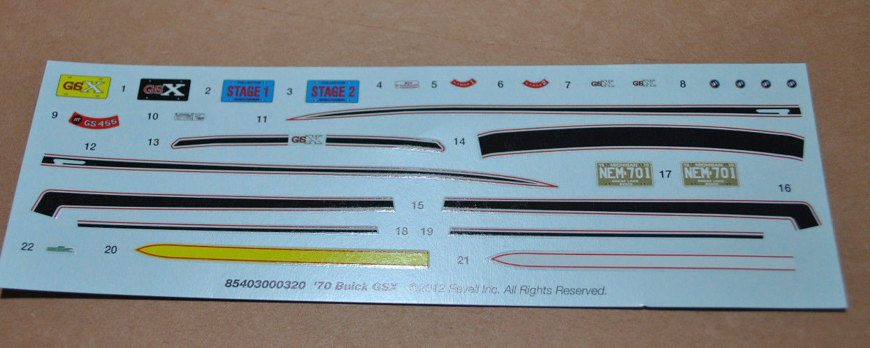

1972coronet Posted August 22, 2015 Posted August 22, 2015 I'm thinking about getting the Monogram 1970 Buick GS 455 kit , and am wondering about the most-recent reissue ; primarily , does it have decals for the gauges and other small parts ? Any-thing to look out for with respect to its construction (i.e. , any parts need massaged / tinkered with) ?
Casey Posted August 22, 2015 Posted August 22, 2015 (edited) Here's the decal sheet from the 2012 reissue of the 1/24 '70 Buick GSX kit: There are no gauge decals, but there are a (very) few engine compartment decals to be used. Edited August 24, 2015 by Casey

Casey Posted August 23, 2015 Posted August 23, 2015 The original issue kit had no decals for the center hood color spear, so you had to figure out how to best to that yourself, either before or after you applied the blackout area on the hood. Now, the spear decal is provided in both Saturn Yellow and Apollo White, and decals for the edges of the blackout hood area/pinstripes are provided.One thing to be aware of is the front bumper/grille/headlight surrounds piece...yes, piece, as in it's all one piece. The headlight surrounds should have the plating removed before painting them body color, but that's not the easiest thing to do without damaging the plating on the bumper or grille. I also recall the rear bumper to body fit wasn't ideal, either, at least in terms of their being enough surface area to bond the two cleanly together. Getting the area under the rear spoiler fully painted can be tricky, too, unless you add some pins to the pedestals and paint and mount the spoiler separately. It's a pretty typical late '80s Monogram kit, though, so overall very good with the expected simplification of assemblies.
