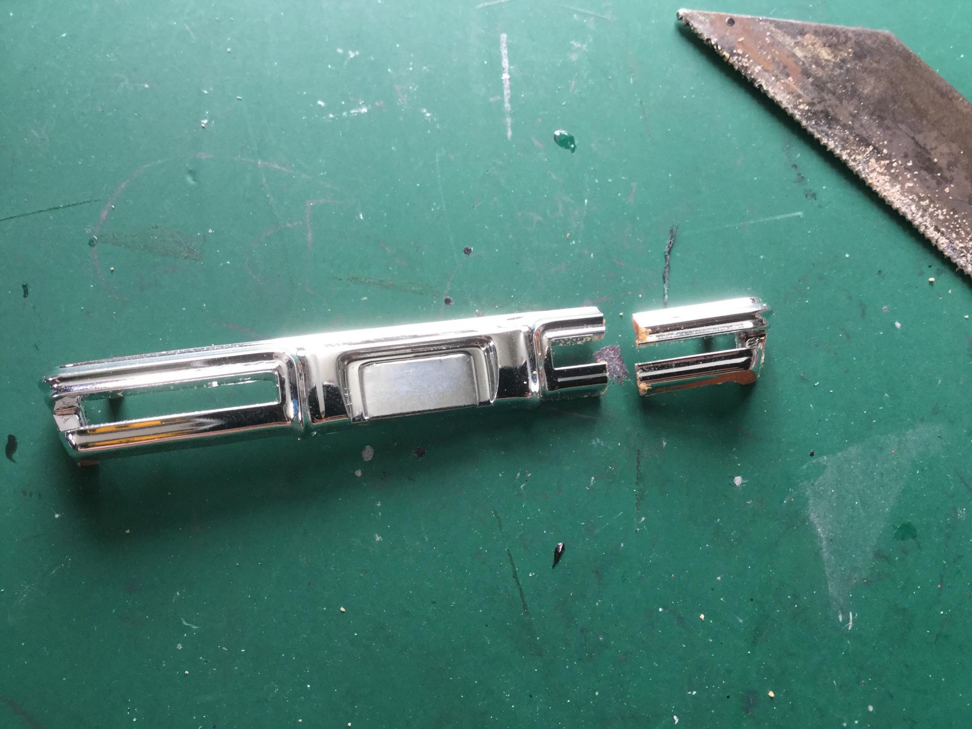

95neon Posted March 4, 2016 Author Posted March 4, 2016 Thanks Bruce! i just started hacking away at the bumper, I don't have a razor saw so I use an old sawzall blade held in my hand, im removing about 3/32 from each side. I couldn't cut it down the middle because then the license plate panel wouldn't look right
95neon Posted March 4, 2016 Author Posted March 4, 2016 My fingers are now all superglued together, but the bumper is chopped and drying. Next I'll cover it in foil and trim the taillights

Can-Con Posted March 5, 2016 Posted March 5, 2016 I have 2 of those bumpers cut down and mounted on my tree that's being sent of for replating.One of the red '70 bumpers and one from the last issue of the '72. They are different bumpers but I really didn't notice one being any wider that the other.

Bob Ellis Posted March 5, 2016 Posted March 5, 2016 Sorry you are having problems with this 72 GTO.I built the 1971 and 1972 when they were new. Got them at Woolworths for 99 cents ant the end of the year. Didn't have much money so 99 cents was more than a half hours wage back then.I never had any problems building them back then and the rear bumpers fit perfect. I can only guess that MPC and ERTL modified the tool greatly. I have recently compared the originals to recent Round2 issues, and you are correct, they don't fit. I tried slicing both sides of the trunk and pulling the sides in. Modelhaus bumpers seem better than the recent kit.This kit became a Street Funny, NASCAR, Modified Stocker,backdated 1970, re-updated 1972 and whatever over 40+ years. Something happened to that kit, somehow. It is what it is, and that's the only 1972 GTO you will find in 1/25.
Bob Ellis Posted March 6, 2016 Posted March 6, 2016 Just for chuckles, I decided to dig out all of the variations of the MPC '72 GTOs that I had, from the annual to the latest Round2 version.I compared the rear bumpers. The overhang on the annual body was minimal. Looked okay. All the bumpers appeared the same width from the annual to the Round2 version.Then I decided that the problem was the body, not the bumper. I checked the fit on the 1980 reissue by MPC. It fit fine. I checked the fit on the Round2 issue and the bumper stuck out way to far. I realized it was a body problem. Everybody that has had a complaint about building a 1972 GTO recently is correct; something is seriously wrong with the body and bumper situation.I compared the body of the 1980 issue to the body of a recent Round2 issue. Voila, it becomes obvious. They are different. Nothing is the same. Even the cowl tray that was added by MPC after the annual run is a different pattern than the Round2 issue. The vent opening on the side of the front fenders is a different shape too. I like to compare the inside of kit bodies. You can see where the engineers design the vents and travels for the plastic when it is filled with plastic. These two bodies, MPC and Round2 are totally different inside. I am guessing that Round2 uses the same cavity of the tool, but the engraving has been redone.It is a problem is mixing old parts with new parts. I think the bumper is basically the same, but the body is different. The old kit from 1972 was fine.The only way to really tackle the problem is slicing the new Round2 '72 GTO at the trunk lines, pry the body wider and then fill with Evergreen styrene. If you have already painted the body that won't work. You need to re-start or get another body to fix.
