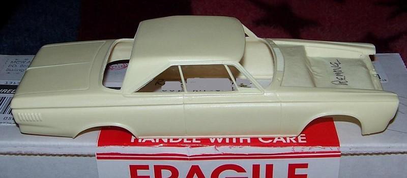

Tim,
I  did my best to modify your picture showing the issues I see.
1st is  the area marked A , you can see the forward edge of the roof where it transissitions into the top edge of the glass is my biggest pet peave and in this view is quite obvious .
It should actually  roll down ever so slihgtly into the  top of the windshield,instead in this pic it appears to continue on flat making it look like it has a  fat upper lip. ( look at a Johan 63 Plymouth sedan kit and it becomes really obvious )
On the lower windshield area ( B ) it appears to curl down in the top of the cowl , where it shoudl continue pretty much flat around the entire perimeter of the lower moulding. ( this may be trickery on the eye due to the picture )
C - is where I feel the vent wing frame leans back to far . IMO, the top of the moulding should be brought forward and the lower extended rearward ever so slighly.( the yellow line in my picture )  This I feel could be easily resolved by any competent modeler,,,,BUT I dont feel we should have to on an  in production modern tool piece.
I haven't bought a 65 Satellite kit yet,,,,based entirely on picttures I've seen online  . And based on this picture  alone  I will not be purchasing the sedan either.
Also,in regards to the lower windshield to cowl area, I feel the LIndberg 64 Dodge is more accurate than the Johan body. ( I just pulled out an unbuilt body I have of each to ck )
Again this is nothing more  than one mans opinion , aka MINE
Edited by gtx6970

Bill....excellent feedback and very helpful.
You, I, and Bill G. all agree on the vent windows (I noted this in my original picture captions and Bill commented above in the thread).
As to your Point A, I wonder if the visual impression here would be lessened once the windshield is installed and painted/foiled accurately.  Because here we are seeing only the surrounding "sheetmetal" whereas the other bodies include the moldings with the body instead of the windshield piece itself as with the Moebius kit.  My guess is that with the windshield installed and trimmed, it would be lessen the concern (that is, appear more correct) but not entirely eliminate it.
I had not noticed your Point B.  This is why having a detailed critique is so helpful.
Best Regards...TIM
