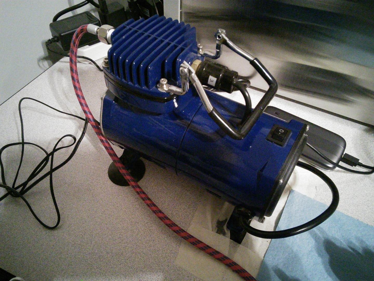

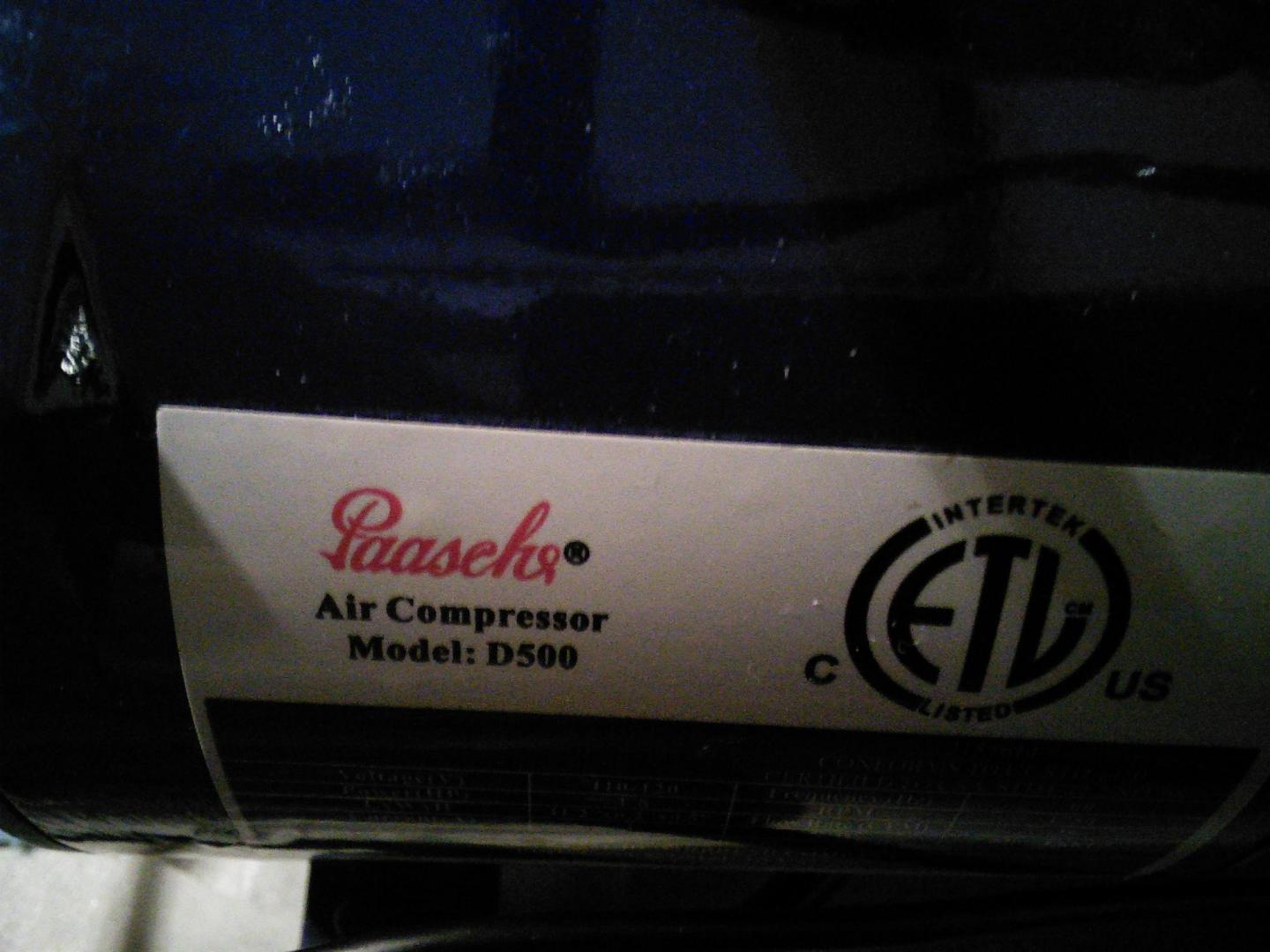

Great looking paint. Looks like your on your way. As far a air compressors I use to use a small single tank Makita. I now use a Paasche D500 and love it. Works great and super quiet.

The D3000R is super quiet at only 47db. Plus, the tank makes it even better cause it doesn't run constantly.

Just curious - from a full tank of air, how long will it stay off - just guesstimate...
Just using it for my second time today. At 30 psi, with continuous spray from a full tank, it comes on after about 20-25 seconds. If you normally spray with it, short bursts, it comes on after about 45 seconds to 1 minute.

That's pretty good! I'll have to check out their website and see if I can find a printed statisic...
Well, that was disappointing - you'd think such a thing would be at least mentioned by the mfr! Here's all that Paasche had to say, "D3000R 1/8 HP Compressor with Tank, Regulator and Moisture Trap. 1/8 H.P. tank mounted piston compressor with regulator & moisture trap. The tank fills to 40 PSI and shutoff. Will deliver up to 20-30 PSI depending on airbrush being used.  Noise level is 47 dbs."
I would have liked to see "fills to 40psi and then refills again at 20psi"... that is what seems to be happening, and it's similar to what I'm experiencing with my Sparmax. To be honest with you, that compressor is a bit underpowered... a more powerful compressor might have allowed a longer "off" period...
