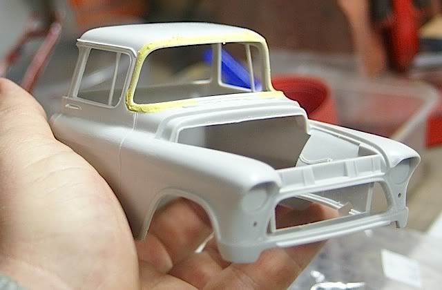

MrObsessive Posted December 30, 2015 Posted December 30, 2015 Richard, one thing that might help is to possibly (and carefully) build up some kind of "border" for the glass to rest on. When I make windshields for my models, that's basically what I do-------give the glass some kind of positive location for the glass to rest on, or fit into. Here's a pic of Johan's Chrysler Turbine Car I was building years ago. The glass was so scratchy and distorted that there was no way I wanted to use it. I ended up using clear stencil sheet and I reinforced the pillars to hold the glass. Since your glass is already molded, you can move your strips of plastic closer to the edges of your A pillars. Of course, they don't have to be as thick as what I used here (.040" half round), and you could perhaps paint them to represent weatherstripping. Hope this helps..........I have this kit and yes, the glass does seem like it's too small for the opening. That was one of the brainstorms I thought of if I ever had to build it-------or simply toss the kit glass and make my own.

Longbox55 Posted December 30, 2015 Posted December 30, 2015 (edited) The problem really isn't the windshield, its the opening in the cab, which is too tall and incorrectly shaped. On the 1:1, the glass does not fit flush to the opening. How it fits in the kit is pretty close on the sides, as the glass does sit inboard of the A pillar. At the top, though, there really should be a header panel with a slight downward angle to it that meets the glass at the top. The top of the glass sits approximately 3" back from the edge of the roof. Edited December 30, 2015 by Longbox55
MrObsessive Posted December 30, 2015 Posted December 30, 2015 Ahhhh, so I was partially there with my suggestion! Make your border pretty much as the pic that Bill posted. That's the first I've seen that up close, and that's a very good reference shot!
retired & glad Posted December 31, 2015 Author Posted December 31, 2015 Thanks Bill and Bill. That's the way I'll go. I'll find the right size rods or angle stock and foil it like the photo. I knew there was a very good way of making it work. This forum is great for answers on a problem.ThanksRichard

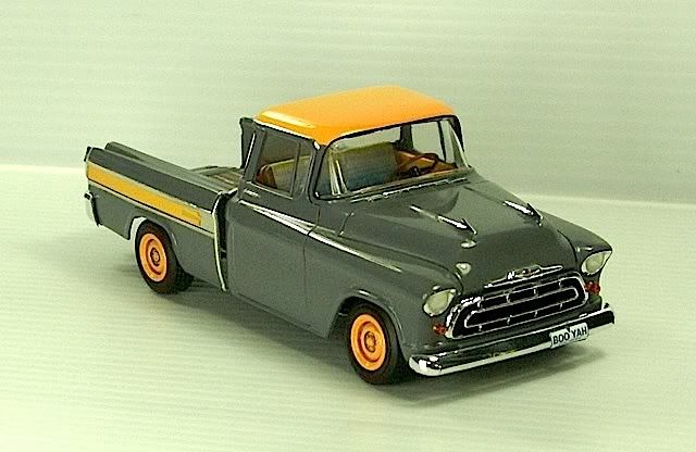

zenrat Posted January 1, 2016 Posted January 1, 2016 I made the hole smaller with styrene rod. Not prototypically correct but it stopped the "glass" falling through.
retired & glad Posted January 1, 2016 Author Posted January 1, 2016 I made the hole smaller with styrene rod. Not prototypically correct but it stopped the "glass" falling through. Great job on this truck. I am going today and get some rods and work on mine again. I am glad I am not the only one with this problem. I thought my kit was the only one that had a bad windshield. Thanks for posting this and showing what needs to be done to correct the fit. Richard
