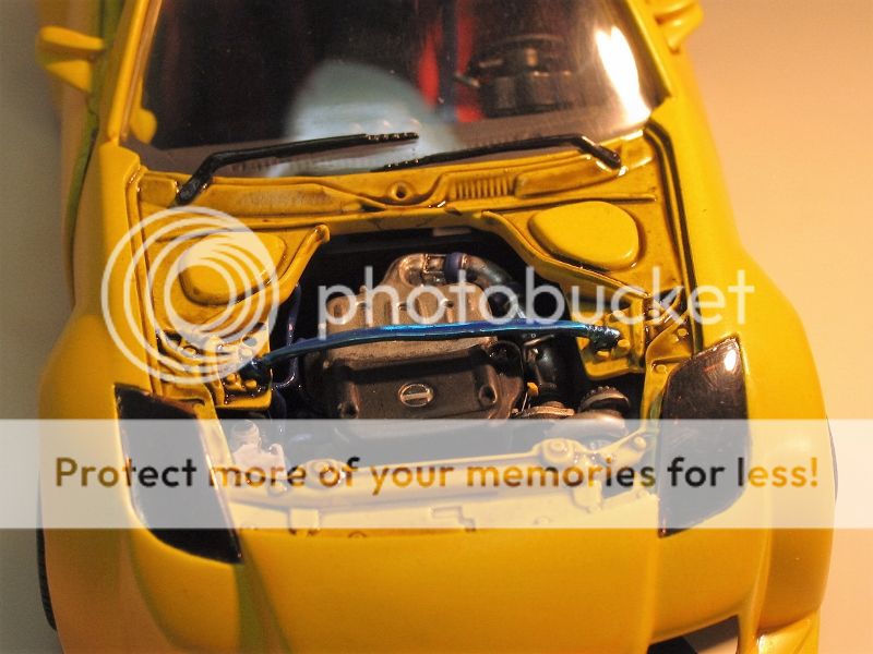

Belugawrx Posted January 24, 2016 Posted January 24, 2016 Cool I'm mixing my own now, that's why I asked.... Try mixing up some flat clear, a bit of thinner, and a drop of black, dark grey, or brown,...or a combo This was a simple mix of Future and a drop of Tamiya Black, the only thing is the future is too glossy, needs flat.

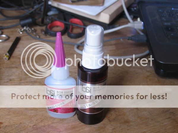

Belugawrx Posted January 25, 2016 Posted January 25, 2016 This is looking good man..as far as the ghosting ..I like to use some CA glue with accelerator ..let it dry and sand out,..prime and paint
lghtngyello03 Posted January 25, 2016 Author Posted January 25, 2016 This is looking good man..as far as the ghosting ..I like to use some CA glue with accelerator ..let it dry and sand out,..prime and paintRegular testors superglue will work right? What kind of accelerator? So just sand with some fine grit paper, reprime then spray color?

Belugawrx Posted January 25, 2016 Posted January 25, 2016 (edited) This is what I use but any super glue will work,..I've heard that talcum powder sprinkled over the glue will work as well... I use 800g then 1000g sandpaper...doesn't leave many deep scratches.. Edited January 25, 2016 by Belugawrx
lghtngyello03 Posted January 25, 2016 Author Posted January 25, 2016 Thanks for the tip Bruce! I'll try my Testor's superglue today, and let it sit overnight then sand it tomorrow with some 1000 grit.
