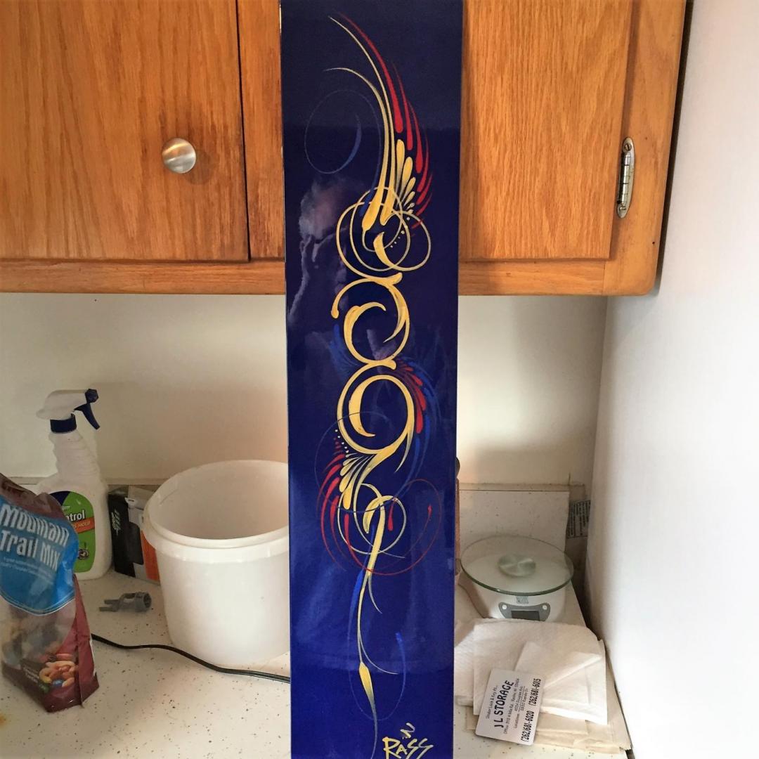

Sent is one example of some of the panel work I do. (All Freehand)
 I did this one last night. Cleared this am......... No Problems
