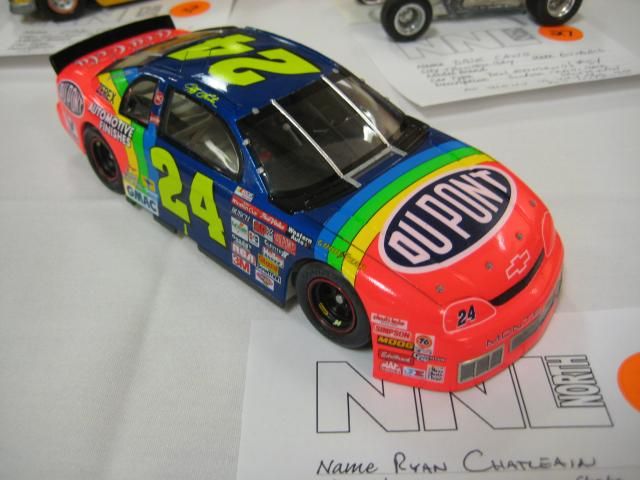

steelhead26 Posted February 4, 2016 Posted February 4, 2016 Hello guys, hope all is well. Picked a Gordon lumina today to practice on. Noticed that the directions call for dayglow red and a blue. Can't seem to find either in spray. Just wanted to see what you guys who have built one have used. I searched the previous posts but many of the images were gone for some reason. ThanksJoe

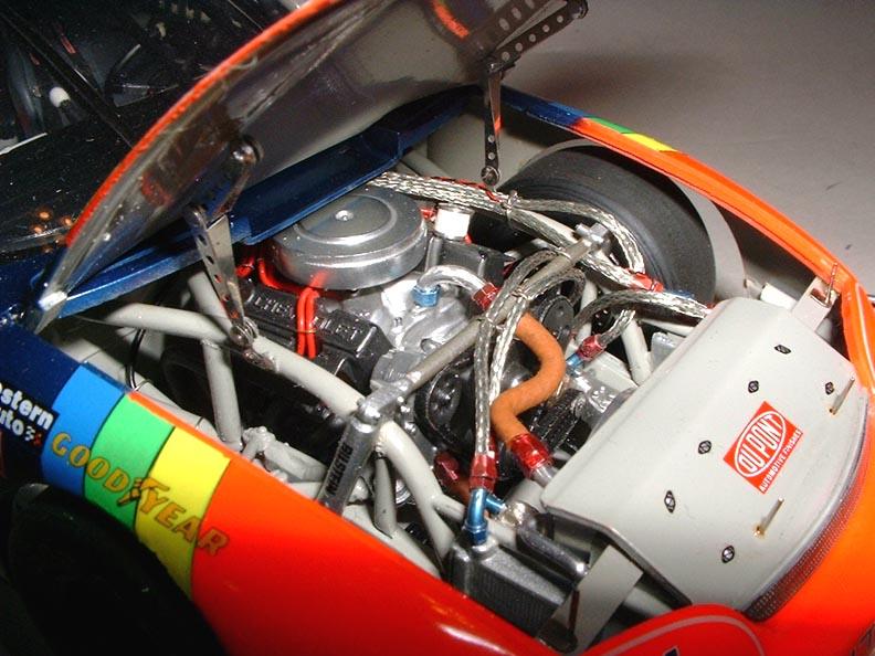

Old Coyote Posted February 5, 2016 Posted February 5, 2016 You might want to try looking at Model Car World .......... they have a large list of Nascar colors in both rattle can and bottles for airbrushing ........... I would think they would have paints for the DuPont cars

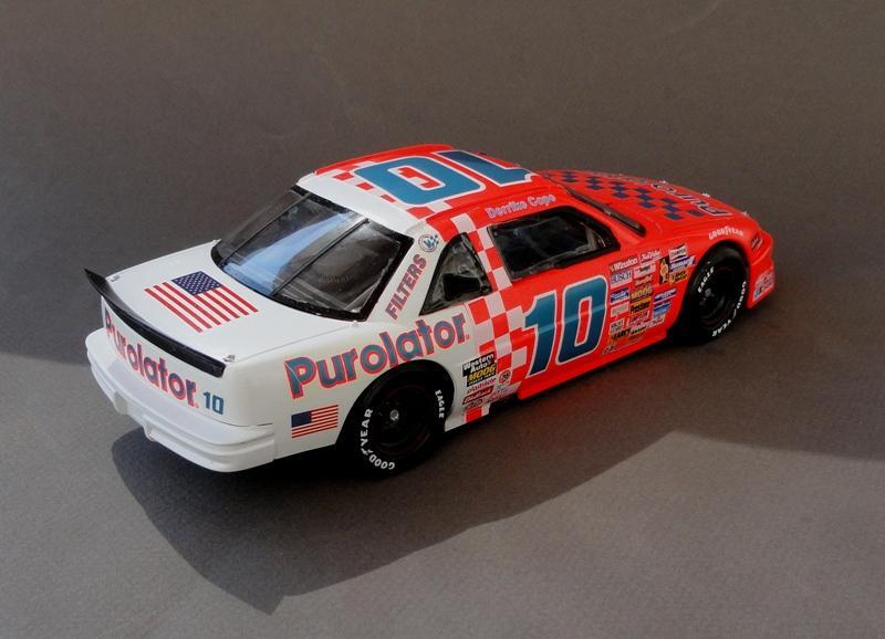

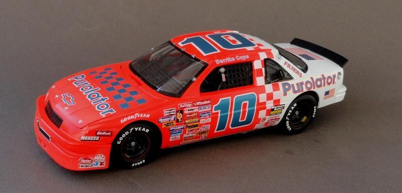

Old Coyote Posted February 6, 2016 Posted February 6, 2016 If you can't find the correct color at MCW, you could try Testors Fluorescent Red ............ it might be an acceptable match ............ I've never done a DuPont car (can't stand Gordon), but here's a car with the Testors paint ........... Derrike Cope's 1990 Lumina

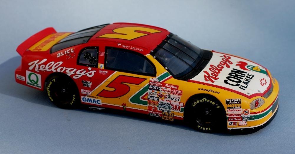

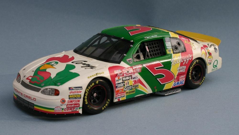

Old Coyote Posted February 8, 2016 Posted February 8, 2016 (edited) Great Idea Joe ........... small steps make for better early results .......... the DuPont car can come in time ................ I definitely want to see pictures of the '98 Terry Labonte car ............. If you didn't already know, I'm a Terry Labonte fanatic ............ I've built a few '98 Kelloggs cars, but not the primary Corn Flakes livery .............. but I have done the '97 and '99 1997 1999 Edited February 8, 2016 by Old Coyote

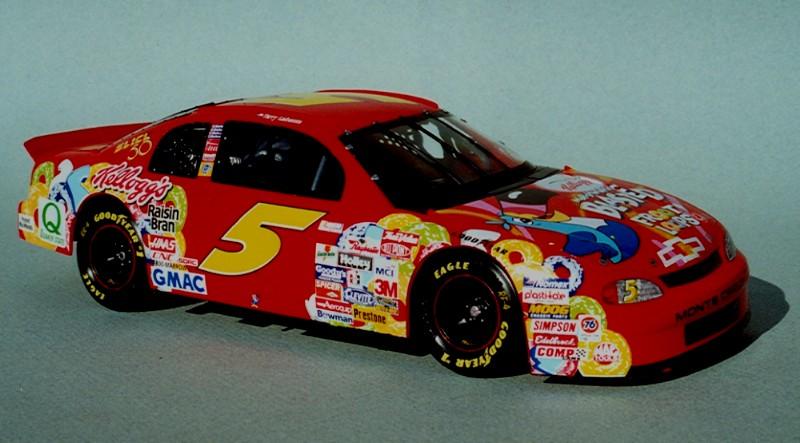

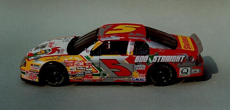

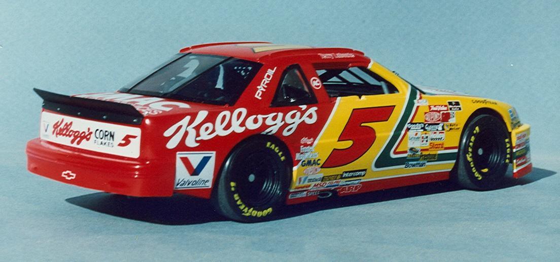

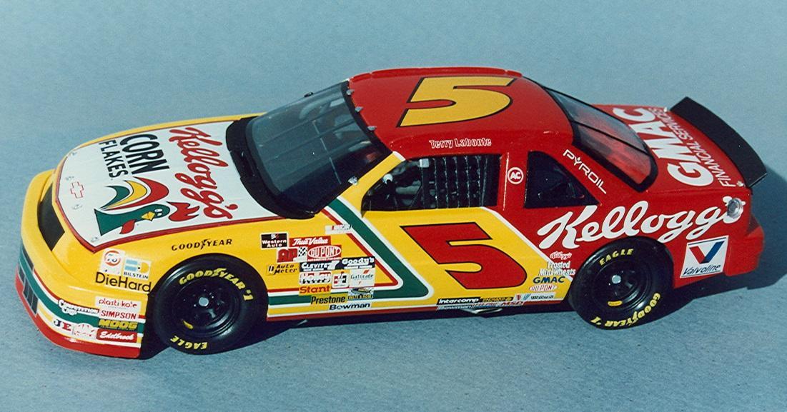

Old Coyote Posted February 8, 2016 Posted February 8, 2016 (edited) These are the 1998 cars I have done ........... Edited February 8, 2016 by Old Coyote
steelhead26 Posted February 13, 2016 Author Posted February 13, 2016 Those are awesome Old Coyote! The top one looks like the one I'm working on. The paint came out ok, though the instructions called for Medium Dark Red which appears to be a few shades darker than I remembered Terry's car. Hopefully I will have time to finish the chassis this weekend. Barring any decal issues I believe I will pleased for my second build in a decade. Speaking of decal work, I bet that Iron Man car was a nightmare to decal. I wish I would have done the Terry Kellog's Lumina instead, I like the longer look of those boats. ThanksJoe

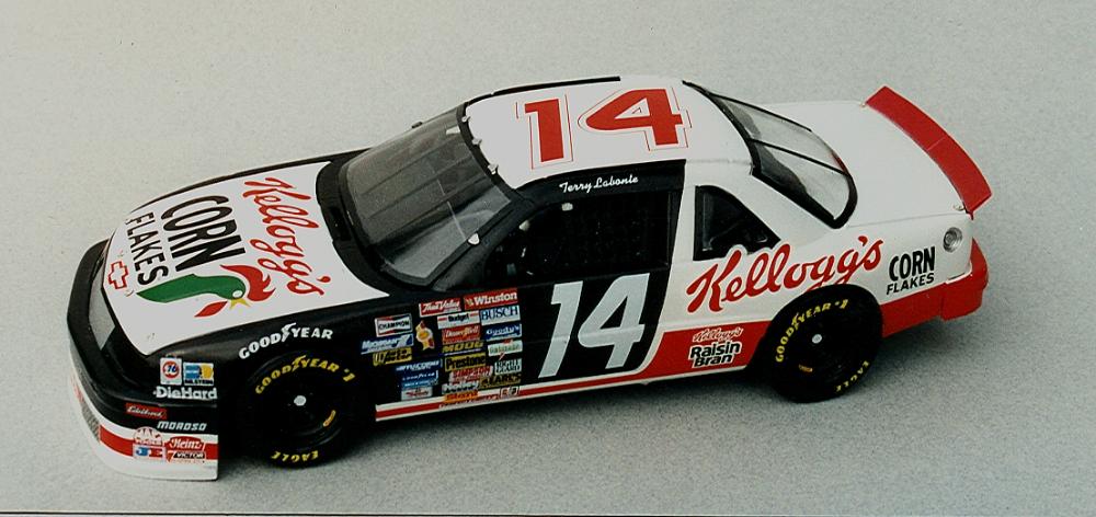

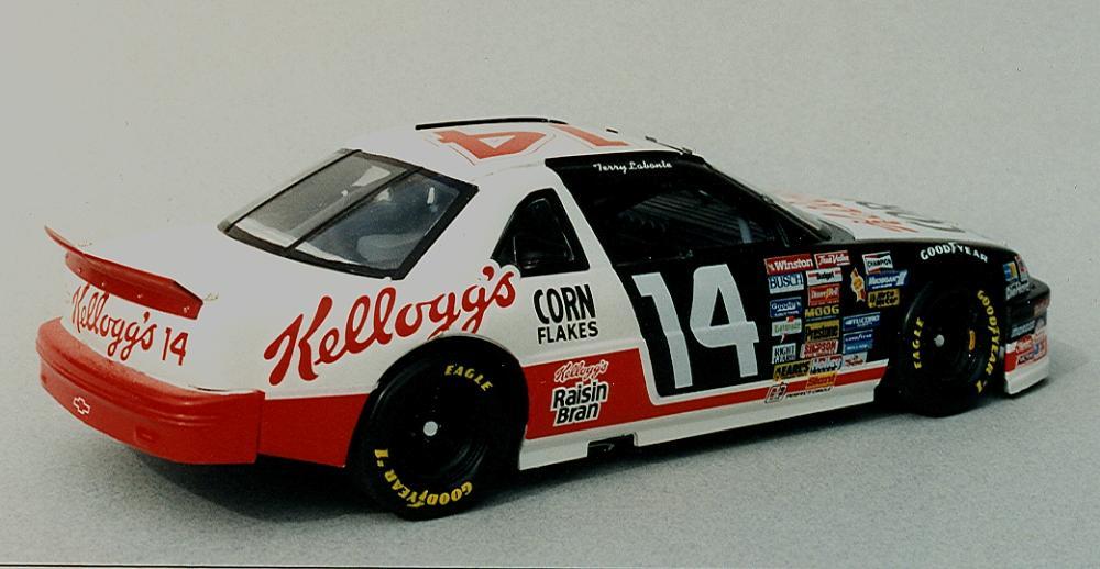

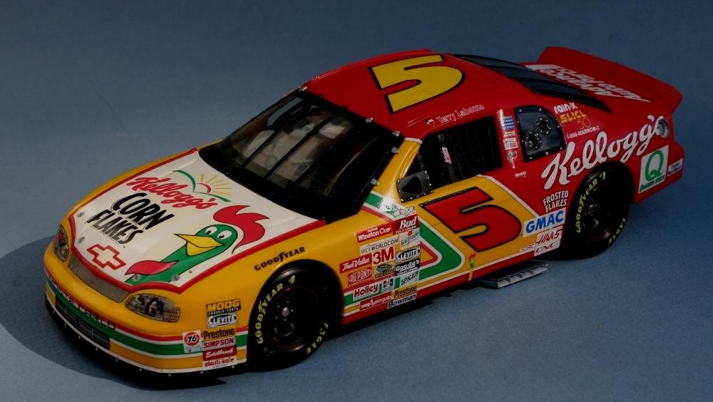

Old Coyote Posted February 13, 2016 Posted February 13, 2016 (edited) You mean this beast ........... it was the first of the Kellogg's paint scheme that became Terry's trademark ,,,,,,,,,,,,, however it wasn't Terry's first Kellogg's scheme ......... that was the black & white '93 Lumina Edited February 13, 2016 by Old Coyote
steelhead26 Posted February 15, 2016 Author Posted February 15, 2016 Love the black and white one. I have a big collection of racing cards and remember seeing this one. How did you get the goodyear decals to stick on the tires so well? Seems like the ones I get have an upraised text of some sort on them, I tried sanding them off but actually made it look worse. ThanksJoe
Toast Posted February 16, 2016 Posted February 16, 2016 Testors "Racing Red" for sure and either "Mica Blue" or "Racing Blue" from Tamiya I can't remember. Yes the Red will need some clear.

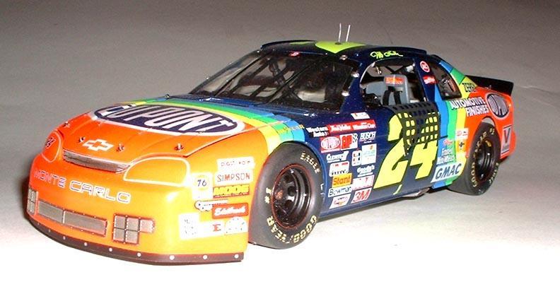

Stryker3285 Posted February 16, 2016 Posted February 16, 2016 The 24 Monte was one of the first NASCAR models I ever did. I ended up using Fluorescent Red as well. It looked good and I will be using it again when I move into some of the Gordon's I've got to do.One thing not mentioned is that you should mask out the Dupont logo that goes on the hood and paint that area white. It will keep the white Dupont letters from having a pinkish tinge to them.
steelhead26 Posted February 23, 2016 Author Posted February 23, 2016 I will have to bookmark this Stryker, I never even would have thought about that showing through. Glad all you guys are on here. I appreciate it. I will be doing a 1995 Steve Kinser Quaker State Thunderbird next. Then I'll try and tackle the Gordo
WizPorsche944 Posted March 9, 2016 Posted March 9, 2016 (edited) If you can find them, I used Testors racing colors #24 red/blue on my 97 Gordon build. You have to clear it though because the red is very flat. Edited March 9, 2016 by WizPorsche944
