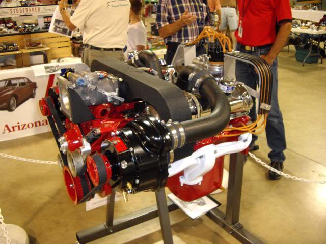

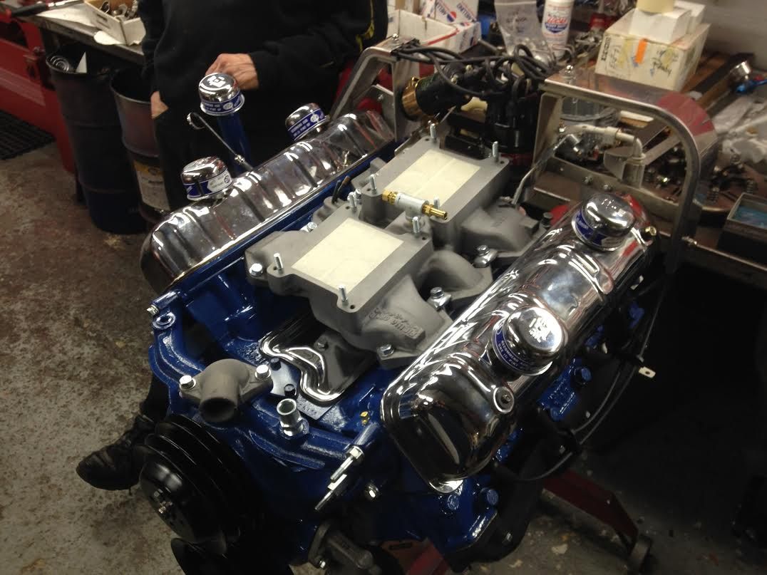

landman Posted October 18, 2016 Author Posted October 18, 2016 (edited) Here is a quick rundown to explain the differences between the different R engines, from an article by Doug Crall who looks like the expert on the matter. R1-289 CID,10.5-1 compression, flat top pistons, 4barrel AFB, 260 degree cam. estimated 240hp. R2-289 CID, 9.0-1 compression, flat top pistons, belt driven Paxton supercharger, AFB carb, Estimated 290-300hp R3-304.5 CID, 276 or 288 degree cam, Paxton supercharger,non-sealed AFB carb inside a cast pressure box. Estimated 335hp. There were only 9 production R3s (all 64's) made by Paxton products , a division of Studebaker (Granatelli brothers). There are probably 20 or so factory built (crate engines) and another 50 or so built up to R3 specs. R4-304.5 CID, 12.0-1 compression, Forged-true pistons, dual 4-barrel AFB carbs, same cam selection as R3. Only one production engine in a 64 Daytona. That engine has been restored. There was also an R4 Daytona convertible created at the factory but lost to history. R5-By Andy Granatelli, not Studebaker, 304.5 CID. He called it Duo Cento because it was to do 200mph on the salt. Modified bendix FI. Dual Paxton superchargers. Estimated over 500hp. That engine has also been restored. Apparently some of the parts were missing and had to be made. Edited December 24, 2020 by landman

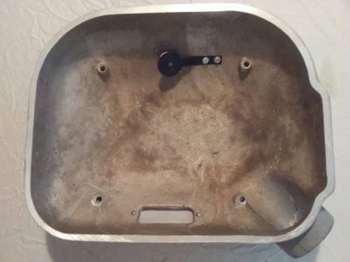

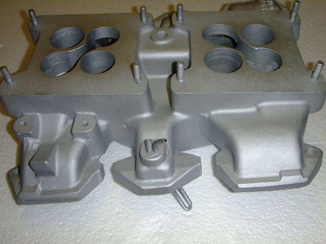

landman Posted October 18, 2016 Author Posted October 18, 2016 (edited) For modeling purposes, the only difference between the R2 and R3 is the air box. So I scaled down a photo of the top half to get the shape. It will have to be scratchbuilt. Edited December 24, 2020 by landman

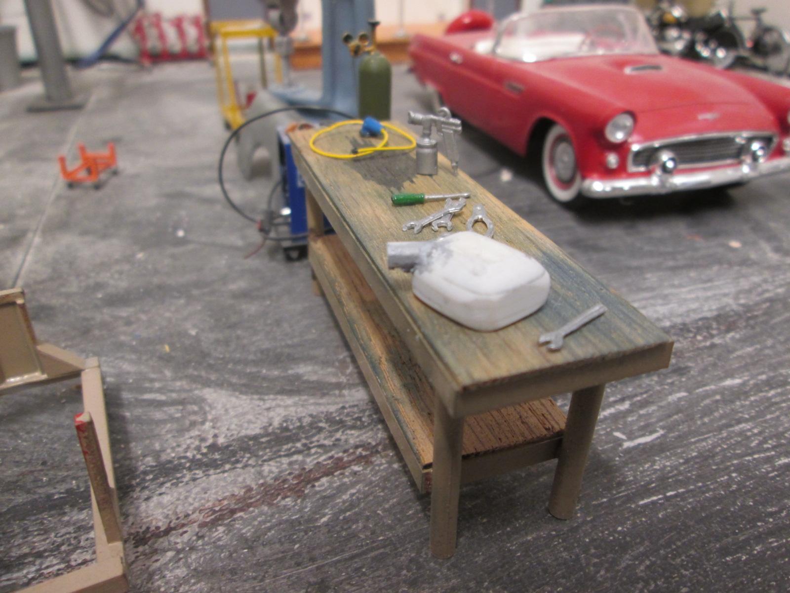

landman Posted October 19, 2016 Author Posted October 19, 2016 (edited) Some work on the R3 air box. Edited December 24, 2020 by landman

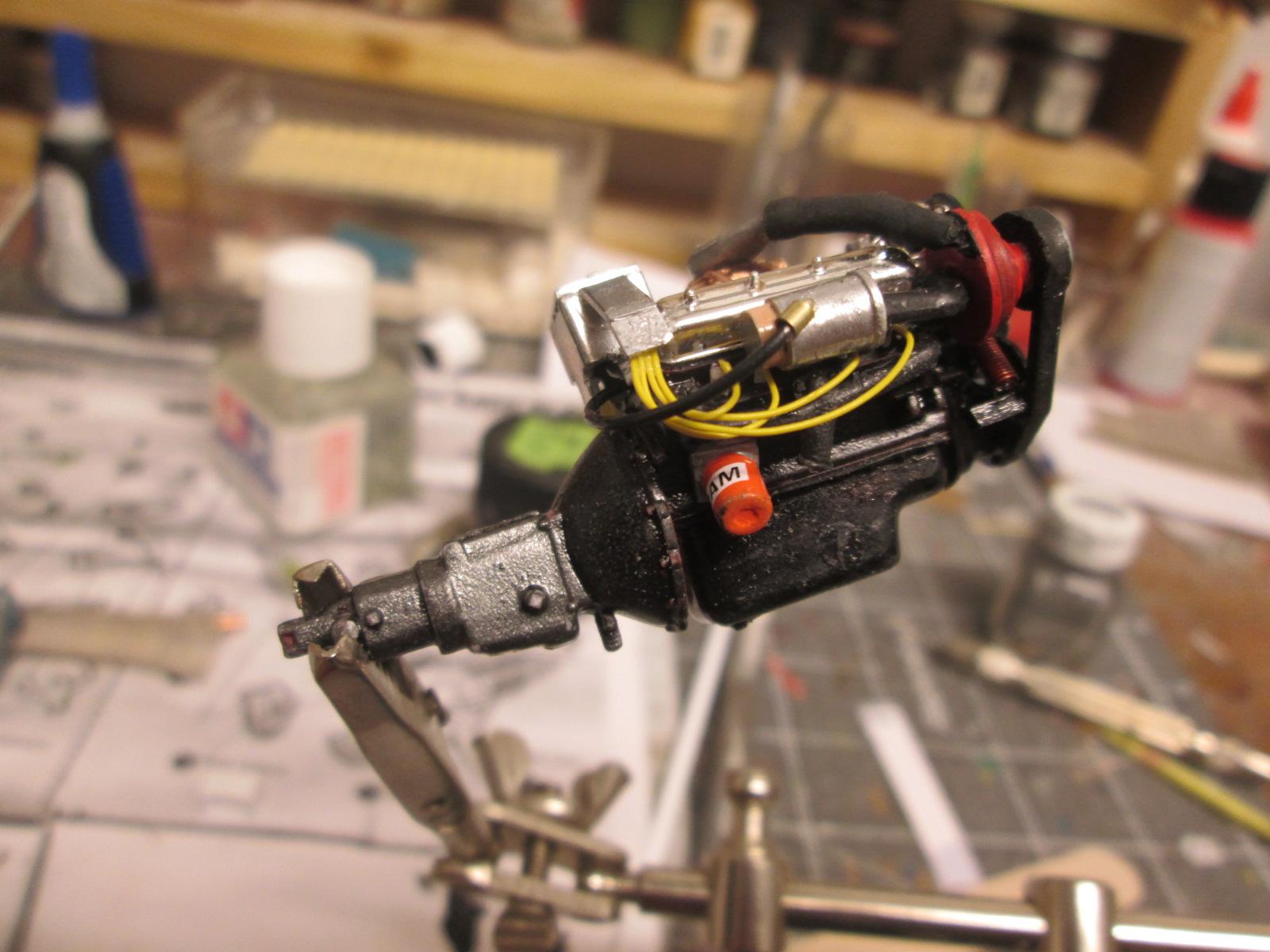

landman Posted October 19, 2016 Author Posted October 19, 2016 (edited) Took another tack with the spark plug wires. I had glued them to the plugs but they broke off when I tried to bend them towards the shield. I'll try the other way. Also started on the ignition shield for the other 3 engines. Edited December 24, 2020 by landman
landman Posted October 19, 2016 Author Posted October 19, 2016 (edited) Worked better this way. They were anchored more solidly allowing manipulation without pulling off. Edited December 24, 2020 by landman

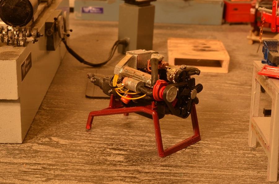

landman Posted October 19, 2016 Author Posted October 19, 2016 (edited) The R2 is completed. Edited December 24, 2020 by landman

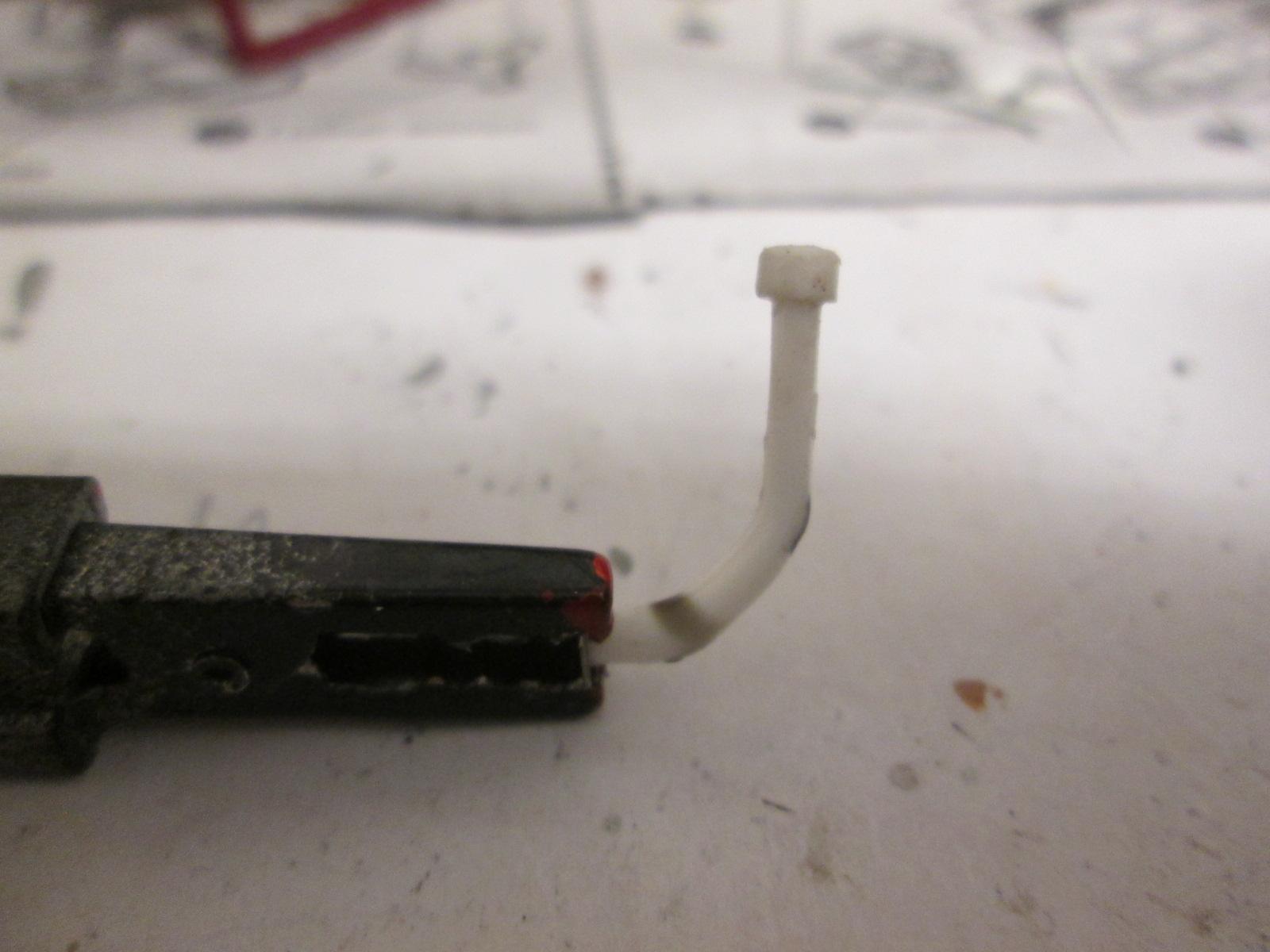

landman Posted October 21, 2016 Author Posted October 21, 2016 (edited) Pipe bending using the tea lite method which I picked up here. Edited December 24, 2020 by landman

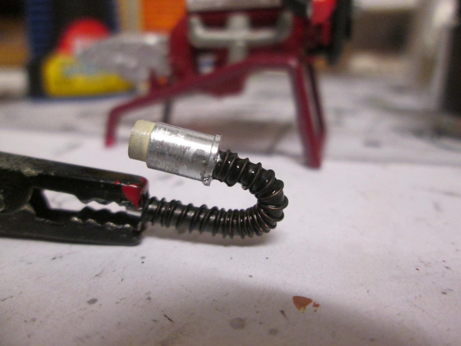

landman Posted October 21, 2016 Author Posted October 21, 2016 (edited) Made the crankcase breather and wrapped some wire around solder to make the air intake pipe. Edited December 24, 2020 by landman

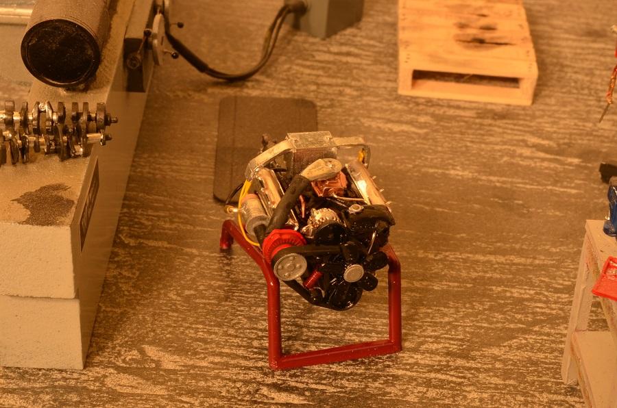

landman Posted October 27, 2016 Author Posted October 27, 2016 (edited) The R3 is done. I see in the photos it'll need a few touchups, but it is pretty well there. Edited December 24, 2020 by landman

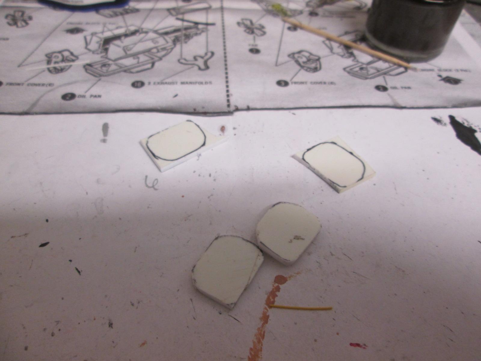

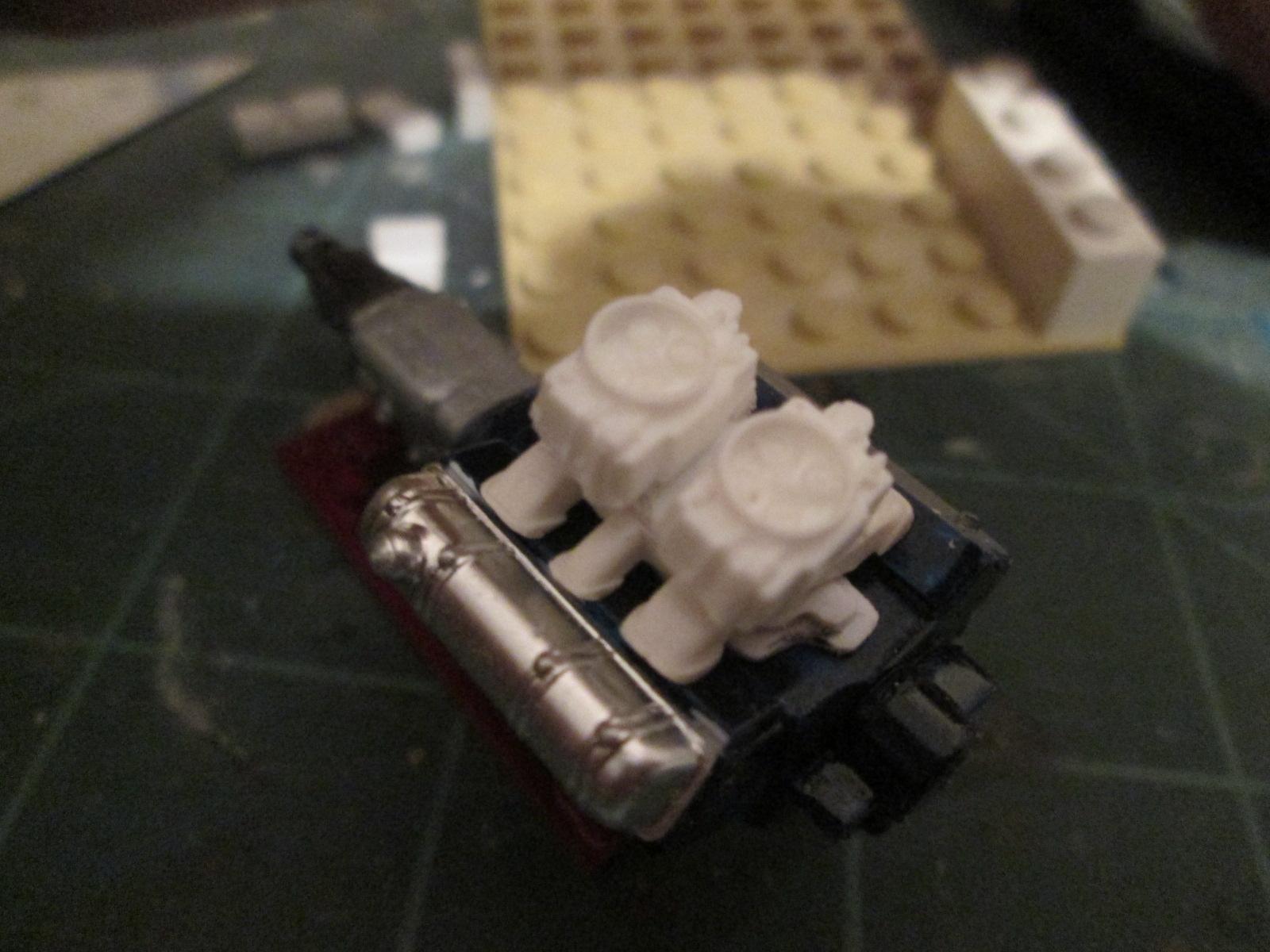

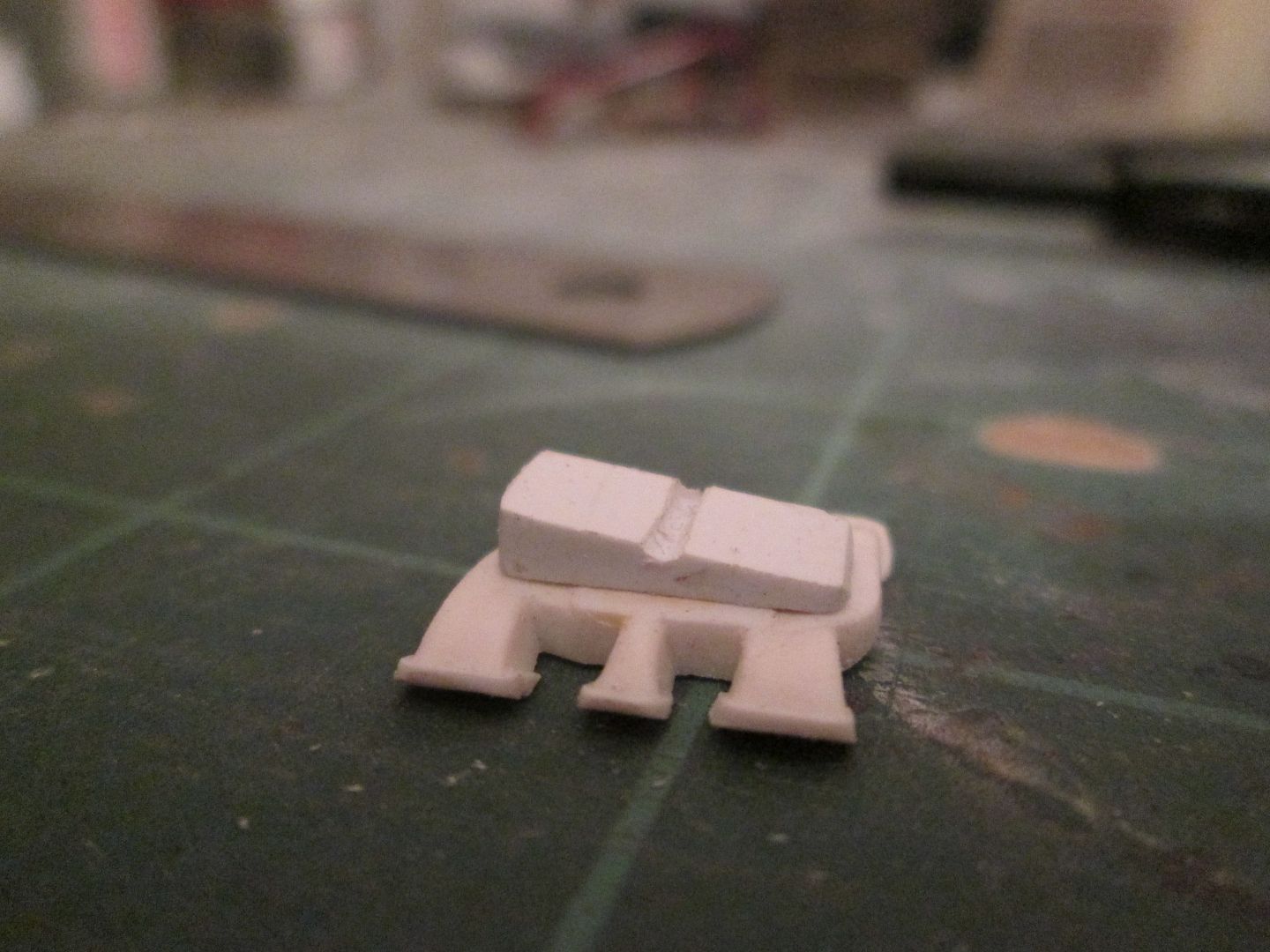

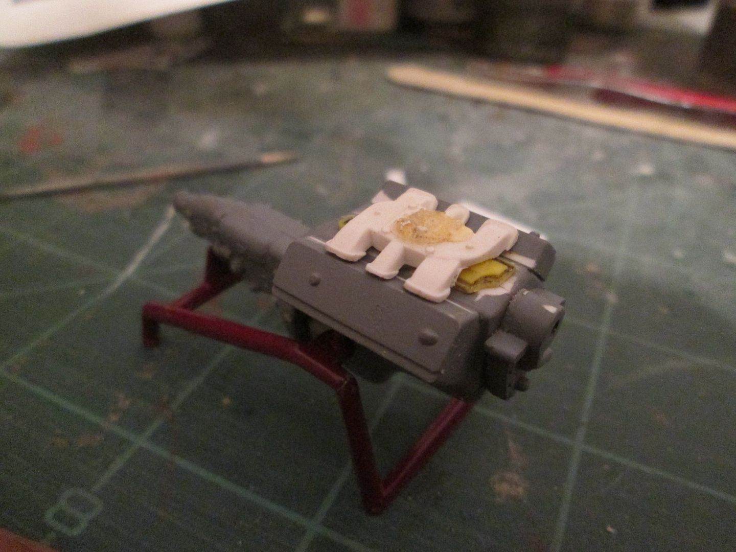

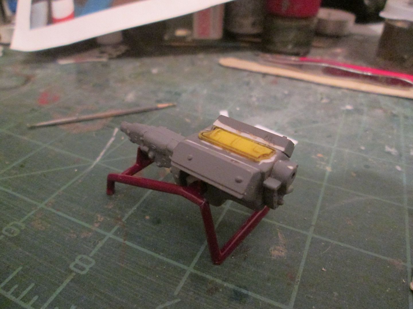

landman Posted October 29, 2016 Author Posted October 29, 2016 Thanks guy for the nice words. On with the R4.The R4's dual four intake has a similar appearance to the single as far as runs go. So since kit R4 intakes are non existant I'll attempt to make one using a single four as a base. The R4 also has a prominent valley cover. Found one in the scrap heap which would work with some trimming. Unfortunately it disappeared from the table later in the evening. Started carving the carburetor bases out of a tapered block. This is to replicate the rake of the 1:1.
landman Posted October 30, 2016 Author Posted October 30, 2016 (edited) I scratched up another valley cover. My wife thinks the dog got the other one off the floor. Edited December 24, 2020 by landman

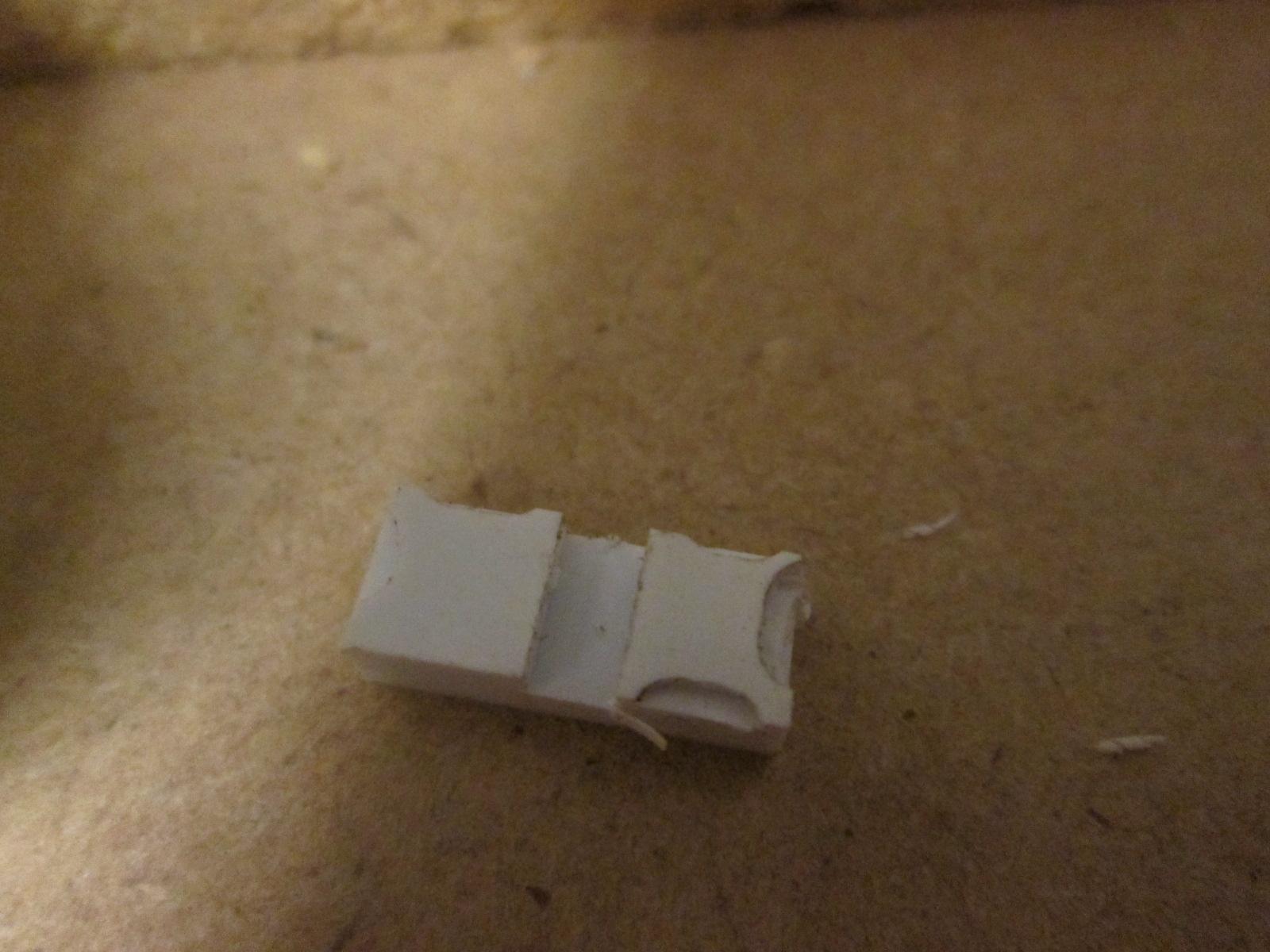

landman Posted October 31, 2016 Author Posted October 31, 2016 (edited) Tried my hand on the mini lathe with the milling attachment. The center groove went OK, the side scallops not so. Finished the engine top parts. Valley cover + stock intake + dual four slanted carb base + carbs. Edited December 24, 2020 by landman

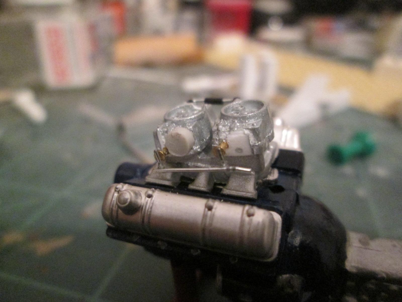

landman Posted November 1, 2016 Author Posted November 1, 2016 (edited) Installed the valley cover, manifold & carbs. Working on linkages and fuel lines. Edited December 24, 2020 by landman
