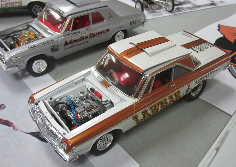

6bblbird Posted October 31, 2016 Posted October 31, 2016 I built this one a while back as a fictional Nostalgia S/S so I was not restricted to the rules! I do remember that the color was from Duplicator but for the life of me I can't recall the actual color. If you have a Duplicator dealer with a large selection you might be able to match it to the can's cap.
Bill J Posted November 1, 2016 Author Posted November 1, 2016 Wow, good information from everyone. I also really appreciate the offer of some Johan cheaters. I did order a set of the cheaters from Speed City Resin Casters, I will see how they work out.. I did know the rules allowed for aftermarket wheels but did not know there was a weight restriction. Makes sense. Seems like I remember seeing a lot of Cragar's back around that timeframe. That would probably make the weight rule because they were a steel rim with a cast aluminum center. I'll probably go with the steelies that came in the kit.Walt, your Lawman model looks great, love the color you used. I have some Ford Emberglo but in the bottle it looks too dark, may paint a spoon and see what it looks like over white. I guess my other option is to check Scalefinishes to see if some factory color would work. Here in Phoenix it is hard to buy spray paints, the law makes stores lock them up and they're hard to look at and even harder to find the person with a key!
