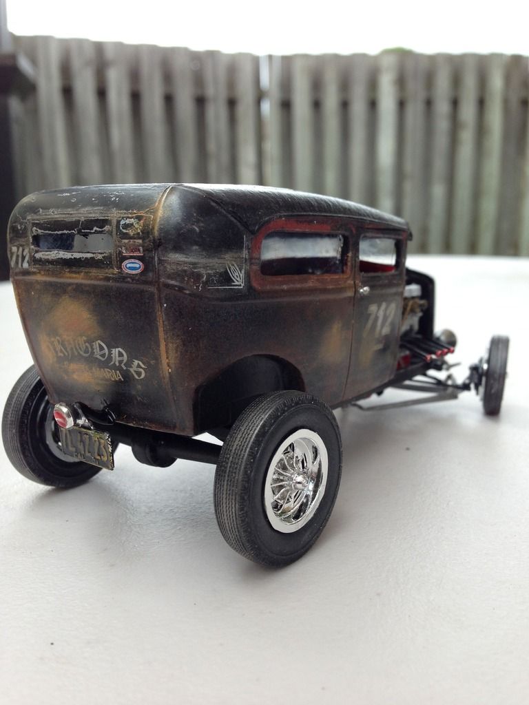

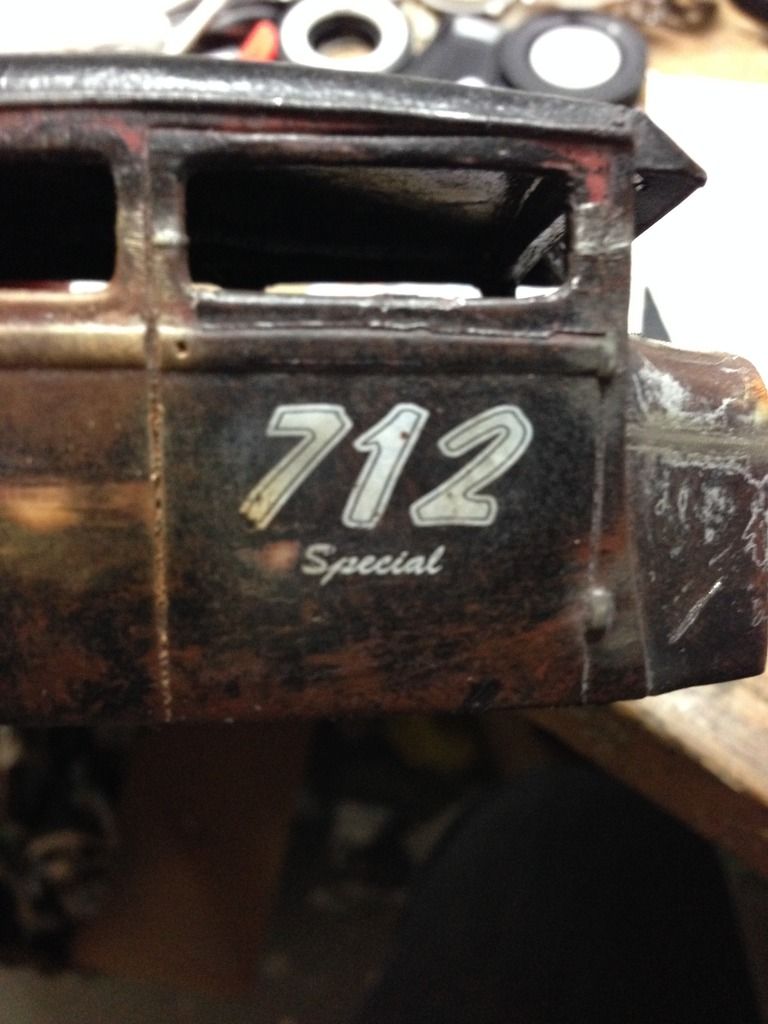

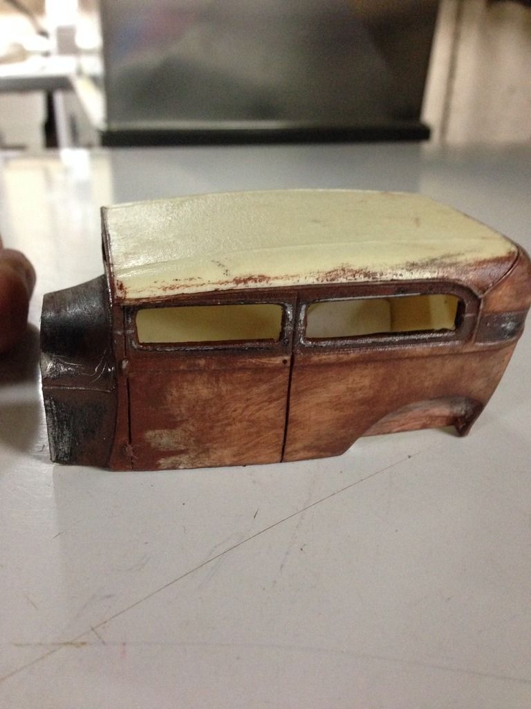

For this build, I layered different colors with a brush (no primer), and then rattle can for the final color coat.  Some careful sanding until the base coats revealed themselves, and one last coat of flat clear.  Some strategic dry brushing doesn't hurt either.

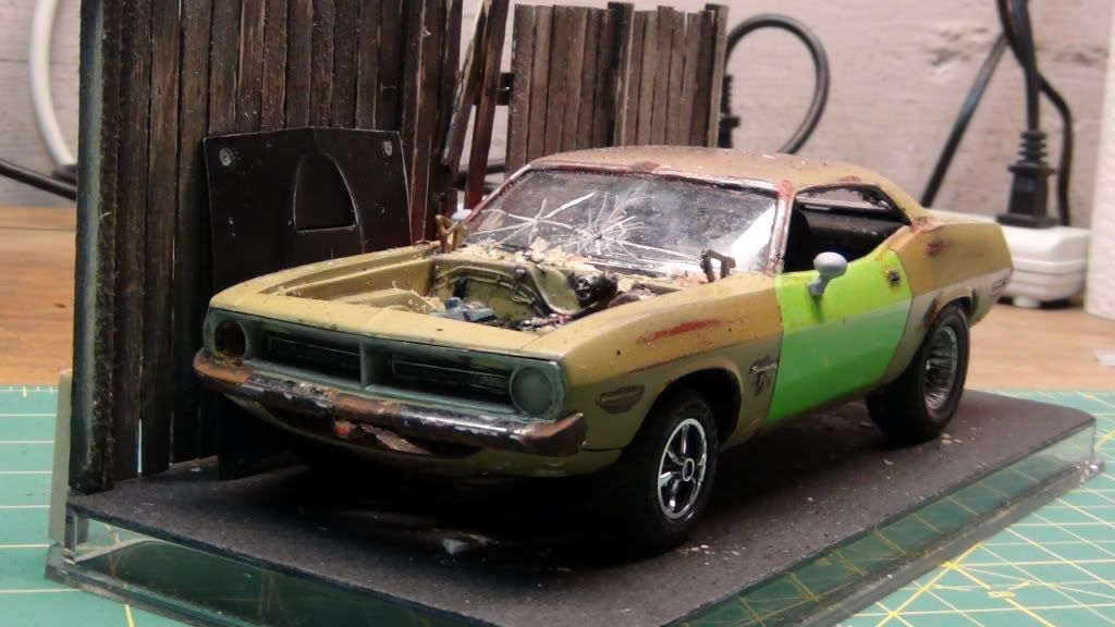

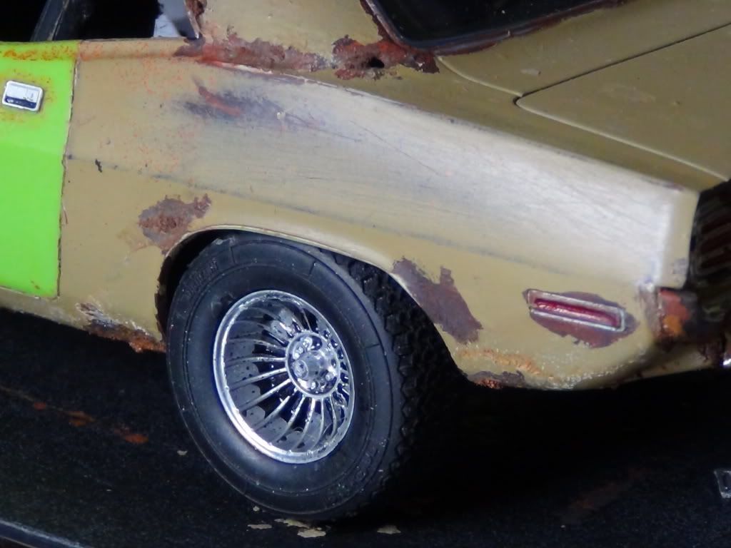

This was my first attempt at a rusted Junker.  Again, I layered different colors, both acrylic and enamel over each other.  Next, I splattered some Micro Mask (aka liquid masking tape) and let dry.  Rattle can enamel top coat, and then used a toothpick to pry off the Micro Mask.  Some light sanding in the "oxidized" areas too.
'70 Plymouth Grand Coupe photo DSC00045.jpg'70 Plymouth Grand Coupe photo DSC00048.jpg'70 Plymouth Grand Coupe photo DSC00042.jpg'70 Plymout Grand Coupe photo DSC00155.jpg'70 Plymout Grand Coupe photo DSC00153.jpg
If anything - going against the rules of mixing acrylic and enamel probably helped me get the distressed effect I was looking for.

Example #1:

Example #2:

If you look at the hood in my 'Cuda dio (propped up on the fence), you'll notice that it is "aged", but not rusted.  That's because the 1:1 '70 'Cuda AAR hood was fiberglass!
