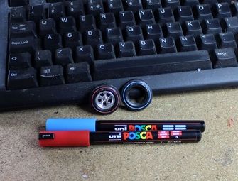

I recently found these POSCA paint filled pens in a local Art and Craft shop. They are similar to Molotow Chrome Pens, only they hold paint instead of ink. A good shake, then push the tip down a few times and paint flows.
I got the 0.7mm tip version.
These were the brand my shop stocked, there are probably others out there.
I tried them freehand on a couple of spare tires and got decent results by following a raised part of the sidewall on the tires. Excess paint was easily removed with a sharp knife.
cc63b50e-ecfb-44b4-b2f0-a5544f068f6e_zps
The results were better than my attempts at brush painting bands on tires but could do with yet more improvement.

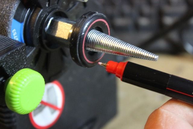

Loading up a tire onto the arbour attachment on a cheapo hobby bench grinder and then touching the spinning tire with a red pen got me a perfect Redline tire!!
 I love it when a plan comes together.:)

Checking the tires I did last night I find the paint has dried hard and has a matt finish. Using a scientific spit test, I find the paint is water based. Probably an acrylic in that case. That should mean it can be used as a striping tool on just about any finish.
 I didn't check at the Art supplier for white pens in the range.  If they do, I can see a whole load of wide whitewalls in my future.

I've done the narrow whitewalls before, using a battery operated drill
