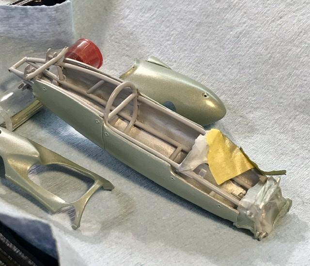

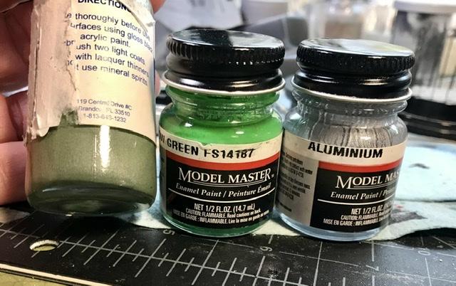

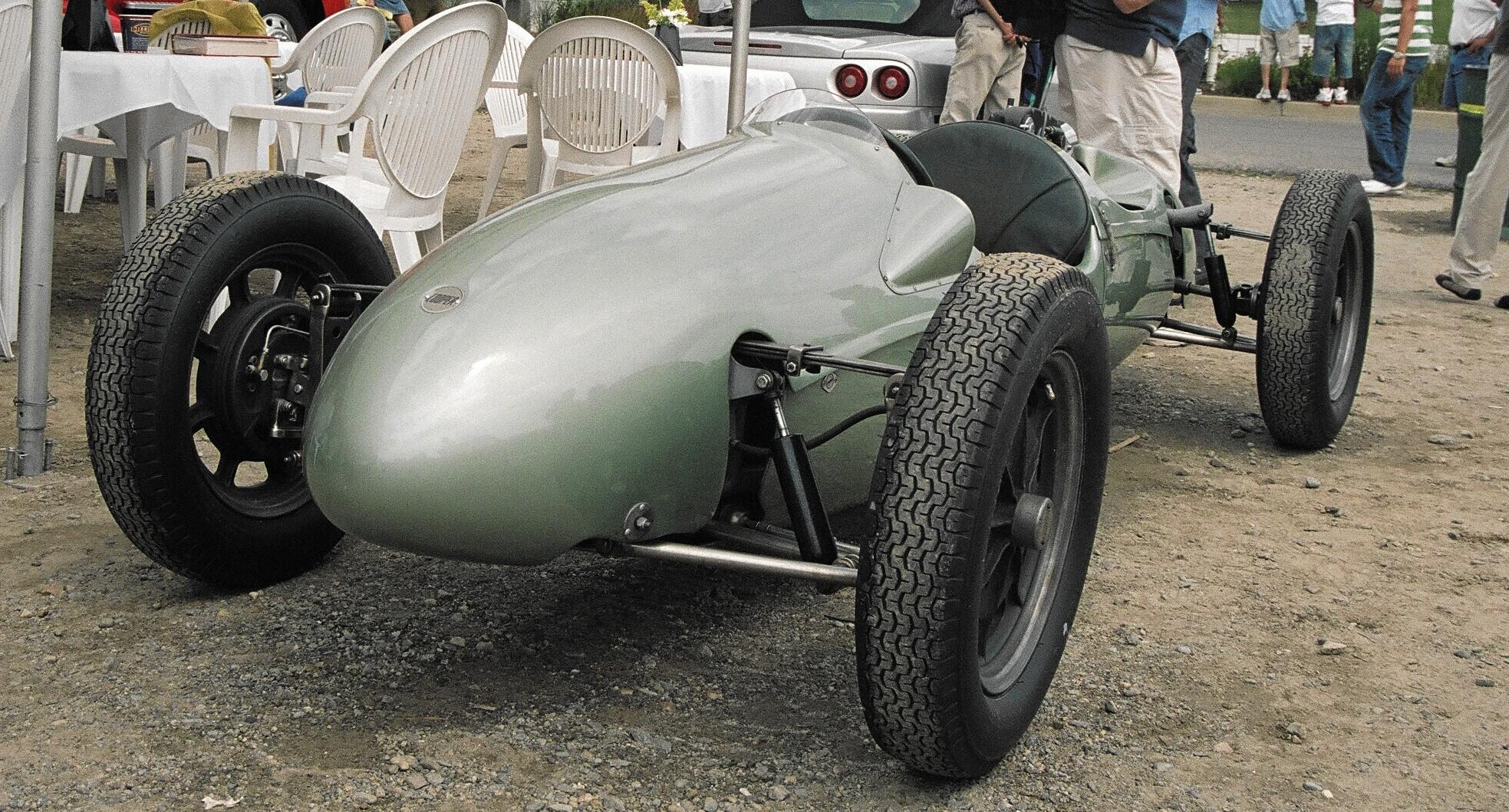

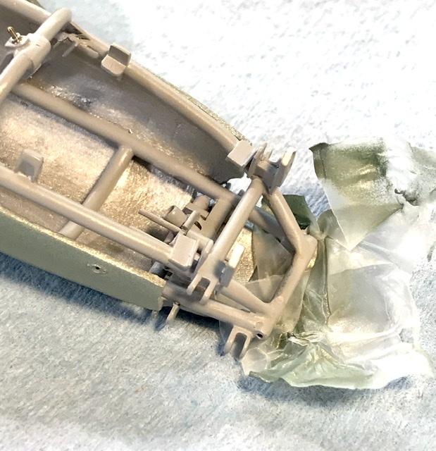

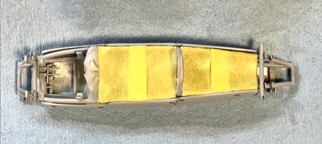

I haven’t airbrushed Model Master paint in - like - forever ...  missed that distinctive enamel scent !   The Cooper wears a paint color that is similar to same era Aston Martins.  So I mixed up a color that looks about right fr the paint in the picture - thinned it - and masked the frame.   Went on really smooth. Assuming that I should let this dry several days before I try to remove the masking - no hurry - should I wait a week?  Lots to do in the interim ...
I would not let the paint dry hardly at all before removing the masking tape. I remove it about 5 minutes after I shoot. That's for Lacquer. Enamel I usually wait about 10-15 minutes and then remove the tape.
I won’t have a problem with “line bleed”. But I see your point ...  removing the tape and parafilm will require a lot of handling and I don’t want to mar the surface. Maybe I’ll try tonite - I used some tape with some light “tack” so I could leave it on a while .... At least that’s the plan .... do you think that I could put some Parafilm on the surface after about 12 hours ??
Hey Andrew...if that's enamel...I would wait a week or so before doing any taping on the paint.  I tape on Lacquer the next day.

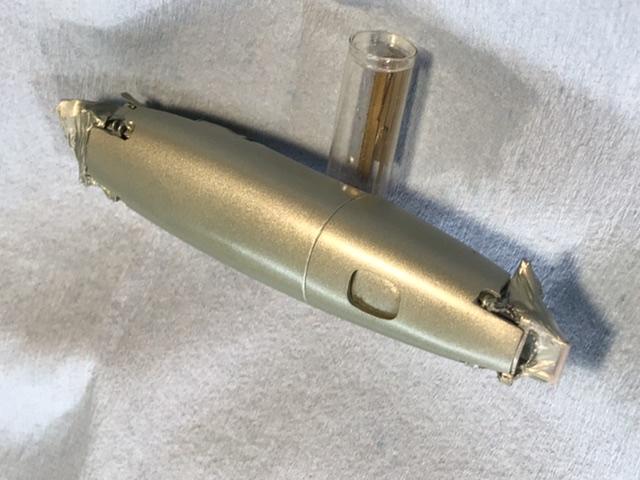

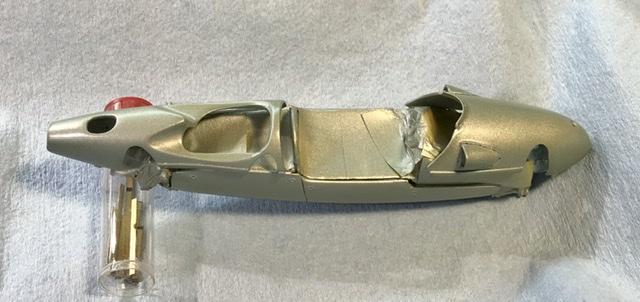

The Model Master is acrylic lacquer - so the drying time is faster than old fashioned enamel. By grasping the body with the chassis members at either end I was able to remove the tape without a problem   -  the parafilm came off without damaging anything   But I’ll wait a few days before more handling

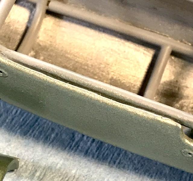

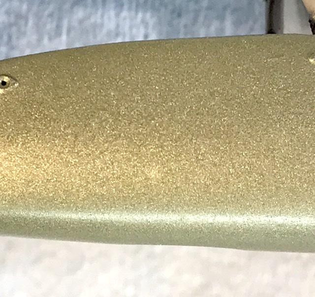

Really like this paint.  Just a little over-bleed on one frame tube .  And a small blemish on one panel and a speck of dust on the nose .  Not bad !  This will take very little final prep. No clear coat. A minimum of sanding.  Just one coat - and bang.  Don’t know why. But metallic colors tend to give me a lot less trouble than solids ...
The parafilm was crucial.  Don’t think I could have masked the exposed frame members without this stuff - without damaging them  ...   ...
