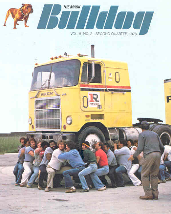

baloney Posted December 16, 2017 Posted December 16, 2017 here's picture that i found... at least you have a base... this one do not have the dog in the grill. remember Ryder trucks are cheap rentals so you must use bud wheels no mags were on those trucks. show us some pics of your project when you start building it!
DRIPTROIT 71 Posted December 16, 2017 Author Posted December 16, 2017 On 12/16/2017 at 5:05 PM, baloney said: here's picture that i found... at least you have a base... this one do not have the dog in the grill. remember Ryder trucks are cheap rentals so you must use bud wheels no mags were on those trucks. show us some pics of your project when you start building it! Expand Thanks for the picture Greg! I've got some old Clint Freeman 2 hole Budds for this project. I personally have never been a big fan of the AMT 10 hole split rims anyway.
