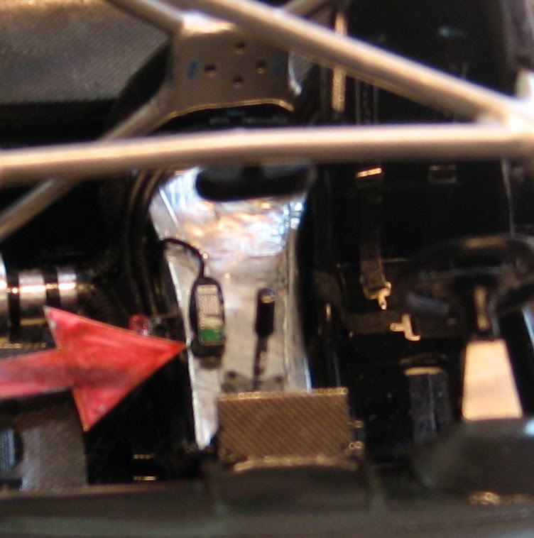

Brendan Posted July 8, 2008 Posted July 8, 2008 I used aluminum tape for making heat shields since it is quite a bit thicker than BMF. With it being thicker, it's excellent for exhaust shielding because you do want wrinkles in it and not for it to be smooth. I use BMF for more of the finer detail work since it's thinner and lays down better. Here's a picture of it on my Aston Martin on the tunnel.
