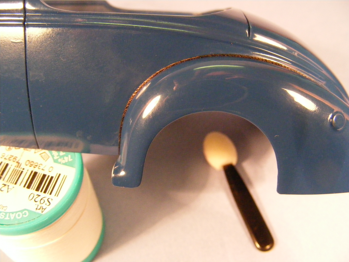

BigTallDad Posted February 18, 2018 Posted February 18, 2018 (edited) Soak the thread in white glue, such as Elmer's. Apply to the desired area...if you smudge a little, clean up with windex after the glue dries. I'd suggest a clear coat afterwards...Elmer's on a painted surface is not a very strong glue bond. I used black thread to install the fender welting (front and rear) on this '40 Ford convert. Edited February 25, 2018 by BigTallDad

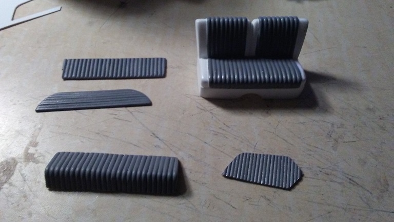

Jon Haigwood Posted February 25, 2018 Author Posted February 25, 2018 On 2/22/2018 at 12:46 PM, ScottH454 said: What is your tuck n roll made out of? I have redone three seats now with .015 plastic rod onto plastic seats. Might be easier to manage than thread. I am making sections with .010 sheet styrene and .080 half round for the back seat. Glueing on .080 half round on the front seat. And making sections with sheet styrene and .060 for the dash and the rear deck. I want the piping to go around the edges of the front seat and at the top of the rear seat. I thought about using rod but I want it black and if I paint it black the paint will most likely rub off when I bend it around the corners and attach it.

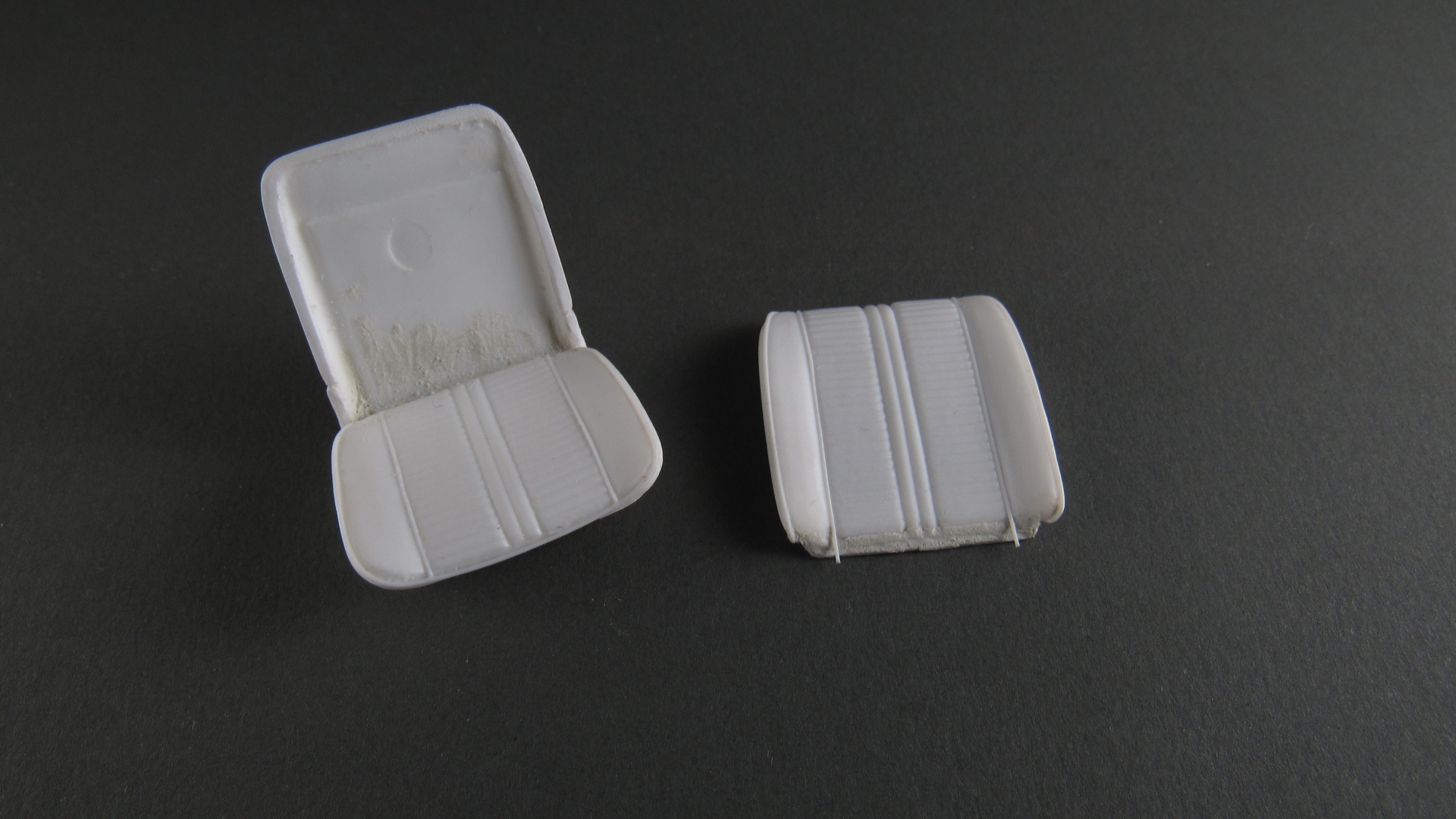

ScottH454 Posted February 25, 2018 Posted February 25, 2018 Ok, so you are trying to avoid painting after it is on the seats? A black marker would give a thinner coat that should let you bend it, but the glue you use might not like it. You could still mask off the piping afterward then paint it black with a marker. From the photos you shared you won't be happy with thread, it won't be smooth enough even after soaking in glue. At the least try the glue on some threads to see how it dries on some scrap plastic will you wait for some .015 plastic rod. The seats I am doing are all the same color so I was just painting them complete with a thin coat of paint. Inserting some photos of the latest seat. The outside was .015 rod an the inside seams is 0.10. I used Tamiya extra thin to glue it down in sections, it softens the rod to help it bend. It did break a couple times an that meant pulling it off to avoid a noticeable seam.
