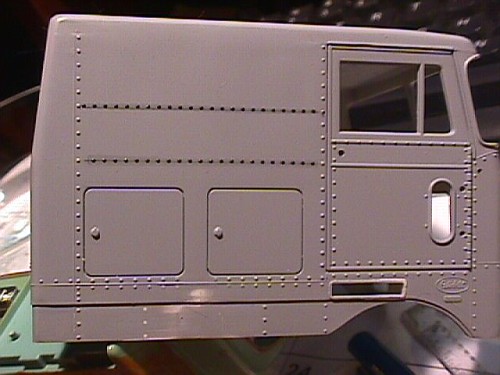

Oldmopars Posted May 22, 2018 Share Posted May 22, 2018 I have been working on correcting the White Freightliner headlight issue, them beeing too high. I cut them out and flipped them side to side(will be in my build thread), but not matter what I tried, I just ended up loosing the rivet details. Is there any way to do this without loosing the details? Anyone sell very tiny rivets that I can add back? Any other ideas? Quote Link to comment Share on other sites More sharing options...

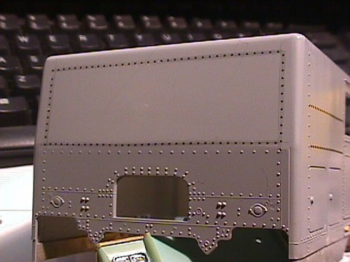

Oldmopars Posted May 22, 2018 Author Share Posted May 22, 2018 This is the Rivet detail I want to restore Quote Link to comment Share on other sites More sharing options...
