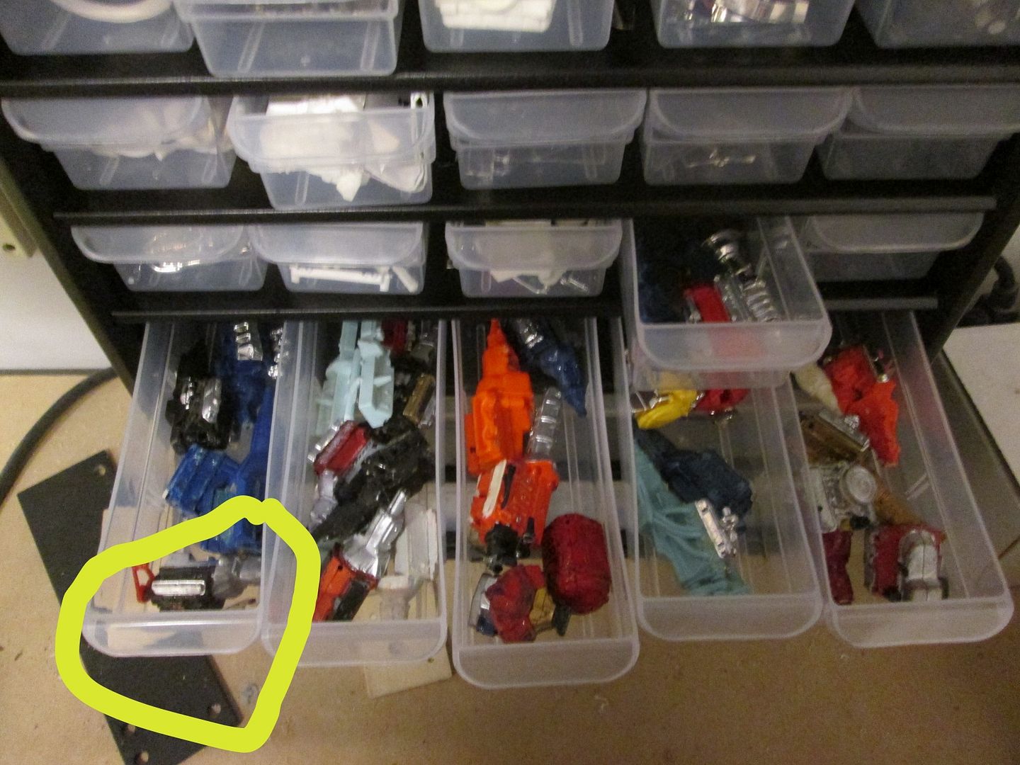

Seeing I won't be using the Fairlane chassis I was going to do it curbside. But then while rummaging in the engine drawers, I found this 351 from the MPC Mach 1. I assume it is a Cleveland. Anyway, I'll use that one since I already have custom wheels. It'll just give it that extra Ooomph.
Edited by landman
In another drawer, apart from the others, were these 3 Y-Blocks. That may be a better fit.
