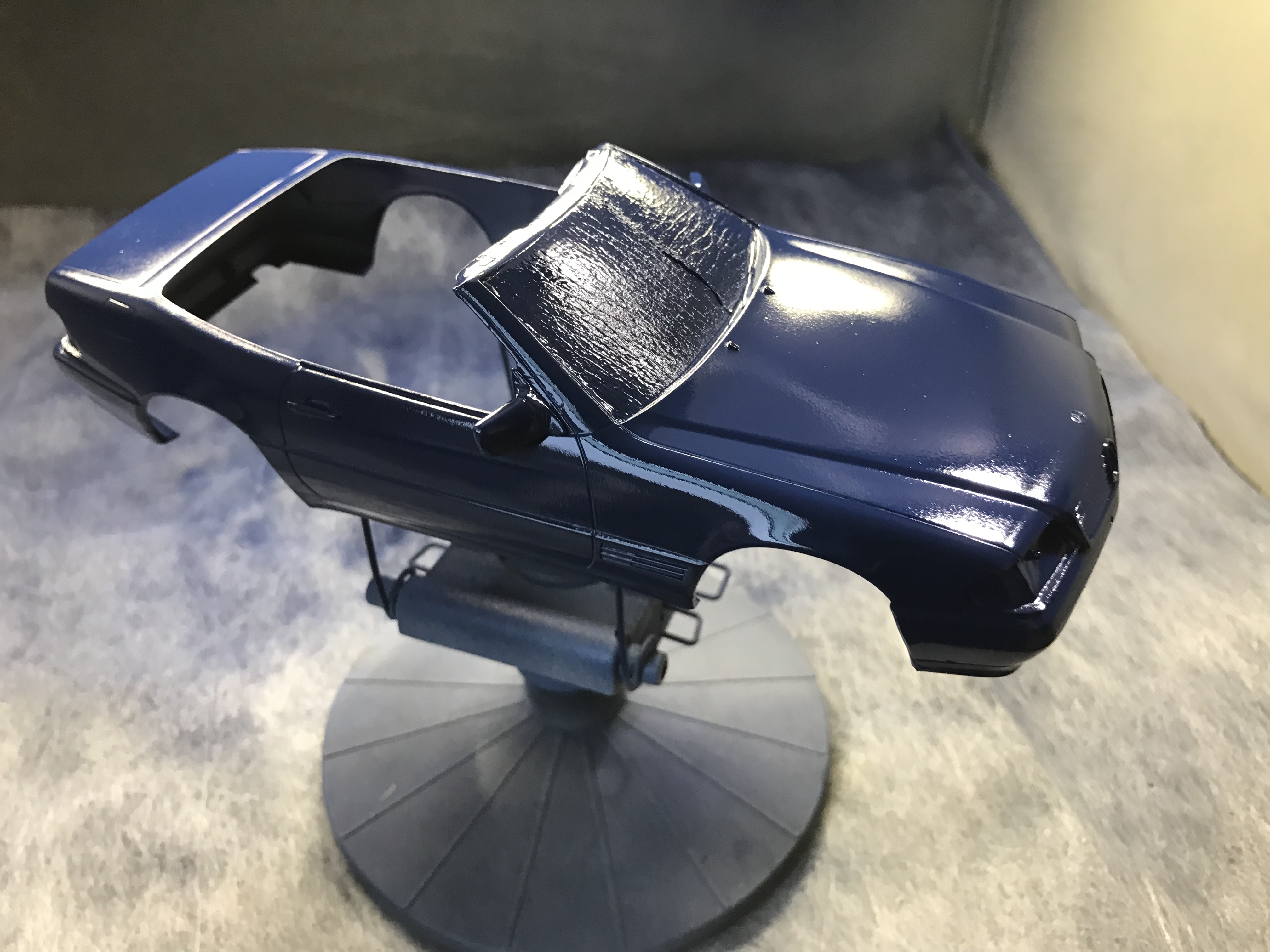

Ich_Will Posted September 1, 2018 Author Posted September 1, 2018 13 hours ago, Oldcarfan27 said: I think MB brake fluid is DOT4 which is synthetic, I don't think it will have any effect on your paint. You'll need to use good old fashioned DOT3 which is organic in nature and will take off paint. Good to know. It took some off but didn’t do a super job. I’ll grab some Dot3 this weekend.
Rider Posted September 1, 2018 Posted September 1, 2018 Sucks when a nice paint job goes bad from a reaction. Good luck with the recovery. Dot3 is all ya need, no need to buy the expensive Dot4, even cheap dollar store stuff works great.
Ich_Will Posted September 1, 2018 Author Posted September 1, 2018 12 minutes ago, Rider said: Sucks when a nice paint job goes bad from a reaction. Good luck with the recovery. Dot3 is all ya need, no need to buy the expensive Dot4, even cheap dollar store stuff works great. I’ll go as cheap as I can. I only used the MB stuff because it was on hand. ?
Rider Posted September 1, 2018 Posted September 1, 2018 3 minutes ago, Ich_Will said: I’ll go as cheap as I can. I only used the MB stuff because it was on hand. ? With the cost of EVERYTHING going up in this hobby I agree, save where and when you can. I buy all my CA from the dollar store too.

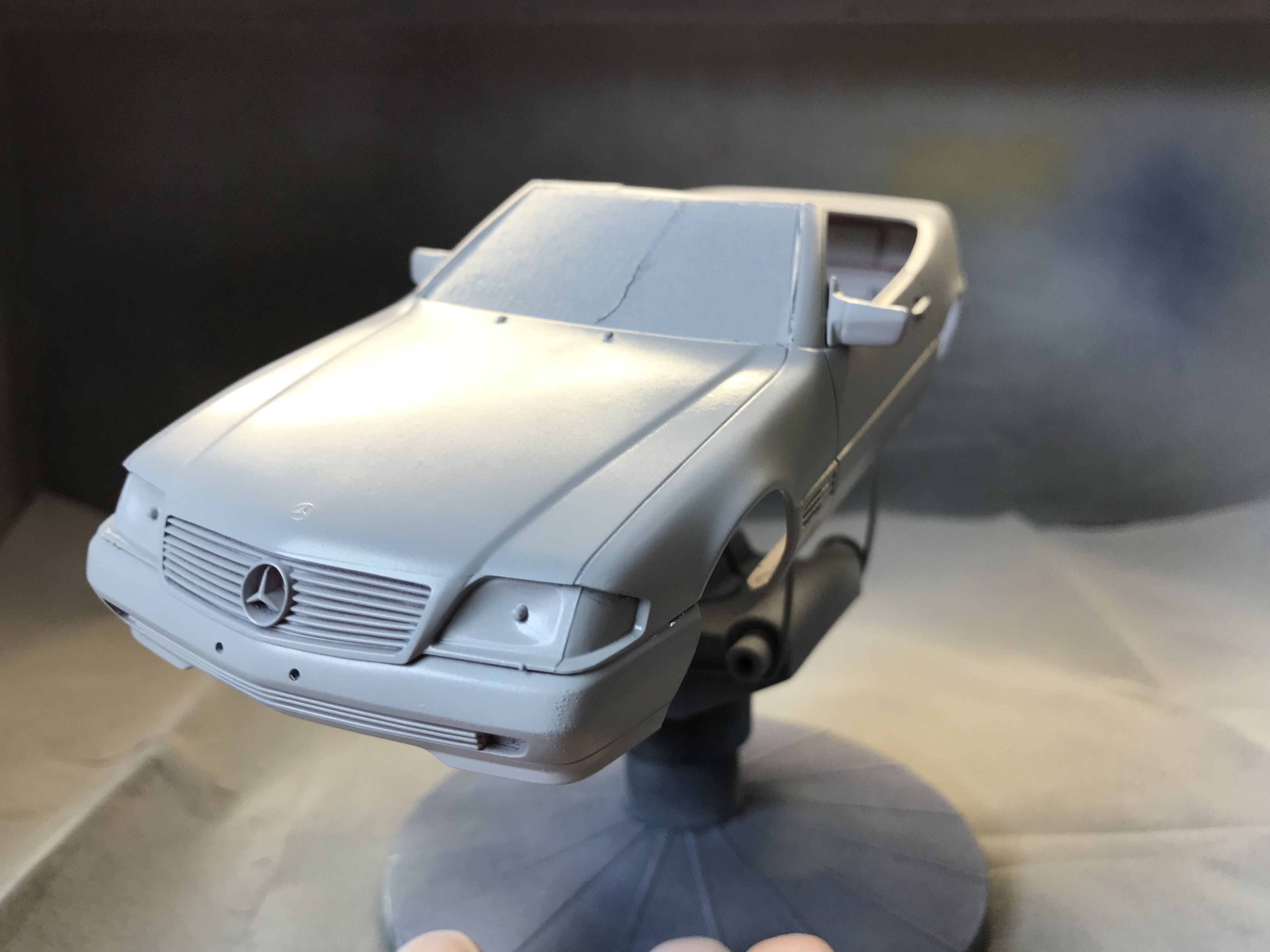

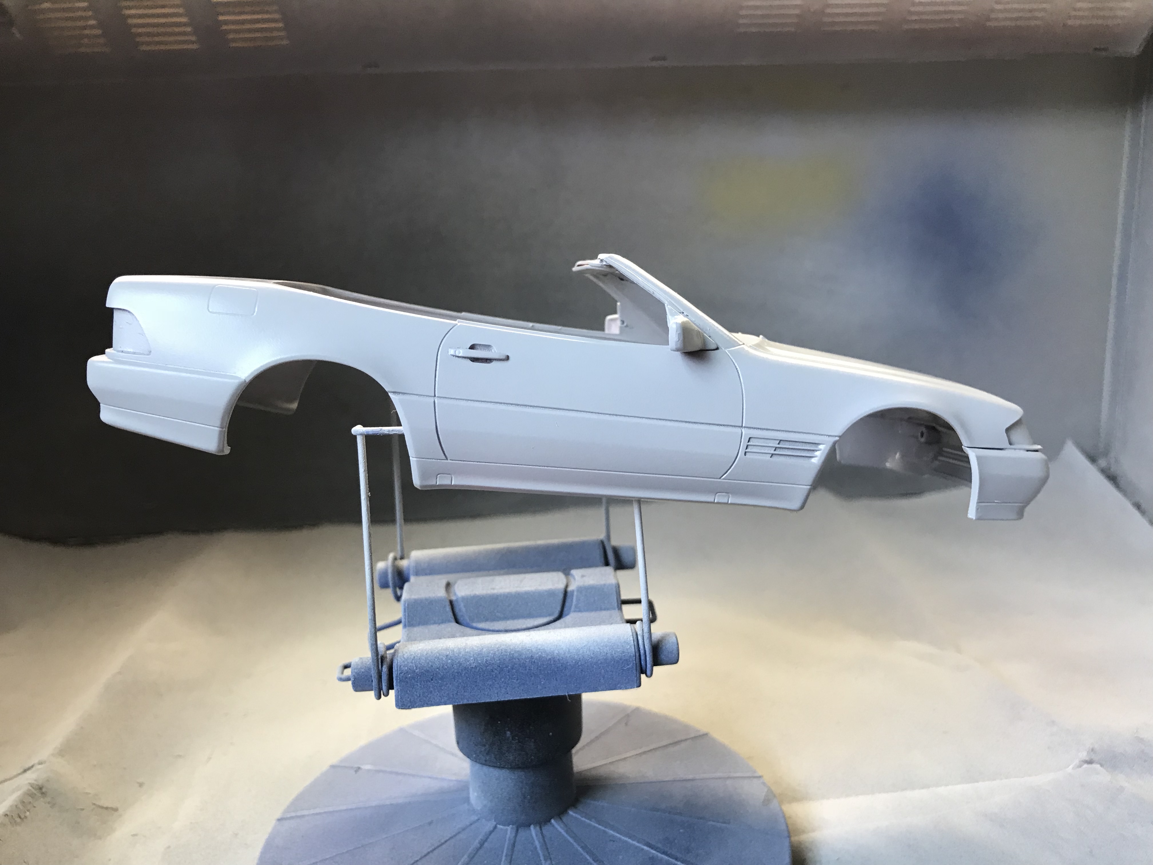

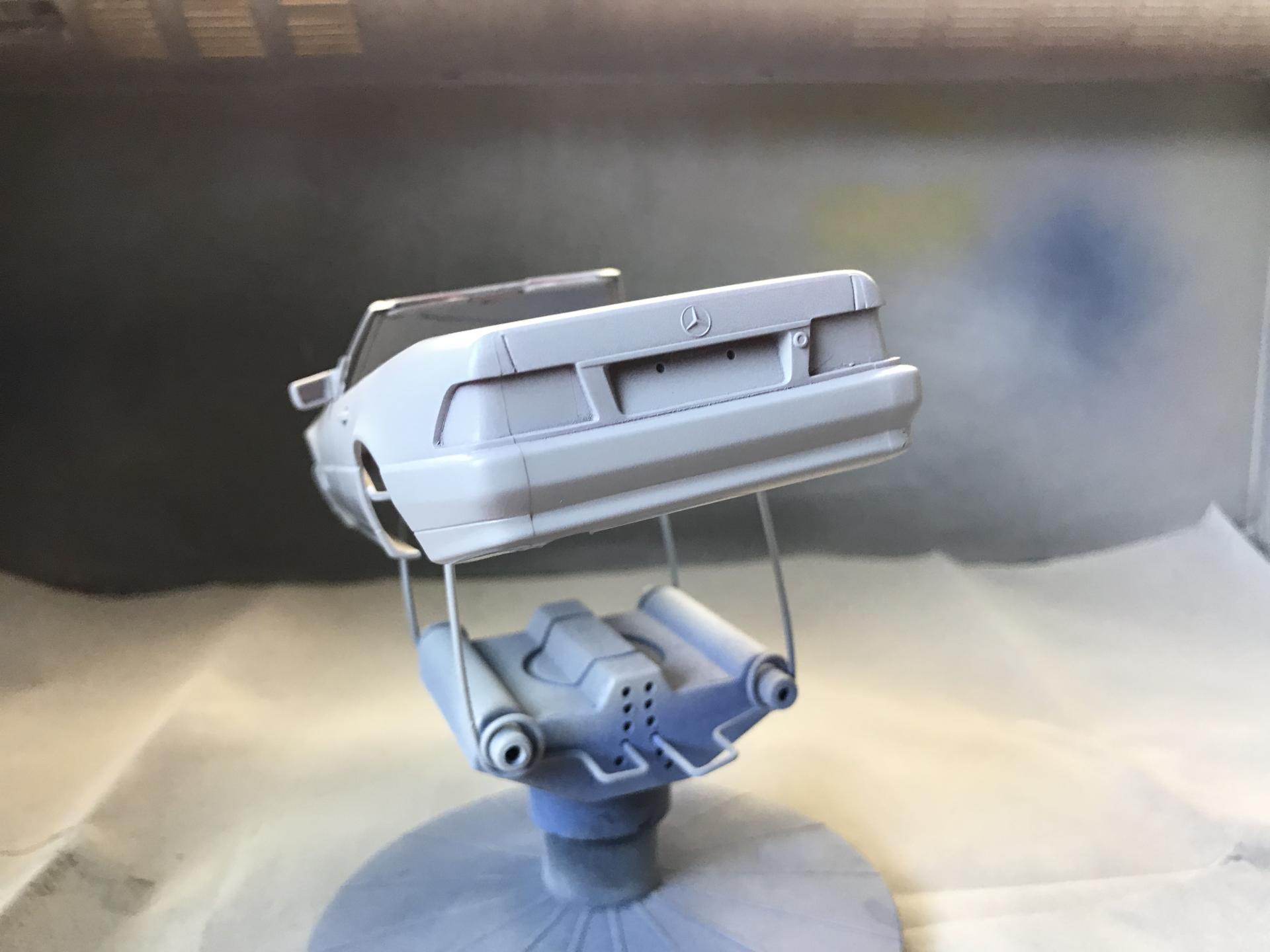

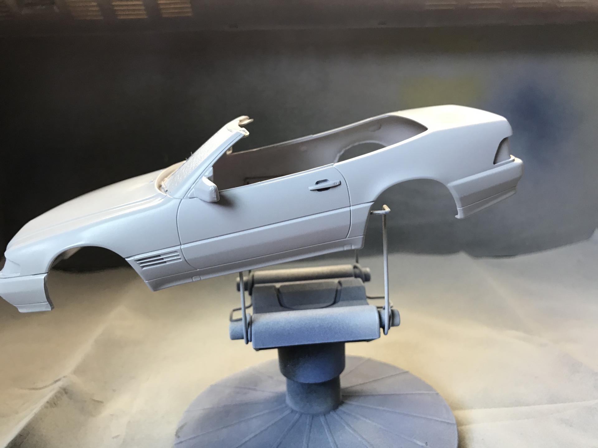

Ich_Will Posted September 3, 2018 Author Posted September 3, 2018 After much work and a bit of creative cursing, we are back to primer. The brake fluid caused cracking in the clear windshield (permanently affixed due to the crushed A pillar from its life in a hobby shop) so it will never be a perfect model.

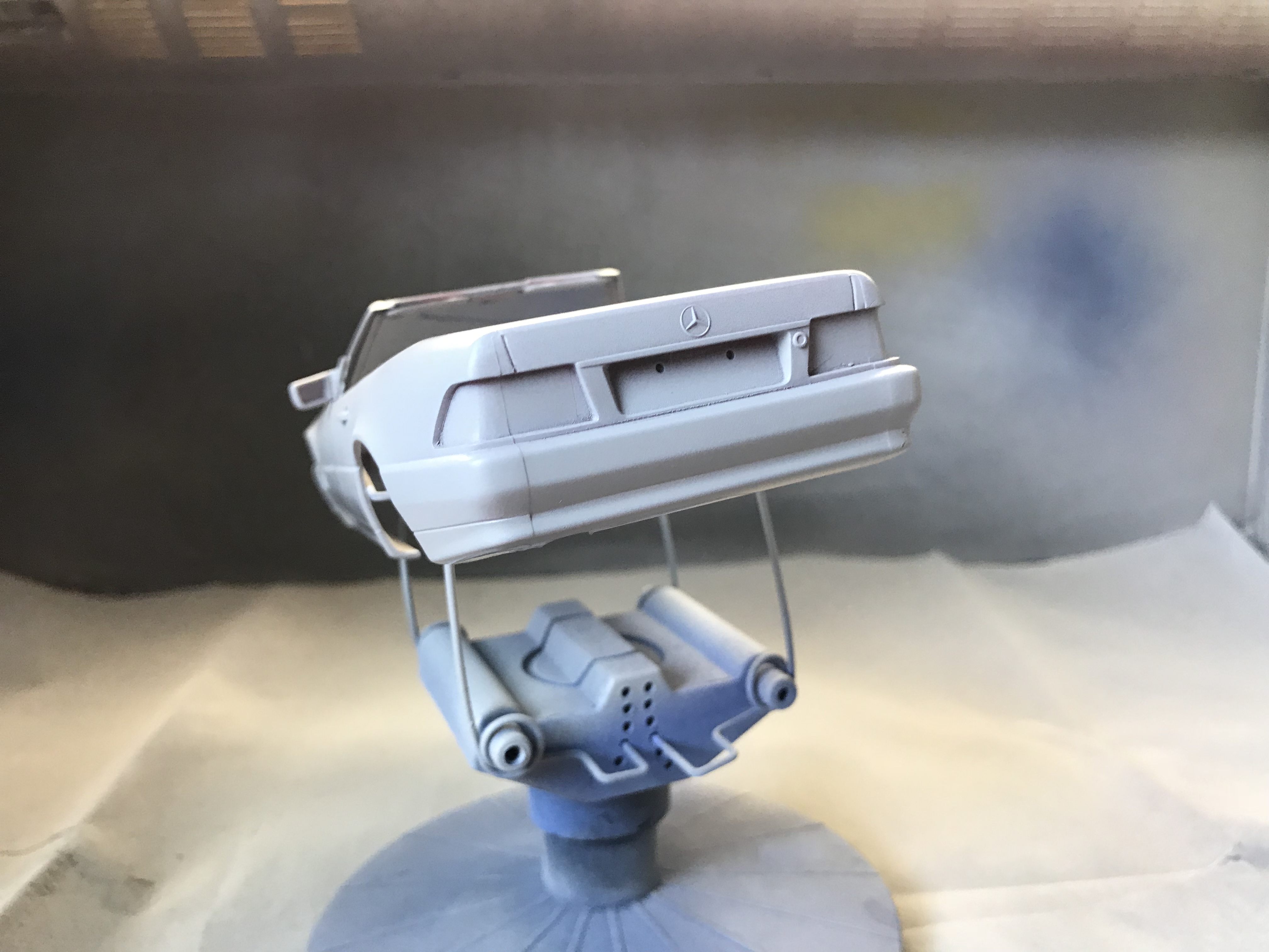

Ich_Will Posted September 4, 2018 Author Posted September 4, 2018 I think this turned out better than the first attempt.
Dann Tier Posted September 4, 2018 Posted September 4, 2018 6 hours ago, Ich_Will said: I think this turned out better than the first attempt. I'm pretty sure I have a windscreen fix for you!!…...I will draw-up a diagram as to how I would fix it ……..I will send it to you tomorrow ASAP!!…..don't get bummed, or give up....I got your back, bud!!

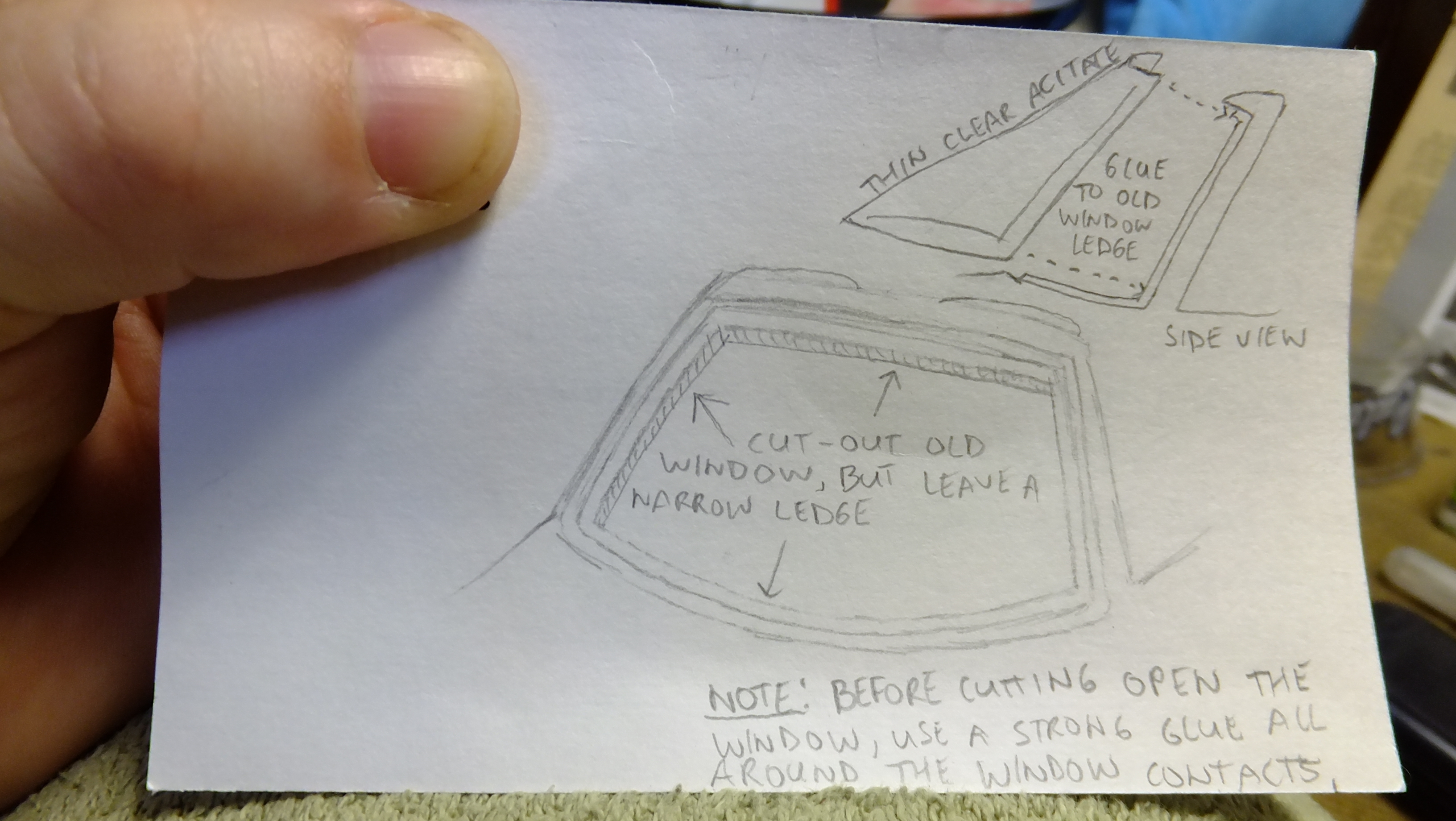

Dann Tier Posted September 4, 2018 Posted September 4, 2018 Hey, bud!, I looked up the instructions for your kit, and heres an idea for you that I came up with. If it were me, this is what i'd try.... you just need some thin clear sheet styrene.
Ich_Will Posted September 4, 2018 Author Posted September 4, 2018 18 minutes ago, Dann Tier said: Hey, bud!, I looked up the instructions for your kit, and heres an idea for you that I came up with. If it were me, this is what i'd try.... you just need some thin clear sheet styrene. Thanks! I'll have a go at this. Nothing ventured, nothing gained, right?
Dann Tier Posted September 4, 2018 Posted September 4, 2018 14 minutes ago, Ich_Will said: Thanks! I'll have a go at this. Nothing ventured, nothing gained, right? That's right, at this point it, its worth a try....
Ich_Will Posted September 15, 2018 Author Posted September 15, 2018 A-pillar snapped while trying to cut out the windshield. Doomed from the get go so I went to the LHS and snagged one in a ratty looking box, had the clerk open it so I could verify condition. Paid less than $20 and we are back in business.

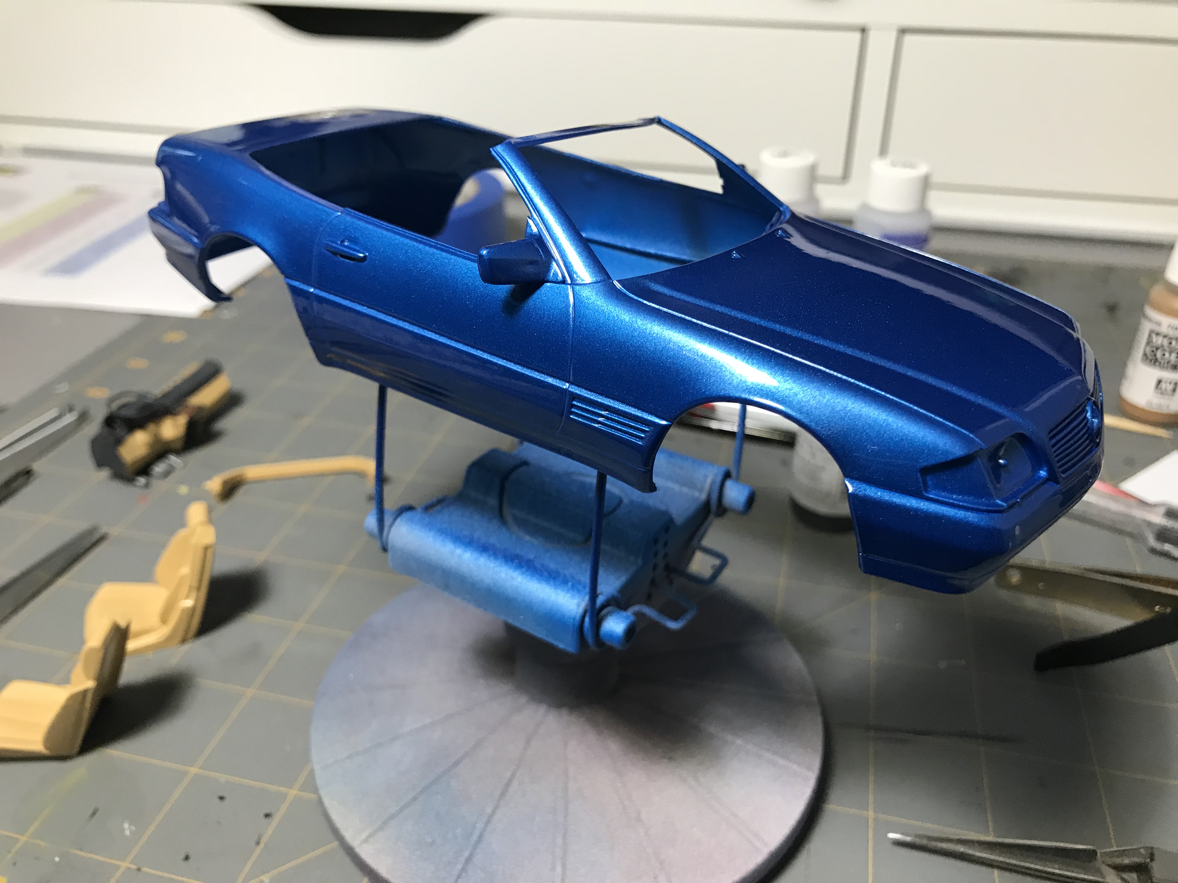

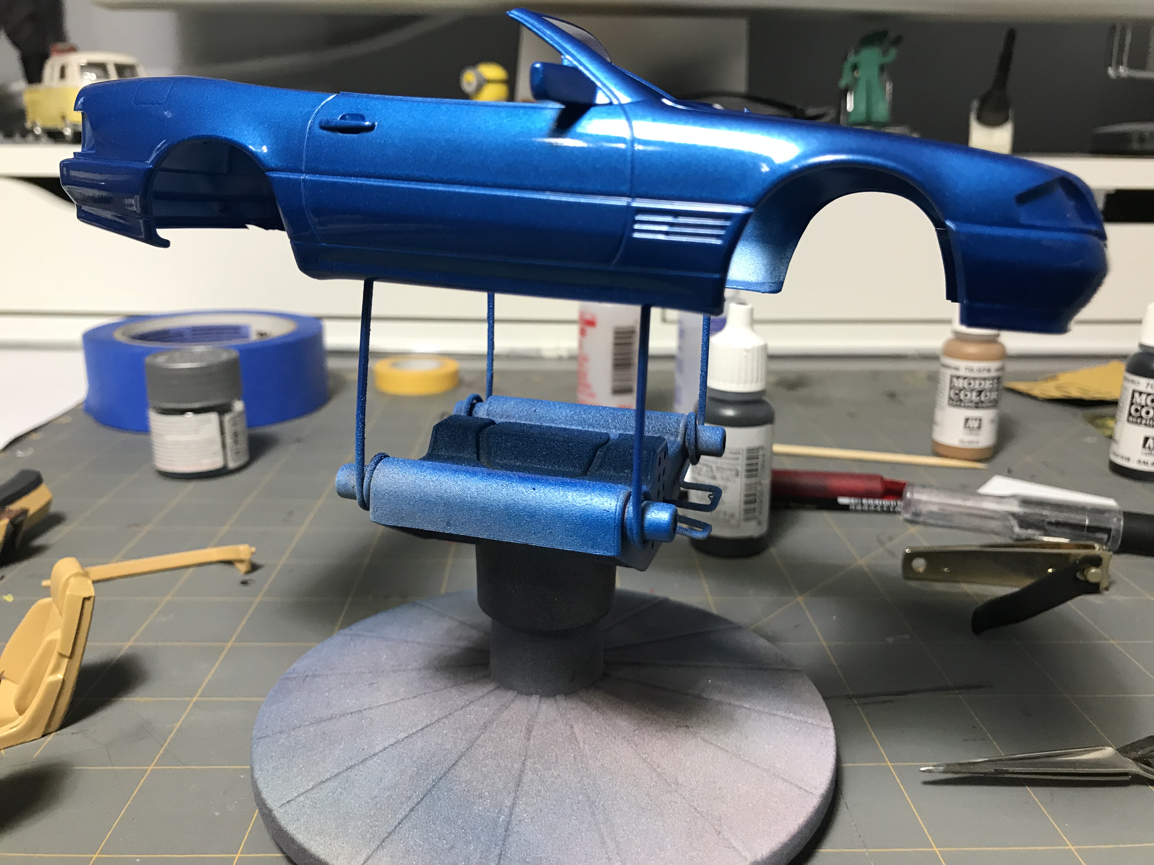

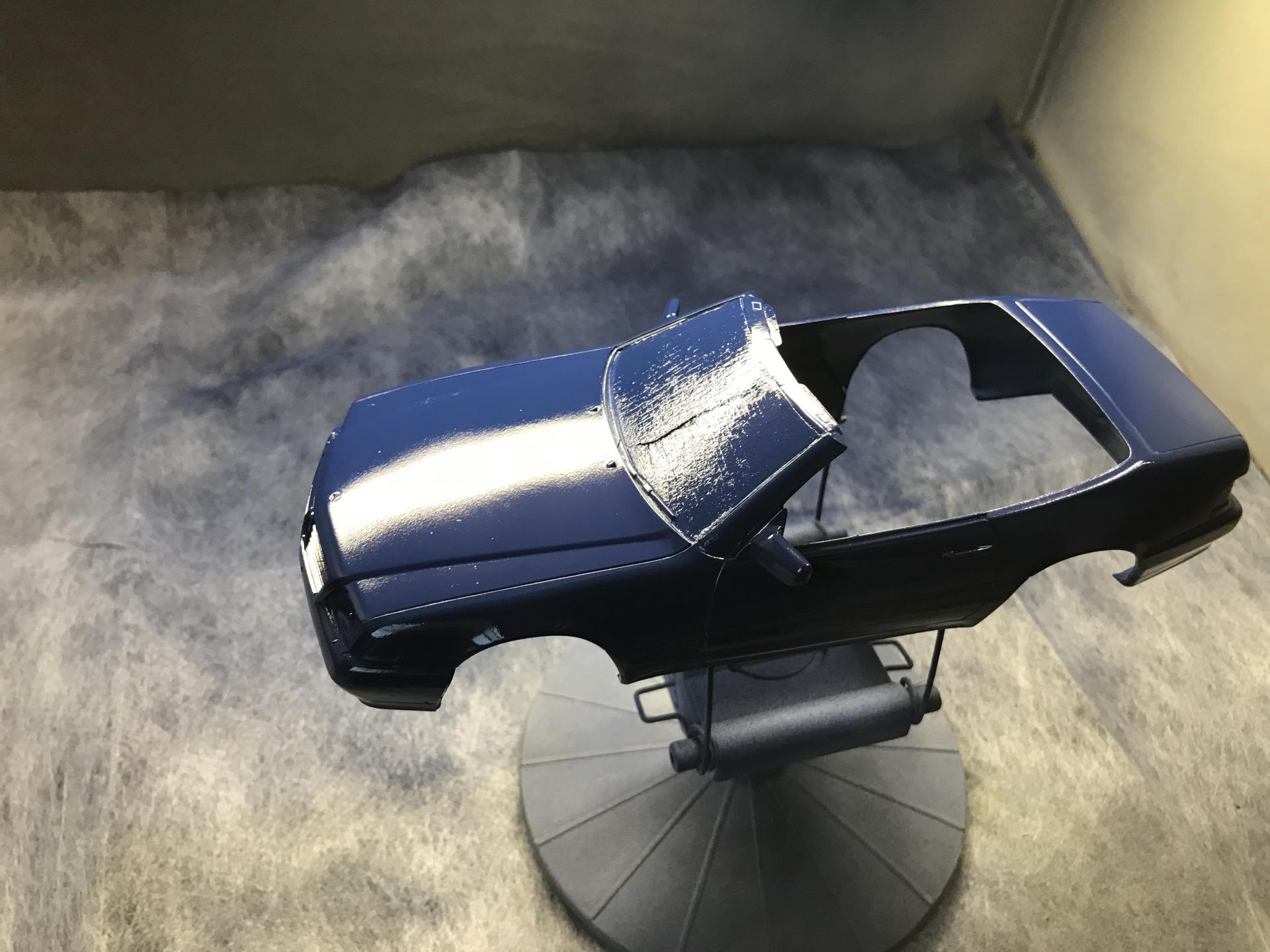

Ich_Will Posted October 13, 2018 Author Posted October 13, 2018 Well, I know we’ve been here before and I feel like I may jinx it by posting a picture of the body color... but here she is.
Rider Posted October 13, 2018 Posted October 13, 2018 That colour blue is really sharp, and the paint looks like it turned out great.
Ich_Will Posted October 14, 2018 Author Posted October 14, 2018 16 hours ago, kelson said: Wow!,that is a gorgeous color!! 15 hours ago, Rider said: That colour blue is really sharp, and the paint looks like it turned out great. Thanks guys. The color turned out just as I had hoped and there’s no dust/particulates in it. The photos really don’t capture the hue properly. It’s a bit lighter in person
