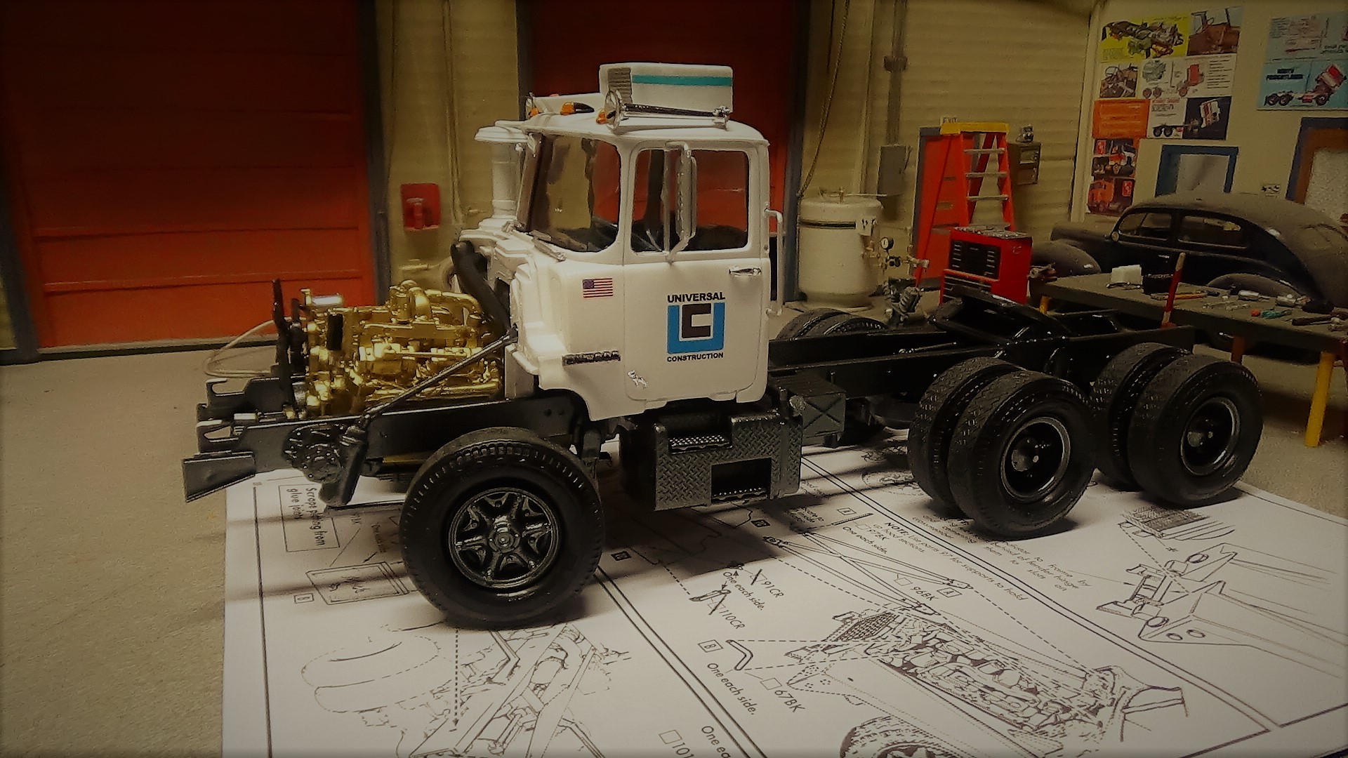

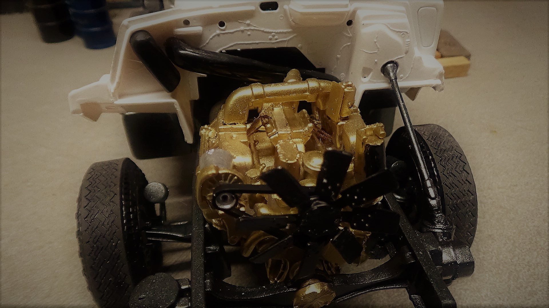

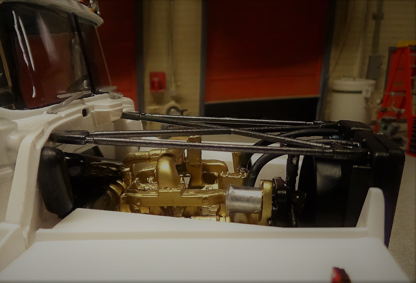

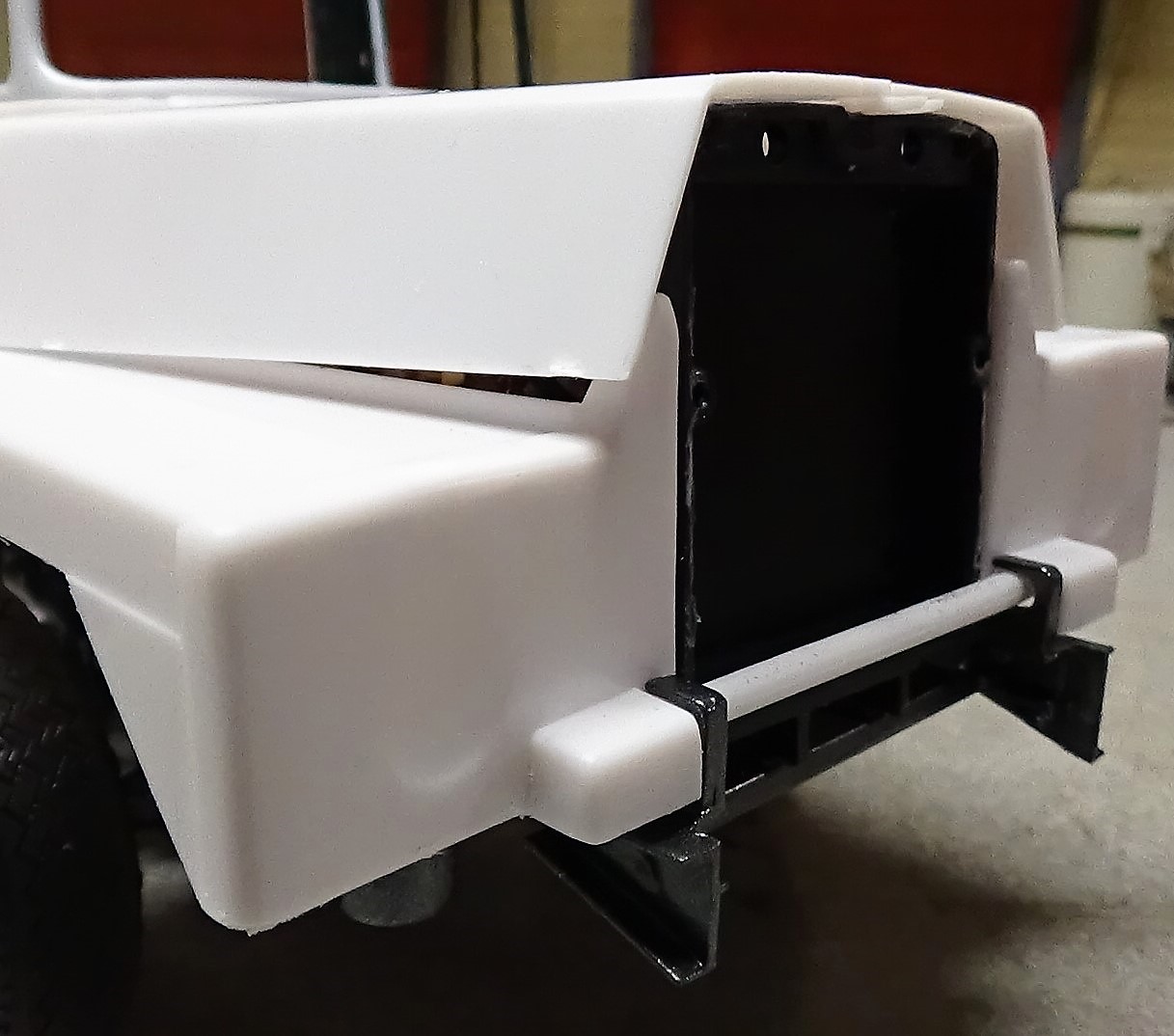

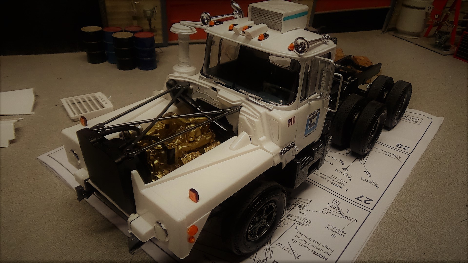

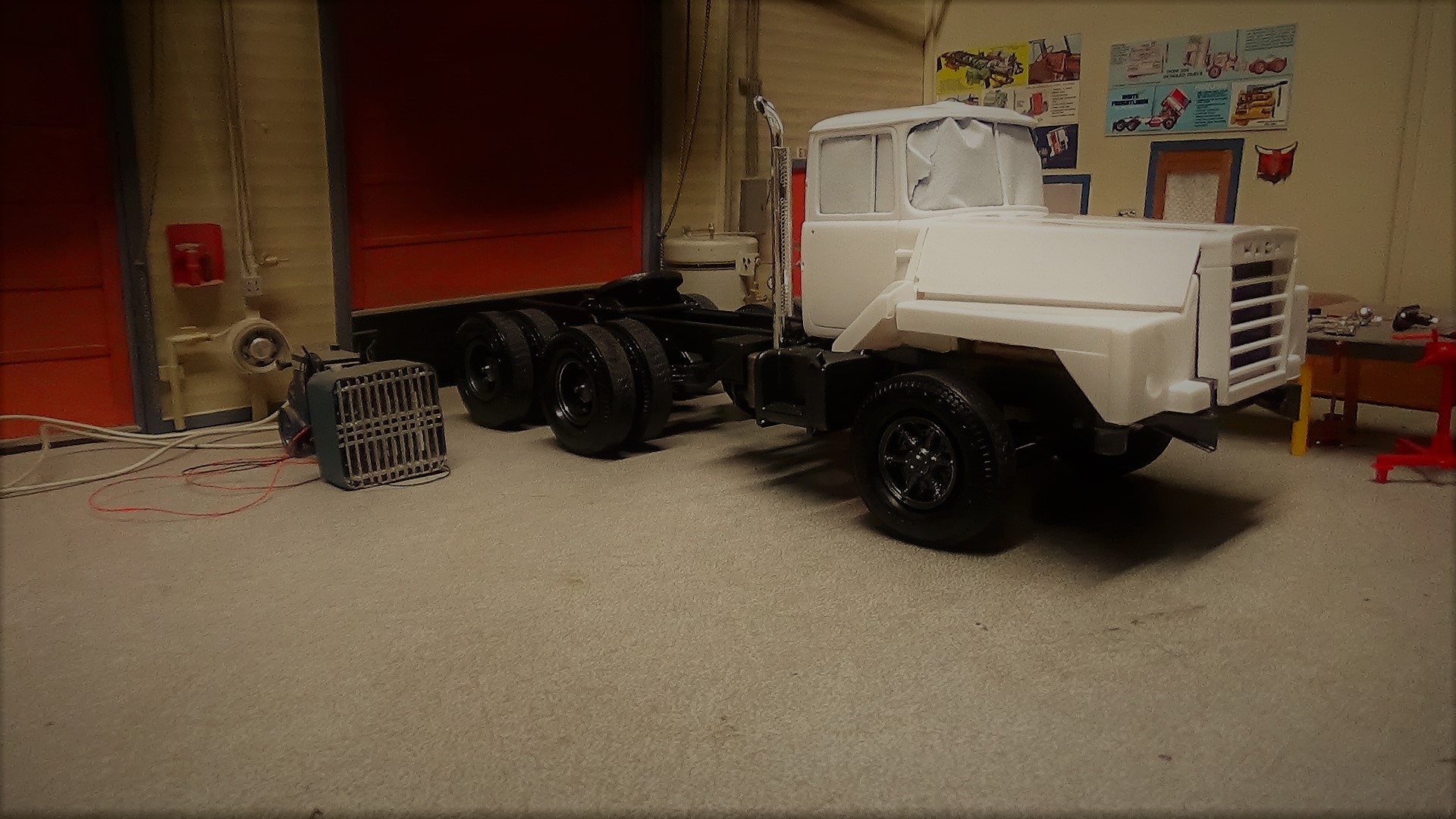

no problem Dan. the radiator supports are too high making the hood run uphill to the grille as seen in the profile picture. so I trimmed them off lowering the radiator shroud, also had to trim the bottom of the radiator and grill to get everything level. now everything lines up except the right fender joint. fenders about ready for paint.
Nice progress Ken!
I had a similar problem with the right filler on the U model that I'm building. I finally sanded off the MPC factory tabs and lined it up with the fender. Even though the fender of the hood hides it on the U it was causing hood alignment problems for me. Anyway I hope that I got it fixed.
Looks Great!!

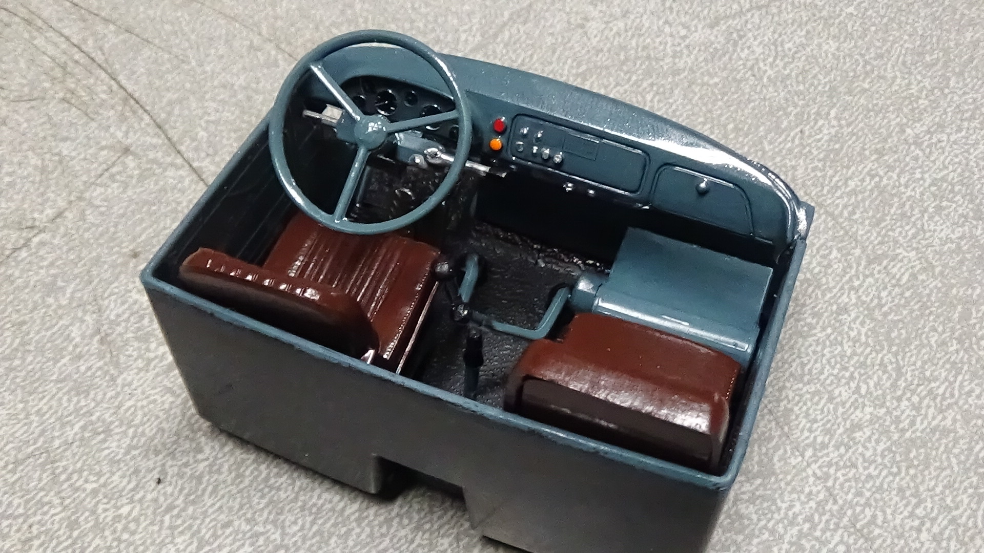

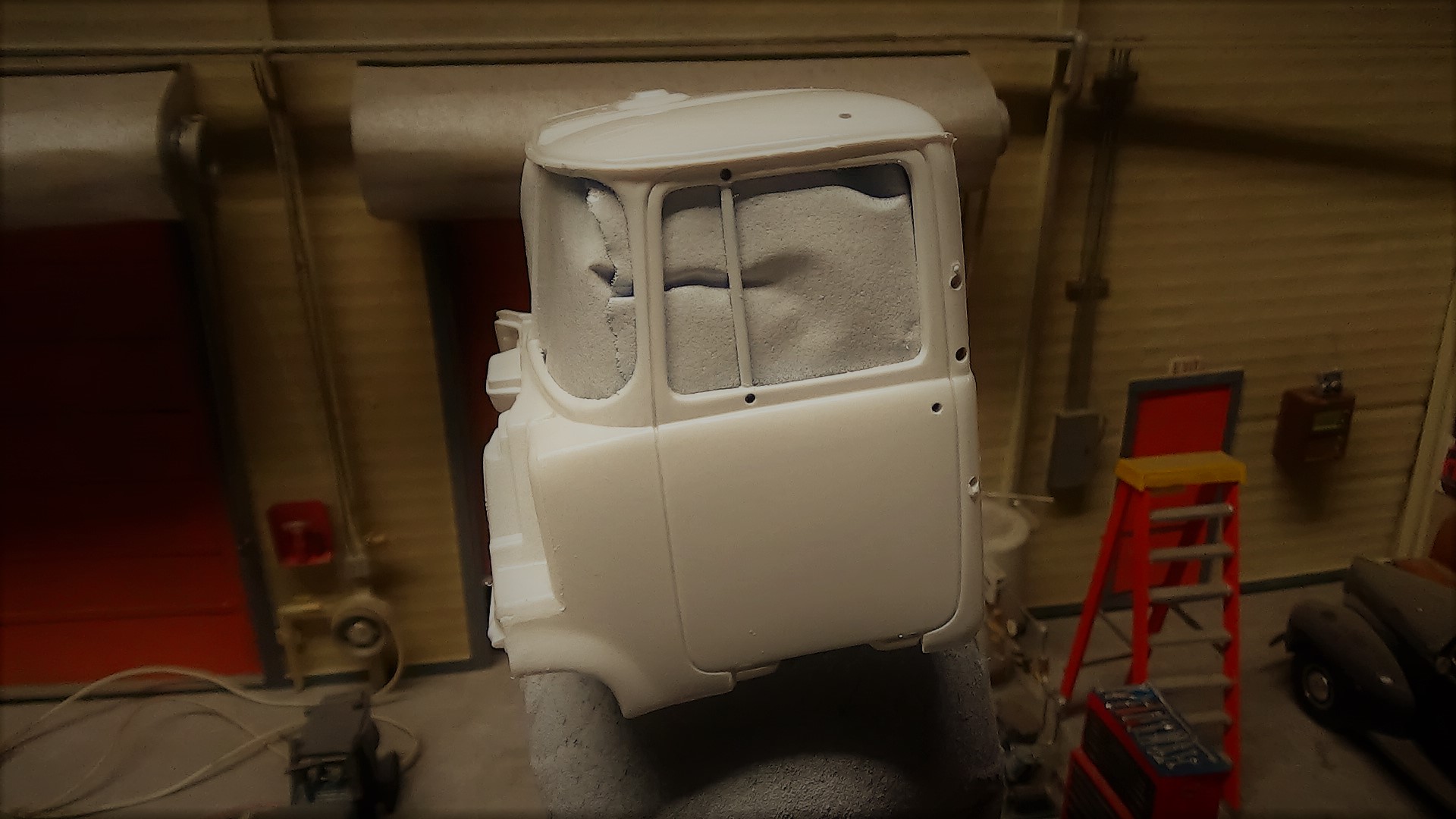

had a good day. got the window glass put in, installed the interior, mounted the cab and hooked up the intake piping and steering linkage. blinged the door handles, painted the heat shield.

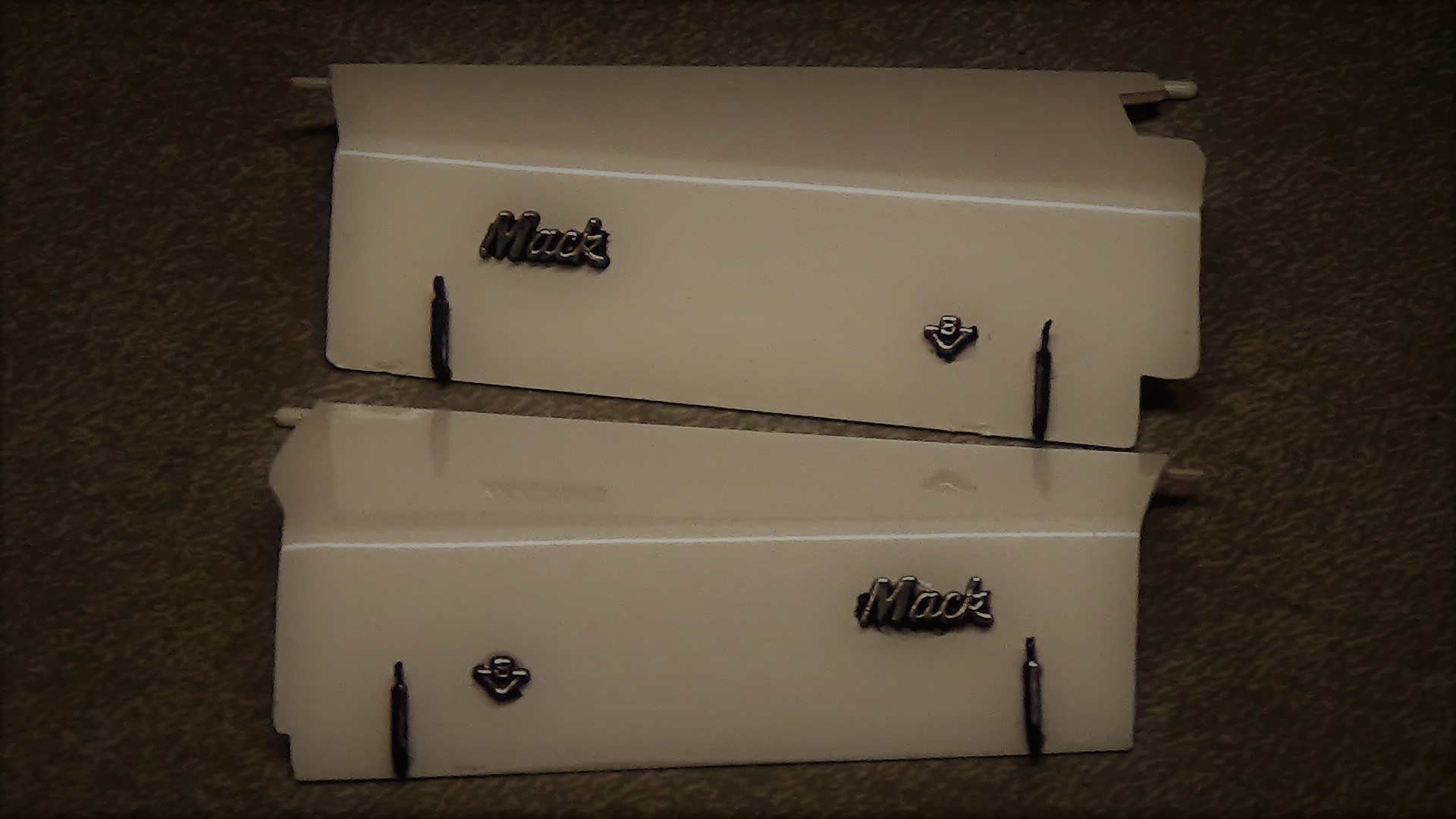

This is looking real good Ken!  I came across a DM800 build on another forum and the builder cut the plastic tube connecting the fenders down the middle. He then sleeved a piece of thin aluminum tube over the 2 halves before attaching them to the frame, allowing the fenders to swing up independently of each other which I thought was a good idea. Just trying to gather info on all of the corrections and modifications I will need to do before I start building mine.
that's a great idea Jim as the grill is wider than the fender opening. I did get the air cleaner mounted and trimmed the roof with painted lights and horns. the decals are from the chevy crew chief kit.
Thanks Dan, I got the hood and grill lined up and mounted. I forgot to mention I ground the tabs off the frame that the interior tub is designed to sit on. the cab is sitting on the front and rear cab mounts, the tabs raised the cab throwing the fender alignment off.

One observation. If you look at the center bottom of the dash you will see a small cutout,  that is the location for the heater box as opposed to the floor in front of the passenger seat. The box is glued to the front interior wall and the bottom of the dash.
