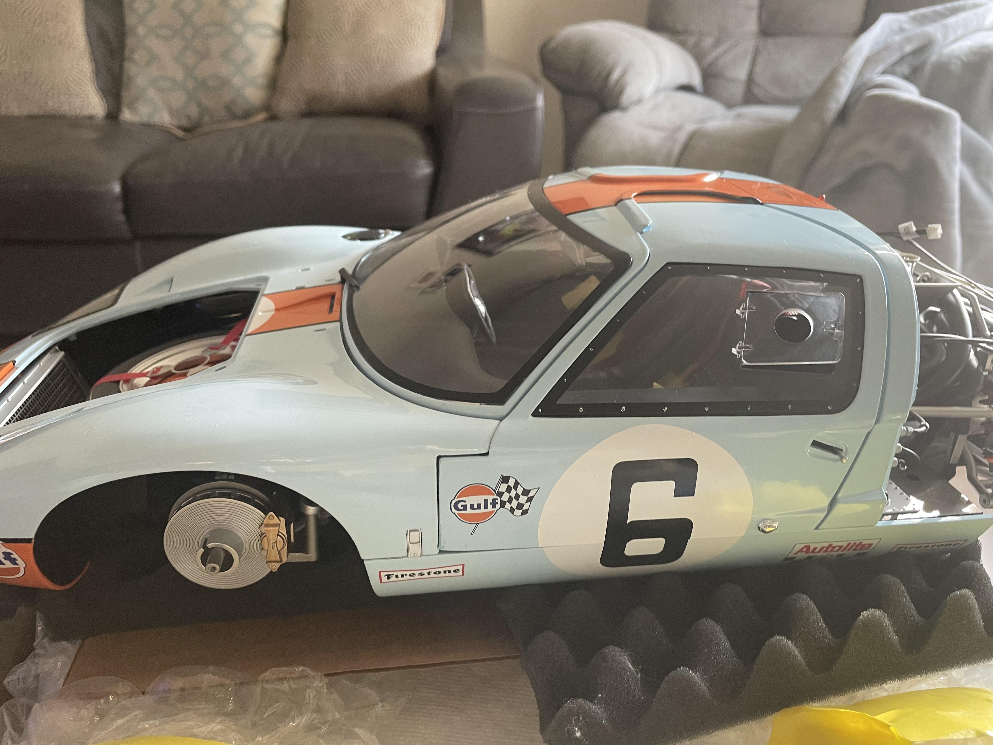

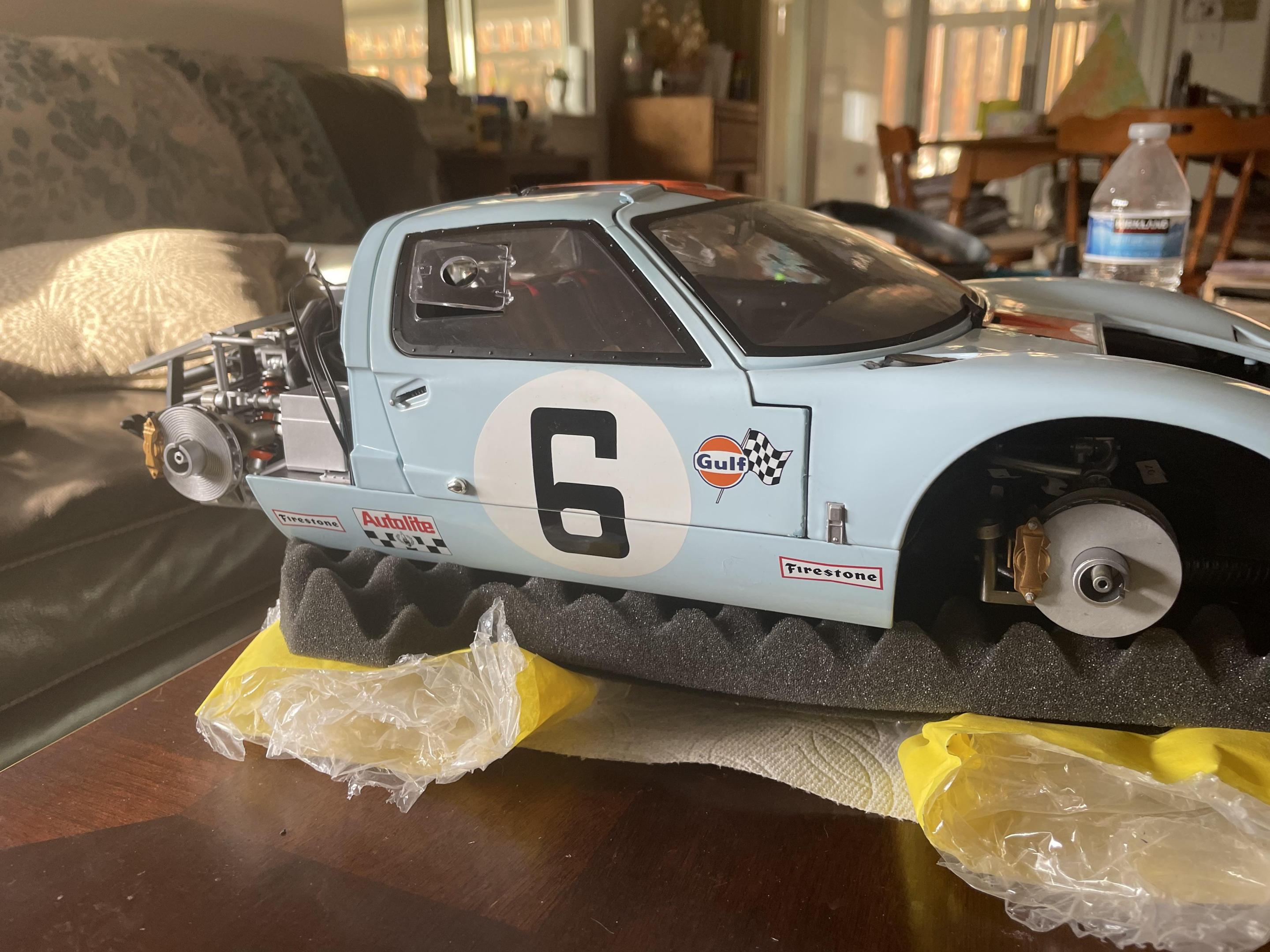

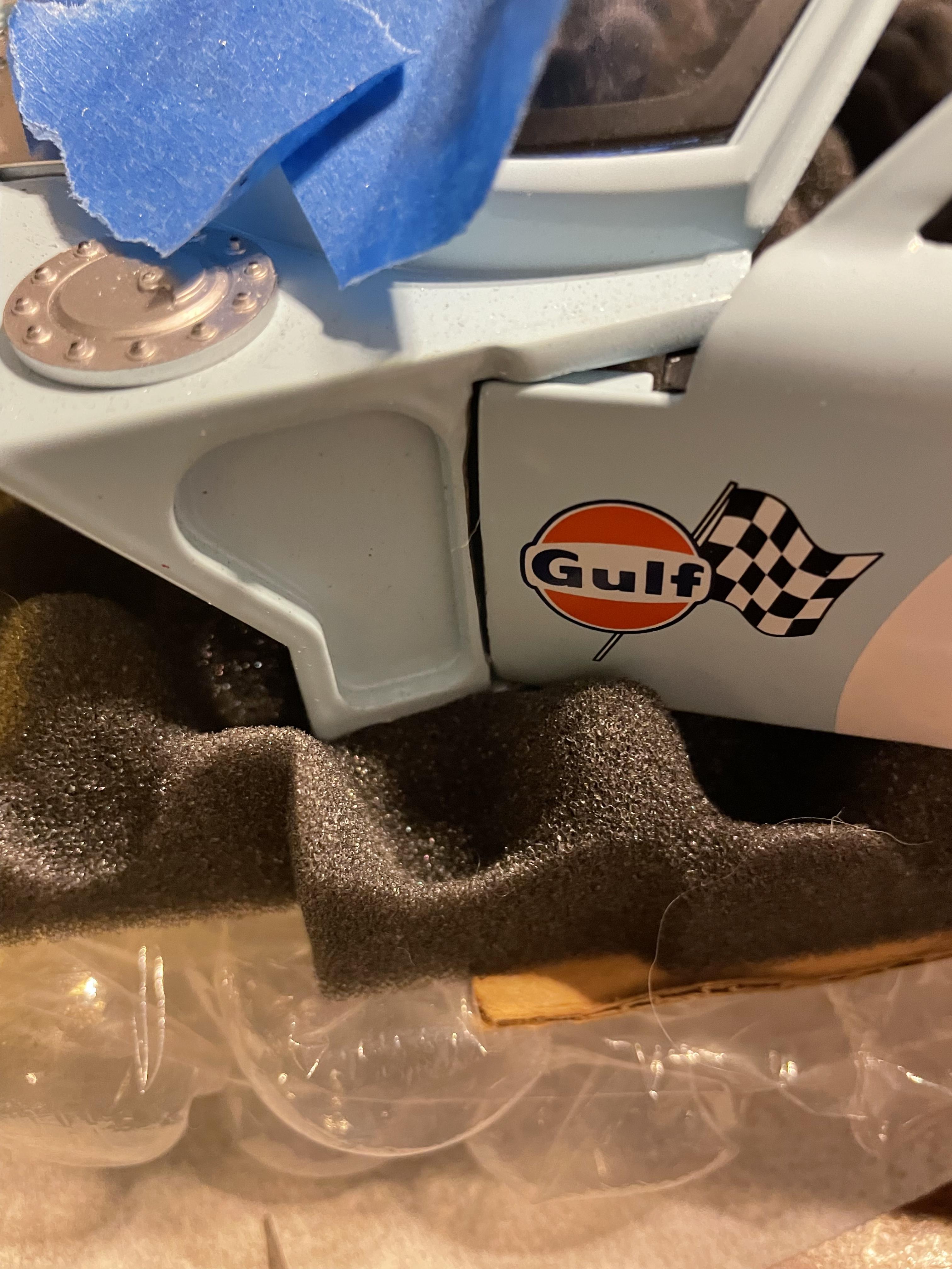

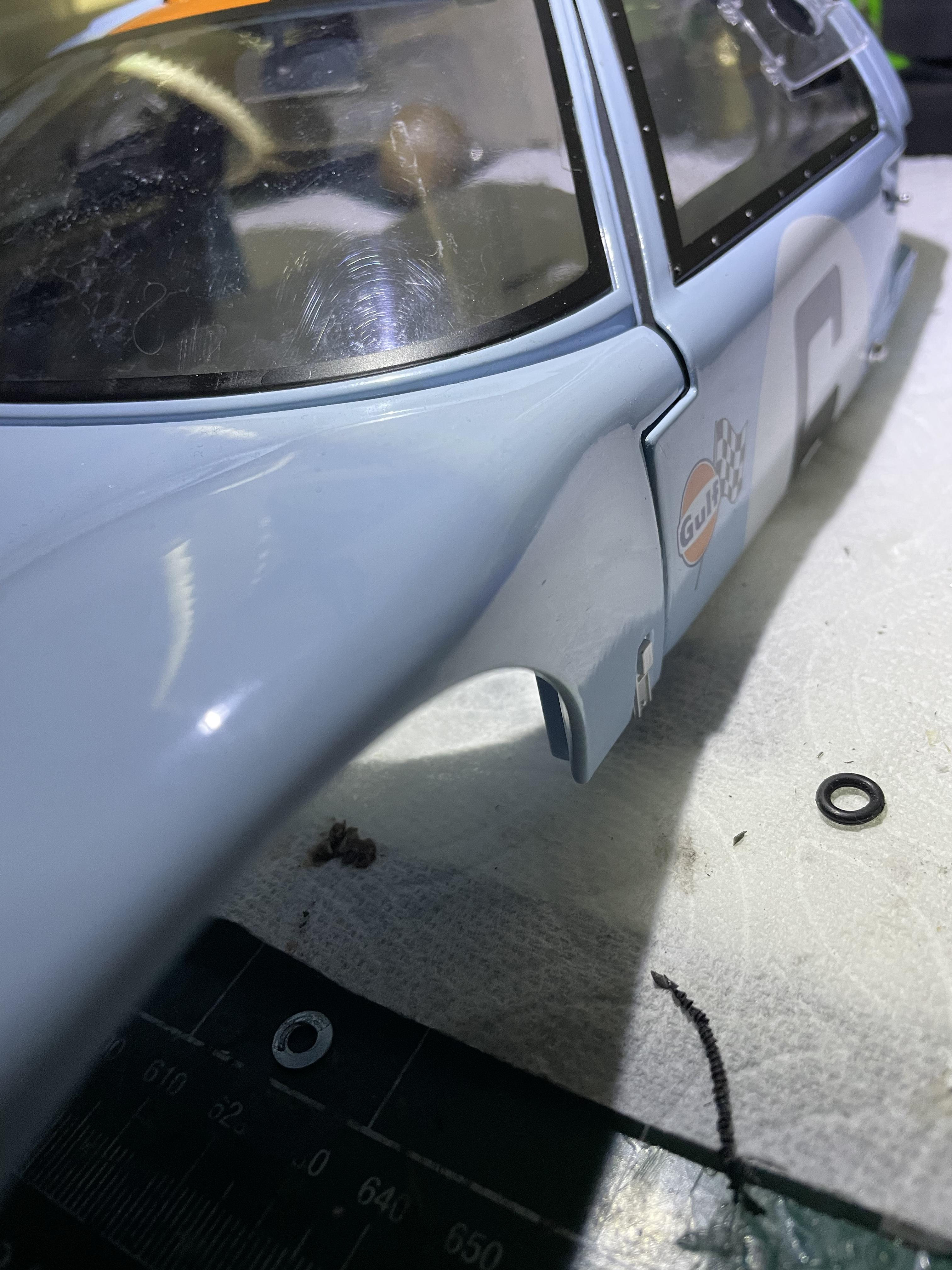

Bill , I am on the ford GT. The doors are a pain. I have been on them for three hours and still not even close. Chipped paint on the edges. Making major mods to get them to fit. Let you know how it turns out. Horrible fit. Had to even cut some of the a pillar away. Very frustrating. Doors will not even close. Putting it away tonight before it becomes a airplane.

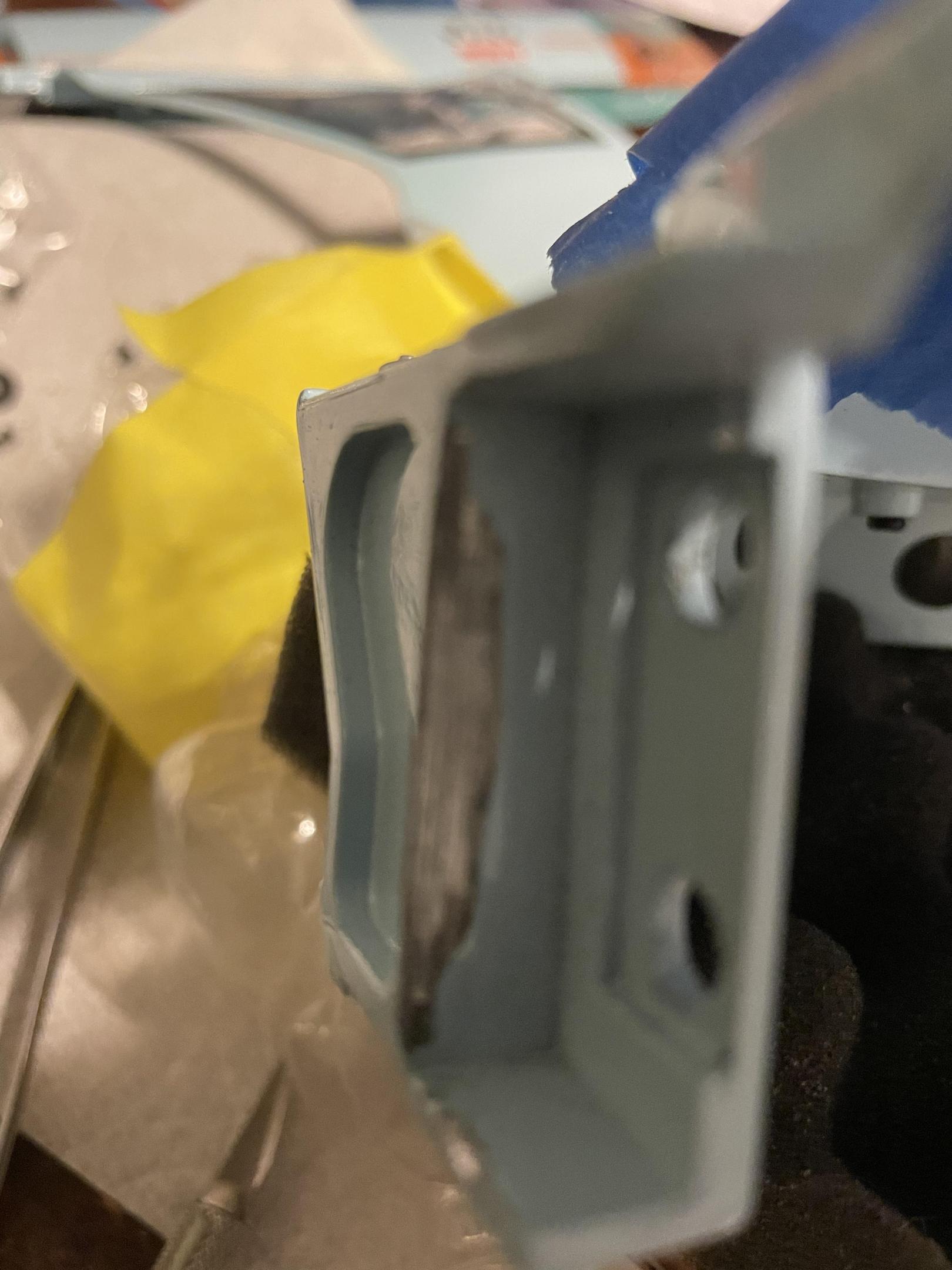

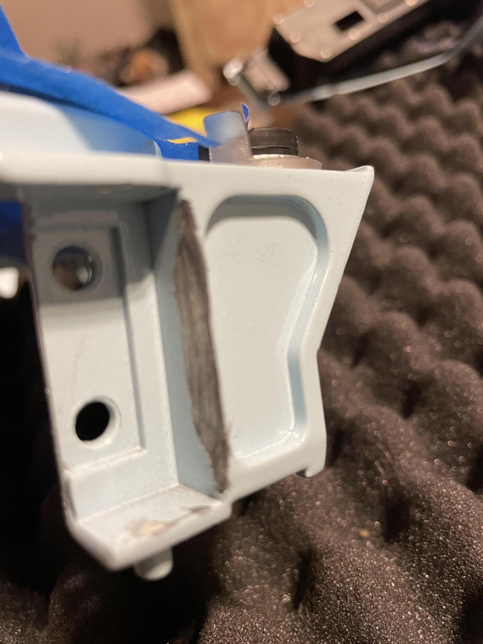

A little better this morning. Not a great fit but ok. The doors are a problem. Like the GT 500 , not the best but ok. I received packs 20, 22 and 24. Did not need 20 , waiting for 23. I guess I’m spoiled on these kits, things should fit but sometimes they do not. . Added some thin shims to the doors. Drilled out the holes to the doors, 7/32 drill bit. Have to be careful as the drill will flip the part out of your hands. Hope yours is not as dramatic.

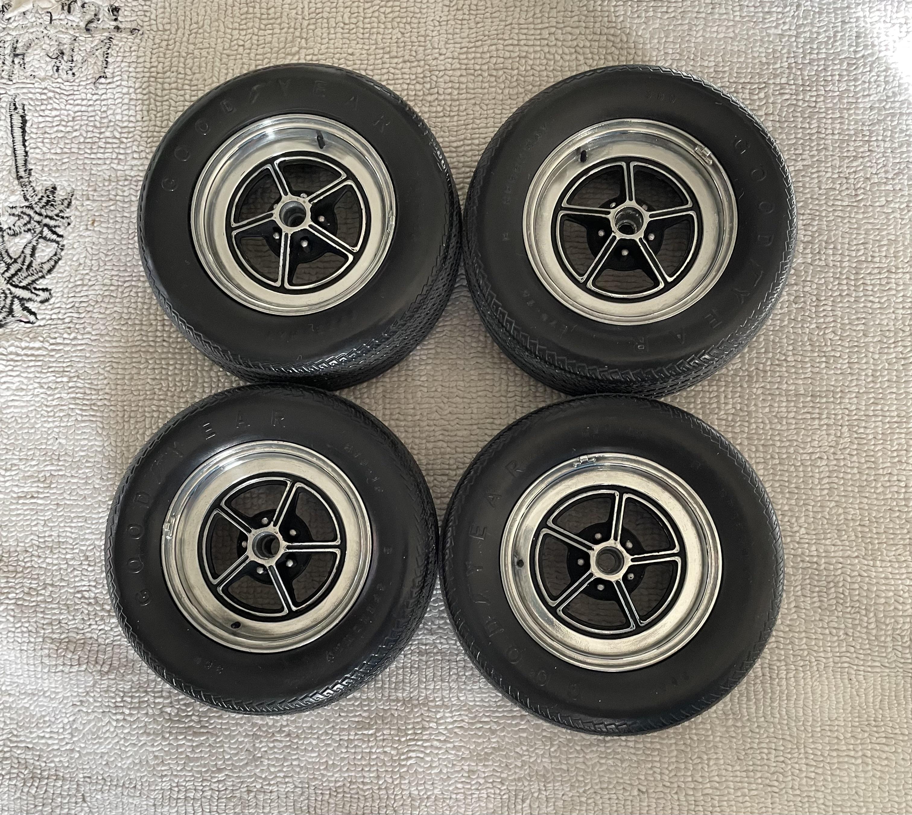

Yes sir! I used a dremel that has a variable speed. Put it on the lowest setting and it worked . I stripped the wheels with automotive stripper, sanded with 2000,  3000 then used the dremel. Painted the black and painted the lug nuts. Thank you for the directions. They came out nice. Before and after.
