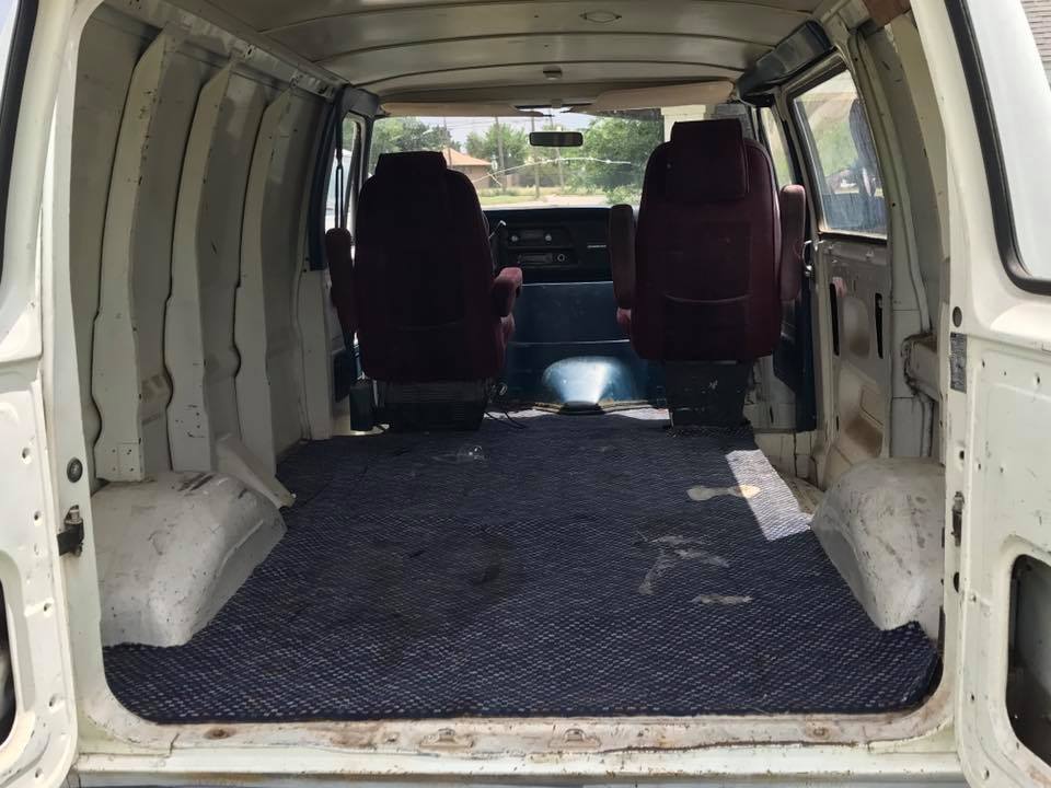

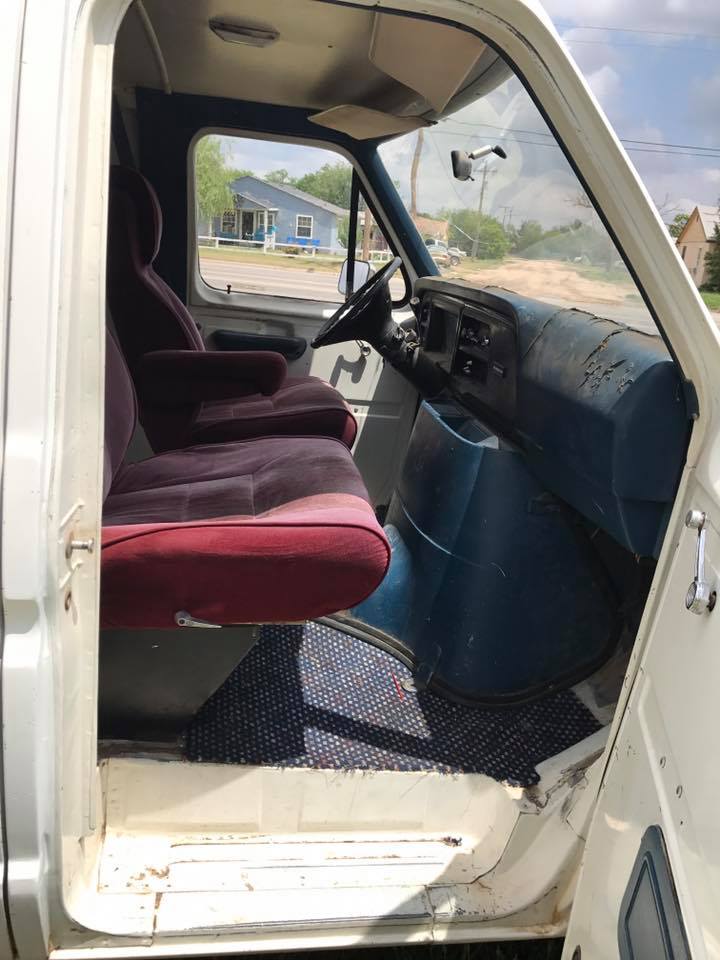

I'm currently finishing an AMT Ford Econoline van.  The only thing I haven't worked out is the interior rear view mirror.  On the real Econoline van the interior rear view mirror is mounted on the inside of the windshield.
Has anyone mounted a mirror on a windshield in a model car/van?  If so what type of glue works best?  Any pictures?
