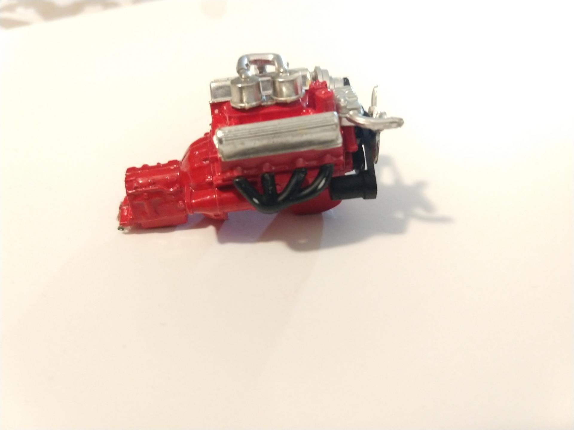

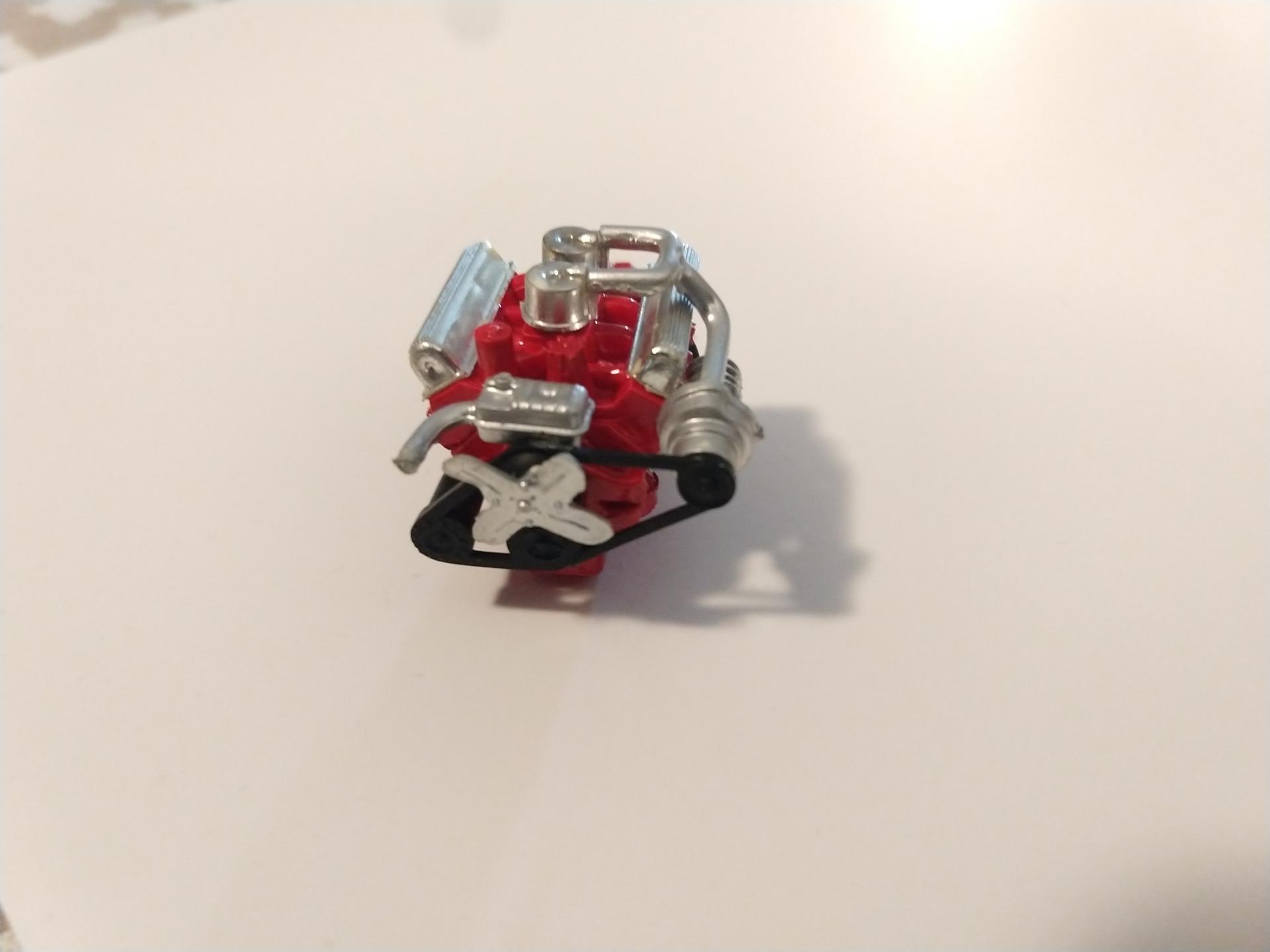

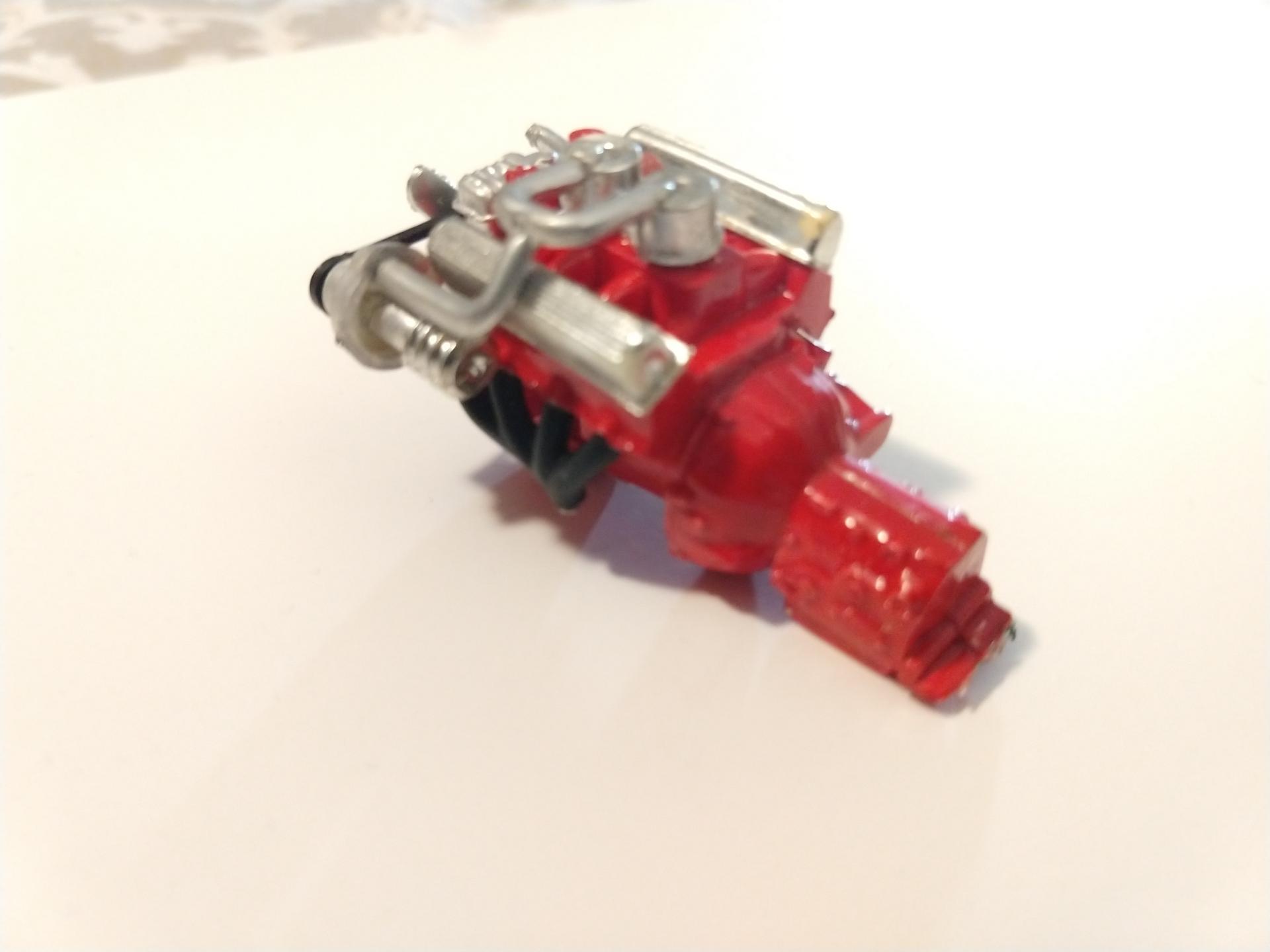

Perspect Scale Modelworks Posted March 13, 2019 Posted March 13, 2019 This is the engine that was in a built 1961 Mercury Monterey I bought on the bay. In all of my research I have not seen an air cleaner/carb set up like this. I'd like to convert the engine to a Ford 352 as found in the '61 Monterey. Is there a readily available kit that includes a nice example of a 352 or any suggestions on how to convert this engine? Thanks
Perspect Scale Modelworks Posted March 13, 2019 Author Posted March 13, 2019 This is what I'm looking to do:
Fat Brian Posted March 13, 2019 Posted March 13, 2019 That is an old centrifugal supercharger setup. The AMT 60 Starliner has the best early FE out there.
Perspect Scale Modelworks Posted March 13, 2019 Author Posted March 13, 2019 Thanks Brian. Looks like I may be able to use the chassis as well.
Force Posted March 13, 2019 Posted March 13, 2019 The chassis from the '60 Starliner should work fine with some modifications. The standard engine in the Starliner is supposed to be a 352 High Performance so it doesn't have the air cleaner in your picture as the HP engines had open element air cleaners, and the exhaust manifolds are also different as they have individual runners. But the air cleaner can be found in the '58 Edsel kit wich also has a nice FE (unfortunately a bit under scale), the '66 Thunderbird also has this air cleaner and I looked in the '62 Thunderbird kit wich also has a nice FE and the air cleaner is similar but wider and more low profile to clear the hood, it has the standard non HP exhaust manifolds tho'. As Brian says, the engine in the '60 Starliner kit is the best early FE out there and if you have the 2 'N 1 kit you get parts to do most of the FE versions that was available up to the mid 60's...except for the mentioned air cleaner and exhaus manifolds.
