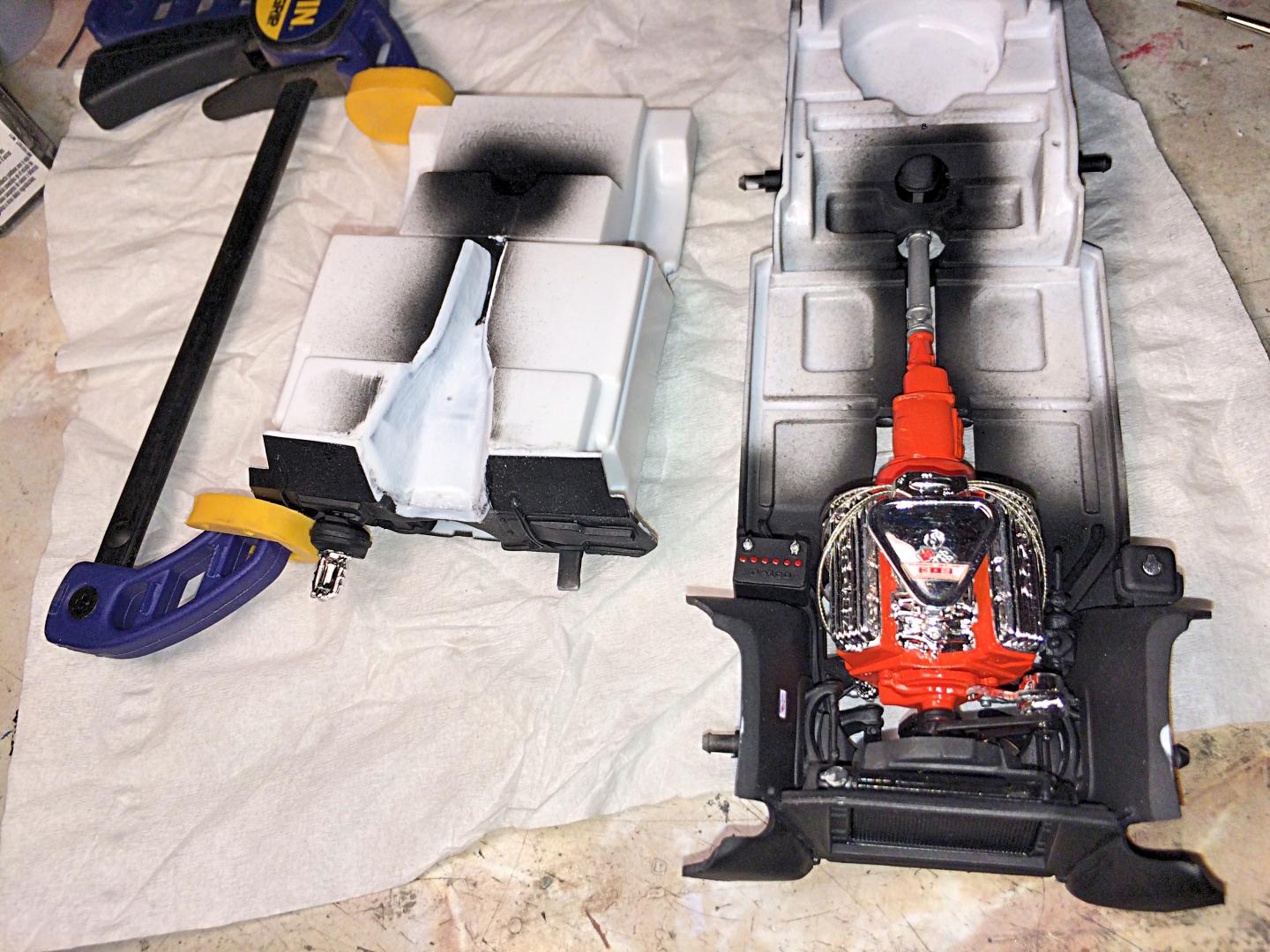

Built this as a gift for a friend, whose daughter is in the Naval Academy.  They love Corvettes, I asked what her favorite color is, so tried to match it.  It was a free kit, was brush painted, and no engine.  I had an engine from a '39 Chevy model done last century.
I didn't know the engine was 1/24 scale, until it wasn't fitting!  Had to thin out the tunnel until it was paper thin.  So I guess it's a 507.  LOL

Can I ask a question?  I have built this car and the 65 Corvette as well.  And I never could figure out how to install the radiator.  I tried several different ways and strategies and I just couldn't get it in there.  Can you tell me your secret on how you did this?  I this same kit in my collection and as soon as I know I want to build it.

LOL  That's why I add such details, to drive some people nuts.  :P  Thanks!
I don't recall the radiator being a problem (using vague memory).  Think the tilt is important, when you glue in, set the top towards the rear so it clears the body.  Scrape any mold lines along the bottom (I do every mold line) so it sets down too.  It goes in after the engine is installed.  A general rule of thumb, scrape all mold lines, especially older Revell and AMT kits.  I think there are no positive glue points when mating the chassis to the body, that is another issue I had with this project, think you need to add a perch in the trunk.  You can see in the picture, I had a major issue, solved with the trusty Dremel.
Thanks for the answer and for the picture!  I see exactly what I did different.  And you'll probably chuckle a bit which is okay by me!  I glued the fenders to underneath the body first.  You have the fenders glued to the chassis first.  I'm not sure why I did that, but at least I did it multiple times! Hahahaha  That picture explains it plain as day Thank You!
