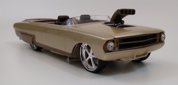

MeatMan Posted April 28, 2019 Posted April 28, 2019 I don't know if this is what you mean, but here I removed most of the body lines but left the lower line at the rocker. I also added skirts, and used color to break the color up. I did not have issues with body strength. Good luck.
