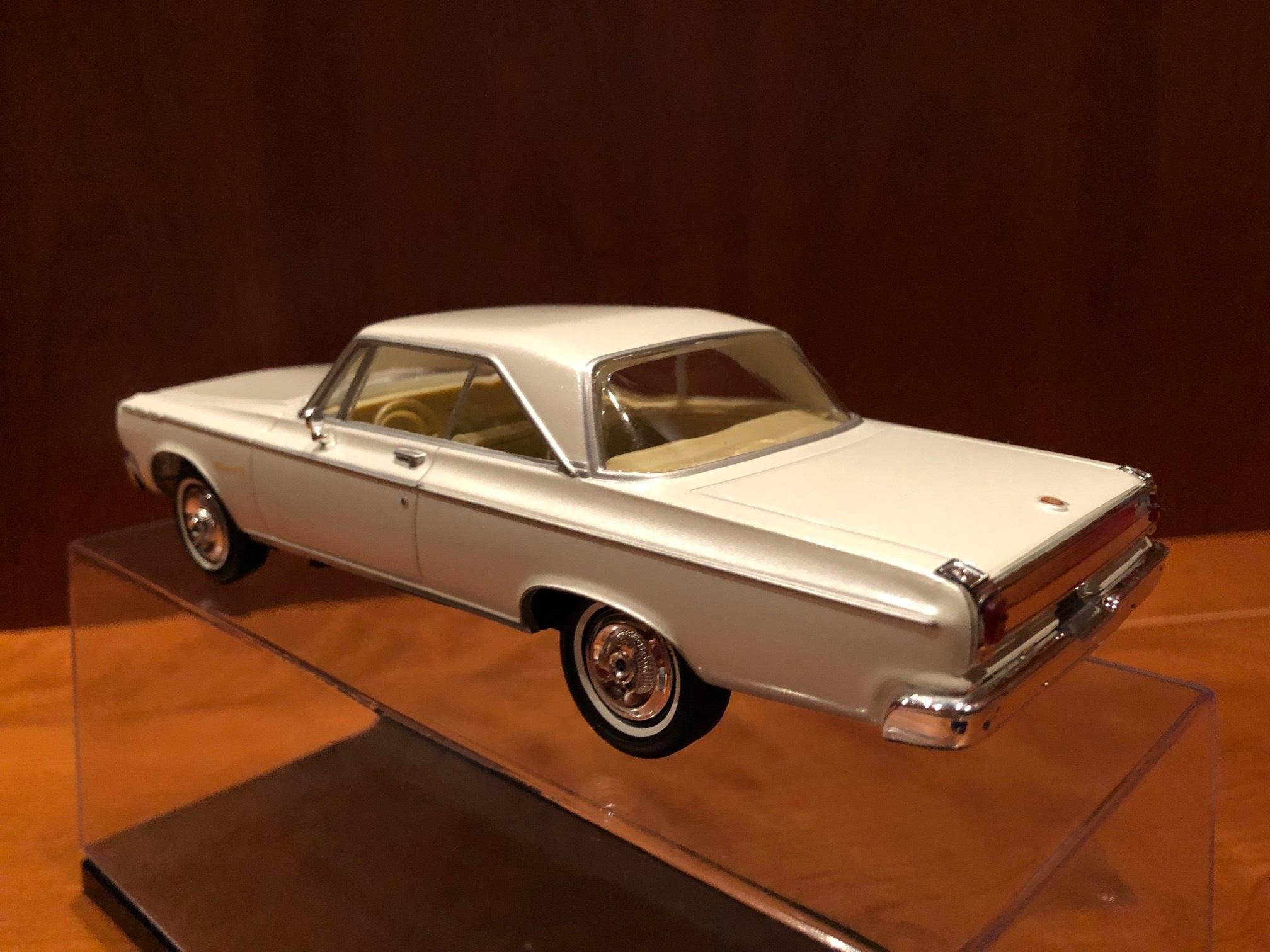

drodg Posted September 30, 2019 Author Posted September 30, 2019 On 9/26/2019 at 8:10 AM, randyc said: I'm not familiar with these, but have done a lot of real vinyl graphics over the years. If the masking is not removing, try wetting the masking on top a little to get it to release from the vinyl easier. Also maybe rub the whole thing a bit after applying but before wetting and do so vigorously to get some friction heat into the vinyl adhesive to help it stick more aggressively. Or hair dryer heat, which will help the vinyl stick and conform better. Make sure the tires are clean and oil free as much as possible before sticking the transfers. These are things you can try to get the masking to release. Seem like the older the masking gets, the harder it gets to release from vinyl decals. Good luck. Post photos if you get a chance - I'm sure others have or will face this again and if we can help... Randy I thank you for the tips. I do believe I need to buy a fresher set for my next build. Here is the finished car that I also posted Under Glass.
randyc Posted October 1, 2019 Posted October 1, 2019 Car looks great. Sorry you're having issues. Even if you order a new set, they may be old. I mean, Pegasus may have ordered a big load of them years ago? So they may still be same lot or old. Hard to tell. Let me know if I can help any more. be glad to try.
