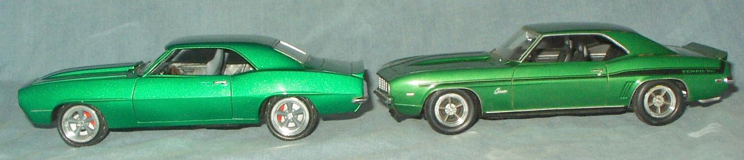

1 hour ago, Snake45 said:
Okay, here's a pic that shows right vs wrong.
On the left is the MPC '69 Camaro, which was poorly and incorrectly converted from their rather nice '68 in exactly the same way they poorly and incorrectly converted their '69 Firebird from their rather nice '68. On the right is the Revell '69 Camaro, which is just about universally regarded as having a nearly perfect body shape.
See the difference in the crease lines on the side of the body? That's where they were in '67 and '68 (on the MPC body); GM moved them up a couple inches for 1969 and MPC did not. The Revell body has these lines in the right place, where they should be.
The MPC (now AMT) '69 Firebird has the same problem. But there's no '69 Firebird kit where these lines are in the right place.
