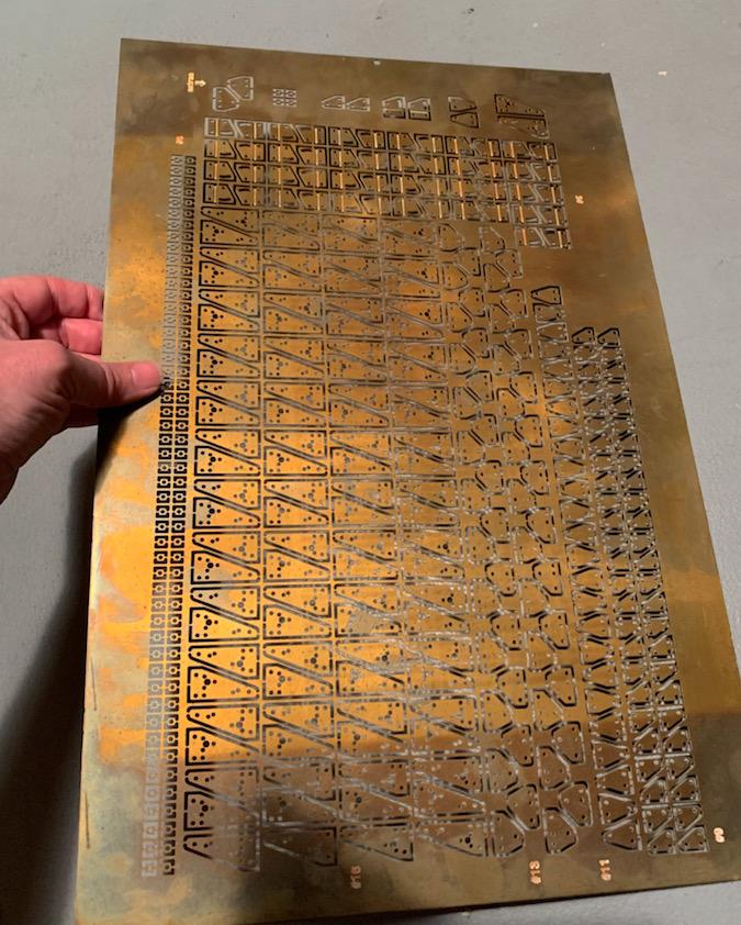

Russell C Posted March 6, 2020 Posted March 6, 2020 (edited) Saved this brass parts sheet from two decades back, a double etch one where the first etch was halfway down into the metal on the top sheet surface, then it was flipped over and another pass was done for an etch-through. If I remember right, this sheet was a total reject because the holes were not undersized enough to prevent the acid from ultimately making them too big in diameter. There's an 'art' to the whole process. Run the sheet through the acid too quickly, and you don't get a deep enough etch. Leave the sheet in too long, and too much of the metal disappears. Edited March 6, 2020 by Russell C typo
