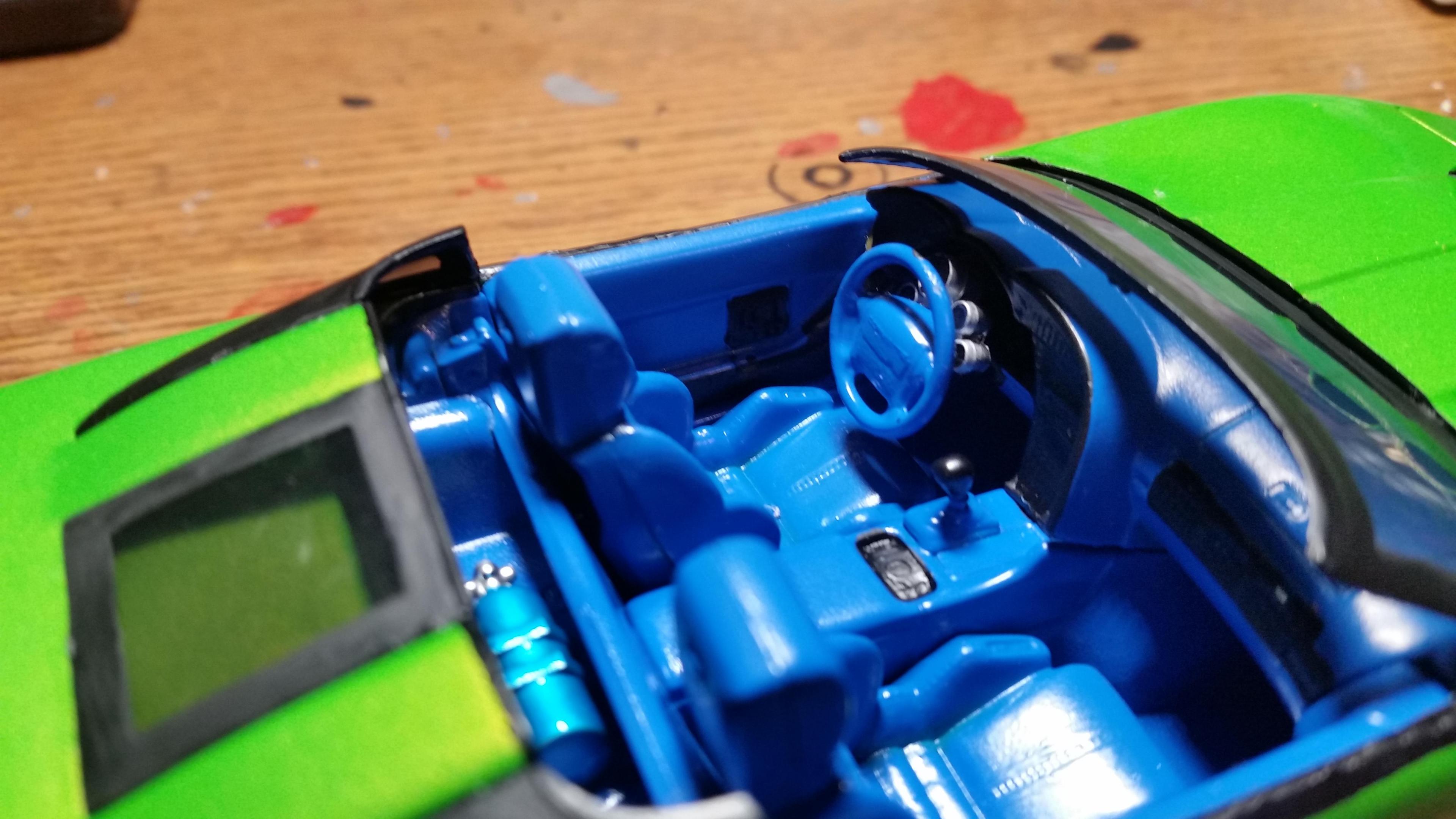

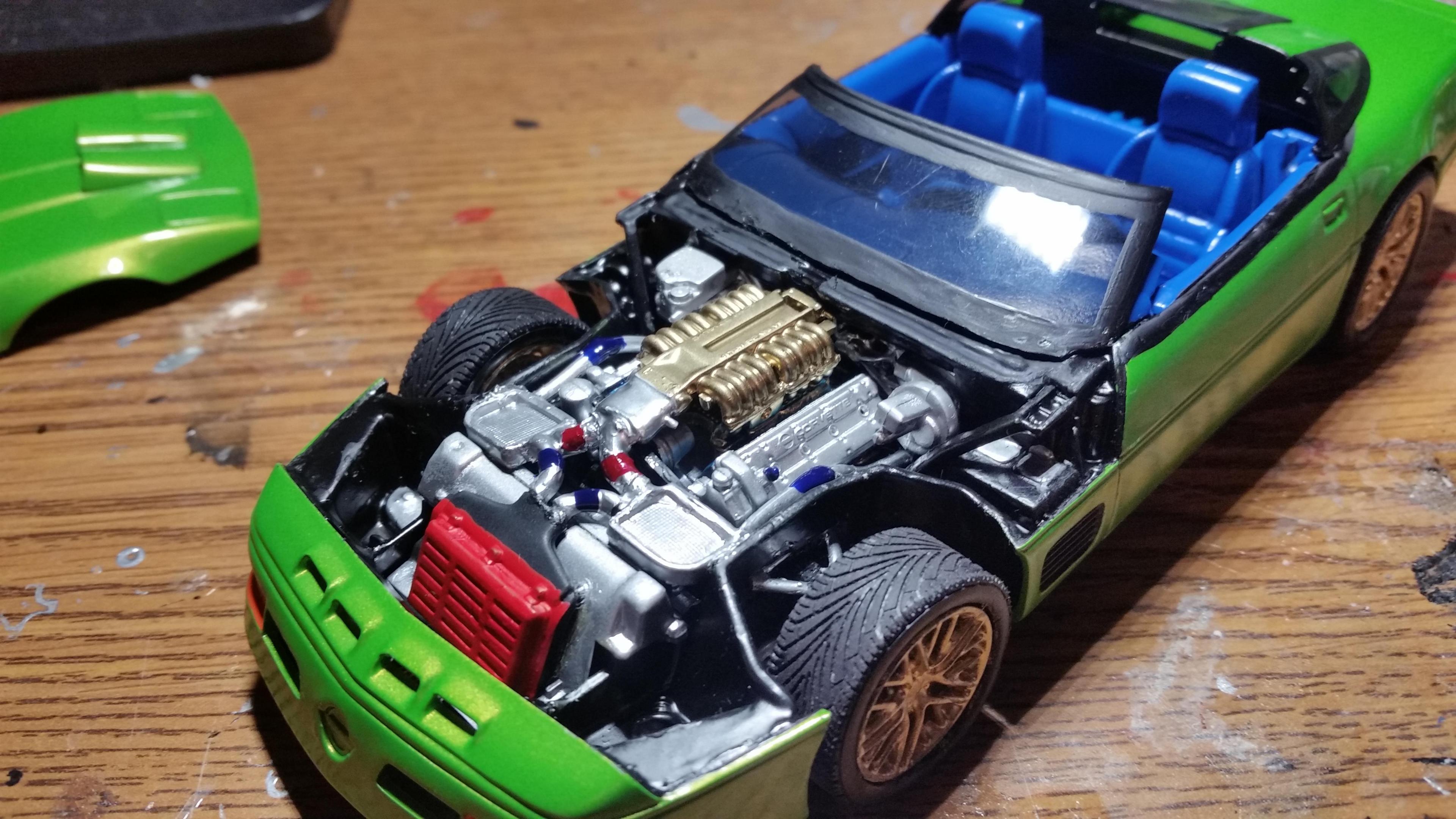

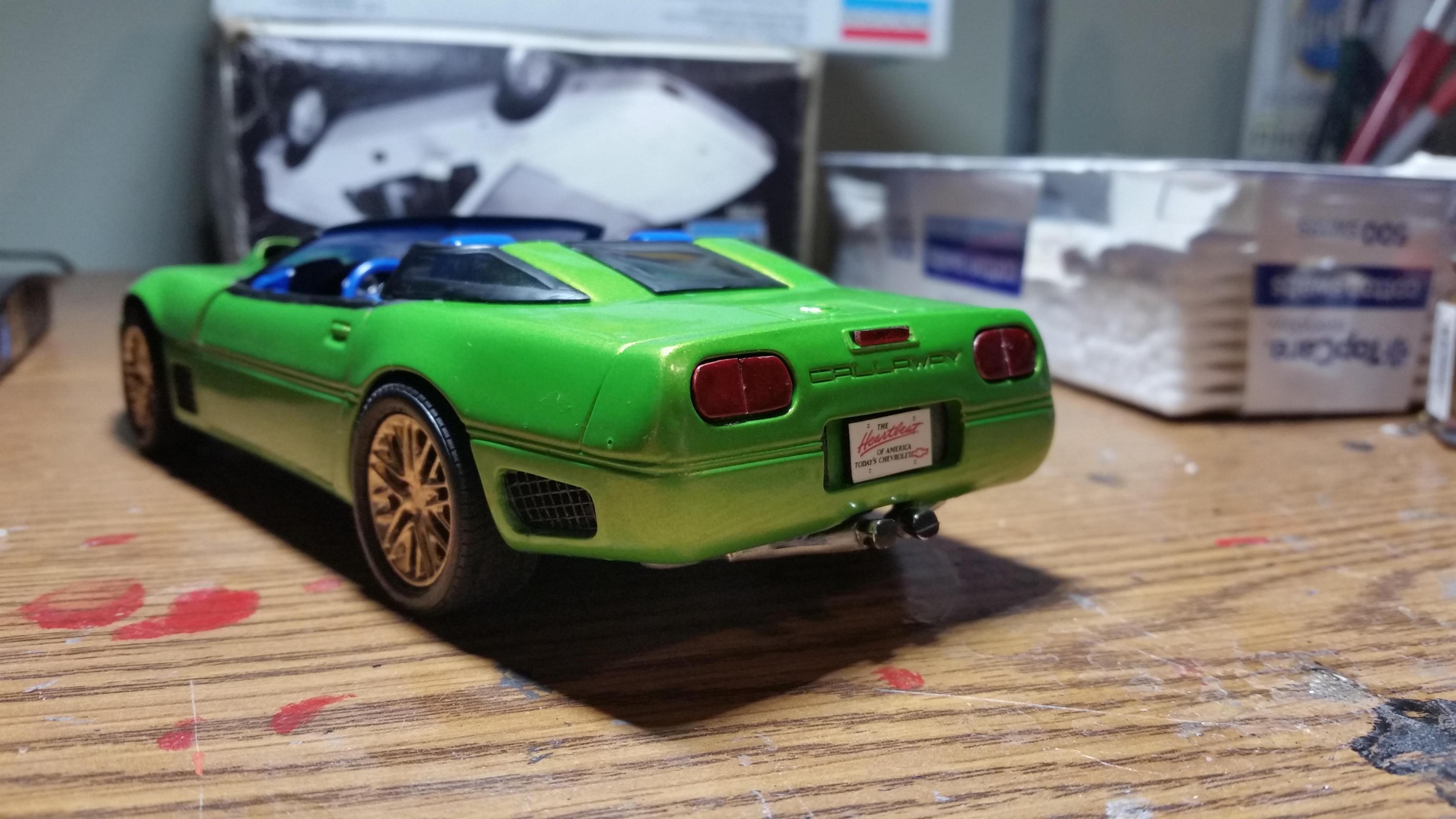

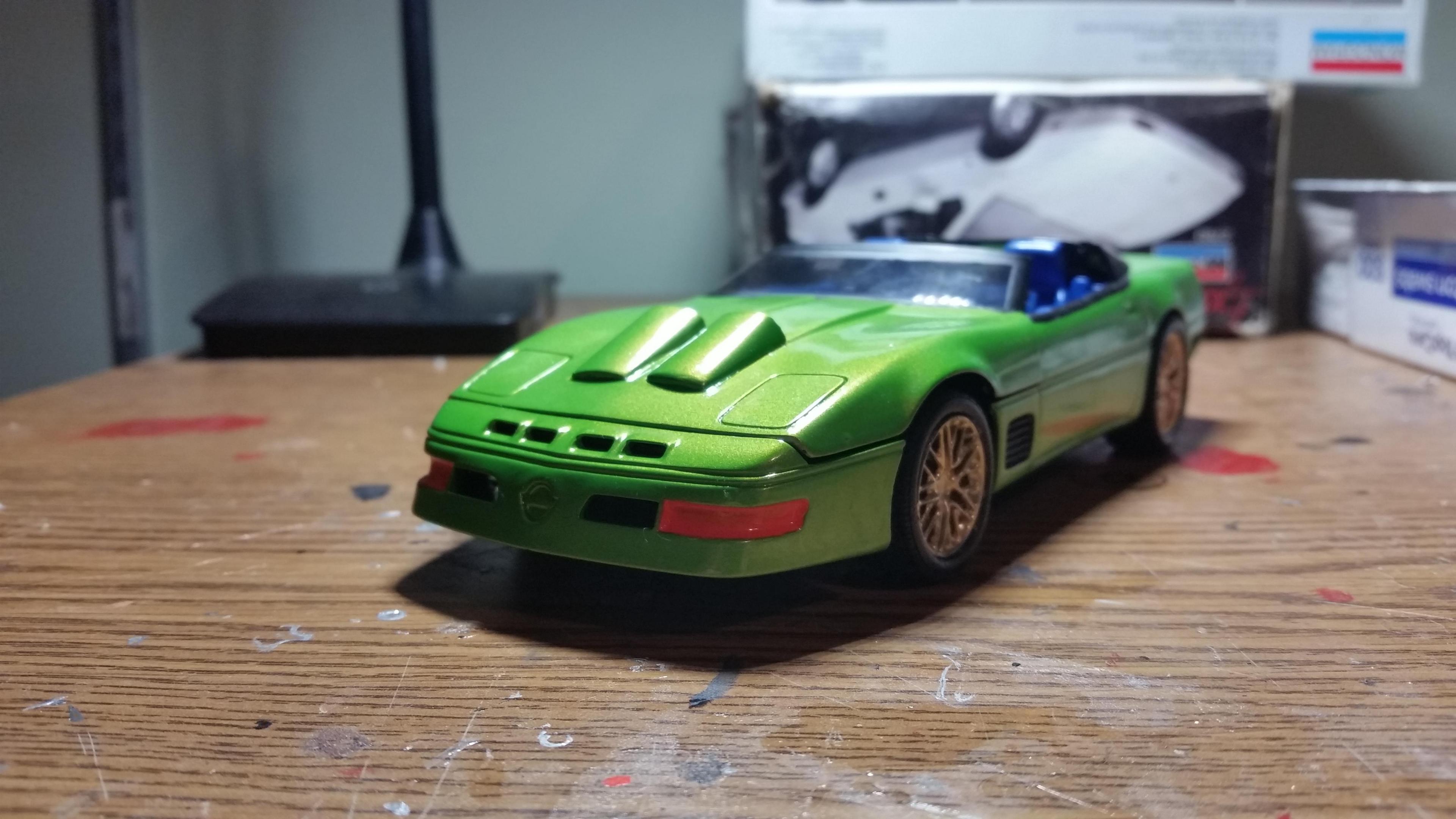

This is a rebuild of a failed attempt from about 12 years ago. It was so warped and bent on top of the poor hood and glass fit, that it got scrapped and recycled for other projects at some point. A few years back, I acquired a Monogram '92 ZR1 (molded in red) cheap in a club auction that not only had a horribly gluebombed body, but was also badly twisted with a broken section near the trunk area that made it unusable for anything else. However, the rest of the ZR1's contents were untouched and still on it's trees, and that inspired me to locate the body, front bumper, and glass glass of the Callaway for a possible restoration.

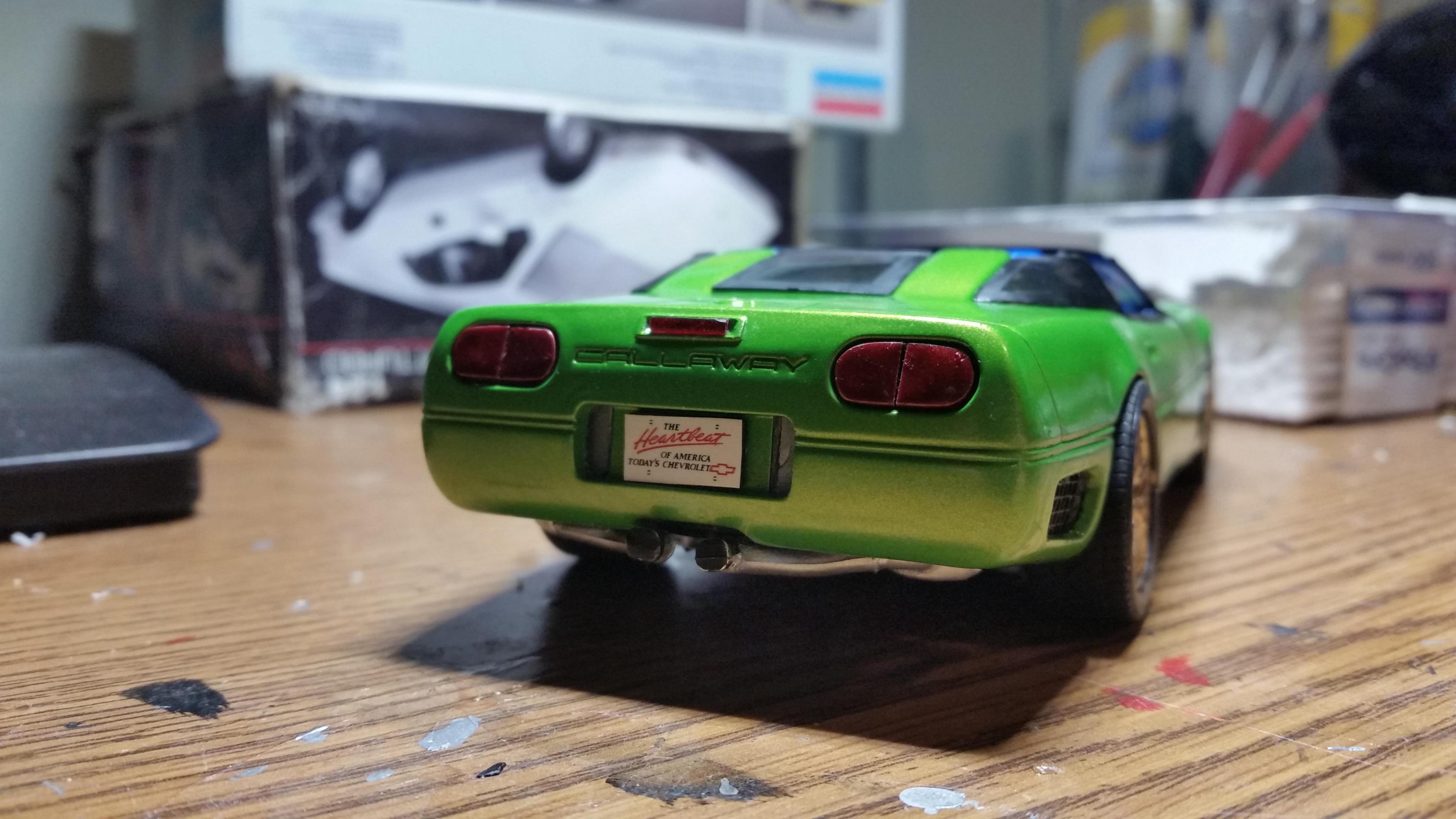

I didn't have the Callaway's original hood, and the ZR1's warped and messy body had the hood heavily glued shut. But I recalled having a unpainted yellow molded ZR1 hood from a parts box I was given at a club meeting. I tracked that down and added trimmed side scoops from the AMT '69 Covair's custom parts as hood scoops. The Callaway's one piece glass snapped on the drivers and passengers side windows, but the rest was salvageable by making it with a windows down look. I also didn't have the Callaway's original taillights, so I made custom two piece ones cut from sheet styrene and painted transparent red over silver. Callaway's body was still warped, but I did the best I could with correcting some of it's horrible fit it as it would probably break and snap further after it's purple bath.
Otherwise, the bulk of the Red '92 ZR1 filled in for the interior, motor, chassis, and suspension stuff. I also did other modifications as followed:

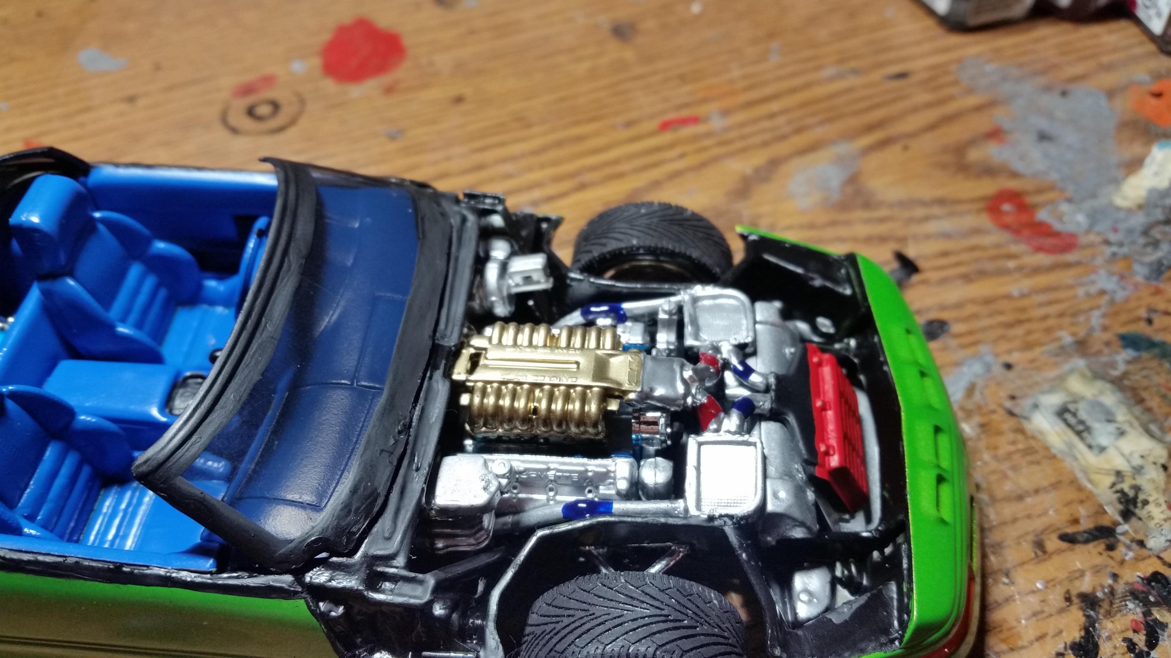

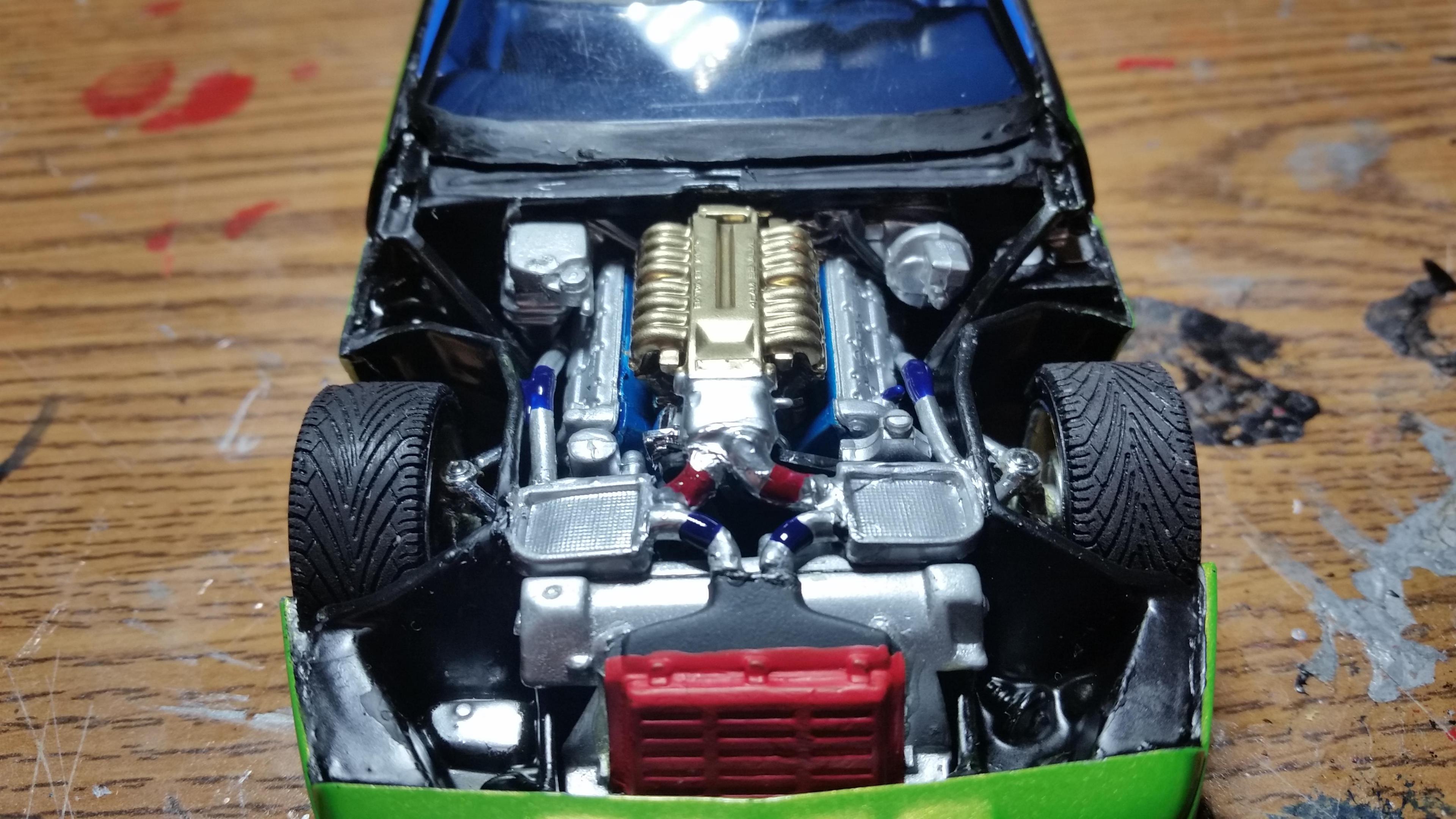

Custom twin turbo setup using resin turbos, intercoolers from Mustang Mach II, and styrene scrap trees bent as intake tubes
ZR1's exhaust was used with slight modifications to where it connects to the turbos and fabricating the rear exhaust to exit out the center of the Callaway's body
NOS tank and steering wheel gagues were leftover parts from a Revell Mathew and Debby Heys Thunderbird Pro Street
Mesh screening was used to replace molded rear bumper vents that were broken from storage

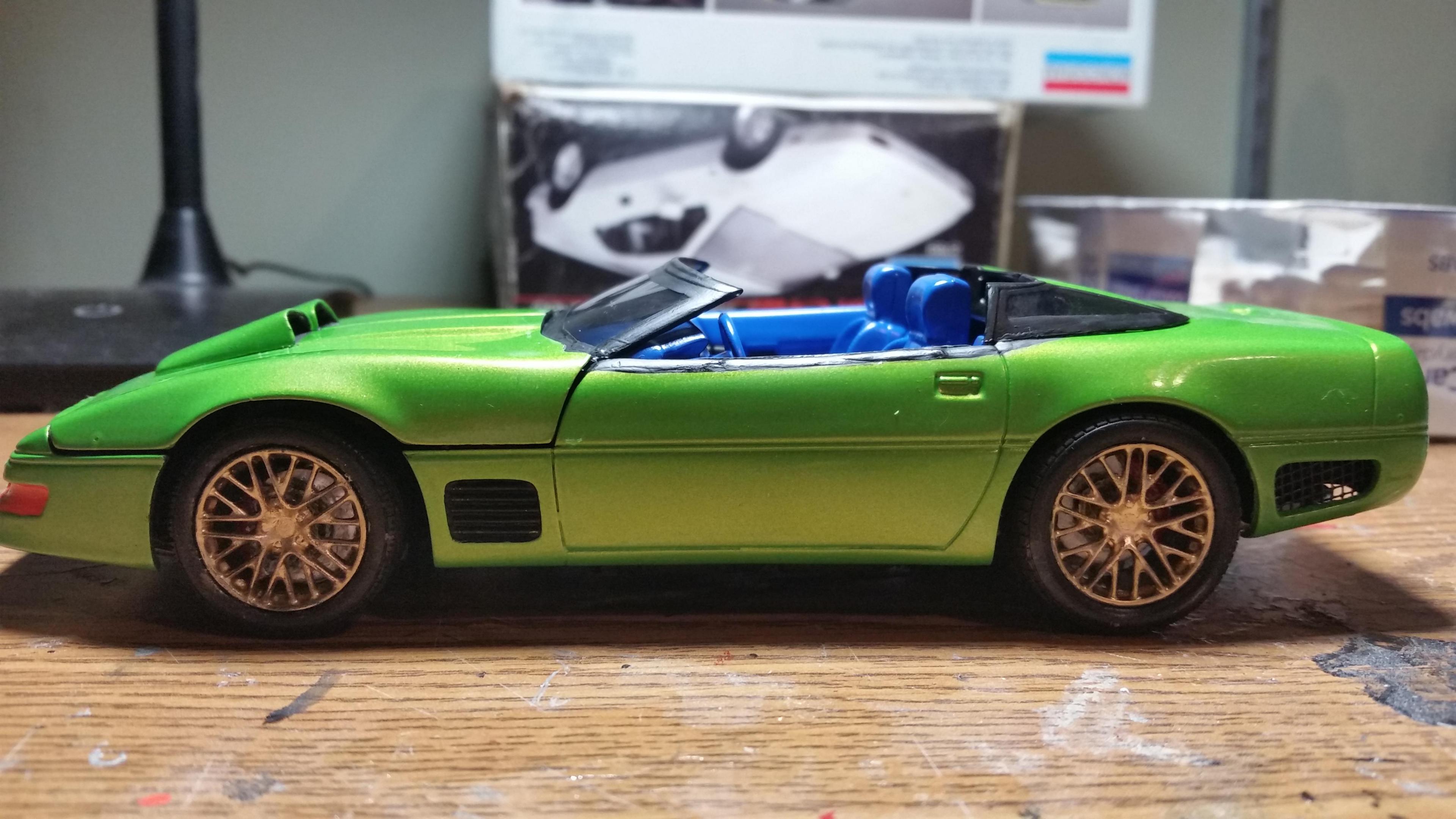

Revell '09 ZR1 wheels, disc brakes, and rear tires were used with front tires from the AMT F&F Supra
Interior paint is Rustoluem Painters Touch True Blue dullcoated with Rustoluem Matte Clear. Exterior is Tamiya TS-52 Candy Lime Green over Rustoluem Silver cleared with Pledge

Great job working with what you had. The interior and body colors are a little jarring but that is the way it was done. Nicely detailed engine. Unless it's to much trouble you might want to remount the left front tire as it is a directional tread pattern.
