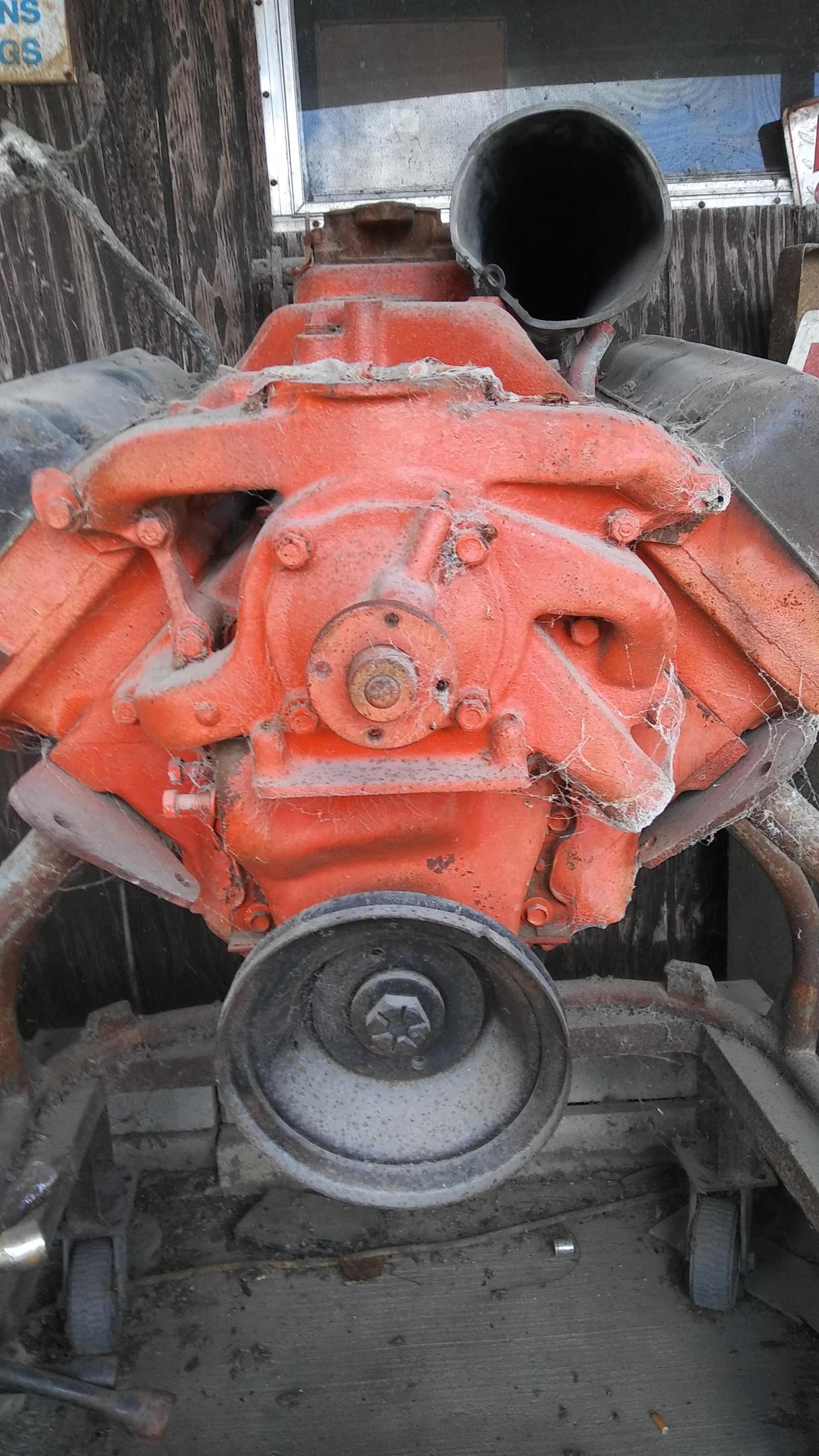

   I got lucky and found an engine on a stand at my local salvage yard 3 miles from my house. It was right next to the front door of the office.

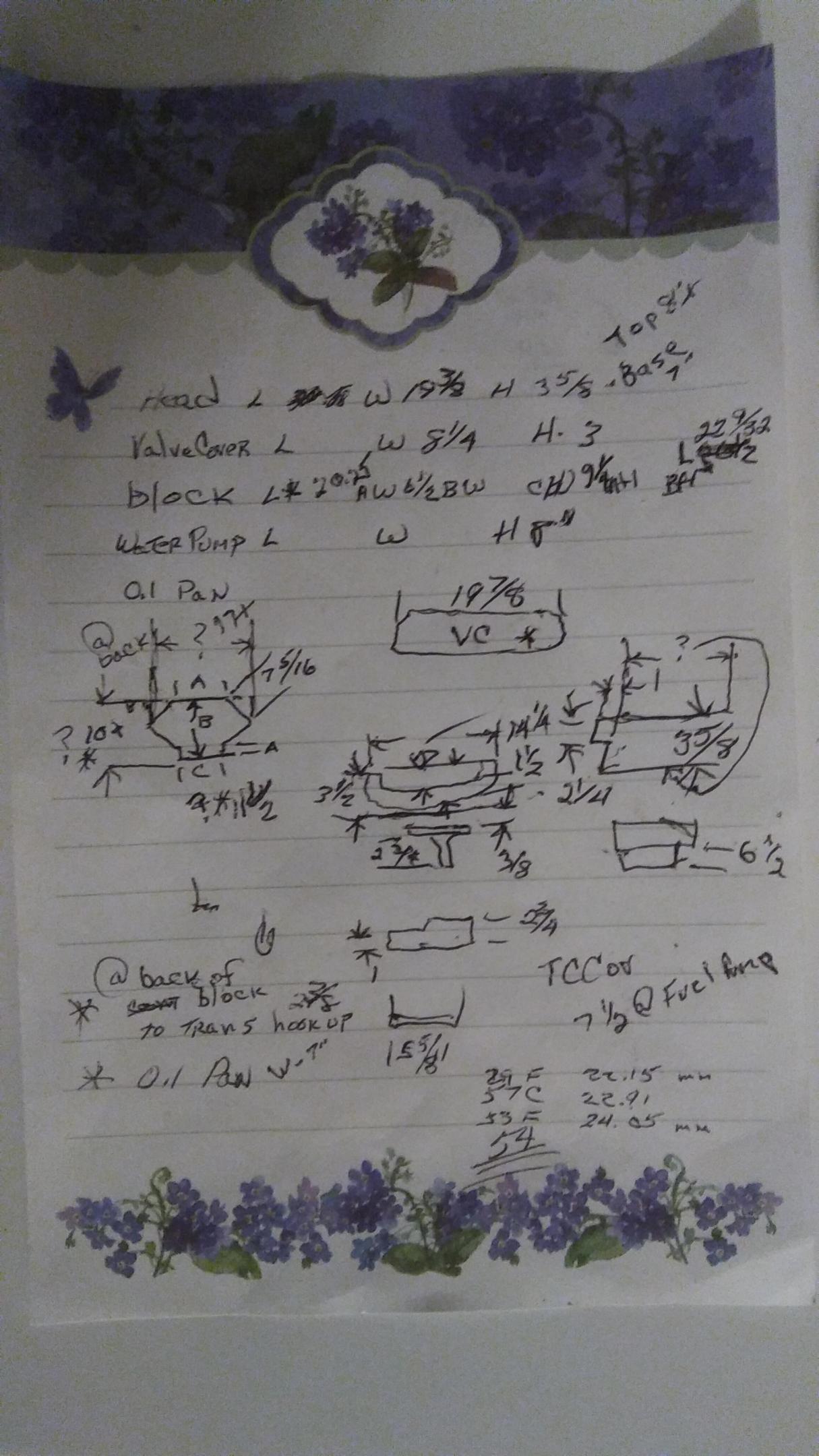

Went back a few days later with a tape measure, pen and paper.
