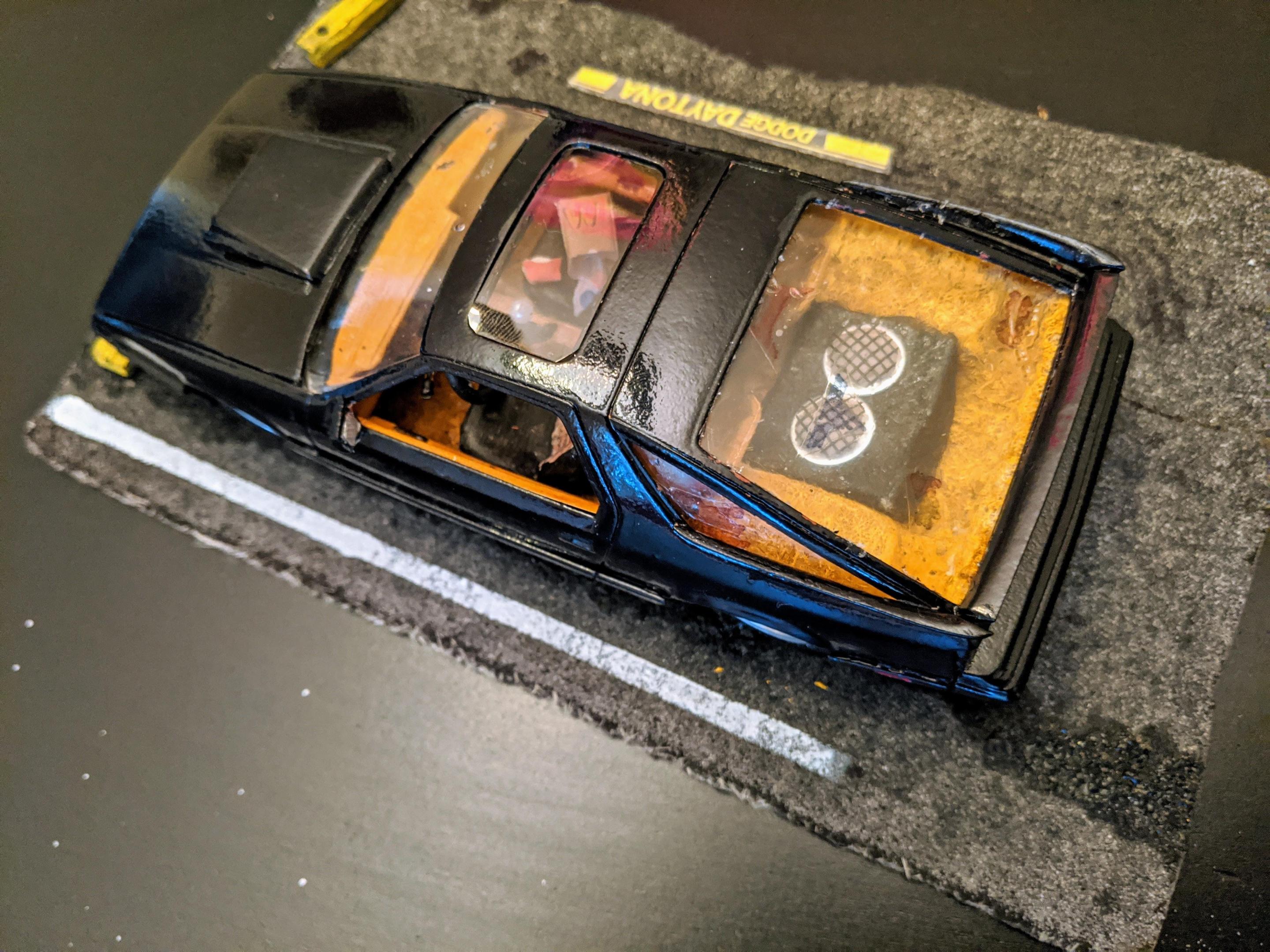

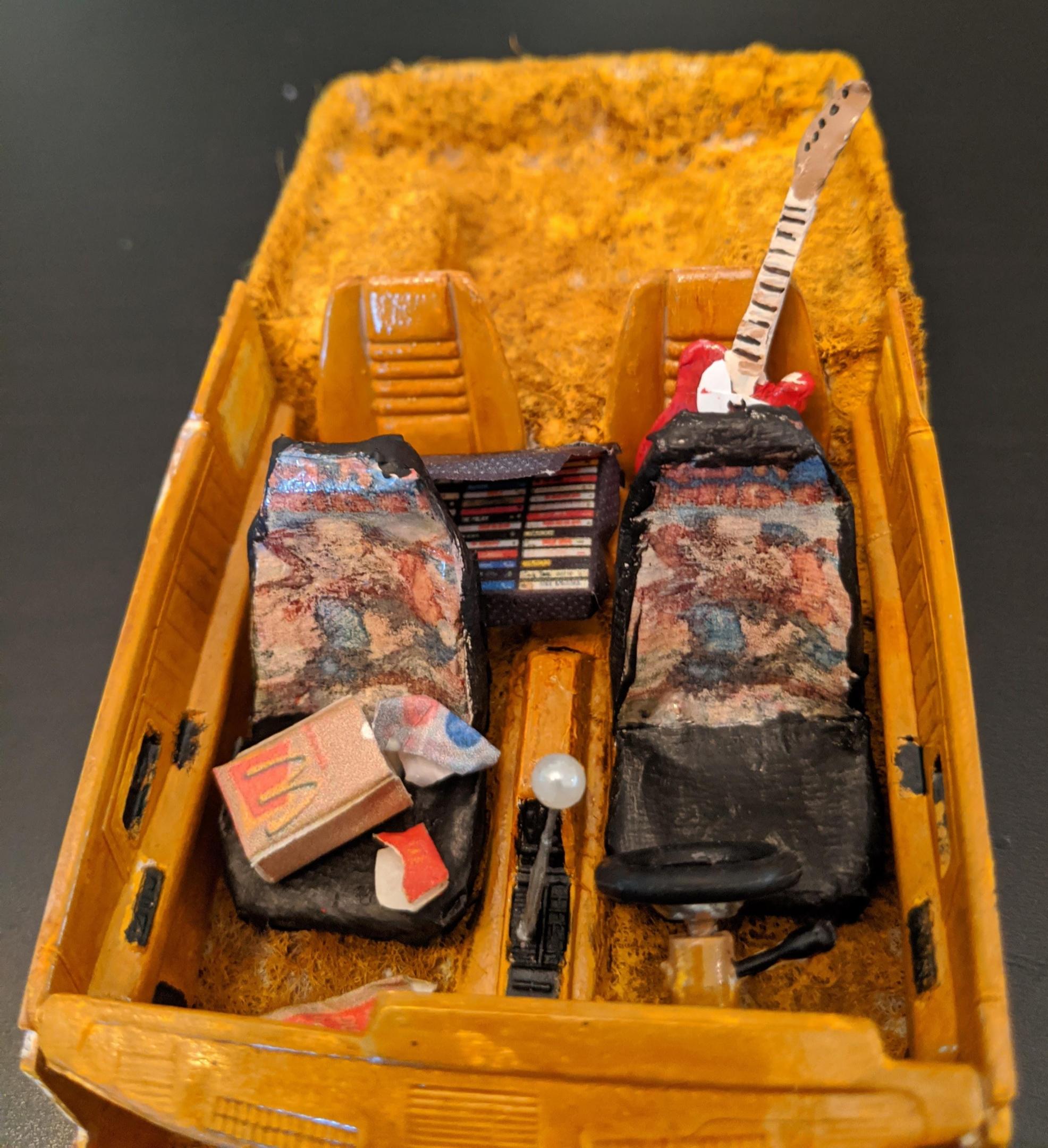

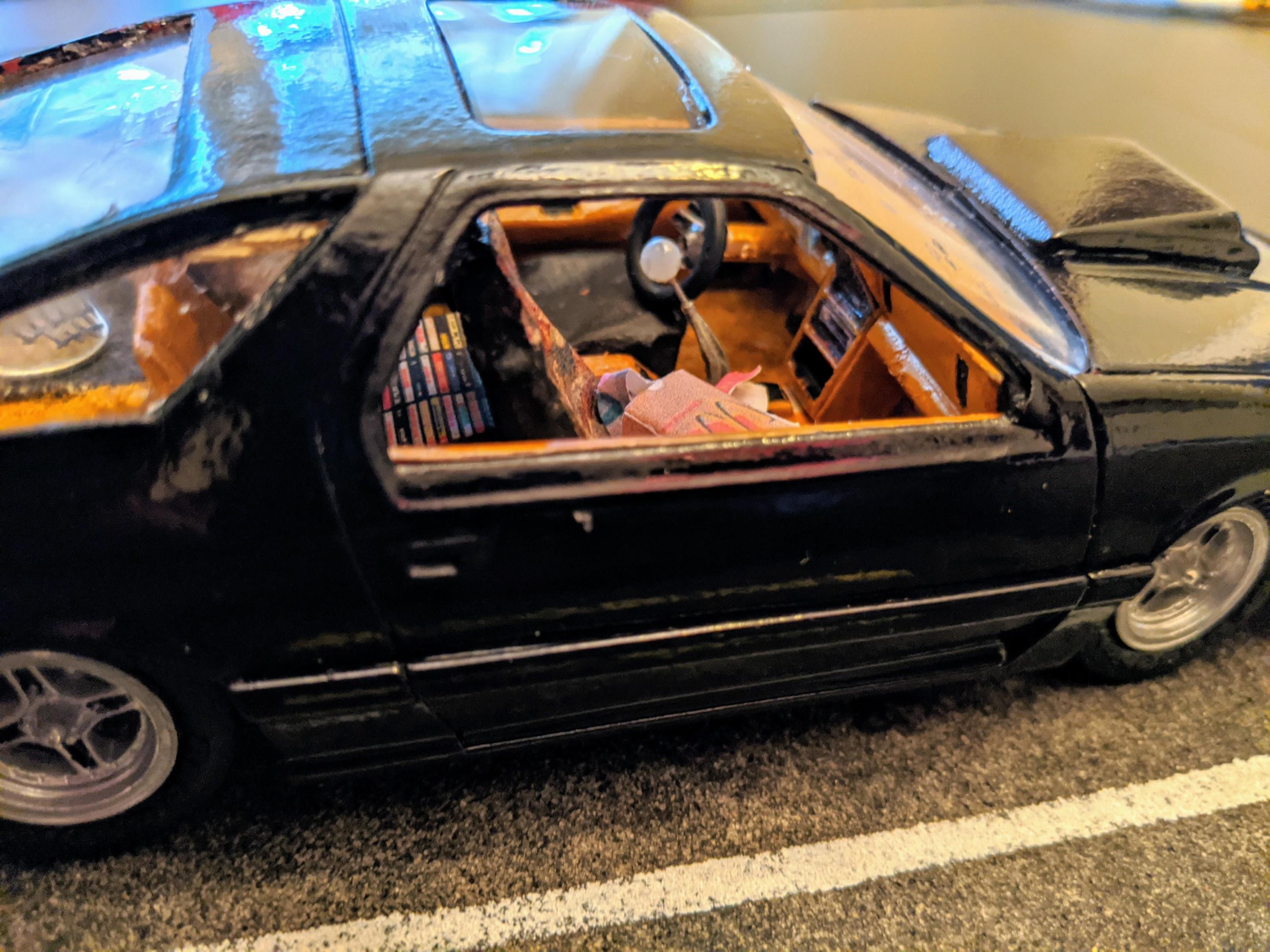

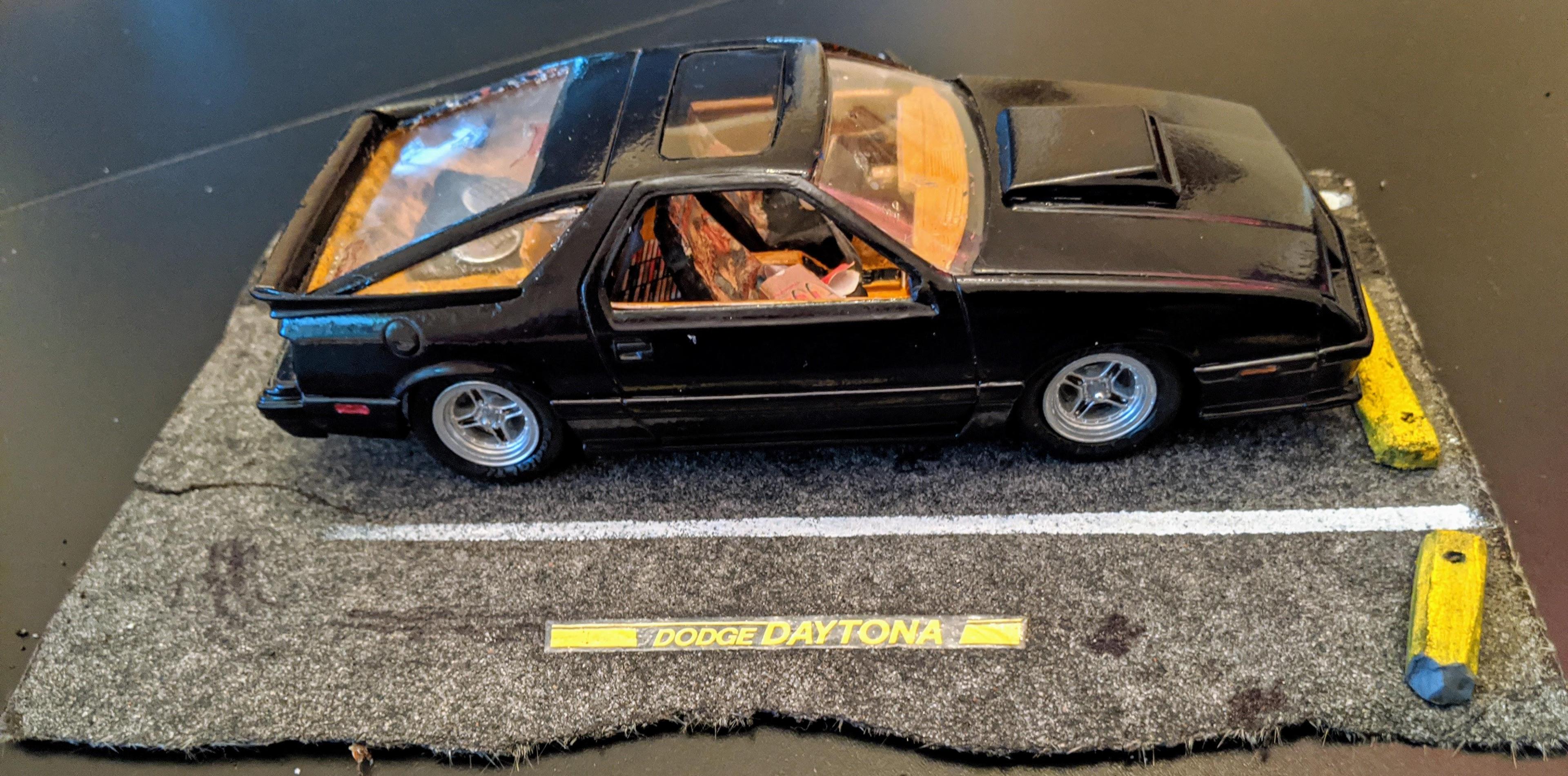

First jump back into modelling and change over from 1/35 military to 1/25 autos  This was pretty much my test dummy for anything I could come up with ….Figured I would do it up in classic 80s style, from the Iron Maiden seat covers, to the diy hood scoop and addition of micky D's bag and giant cassette holder.
Not perfect but lots of lessons learned.

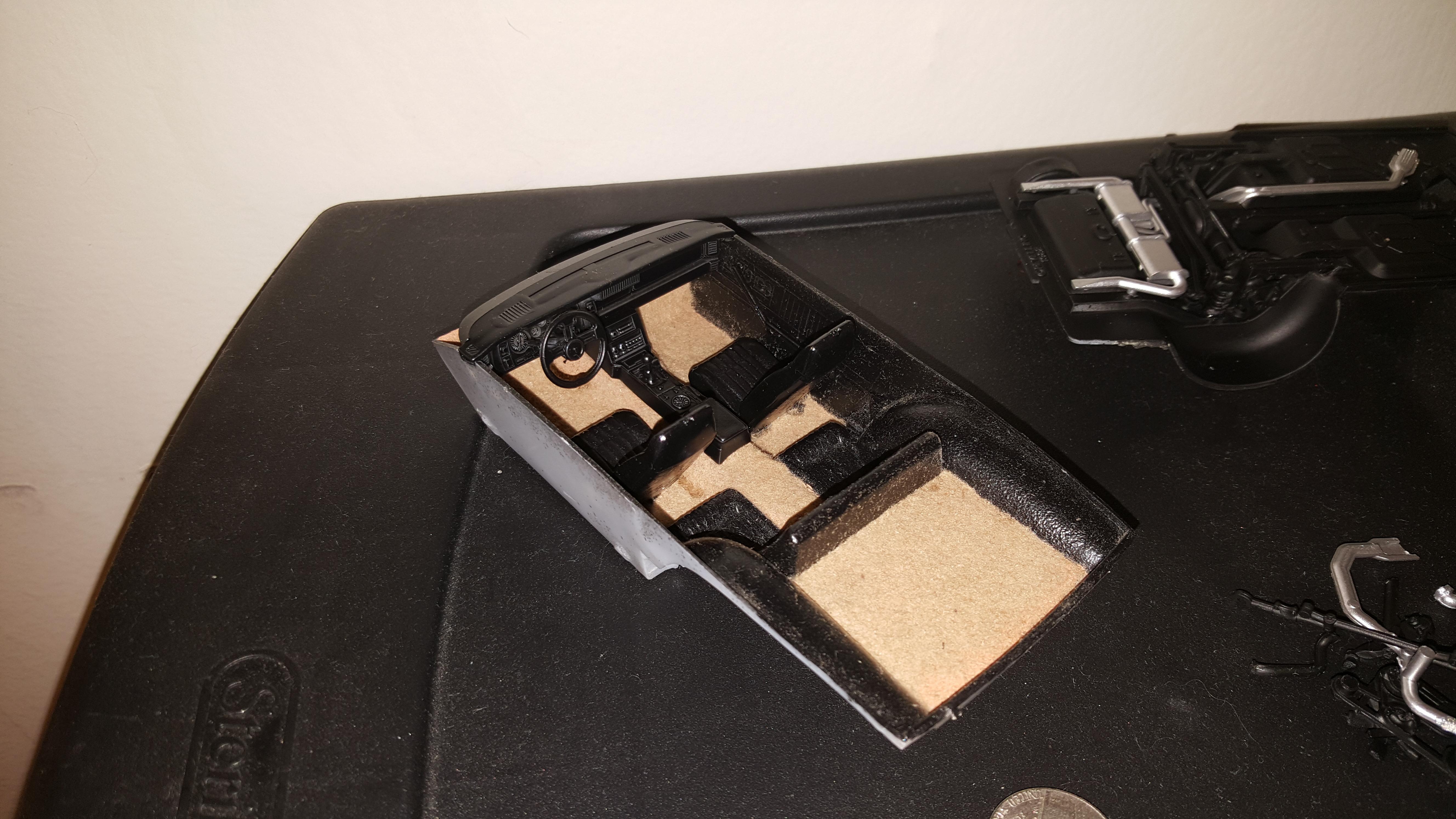

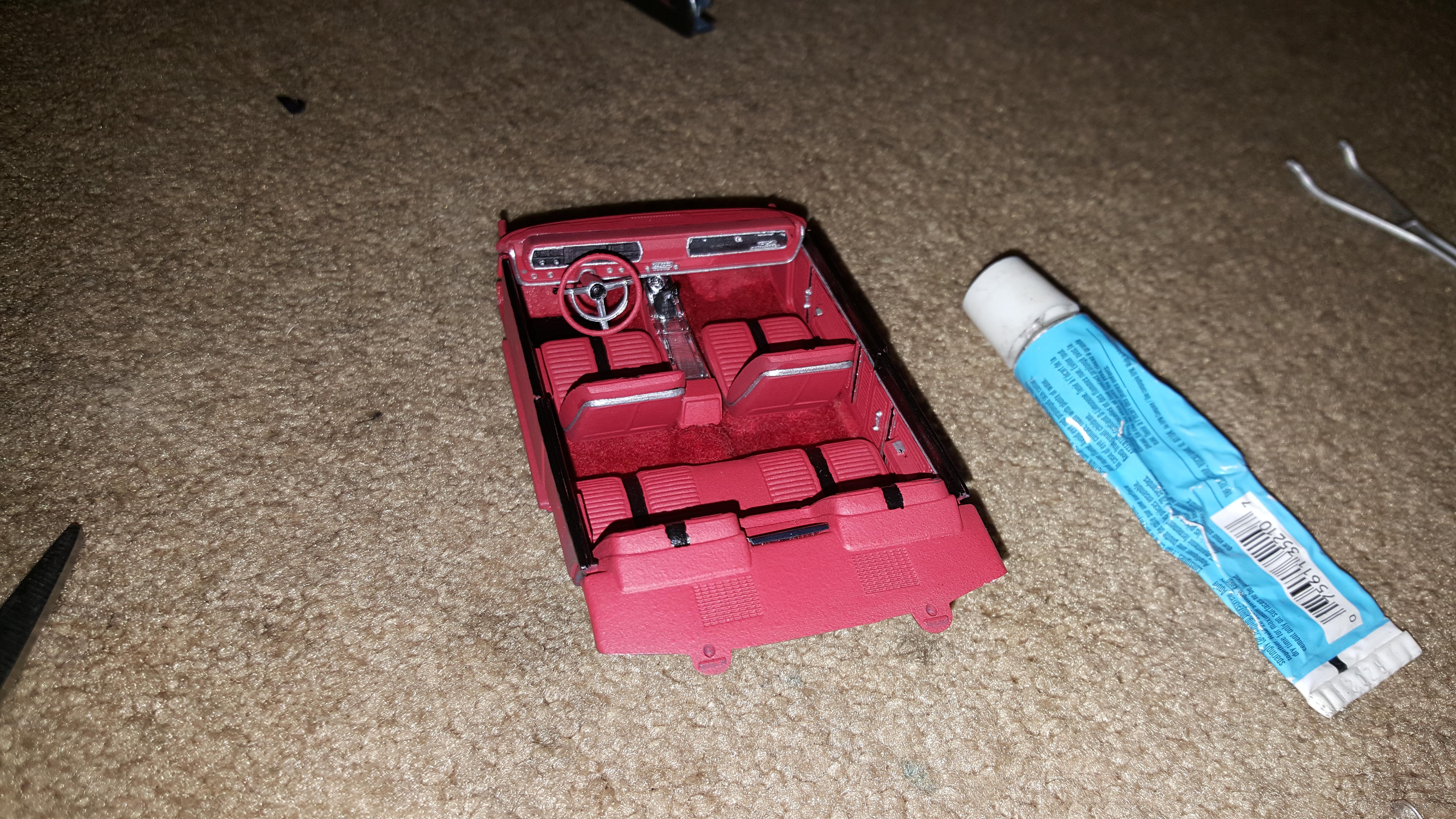

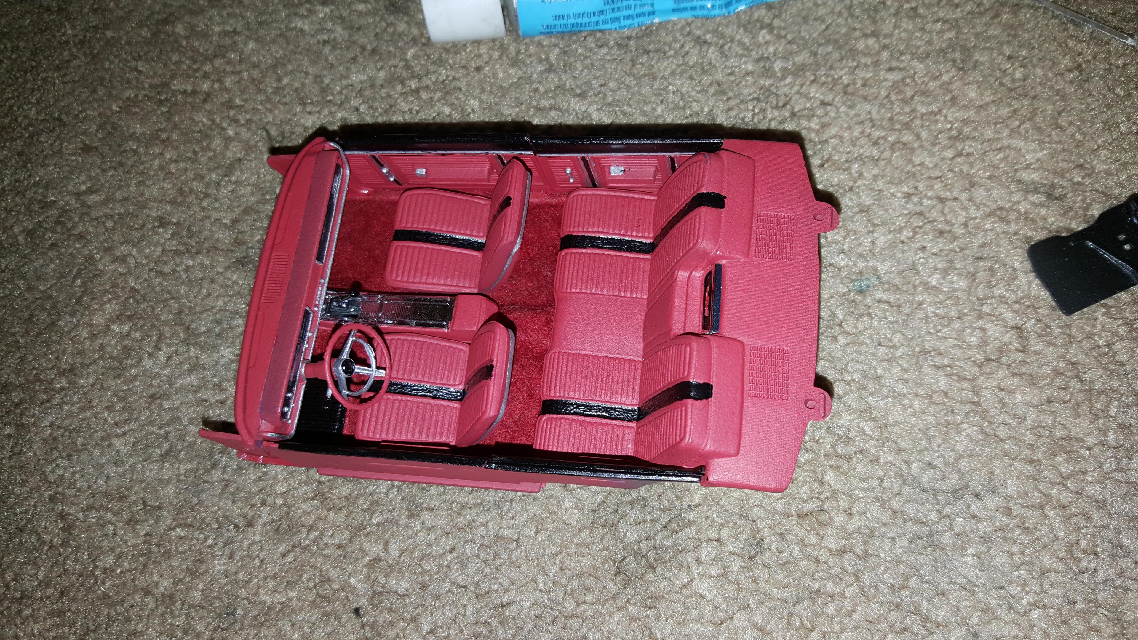

I dont use the typical flocking material to make my carpeting. I run card stock through a cheese/veggie grater then pile it on top of a piece of screen. Then I use a brush to apply Elmer's white glue to the floor. Place the interior tub over a sheet of paper on a counter or table. Then I "Sift" the shredded card stock over the Elmer's glue and gently push it down after I've sifted it. Then I tap off the extra onto the piece of paper. Then you can load up your screen again. Work in sections so you're not racing against drying time. They do make specific flocking powder that people have good results with but I havent used it. Welcome back to the hobby!
