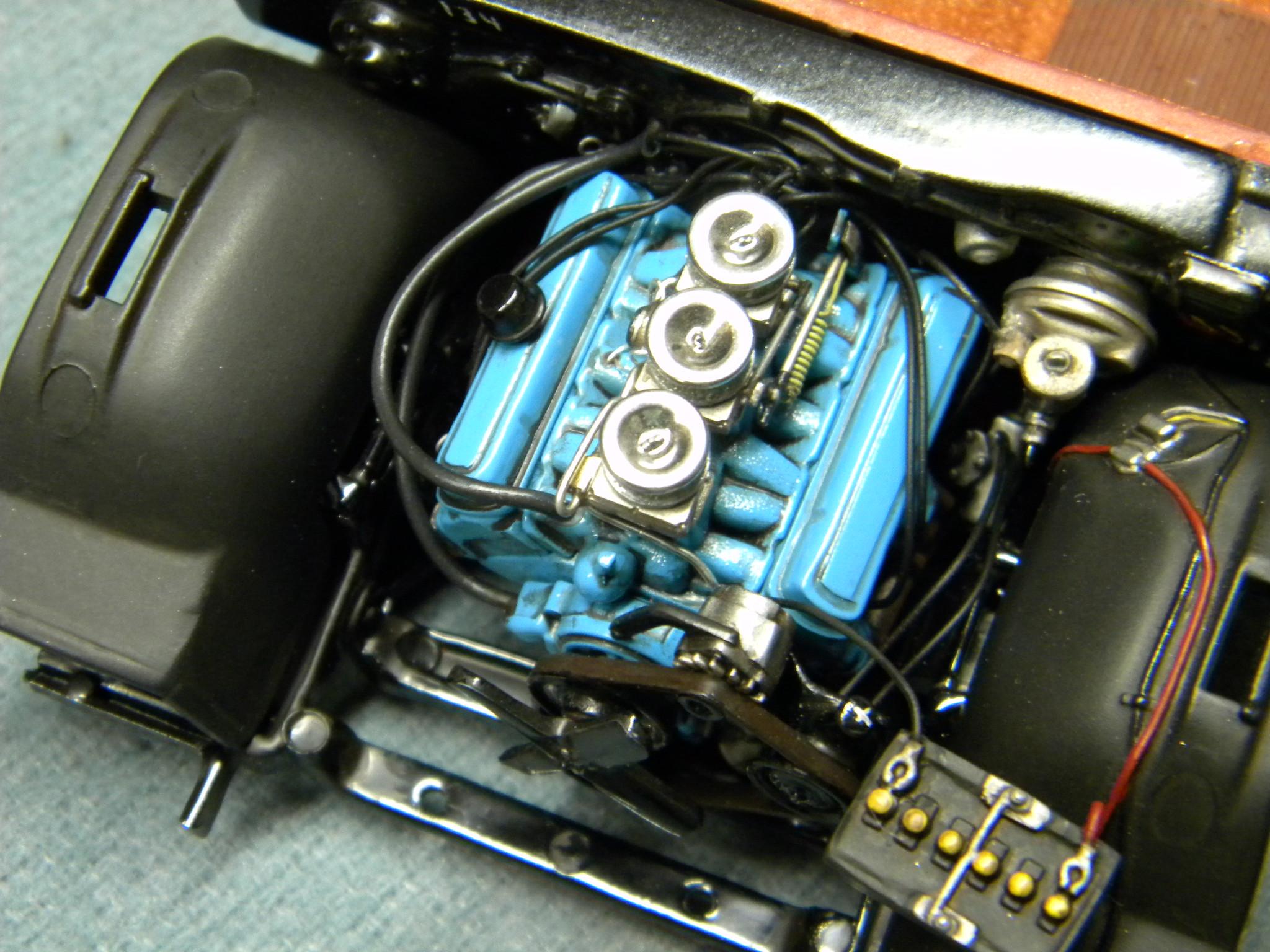

Donny Posted July 26 Posted July 26 On 9/4/2020 at 5:38 AM, StevenGuthmiller said: The "M.A.D." distributor that Brian has pictured comes with a length of slightly larger wire to be used as boot material. You need to strip the jacket from the wire and use the jacket for the boots. Drill the holes in the heads large enough and deep enough to accept about 1/8th inch piece of the boot material and glue them into the holes first. It's a good idea to use some sort of pointed instrument to slightly stretch the boot material on the end that will except the wire. This makes adding the wires much easier later. Once the boots are in place to your satisfaction and the glue has dried you can slip in the wires. Of course this is all dependent on the fact that the distributor is already installed. That needs to be done first. By the way, don't throw away any of the left over wire that you cut from the leads or the wire that you stripped for the boot material. These will both come in very handy for other wires, hoses and fuel lines throughout the engine compartment. On the '64 Grand Prix that I'm working on currently, left over wire from M.A.D. distributors was used for all of the fuel lines, battery cables, power steering hoses, brake line and the brake booster vacuum line. It's extremely useful stuff! Steve Great post Steve, just what I need after 50 years away from the hobby. Don
