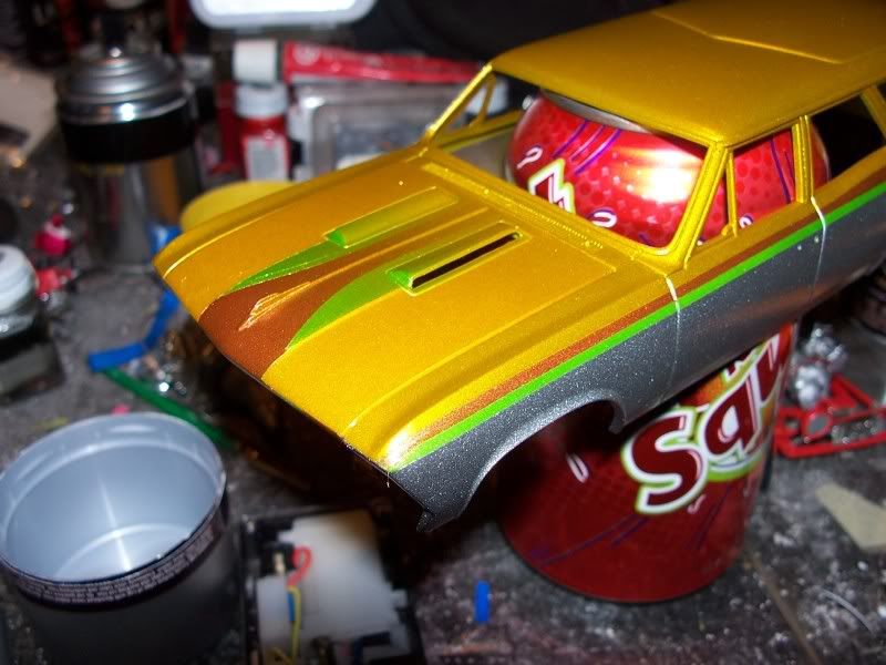

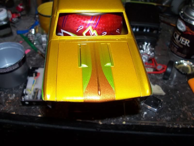

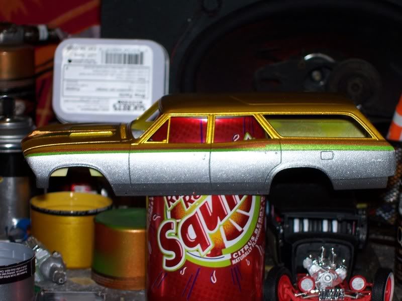

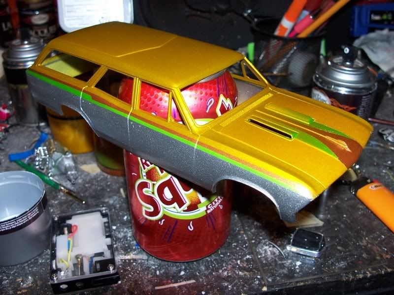

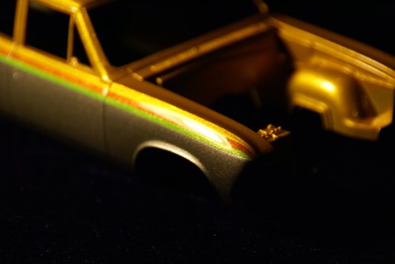

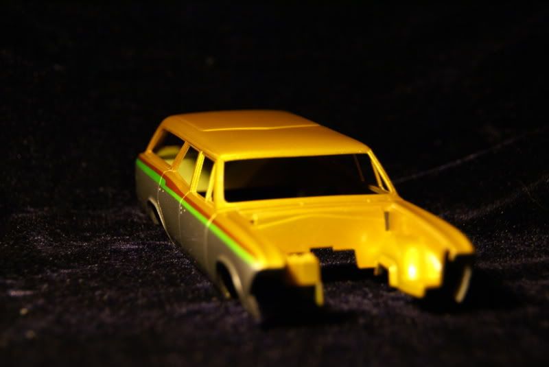

Jake-Off Posted November 9, 2008 Posted November 9, 2008 well the start of the California wheels 66 wagon none of it has clear on it yet, since idk if i want to add anything else to the paint
plumnuts Posted November 9, 2008 Posted November 9, 2008 that is some wicked paint!!!! I have tons of questions ,but lets start with what kind of tape do you use to get those lines? and what kind of paint to get that kind of coverage? (have you cut and buffed yet?). and last question for now, do yoe cut your design out on the car or transfer already cut tape to car?

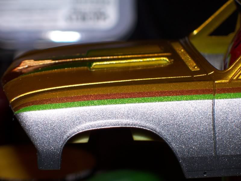

Jake-Off Posted November 9, 2008 Author Posted November 9, 2008 that is some wicked paint!!!! I have tons of questions ,but lets start with what kind of tape do you use to get those lines? and what kind of paint to get that kind of coverage? (have you cut and buffed yet?). and last question for now, do yoe cut your design out on the car or transfer already cut tape to car? to be honest nothing really special, i picked up the fine line tape at my local hobby store. i belive its 1/16th in size and it rang up over 6 bucks for a tiny little roll. its meant for use on model cars, planes, trains etc... for paint i used the testors lacquer colors, which it really doesn't cover all that well. so i had to paint the whole model the green first, then i taped off the aera that i wanted to stay geen then painted the whole model orange, and then taped that off and so on. with each color i did a bunch of light mist coats so the build up along the edges wouldnt be too bad. but the best thing about doing a multi layer paint job like this is when it comes time to un wrap the whole thing after two days of work... and theres no clear on it yet.... not sure if im gonna add anything else to the paint i think that answers most of ur questions, i might have missed one or two, but i can try and find the package from the fine like masking tape and get back to u on that subject

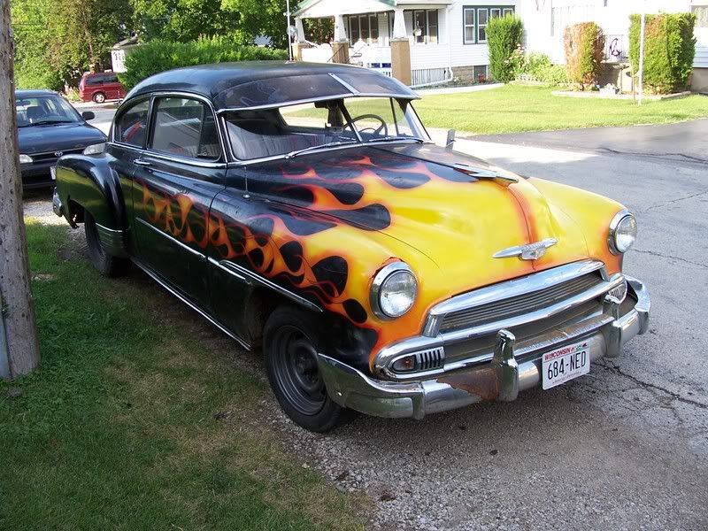

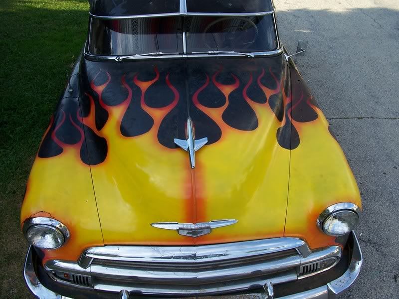

Jake-Off Posted November 9, 2008 Author Posted November 9, 2008 GORGEOUS work on the paint !!!!!!!!!! I'm not sure if it would be cheaper for ya or not, but if you go to a paint store for 1:1 cars, you can get "pinstripe tape" in widths from 1/16 up to about 1/4, but it comes in rolls like 40' long. (enough to last a model builder a loooonnnggg time... ) On 1:1 stuff I know either blue or red pearls look stunning over silver or gold base coats (respectively), but not sure about over the green or bronze... Again, great job on the paint. i have a bunch of 1/8th inch fine line, i put flames on alot of my buddies 1:1 cars and my own ratted out 51 chevy, but with the 1/16 fine line the edges r too tall which builds up alot. perfect for 1:1 cars but dont work well with the model cars this would be my 1:1 51 chevy rat, i did the flames after i put a green fender on it, after iola wi's swapmeet, and have done prolly about 10 flame jobs since july, everyone saw my car and wanted some flames... which i have a bunch of matrix system paint and clear that i got for free but thanks for looking man mucho appreciated

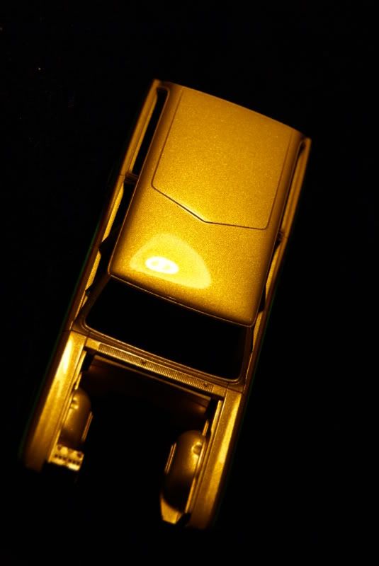

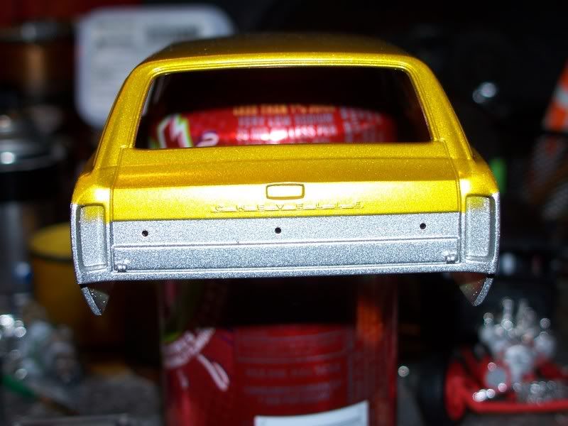

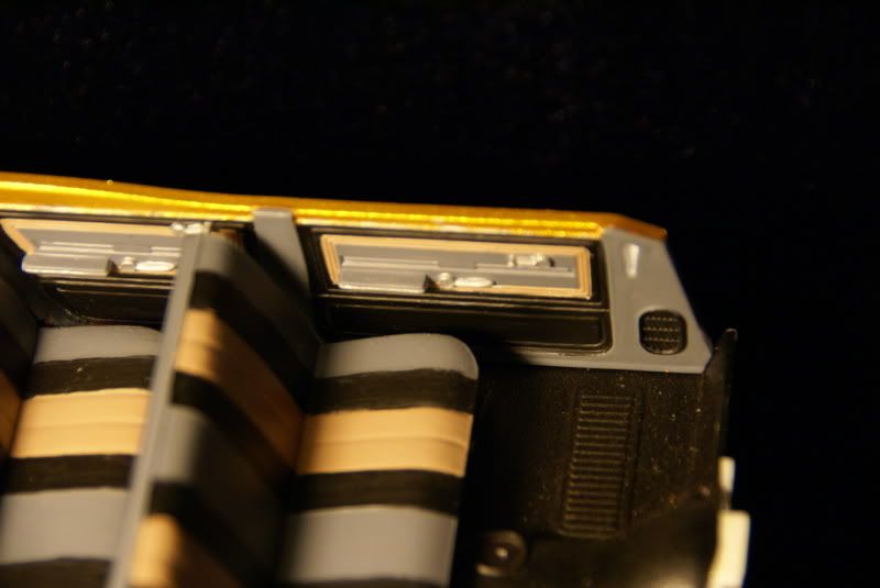

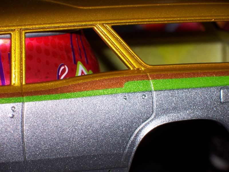

Jake-Off Posted December 18, 2008 Author Posted December 18, 2008 (edited) a lil later than expected but heres the body and interior. the interior still needs work and touch ups and details, but it gives u a better idea of what its looking like. the body still needs bare metal foil...and the hood is MIA. no clue where it is so i might be buying another kit for the hood. and the camera was acting up so i didn't get the best pics, but hopefully u can see the level of shine in this thing Edited December 18, 2008 by Jake-Off
GOTH KUSTOMS Posted December 18, 2008 Posted December 18, 2008 (edited) Do you have a cat? well when parts come missing I always look for my cat , or in the kitty poop box , under the couch, or under my bed , she's always jammin with my stuff. Anyway, this is look'n top shelf, dig the interior kolor combonation, nice fit to the body's kolor. Nice shine too, smooth as glass... Edited December 18, 2008 by unforgiven
Jake-Off Posted December 18, 2008 Author Posted December 18, 2008 Do you have a cat? well when parts come missing I always look for my cat , or in the kitty poop box , under the couch, or under my bed , she's always jammin with my stuff. Anyway, this is look'n top shelf, dig the interior kolor combonation, nice fit to the body's kolor. Nice shine too, smooth as glass... thats pretty funny man, but no i dont.... i just have a messy work bench, and with moving stuff from my table to the bench it miht be in a model box with a bunch of spare parts getting all scratched up but wjen i was younger and had cats i did have that problem offten since i built most my models on my bedroom floor, i was 6 or 7 at the time...and never built a snaptite. i just had to use the orange smelling non toxic glue that i sniffed often what can i say, the stuff smells good but adhered for.... well im sure u know. but i watched my dad build models alot when i was a tike, and the same goes for 1:1 cars as well
