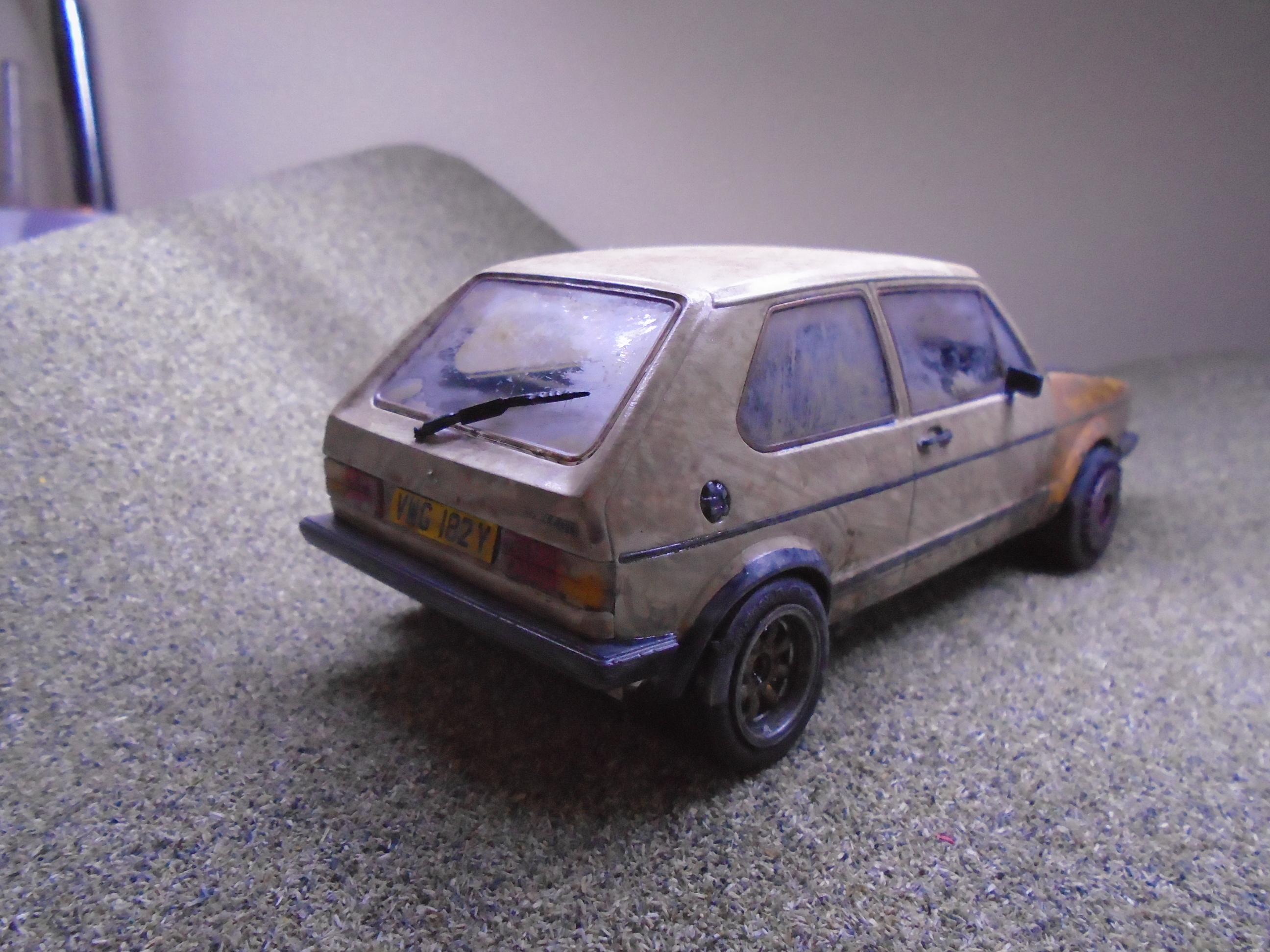

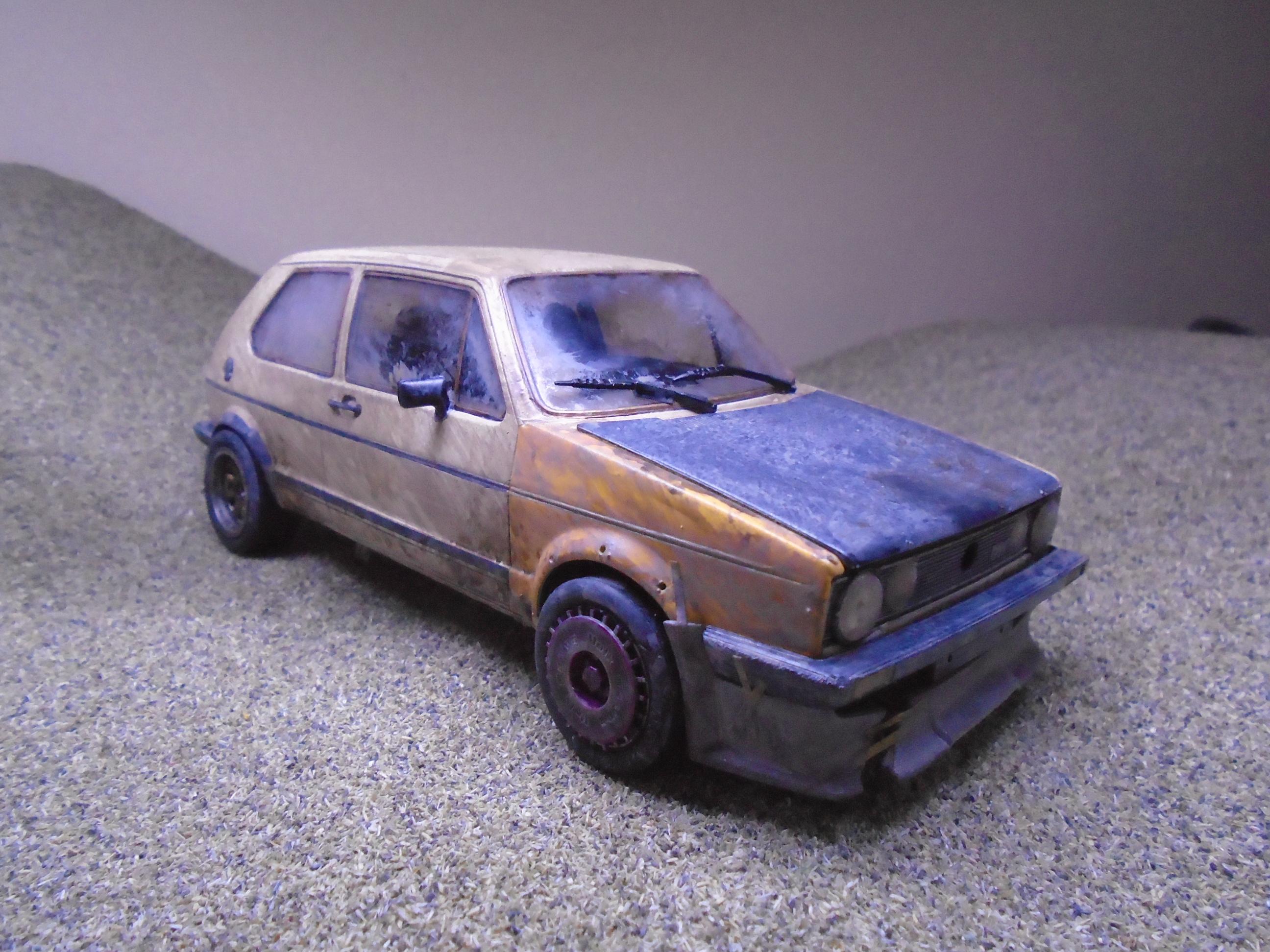

stitchdup Posted December 28, 2020 Posted December 28, 2020 I did this one with 14 wheels but I used the tyres from another kit (revell ford escort rally car). If you need a set of smaller tyres I am happy to send you a set that will fit 14-16 wheels that will fit the golf.
MatasKershys Posted December 28, 2020 Author Posted December 28, 2020 2 minutes ago, stitchdup said: I did this one with 14 wheels but I used the tyres from another kit (revell ford escort rally car). If you need a set of smaller tyres I am happy to send you a set that will fit 14-16 wheels that will fit the golf. thats a cool build, as this is my first build I dont have any parts hanging around, how much would you ask for tyres?
