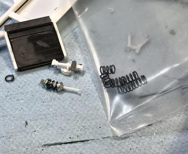

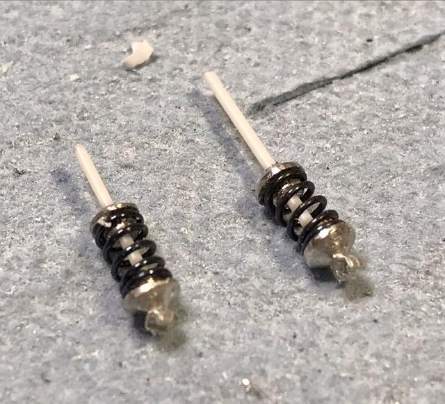

absmiami Posted April 23, 2024 Author Posted April 23, 2024 Mystery meat - no idea where these springs came from - ive had a small stash - hard to find scale springs with thick spring steel - but i got a few …
absmiami Posted April 23, 2024 Author Posted April 23, 2024 The A6GCS had shocks within the wishbones - they also had Houdaille dampers behind the wishbones - ill add those later - now to the radiator … 1

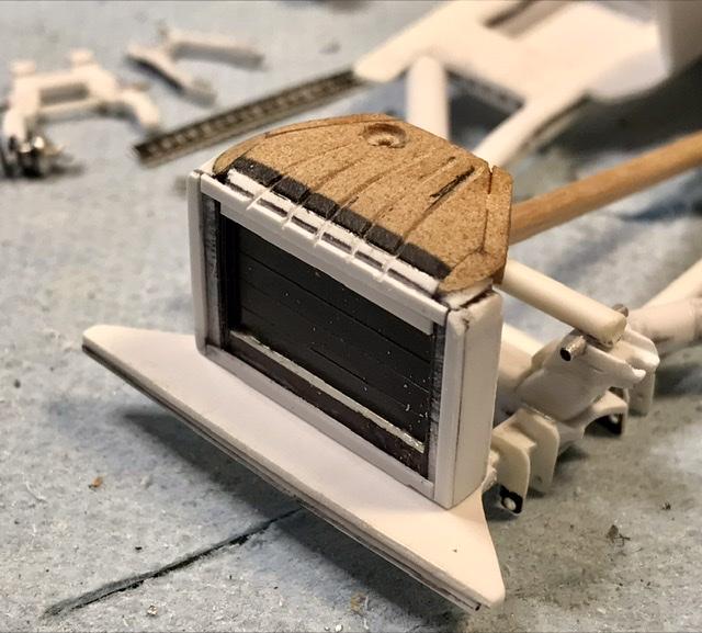

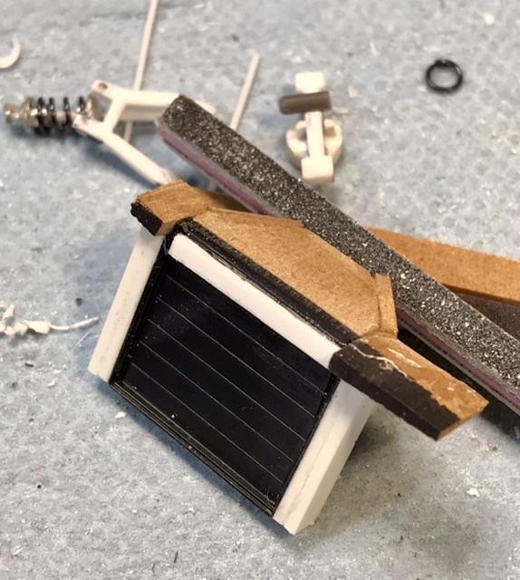

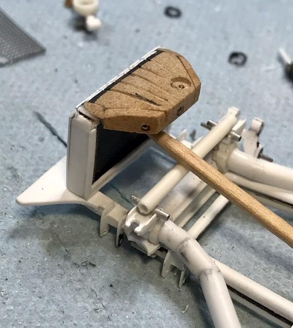

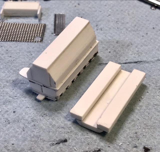

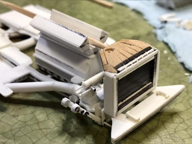

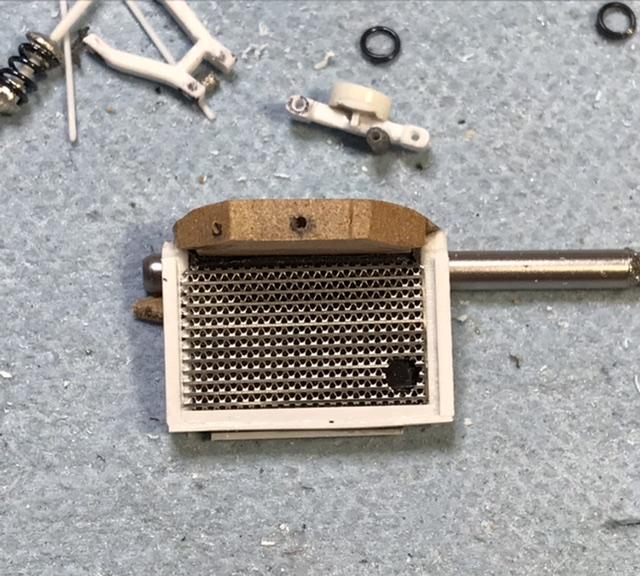

absmiami Posted April 24, 2024 Author Posted April 24, 2024 Maserati sports cars used radiators that had expansion or header tanks - similar to the Alfa open wheelers - the tanks were tapered - the radiators all looked alike - their dimensions varied depending on the engine size …. This one was made with spare parts, Evergreen strip, and a scrap of Renshape for the header tank -

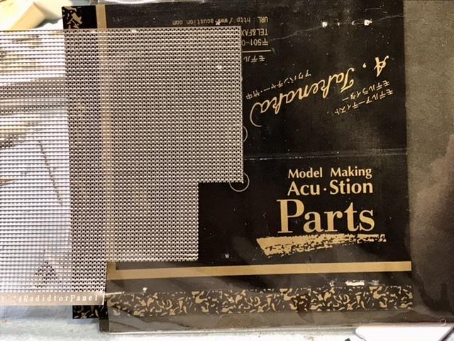

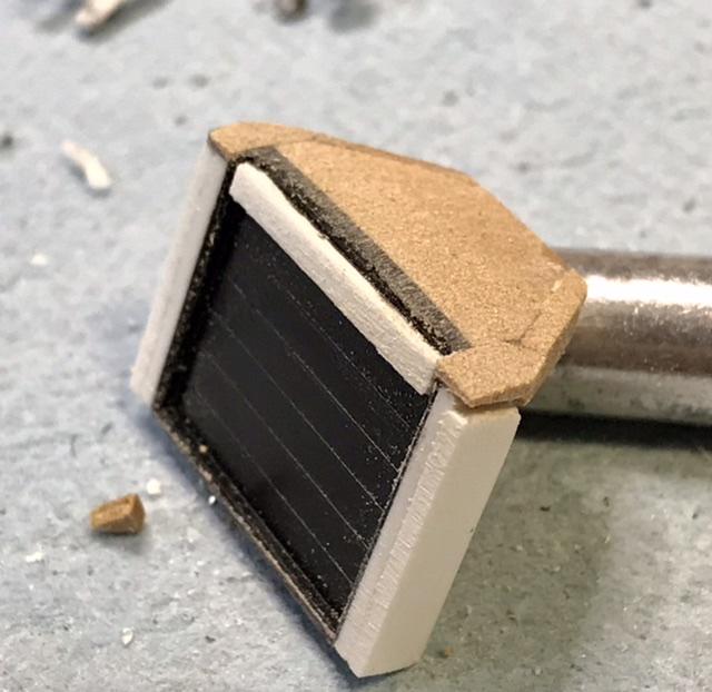

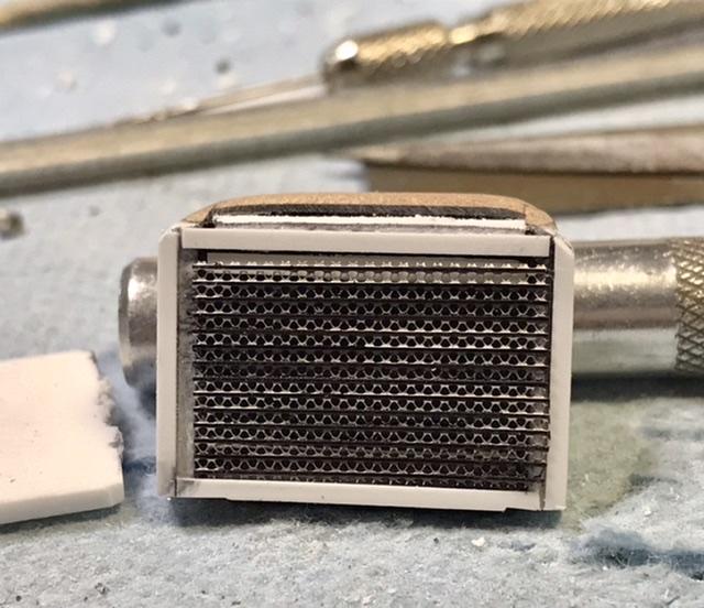

absmiami Posted April 24, 2024 Author Posted April 24, 2024 Some old stash photo-etch radiator screen - front and back

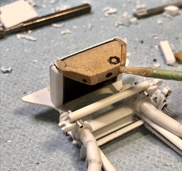

absmiami Posted April 24, 2024 Author Posted April 24, 2024 A few more details - and its done - will be painted silver …
kensar Posted April 25, 2024 Posted April 25, 2024 You've done a lot of work here. Interesting choice of material with the Renshape. I'm interested to see how you finish it.

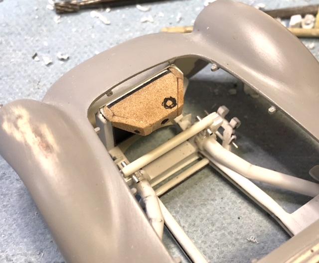

absmiami Posted April 26, 2024 Author Posted April 26, 2024 Re Renshape - the brown Renshape has medium density - so it is subject to scratches on the surface when you shape the part - not a big deal - just prime - that will reveal the scratches - a little more sanding - and then paint / treat like resin to finish …
absmiami Posted April 26, 2024 Author Posted April 26, 2024 The rad will need a little putty on the corners - not too much …

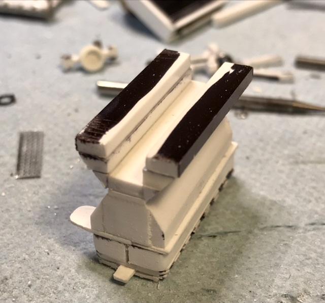

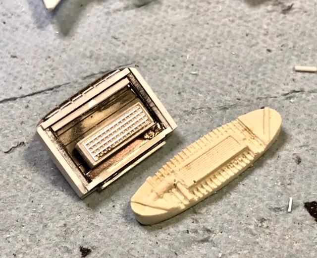

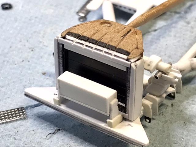

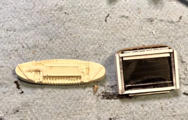

absmiami Posted April 27, 2024 Author Posted April 27, 2024 The Strada kit was basic but its creator took the trouble to add some cast-in features that were very accurate - like the oil cooler / radiator - so lets make one -
absmiami Posted April 27, 2024 Author Posted April 27, 2024 Evergreen and a strip of radiator photo-etch - will be clearly visible behind the grill - so worth the effort …

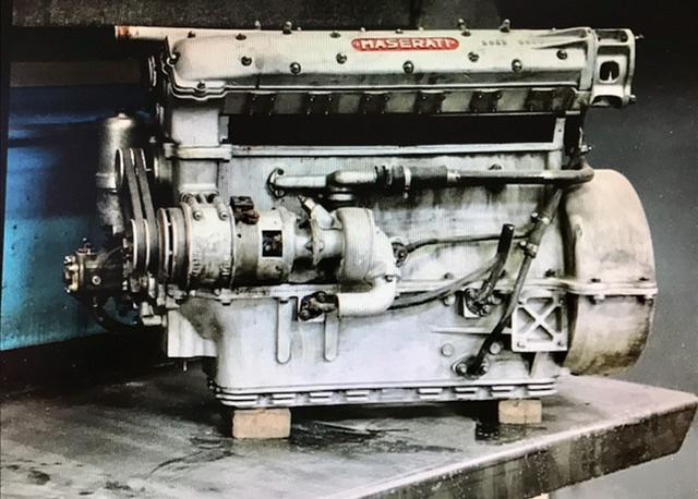

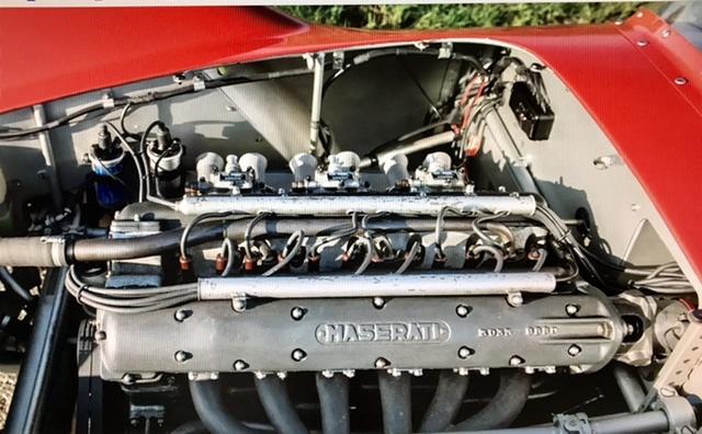

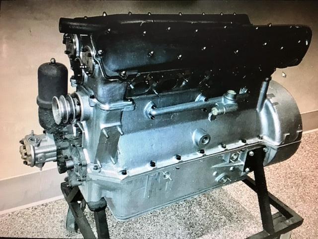

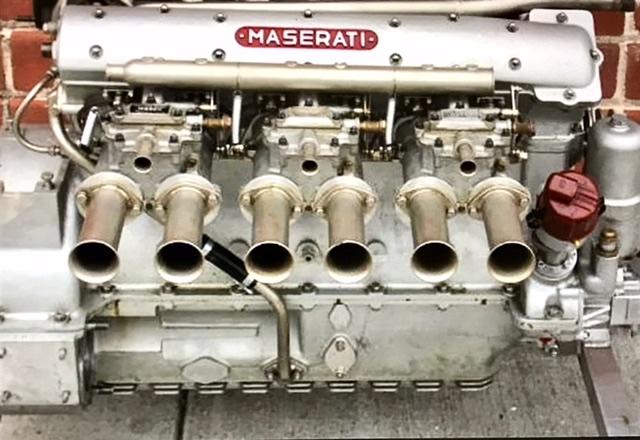

absmiami Posted April 30, 2024 Author Posted April 30, 2024 Over the years i have glommed a bunch of auction photos of the engine - these are two - so i know exactly what the engine looks like - i dont have measurements - but i can judge the dimensions roughly - im making an engine that will fit the engine bay - ill end up with something that is pretty close to scale …
absmiami Posted April 30, 2024 Author Posted April 30, 2024 The engine was a 2 liter DOHC straight 6 cyl with Weber carbs and dual sp plugs - one distributor perched on the forward right hand corner of the crank case and the second distributor attached to the end of the exhaust side cam cover - if there was a prettier sports car engine - ever - please post your competition -

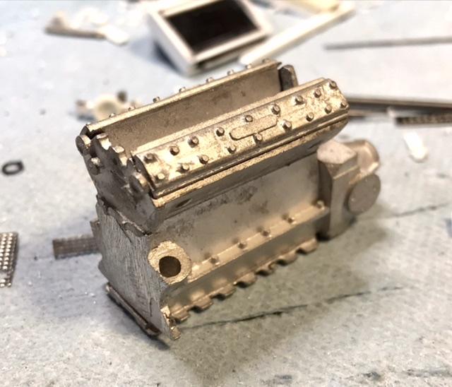

absmiami Posted April 30, 2024 Author Posted April 30, 2024 The old Western Maserati 250F wh metal kit has a slightly bigger DOHC six - it won’t fit in my A6GCS - but it will be my guide - actually I suspect that this kit engine is a little over-scale …

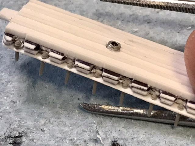

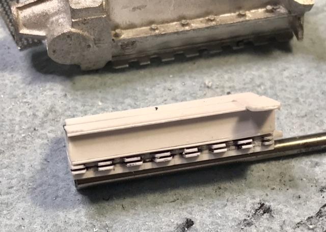

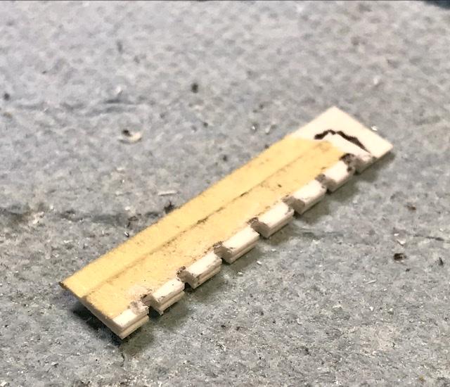

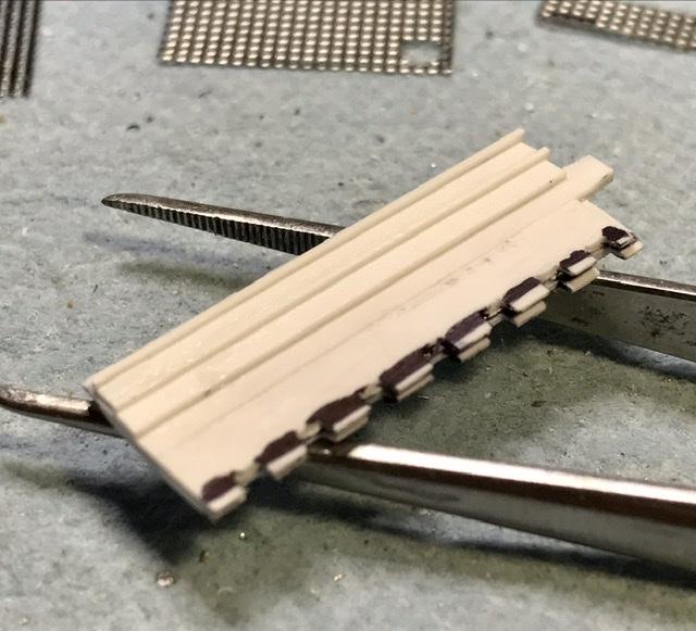

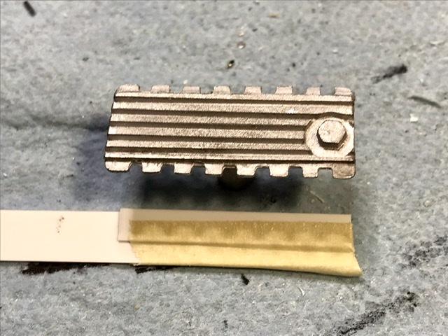

absmiami Posted April 30, 2024 Author Posted April 30, 2024 First things first - the A6GCS sump is finned and bolted like the 250F sump - so …

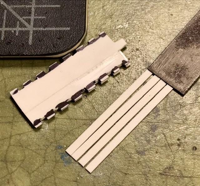

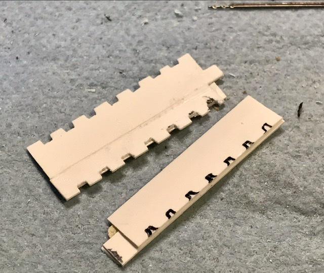

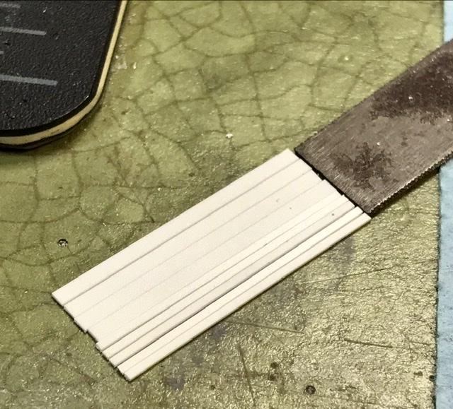

absmiami Posted April 30, 2024 Author Posted April 30, 2024 By filing the slots for the fins on 2 strips taped together I get slots that are aligned left and right …
absmiami Posted April 30, 2024 Author Posted April 30, 2024 Two layers of fins - made with .010 and .015 srtip - and strength ribs on the base of the sump …

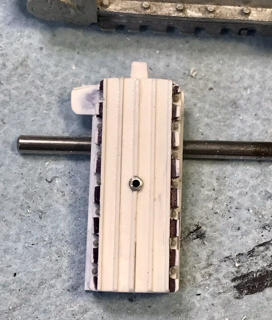

absmiami Posted April 30, 2024 Author Posted April 30, 2024 The tab that sticks out will be made into the forward engine mount … and the bolts within the fins are Master Club .06 resin bolts …

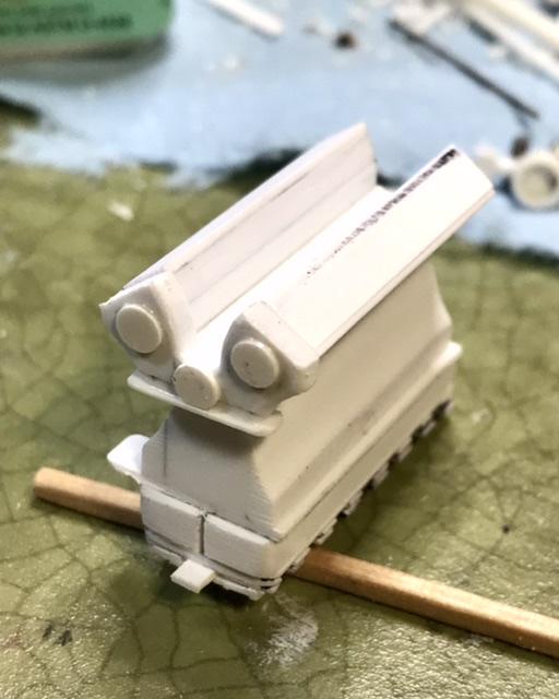

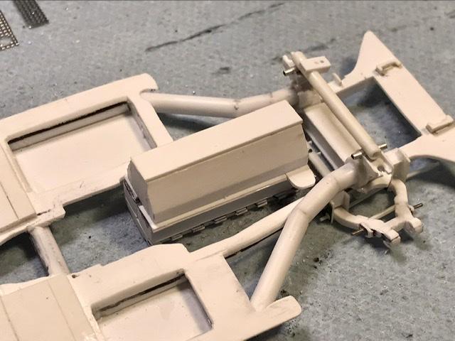

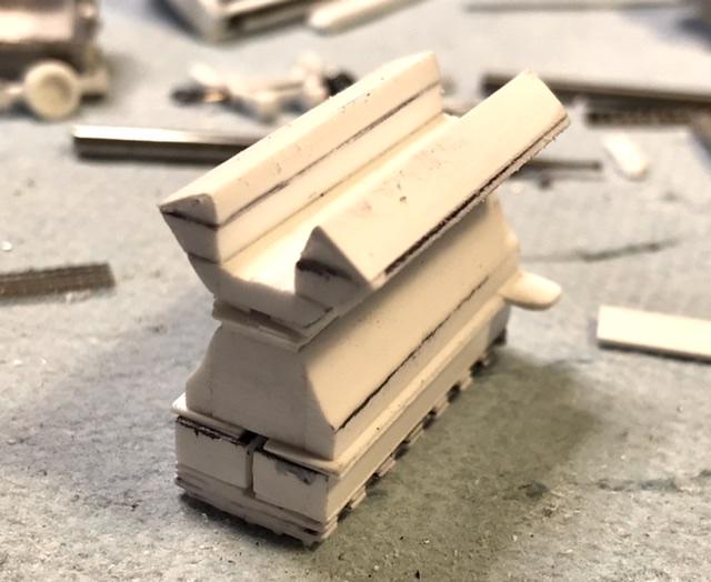

absmiami Posted April 30, 2024 Author Posted April 30, 2024 Larger Evergreen strip liquid glued to the base of the sump to grow the crank case and the block …

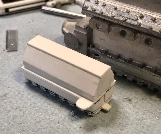

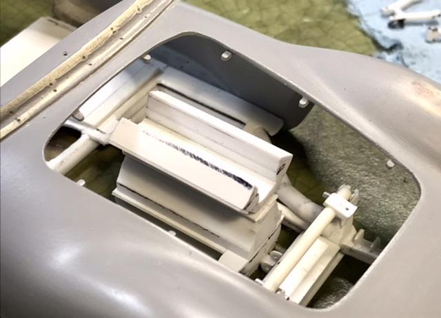

absmiami Posted May 1, 2024 Author Posted May 1, 2024 Growing the engine and checking its eng bay fit …
absmiami Posted May 1, 2024 Author Posted May 1, 2024 The cams are driven by chains mounted in front - got to make the chain cover before roughing out the cam covers …
