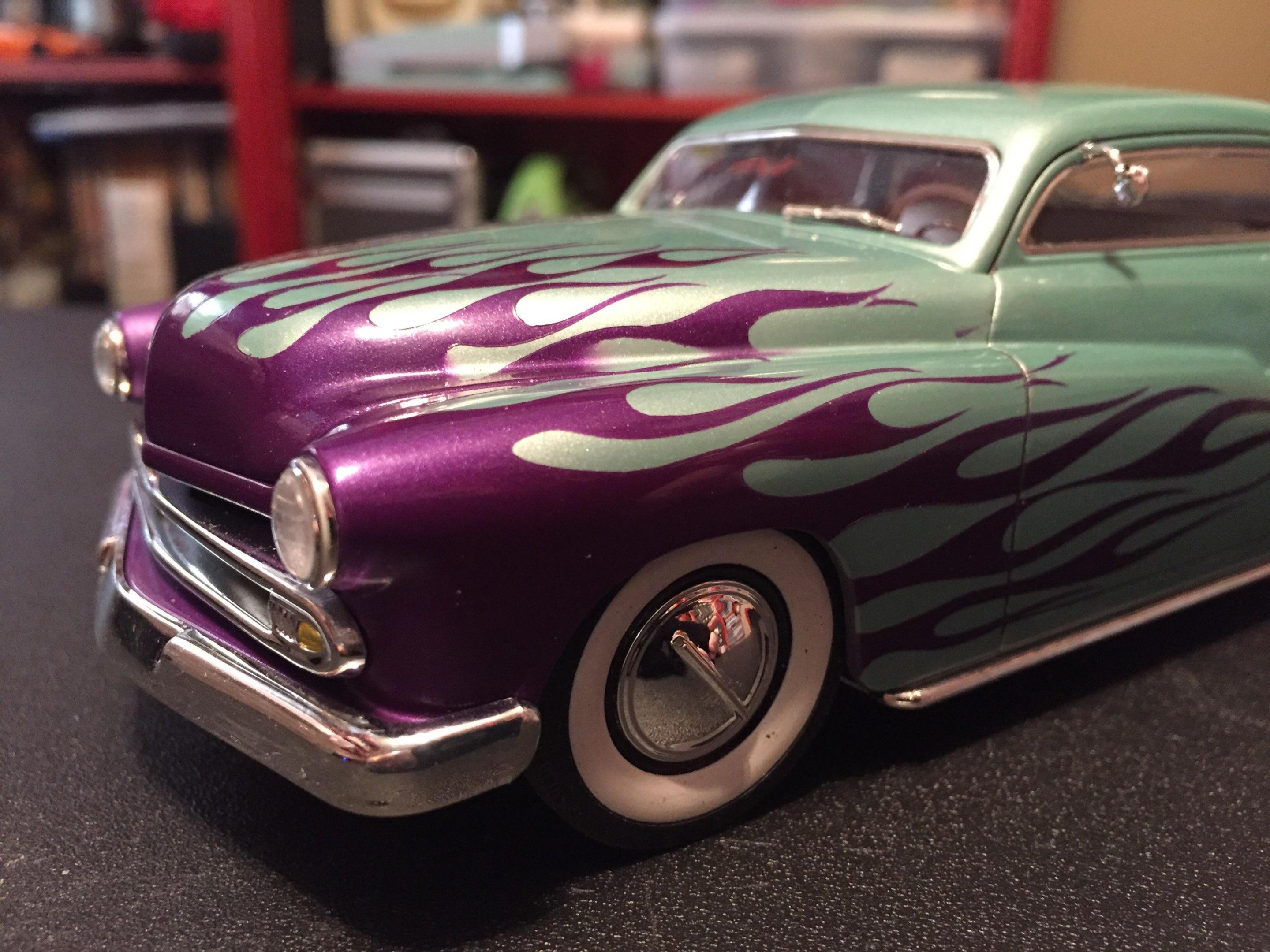

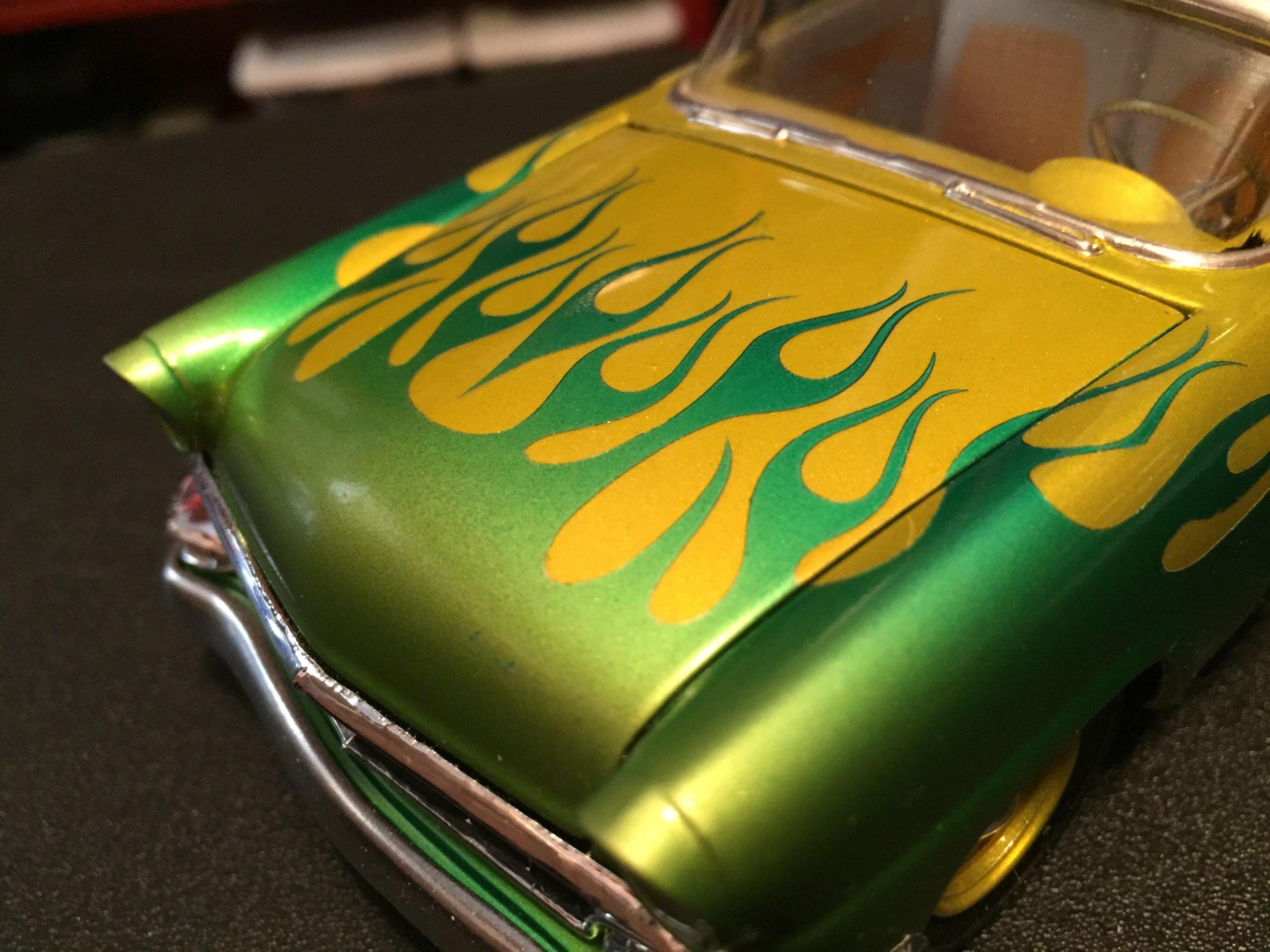

customline Posted January 14, 2022 Author Posted January 14, 2022 Here's a couple of shots of the first two. The Merc makes me very happy although the alignment of the mask segments was a bit off. The mask was a big hassle but I managed it somehow. But everything after that was pretty smooth and I'm happy with the whole project. The '56 became too much with opening doors (that I regret reversing). Masking over opening doors is to be avoided. ? . The flames seem a bit thick even though I tried to keep it thin. I did nothing afterwards to smooth it out for fear of screwing it up.i guess I still could?. 1
