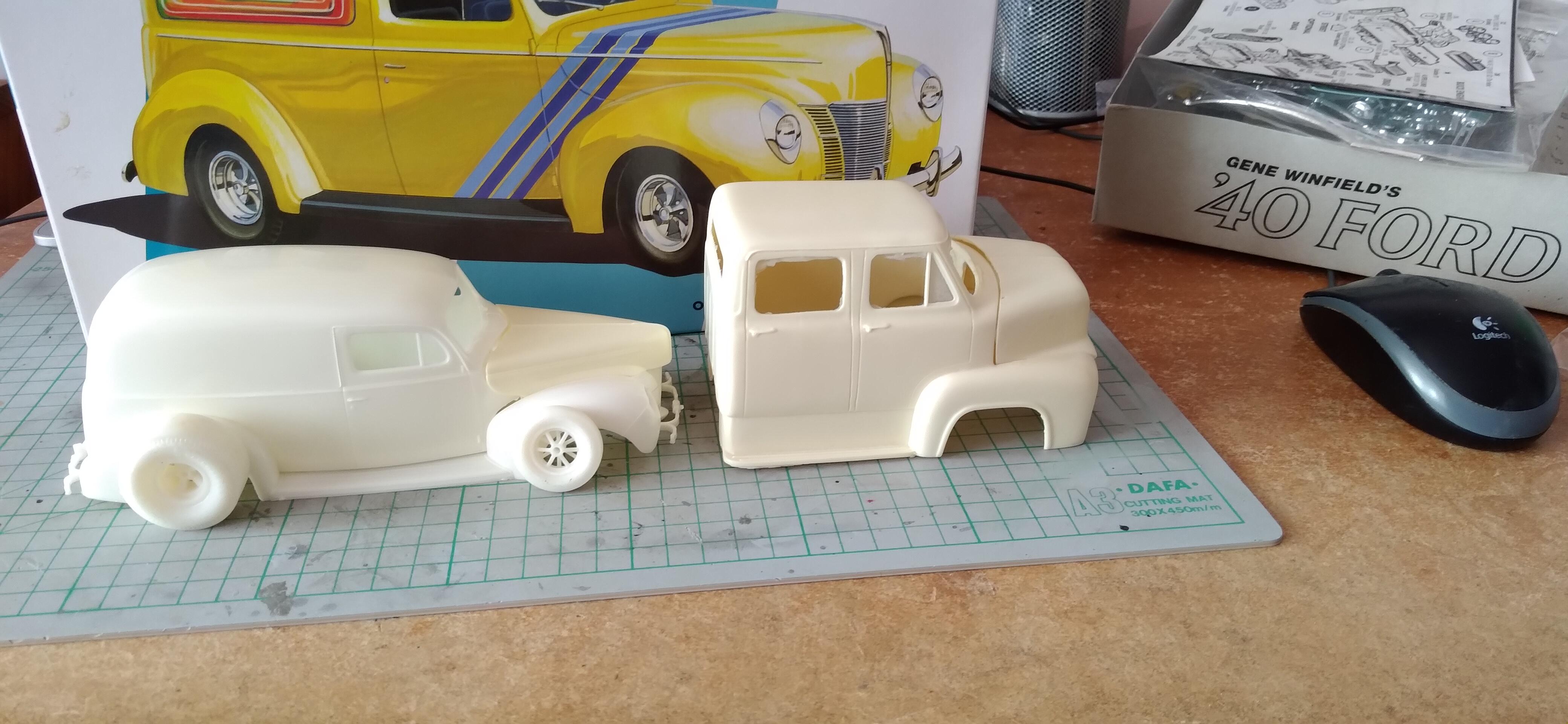

I am looking for help with the dimensions for the Ford C600 chassis, from the stakesides or Hostess Cakes kits. The plan is to build a COE car transporter for the '40 sedan delivery. The Jimmy Flintstone COE Ford is a crappy molding but its what I have to work with. Rather than trying to scratch a chassis and not wanting to "kerbside" it I am looking for a donor kit to go under it. I would like to know the length of the chassis and if anyone has them some phots of it as well please.
