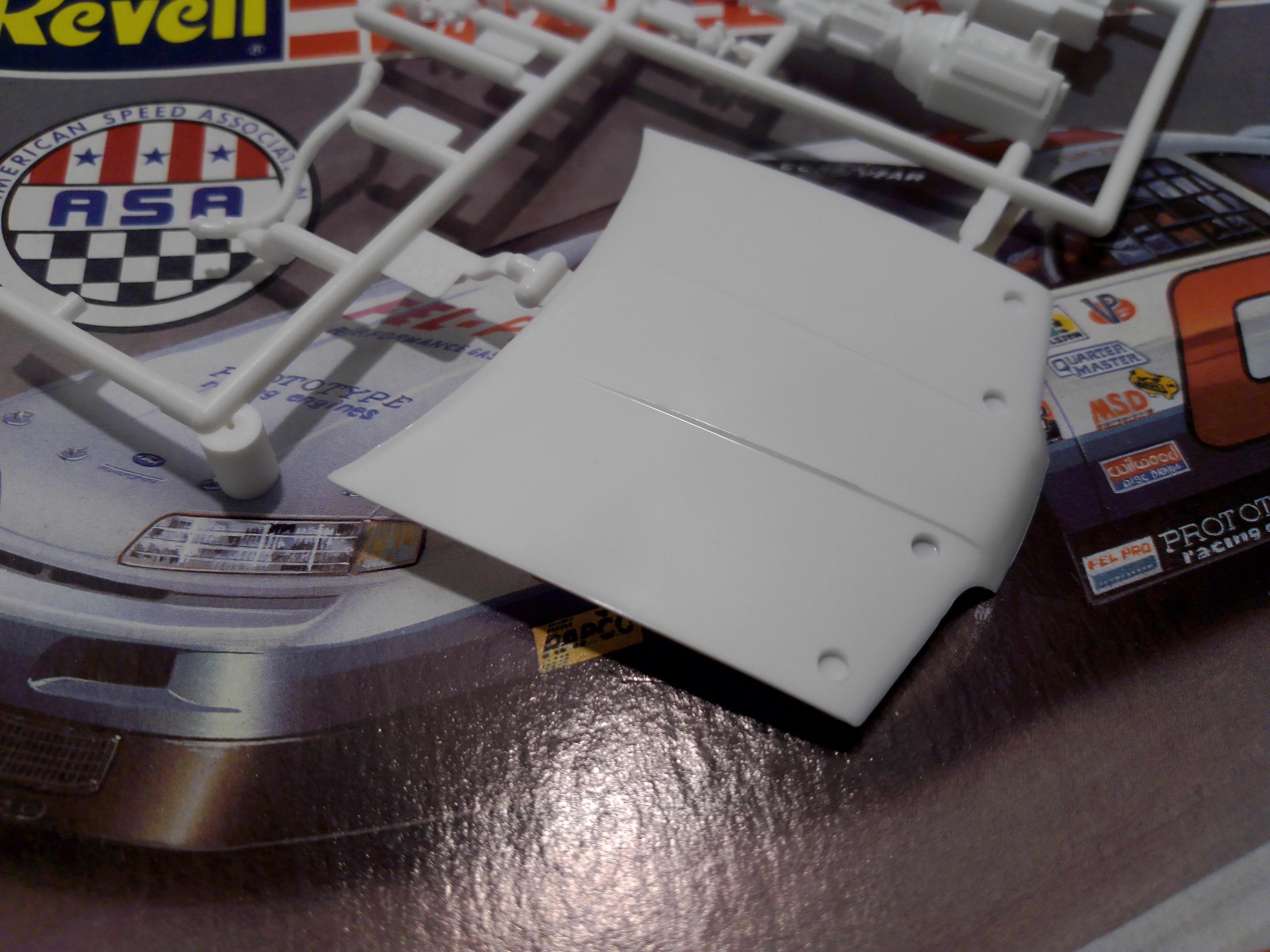

The image, the hood is from an ASA Fel-Pro T-Bird.
If possible how would I make a replica? A cast of it perhaps?
I have an old built ASA Zerex T-Bird without a hood. Lost in time somewhere.
It's a tricky shape,centre ridge and with a slight lip at top edge.

'Twere it me, I'd make a fiberglass mold, and make a very thin repop from glass in that.
But since, far as I know, I'm 'bout the only person doing that, it's probably not much help to you...and most people just don't have access to the materials I use.
Normal mold making and part casting, below.
Free video how-to library from a company that makes the silicone for molds and the resins for parts.
https://freemanvideos.com/Moldmaking-Casting/
Have been researching more on this.
Viewing more videos and the cost of moulding supplies here in UK, not so expensive.
I assumed costs would be sky high. Unless I make many mistakes.
Will consider this, learn more on similar mouldings like this flat and thin hood.
