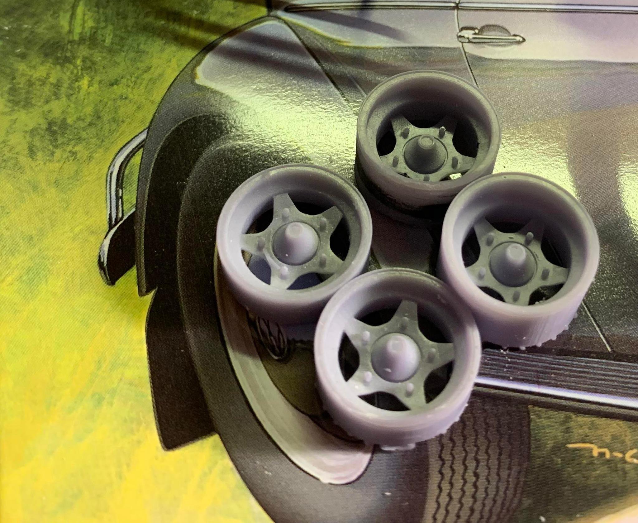

I started on this at the end of October. I had just released my new Jackman rims and was looking for something to use them on. Charles at Texas 3D Customs released his transkit for the Revell bug to make it a Baja and I had also already downloaded the Black Box VW engine files and had several printed and waiting to go into my next project. So those items are the inspiration for this project!

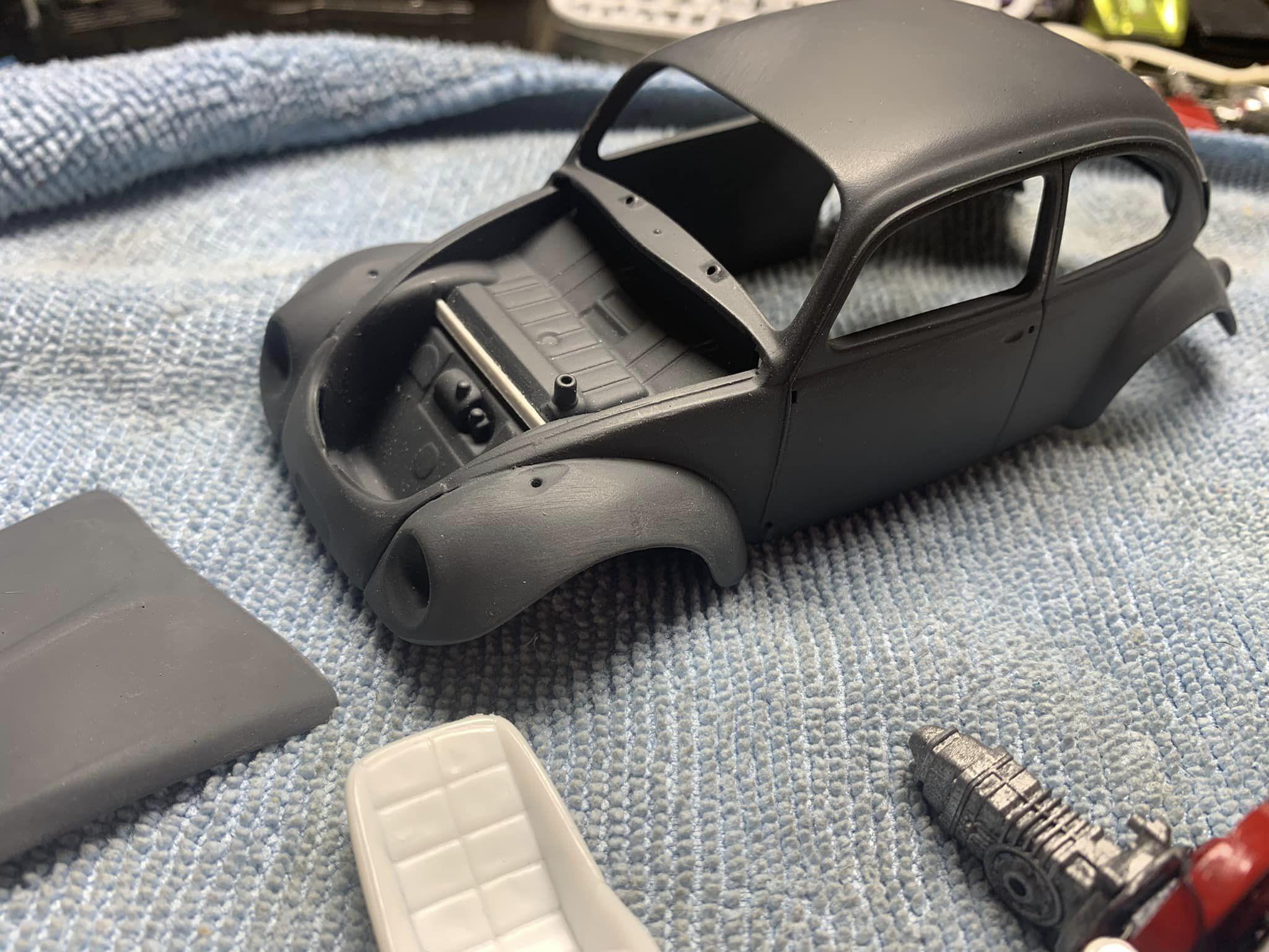

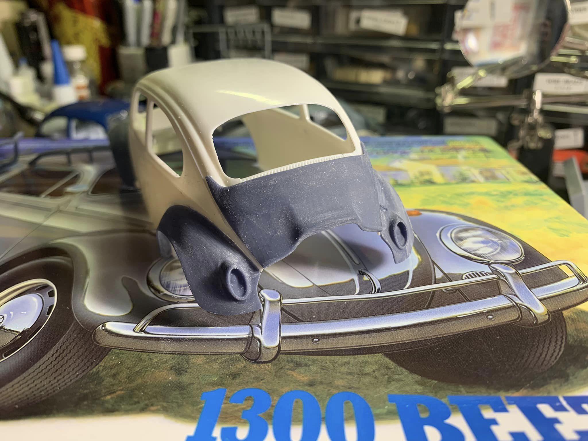

Changing the base model to the Tamiya kit had a few fitment issues but nothing that can't be overcome. I spent maybe an hour or so cutting, sanding test fitting before I glued everything in place.

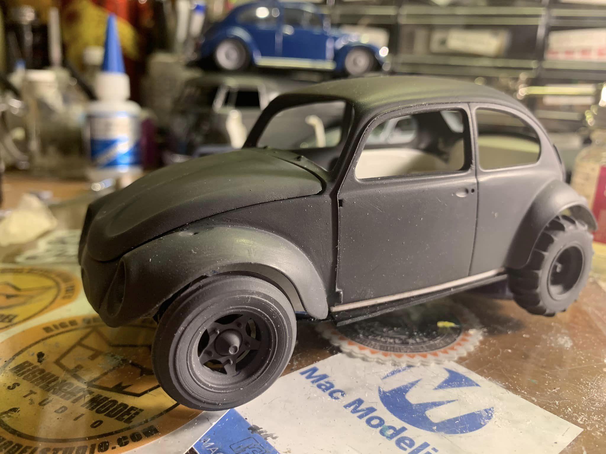

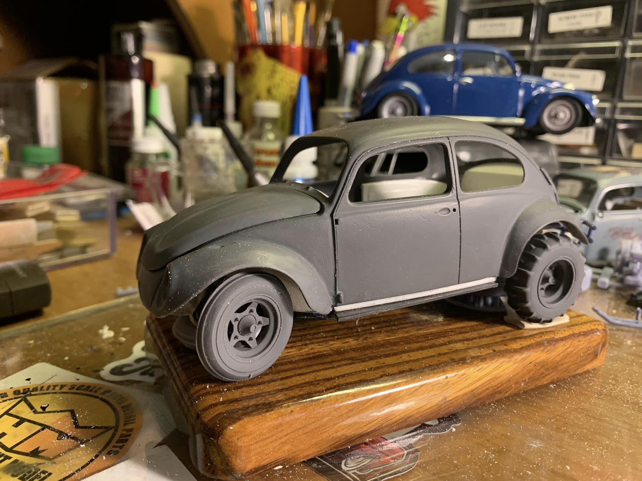

I was able to prep the body for primer and find a nice set of truck pulling tires on Cults that I scaled down to fit my rims and to look proper for a sand baja bug. I think in all I applied 3 coats of primer to the body, sanding between each to get rid of the very faint lines from the 3d printer.
These photos also show a mockup of how I was hoping the ride height would look like when finished.
  • Like 2

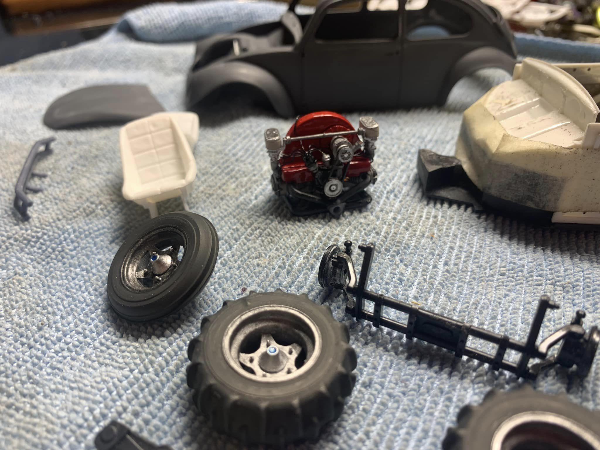

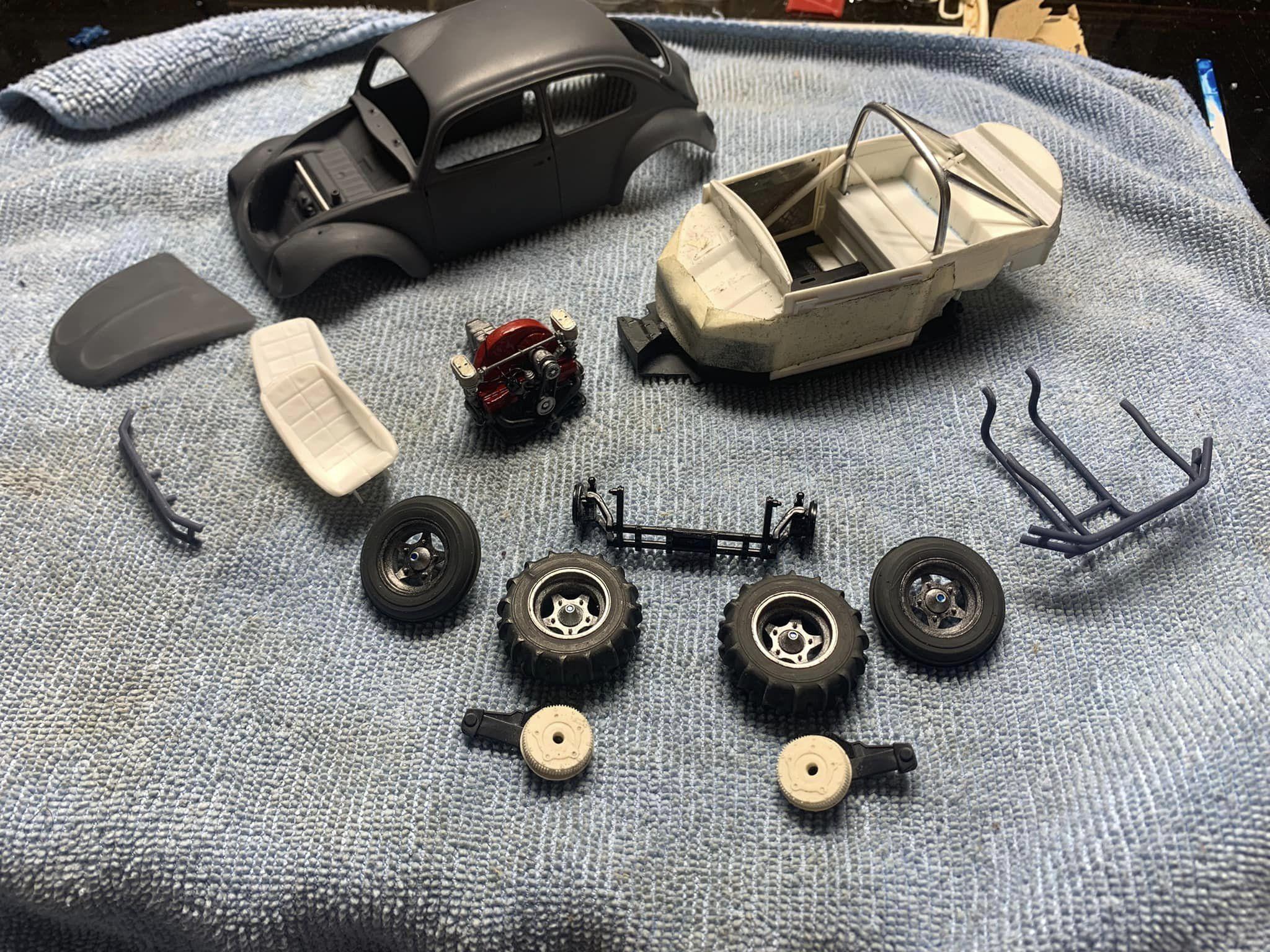

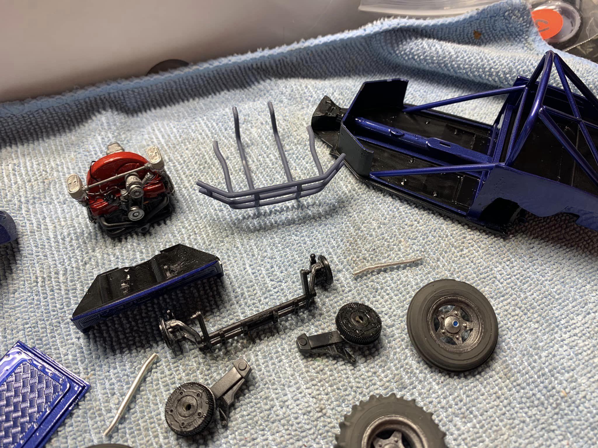

Final sand on the body, assembling some of the sub-assemblies - engine, front beam, rear brakes and swing arms, painting the tires and wheels. Also sourced a set of seats from the parts bin.

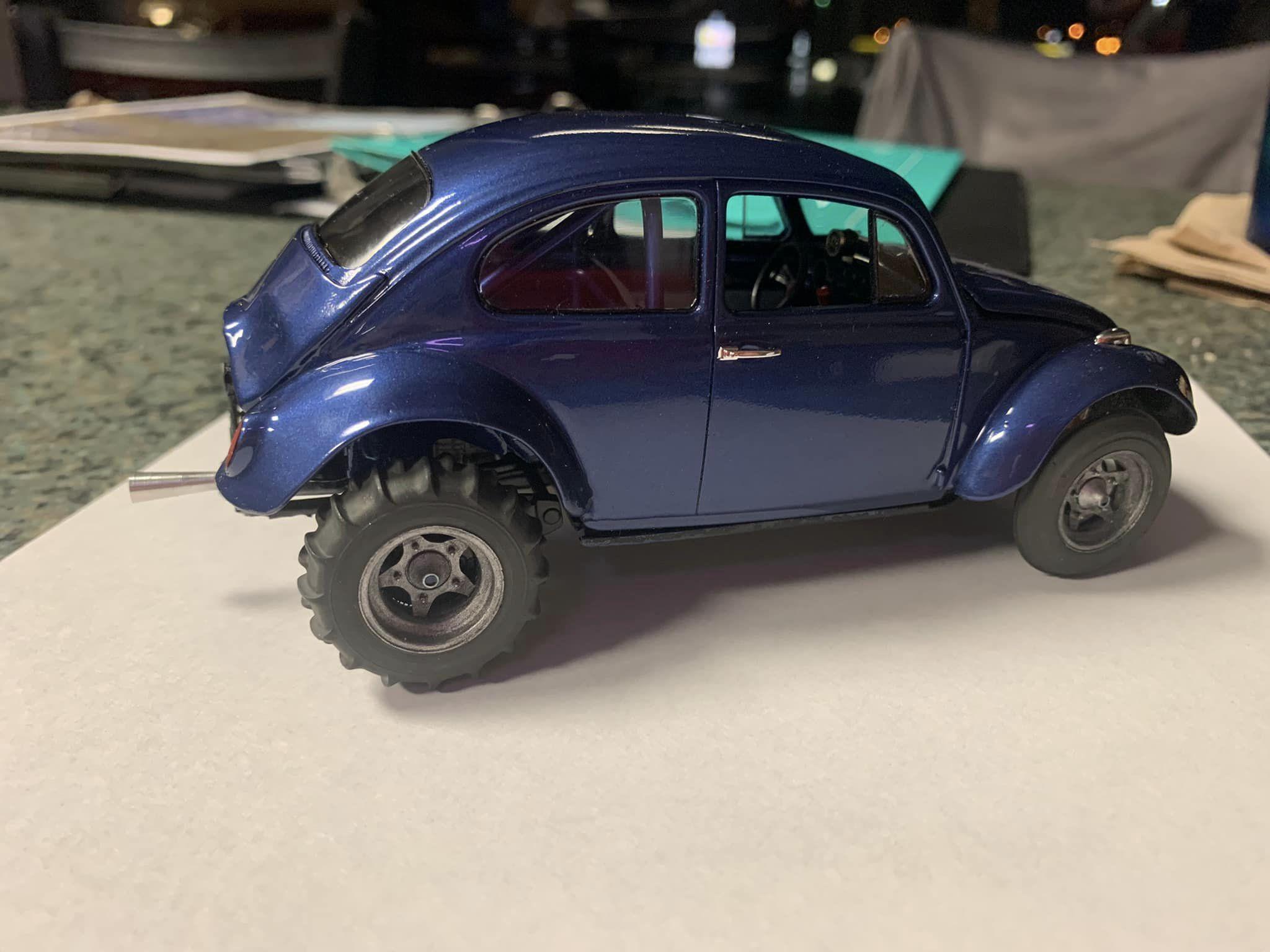

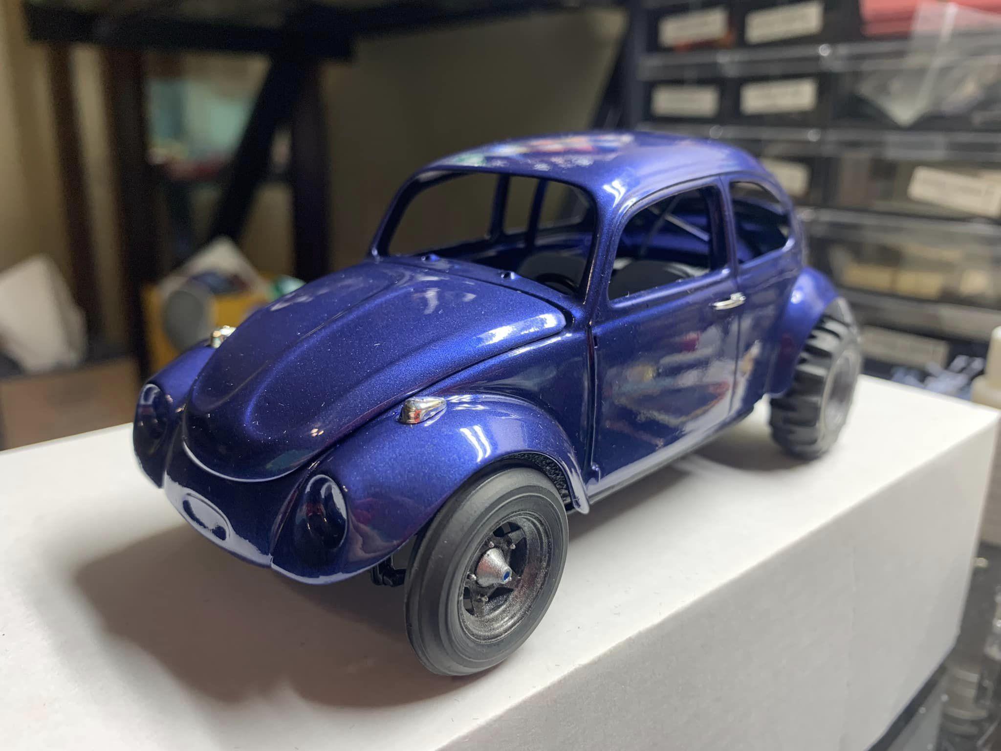

Final assembly done, and model completed this past weekend.
Details:
Tamiya kit
Texas 3d Customs Baja transkit
Finks Garage rims and tires are from COSPLAYITEMSROCK on Cults.com
Splash Paint & clear
Mr. Model tach and stinger
Black Box 3d printed engine

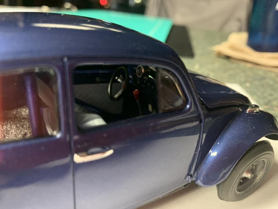

Detail Master steering wheel
Parts box seats
Scratch built roll cage & rear seat delete

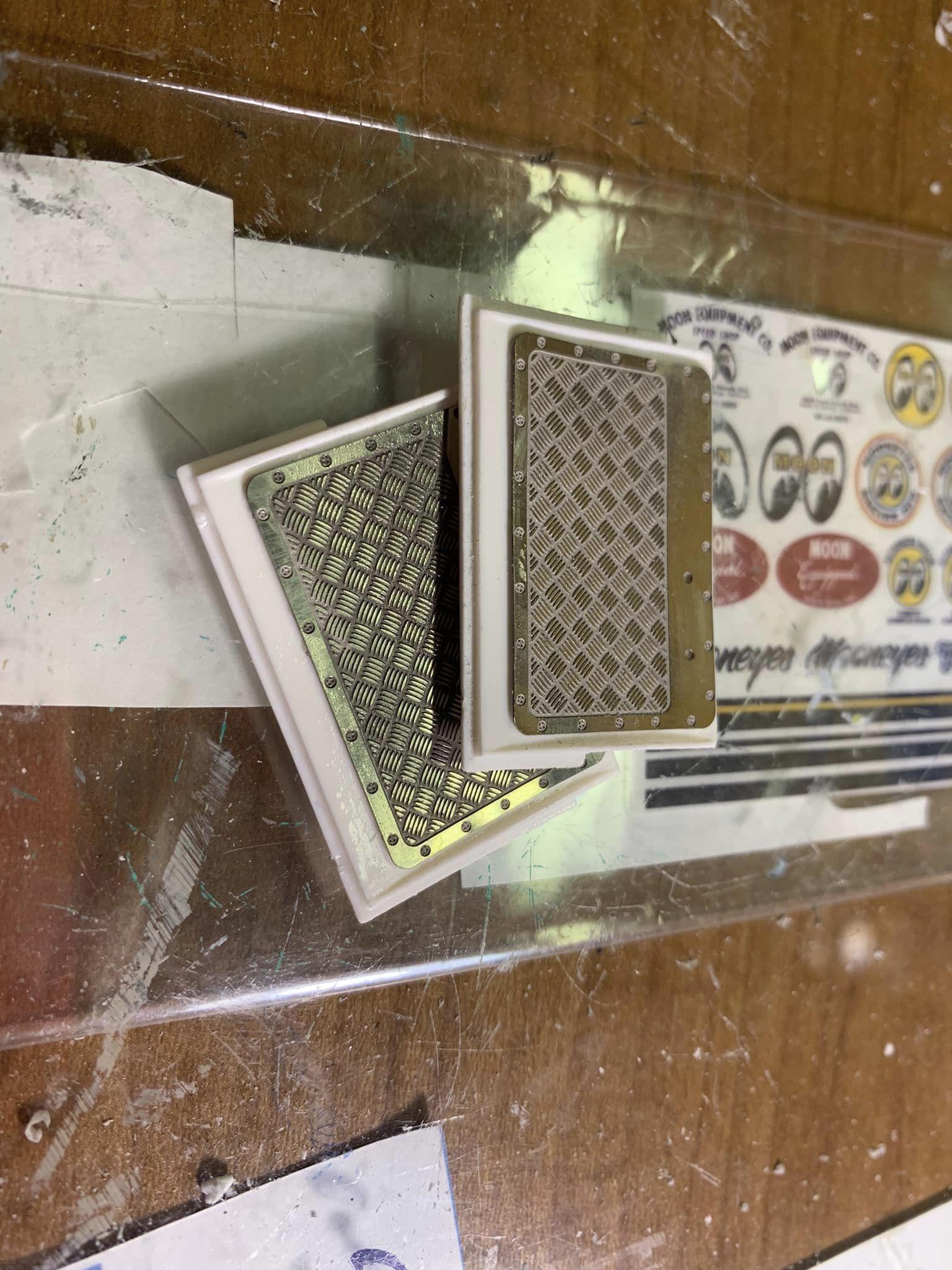

Highlight Model Studio door panels
Detail Master photo etched window cranks and door lever
