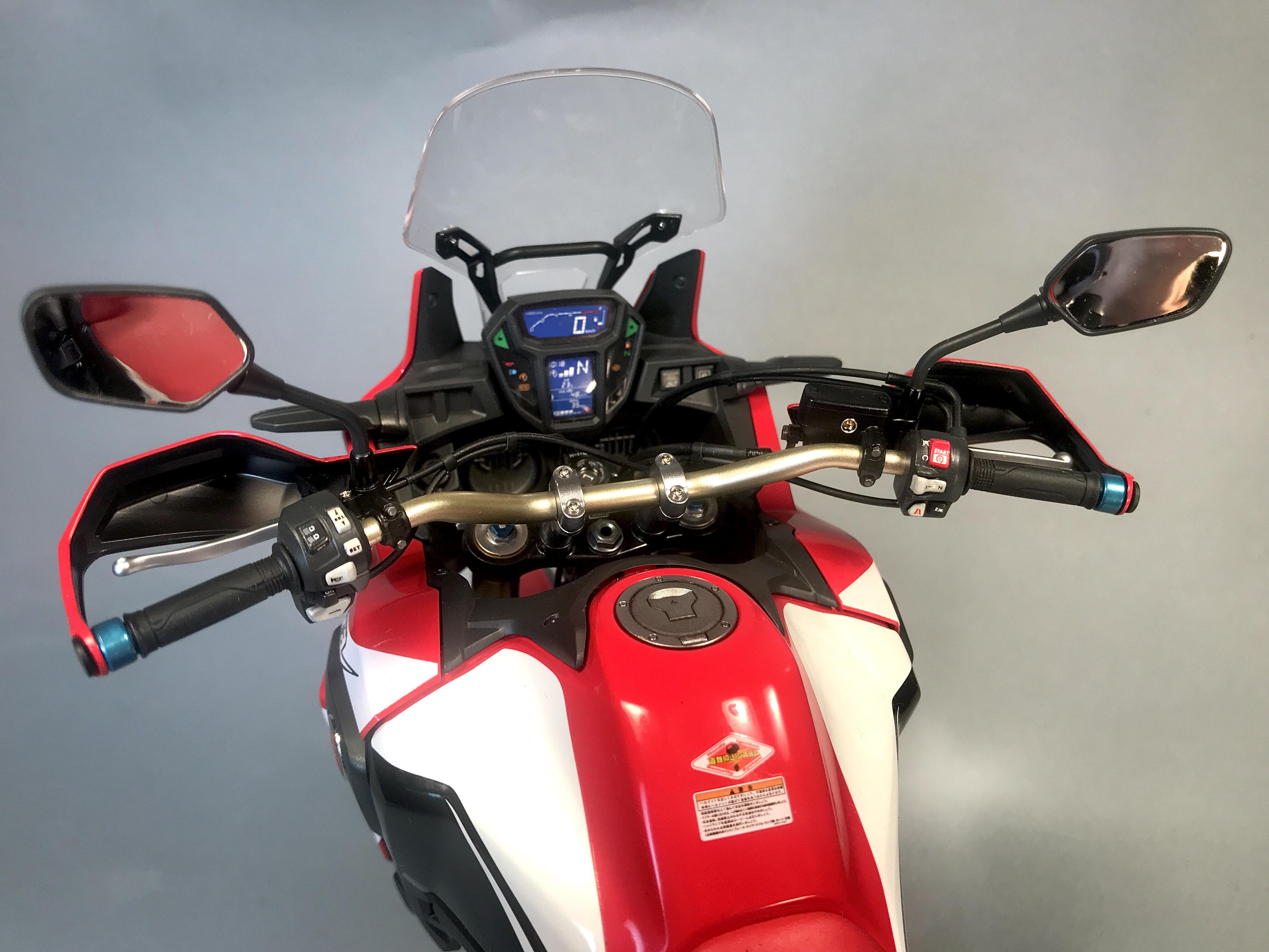

Wolf Posted March 14, 2023 Posted March 14, 2023 (edited) Hi Mark, This kit is, in my opinion, the best of Tamiya’s 1/6 scale bikes in terms of what you get in the box. I’ve built a few and still have a couple in the stash. Of course it’s Tamiya’s latest bike kit so it benefits from all the newest model making technology. I built the kit a couple of years ago and was particularly impressed with the rims and how delicate the spokes are moulded. I opted for the detail-up chain as I wanted the chain to move with the rotation of the rear wheel and in the end it looks far more realistic than the kit piece. The only detail I added to the build was the missing fluid level sight glass on the front brake fluid reservoir and the stencils on all the control switches on the handlebars. If the kit has a short fall it’s the lack of data stencils for all the function switches on the handle bar controls. In 1/6th scale I think it’s an obvious omission as the details are large enough to notice especially with the kit already being so detailed. I used lots of bits and pieces of decal from multiple sources to make up the stencils. The symbol on the horn button was 3 separate bits of decal that came off a 1/72nd scale WW I German aircraft data stencil sheet! I hope you don’t mind me posting a photo of my build that shows the added data stencils. Cheers, Wolf Edited March 14, 2023 by Wolf 2

Wolf Posted March 27, 2023 Posted March 27, 2023 Nicely done so far Mark, This build definitely evokes a strong sense of deja-vu. This kit was definitely one of my very favourite builds. Cheers, Wolf 1

Wolf Posted April 8, 2023 Posted April 8, 2023 Beautiful work so far, Mark. Isn’t it a nice refreshing build where everything is relatively straight forward? No major modifications necessary, just paint, glue, and assemble. Tamiya sure delivered with this one. Cheers, Wolf 1
