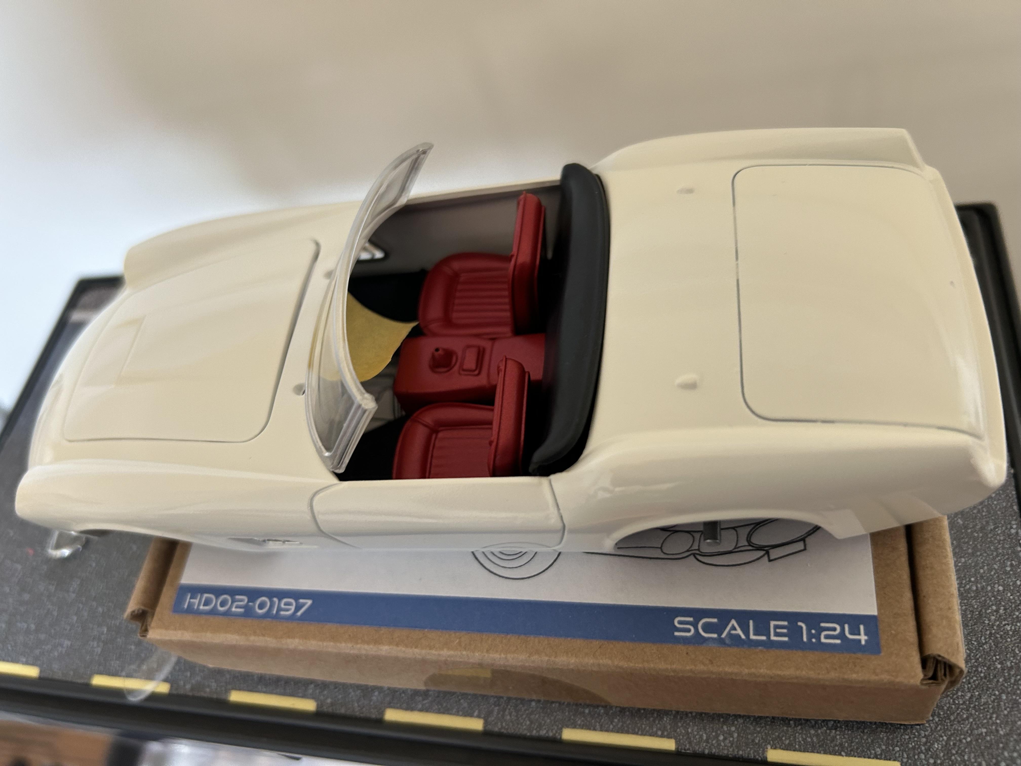

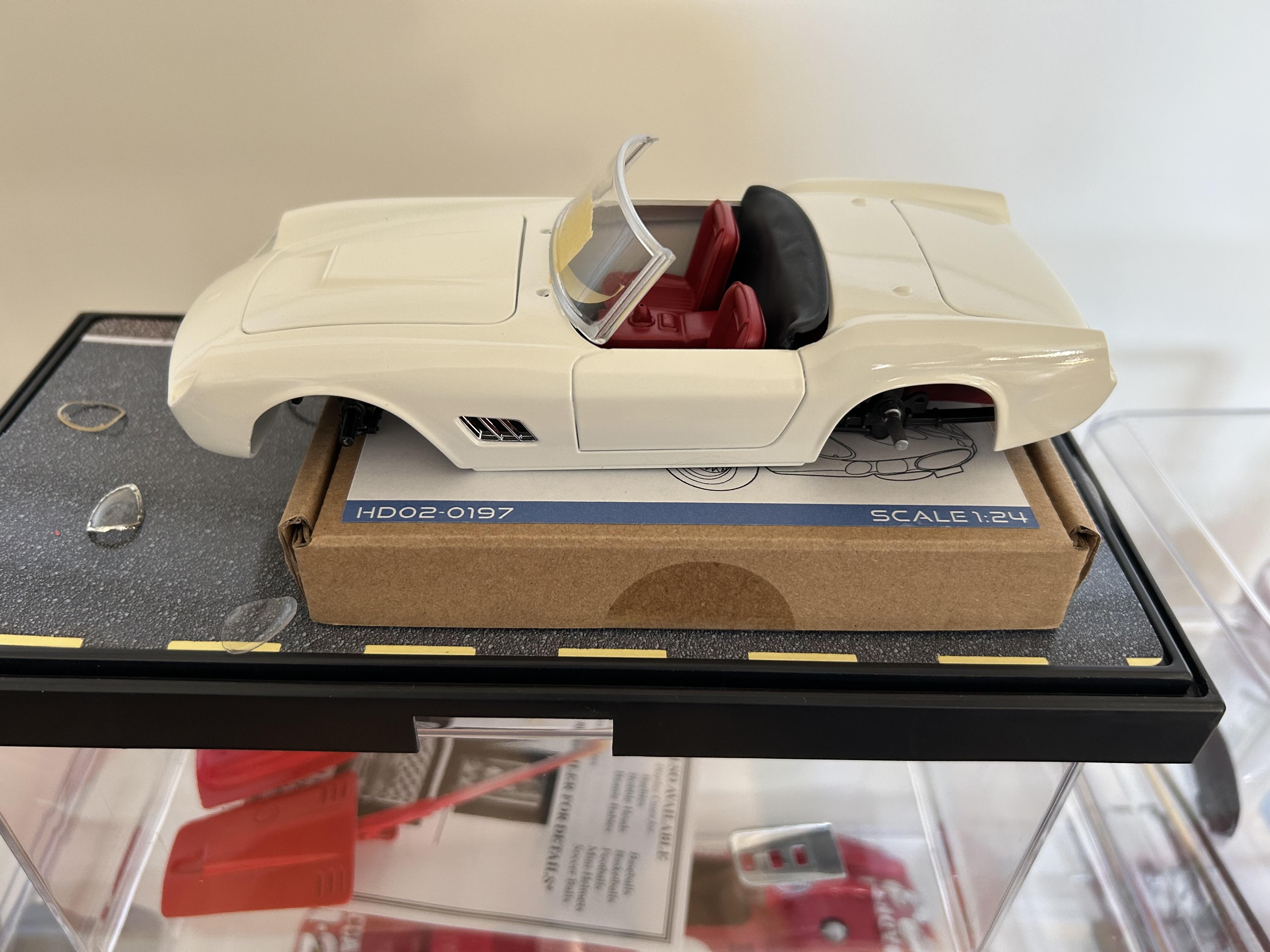

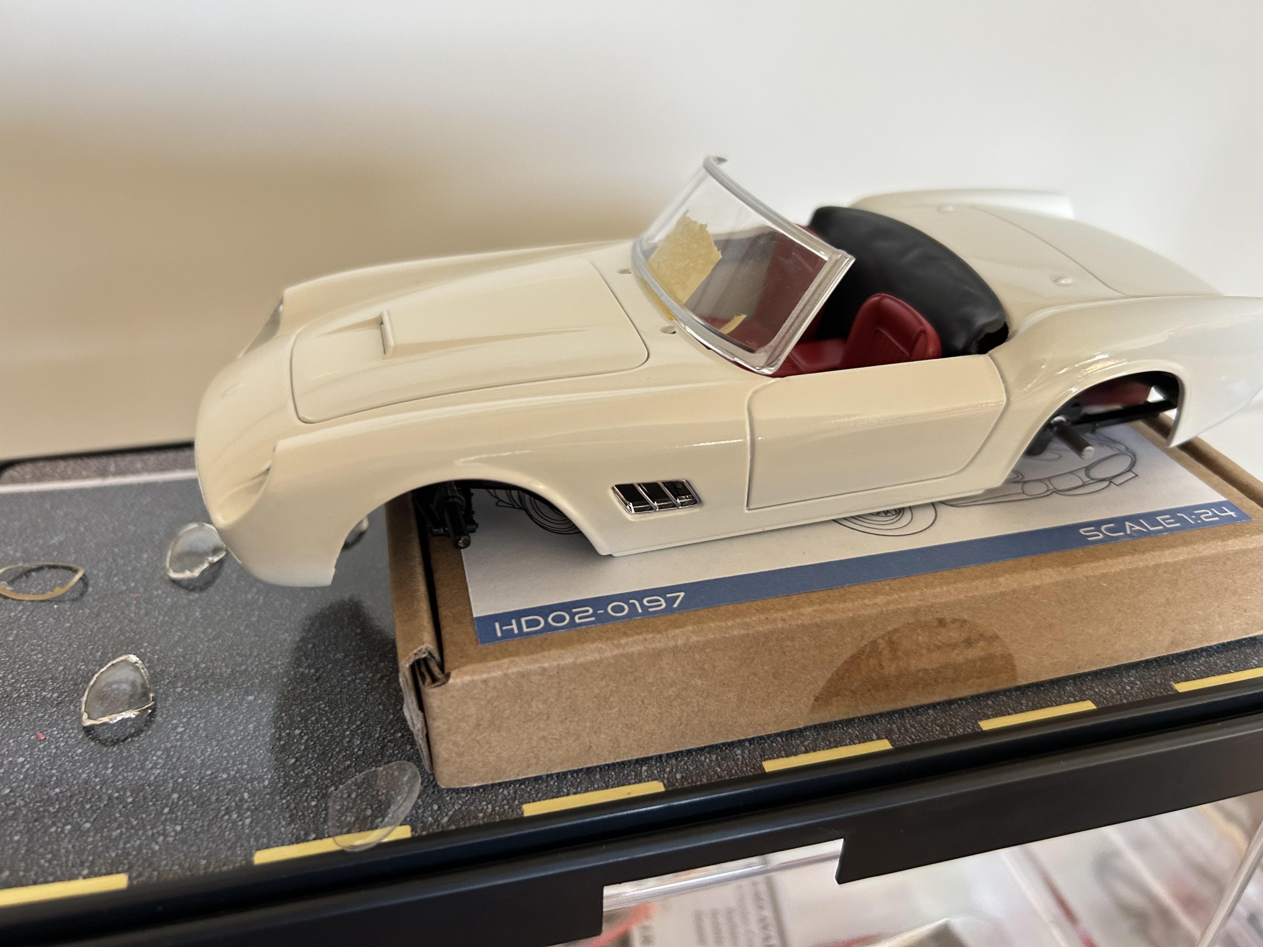

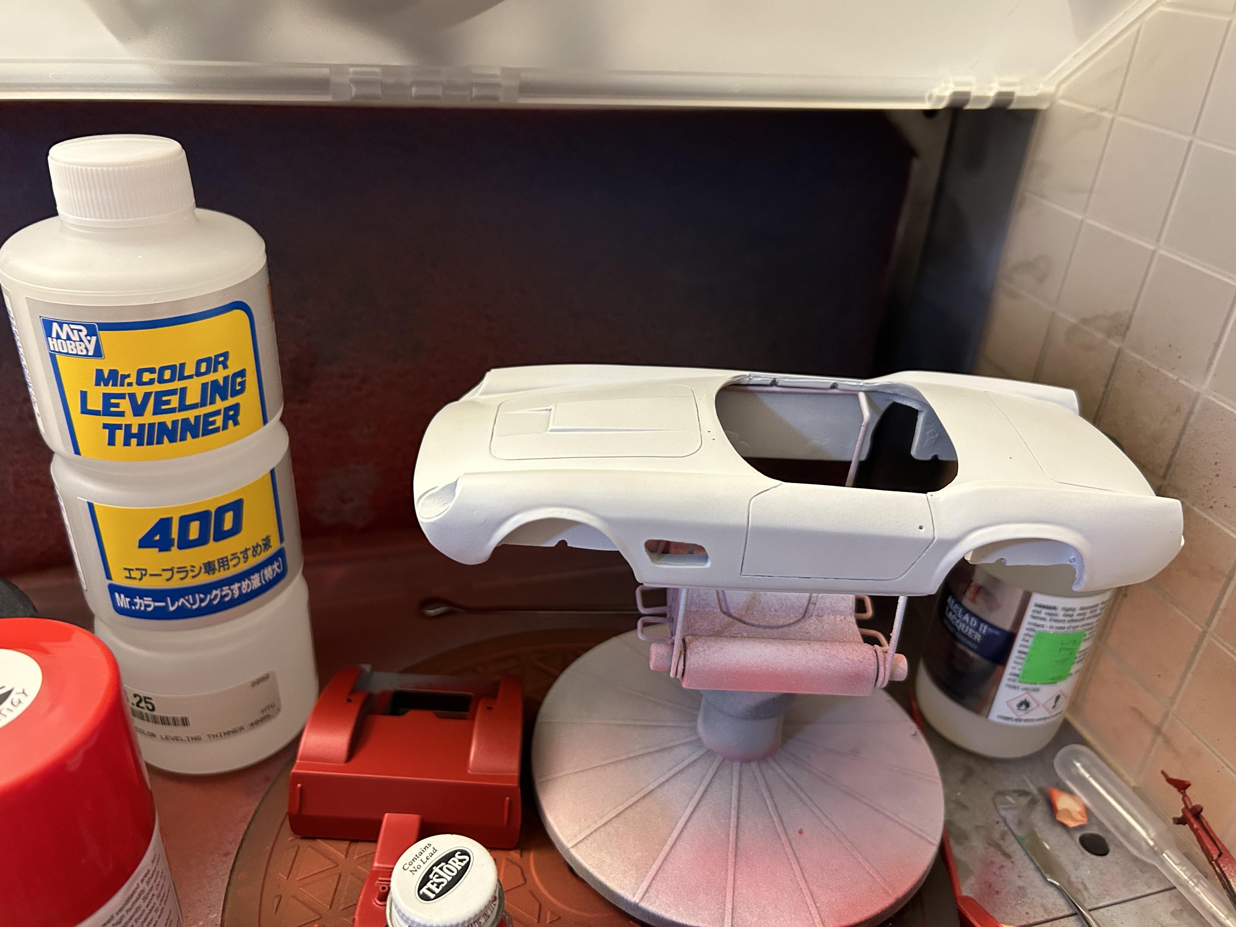

The color is a mix of tamiya lacquer paints white and racing white.  I believe I settled on 50/50 mix.  Then thinned 50/50 with lacquer thinner. (Mr hobby leveling thinner) Sprayed several coats followed by airbrushed tamiya clear lacquer.  The tamiya bottled lacquer paints are great.  I am new to airbrushing and they go in super smooth.  Much better than spray cans. You can order on Amazon if your local hobby shop doesn’t carry.

Glad to see non-red Ferrari!  They both look great!  The off white has the classic feel, I like it!

It will be a copy of restored chassis #2015.  Ran in 1960 lemans.
Sorry should have read mr color leveling thinner…

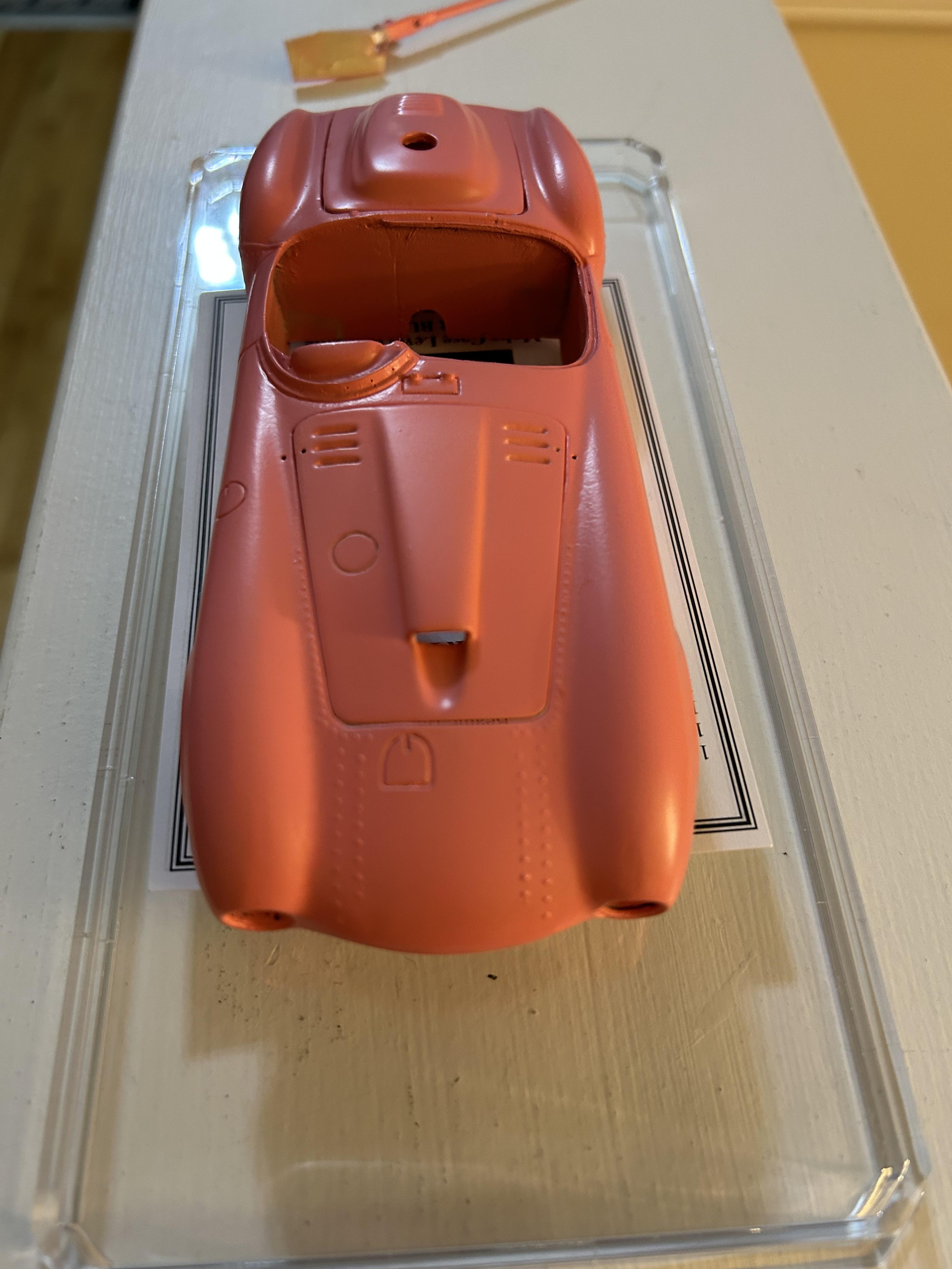

A third Ferrari in process.  Renaissance Ferrari 250 California.  Filled in defects under front and rear with 2 part epoxy.  Removed extra lip where windshield attaches primed with gray and white primer
