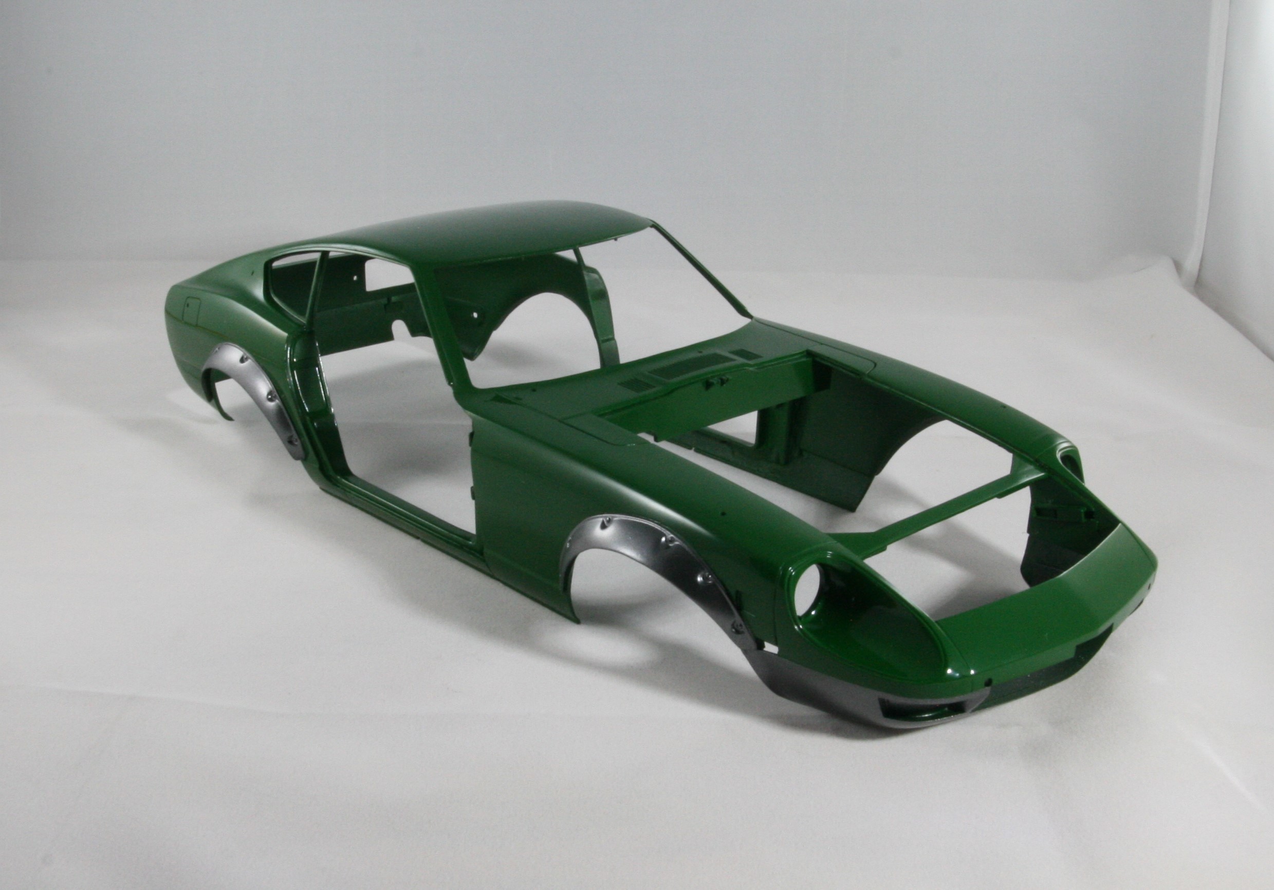

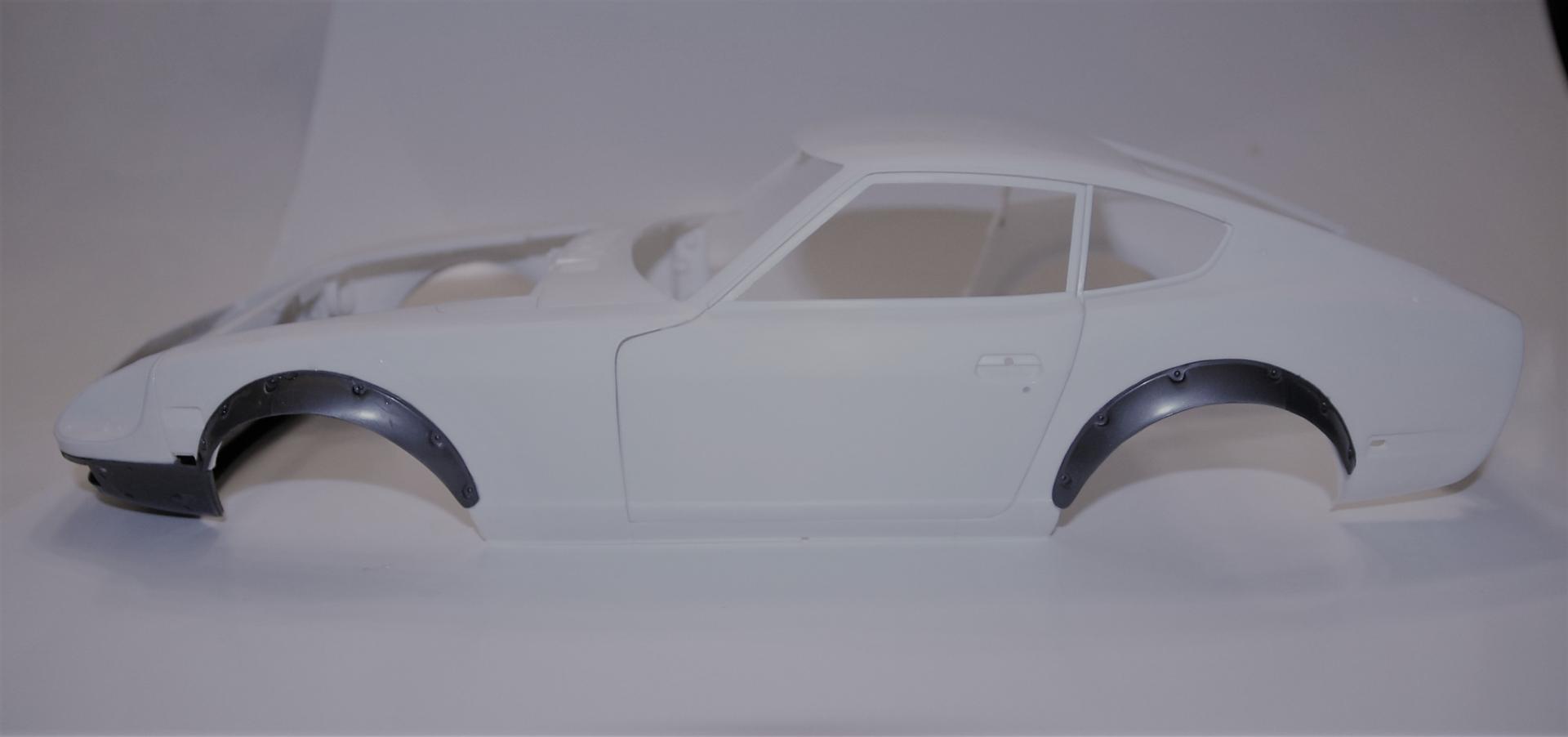

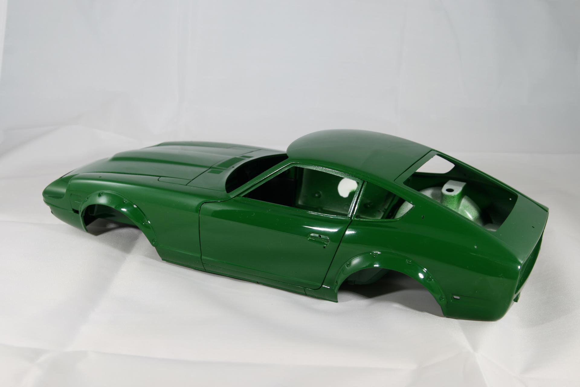

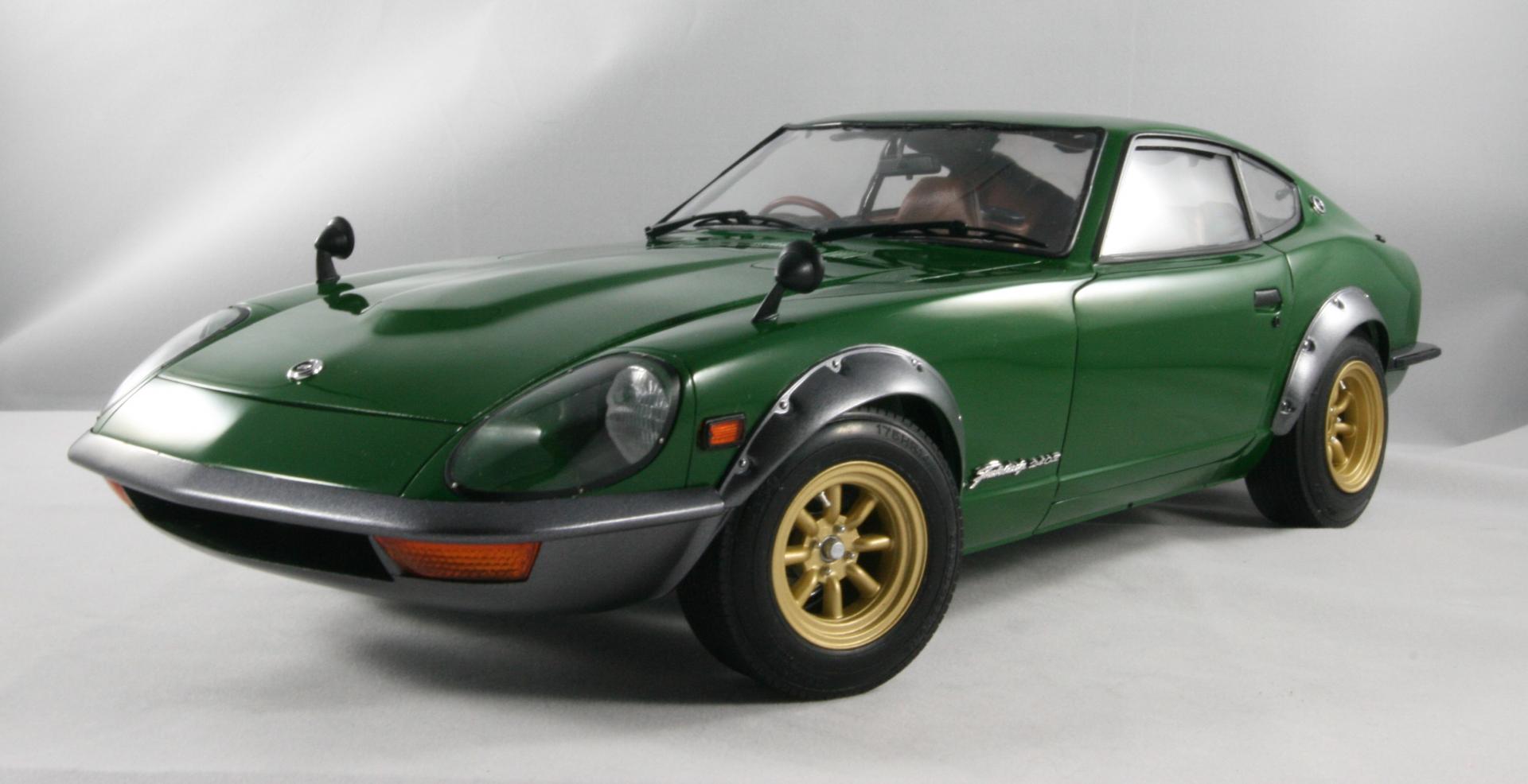

I prefer, whenever possible, to attach aero parts/fender flares to the body before paint or final assembly. This allows me to use cement for a strong bond and to fettle any fit issues before paint as opposed to getting any nasty surprises during final assembly. Often add-on body parts won't have positive mounting locations on the body, which can lead to problems at the end of a build. Take, for example, the 1/12 Tamiya Datsun 240zg. The flares are separate parts and aren't the best fit to the body. Even though they're a different color on the car, I decided it was a better idea to attach them before paint and then mask and paint after the body color was applied. The result was a perfect fit and a durable joint I never have to worry about breaking.
