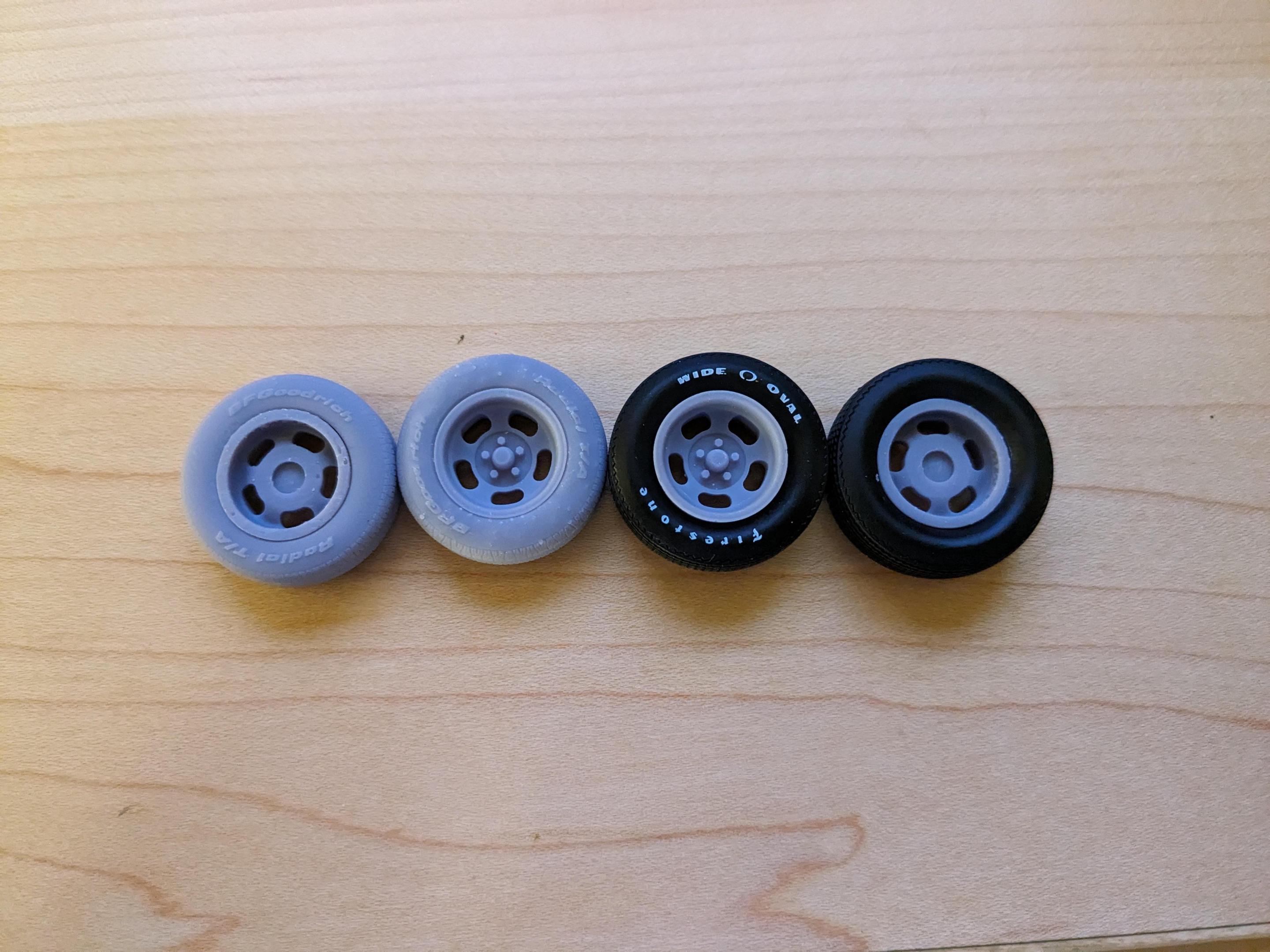

Can't confirm, but will try to help. I don't have that tire pack (I thought I did, but I can't find it...), but I have the "Wild Wheels and Wide Ovals" PP020/24 set. I believe the tires are the same as the F60-15 tire kits. They are a perfect fit IMHO in Joel's 15x8 slots. I ASSume that the L60-15s would fit the 15x10 wheels, but I can't confirm.
Pic is Joel's 15x8 slots with the AMT tires and his 15x8 Radial T/As. Tires are pretty much the same size.

That is very helpful!  I haven’t seen any soft tires on resin wheels until now and they look great!  The L60’s have to be 15x10, any wider would be drag tires, LOL!  I’d love to see a pic of 15x10’s though.  Thank you!!
