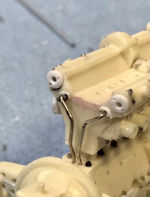

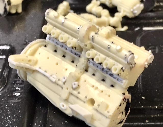

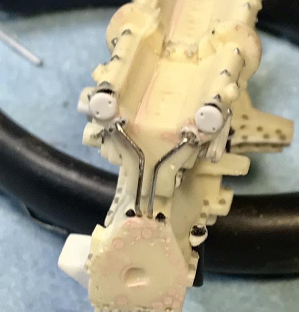

absmiami Posted October 21, 2023 Author Posted October 21, 2023 The rear facing caps are drilled for tach line hardware … gotta re-visit the dash - there should be two tachs …

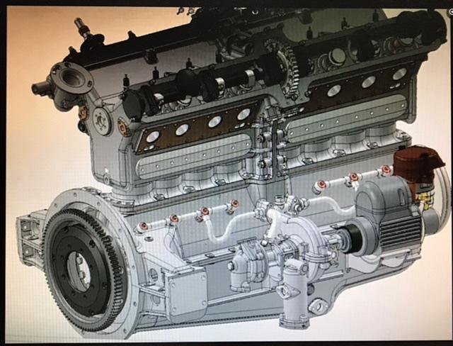

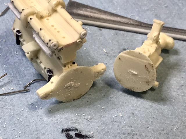

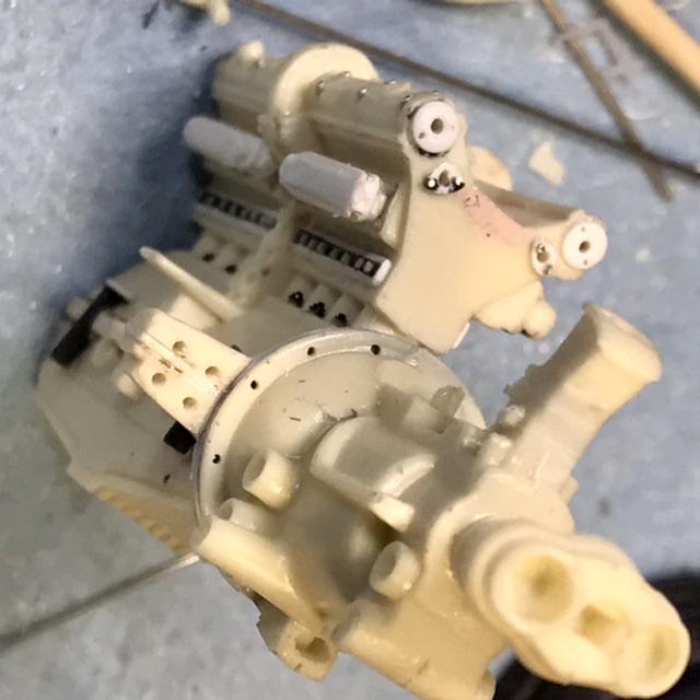

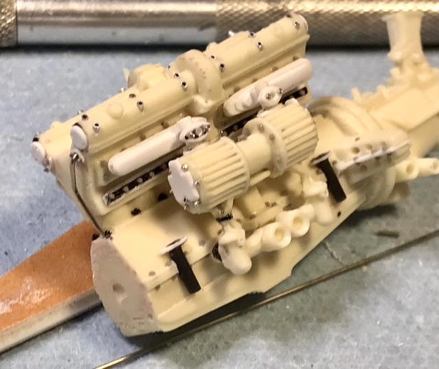

absmiami Posted October 24, 2023 Author Posted October 24, 2023 This is also fr the Jim Stokes F book page - reiminding me that i need to make a ring of bolt holes on the back of the block where the trans is attached -

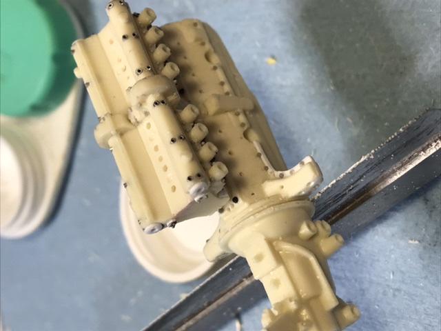

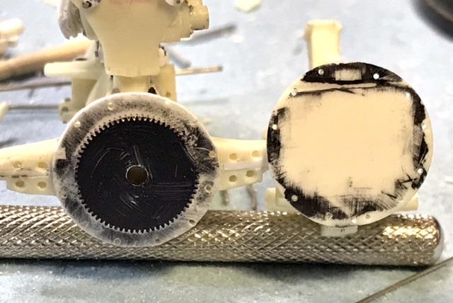

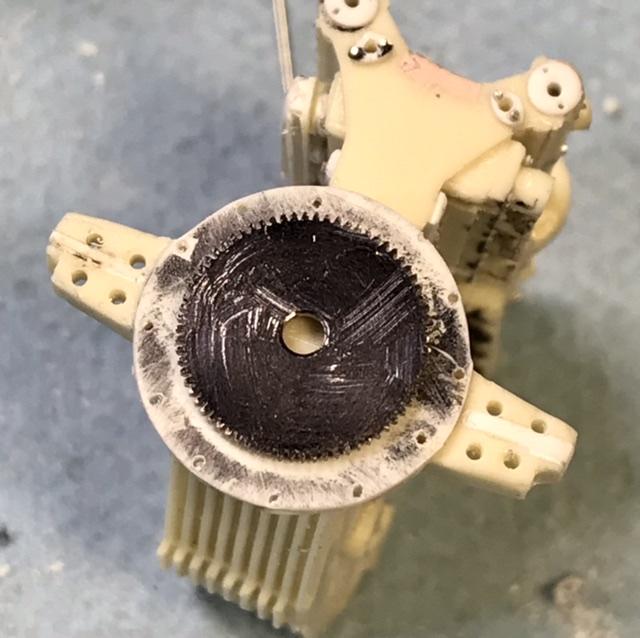

absmiami Posted October 24, 2023 Author Posted October 24, 2023 And the trans casing is finished differently - appears to be fl black - so i decided to hack it off with a fine razor saw ….

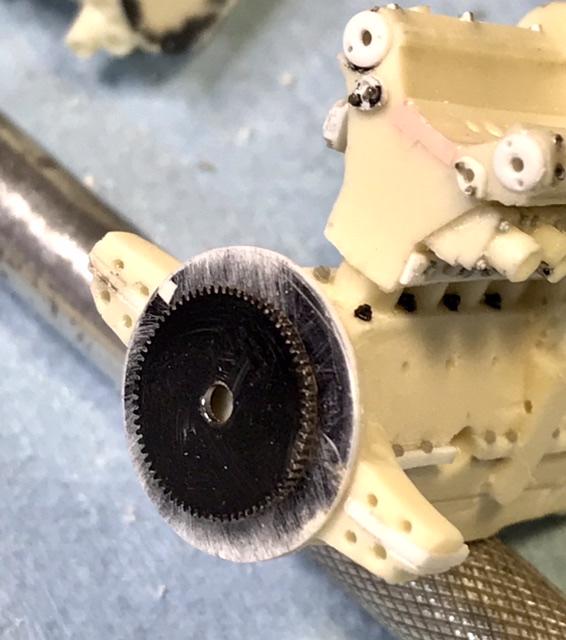

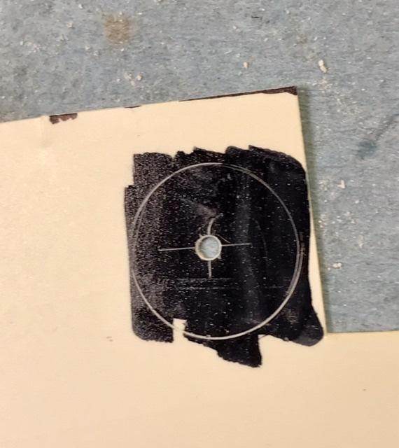

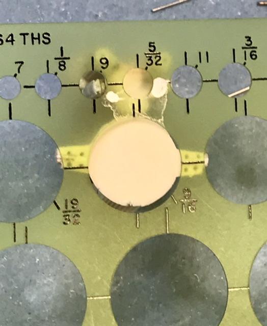

absmiami Posted October 24, 2023 Author Posted October 24, 2023 Made an .015 plastic disc to replace the resin removed in surgery - and threw on a fly wheel - discarded spare watch gear - for laughs - this will have to go when the trans is glued to the block -
absmiami Posted October 24, 2023 Author Posted October 24, 2023 And the bolt holes in both parts - probably will use .06 Master Club bolts … 1

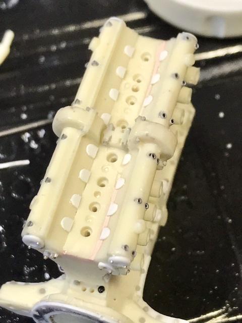

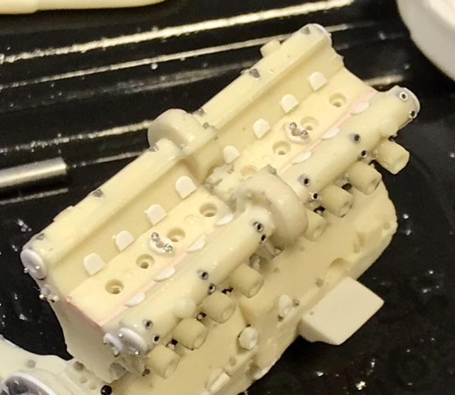

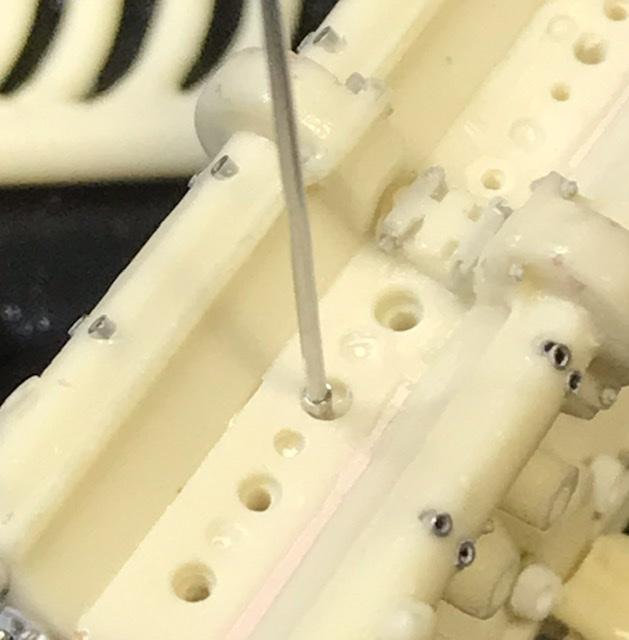

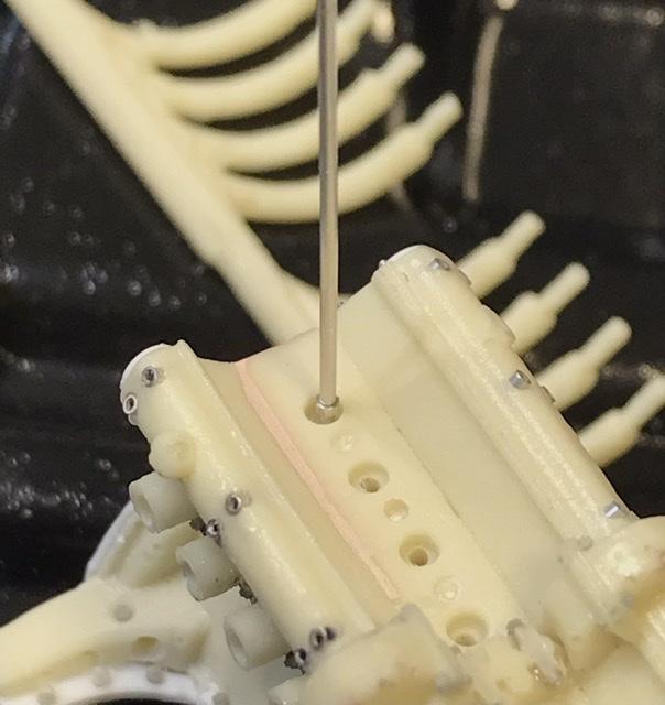

absmiami Posted October 30, 2023 Author Posted October 30, 2023 The cam cover end plates each got two RB Motion bolts fr his Cosworth Cam Cover bolt set - they are stupid small - .012 - and then i did some work on the cyl head …

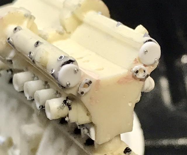

absmiami Posted October 30, 2023 Author Posted October 30, 2023 Made flanges for the cyl head water pipes and the oil lines off of the bottom of the block …. These were sanded to shape, drilled, then cut from a strip of Evergreen …

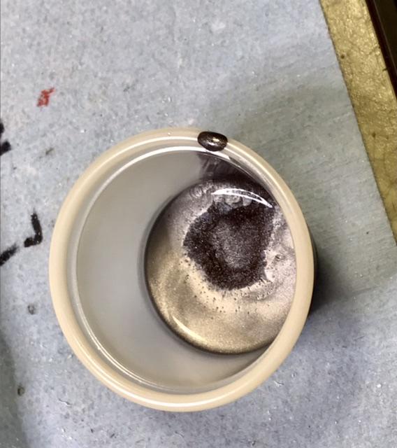

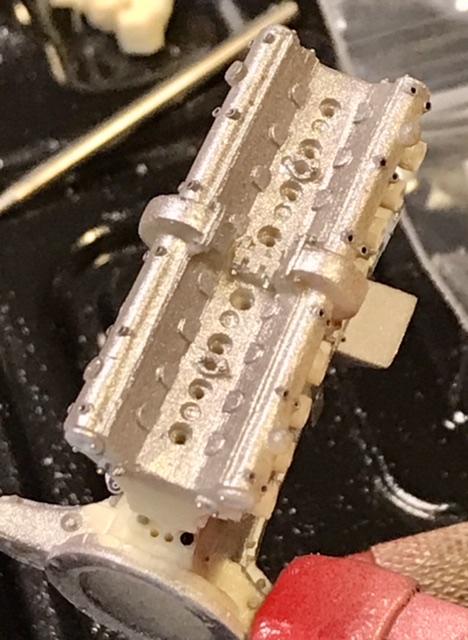

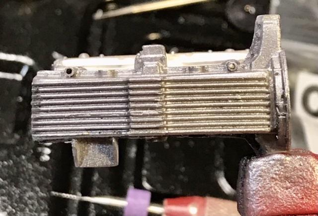

absmiami Posted October 30, 2023 Author Posted October 30, 2023 The correct color for an engine that was made over eighty years ago and raced or used almost every year since is always hard to figure - mixing about two parts light gun metal to one part mica silver - this is what i came up with ….
