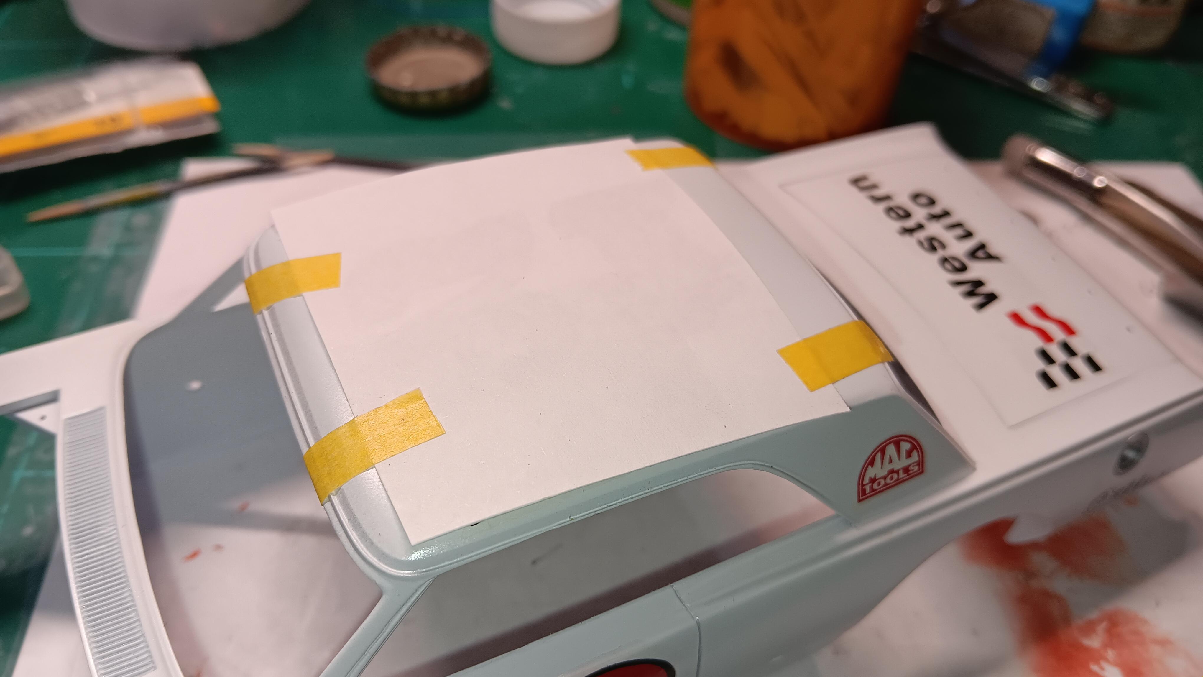

bobss396 Posted March 21, 2024 Posted March 21, 2024 Sometimes I do the roof decals last. But I did them already on this one. The roof takes a beating during assembly. I simply tape a piece of scrap paper over it with Tamiya tape, applied lightly. The car has to be close or completely done before I remove it. 1
CaddyDaddy Posted March 22, 2024 Posted March 22, 2024 I LIKE IT!! I've had the same problem. How about a paper towel or paper napkin to provide a little cushion? Just a thought....... 1
bobss396 Posted March 23, 2024 Author Posted March 23, 2024 22 hours ago, CaddyDaddy said: I LIKE IT!! I've had the same problem. How about a paper towel or paper napkin to provide a little cushion? Just a thought....... I have used paper towels in the past, but paper holds the tape better. Maybe a paper towel under the paper next time. On this build, I ran into too many late-stage issues and did a lot of unplanned handling of a near-complete car. Something to avoid in the future.

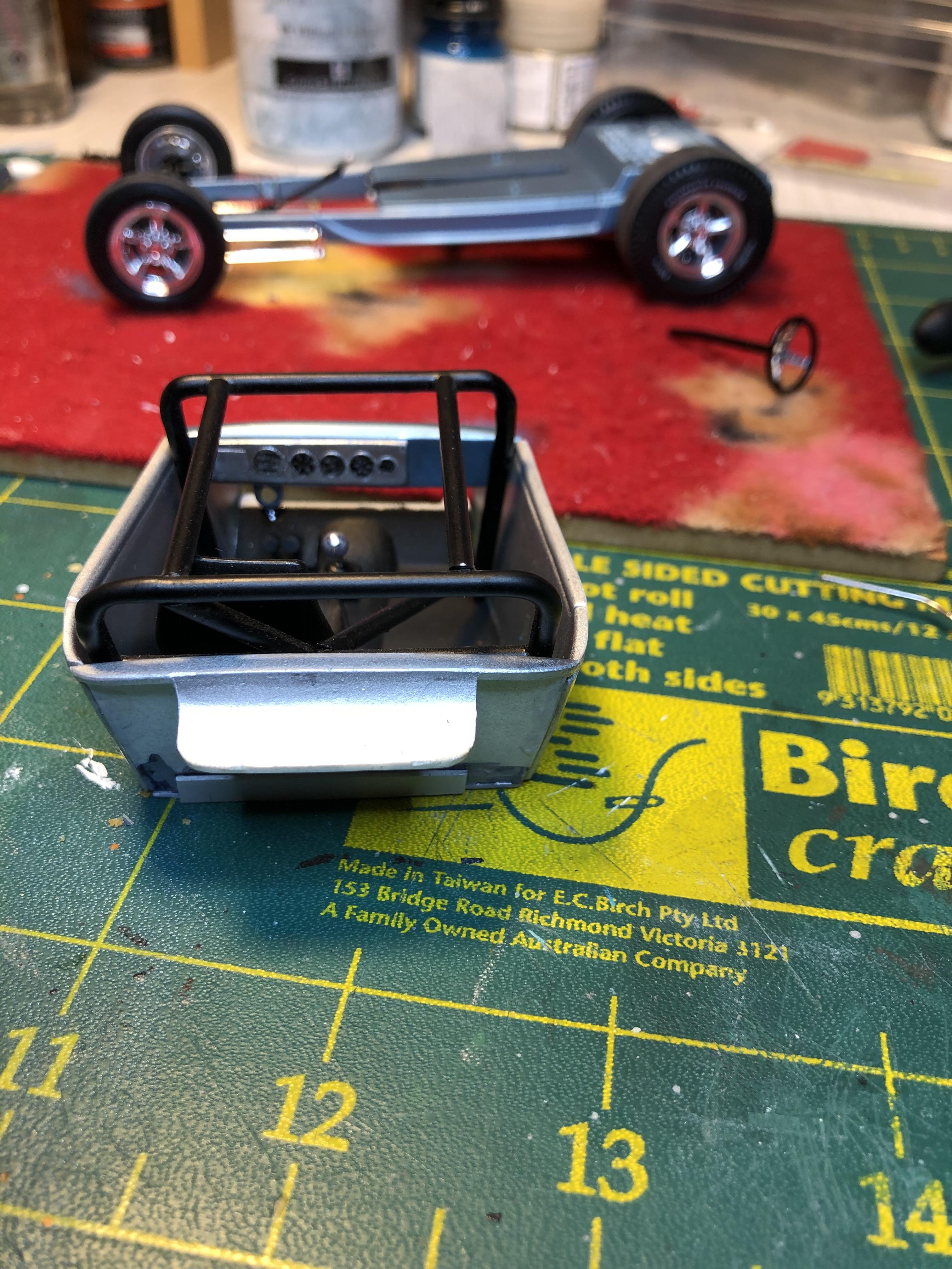

bill-e-boy Posted April 6, 2024 Posted April 6, 2024 I have thin board (we call it "Custom Wood" here in NZ) lined with some polar fleece off cuts. Felt would work. Glue on with PVA glue. They are about 9" x 6" - or any size you want really. I have three of them. They are great for mock ups on the hard side too. You can see my most colourfull one in the background with the chassis sitting on it.
