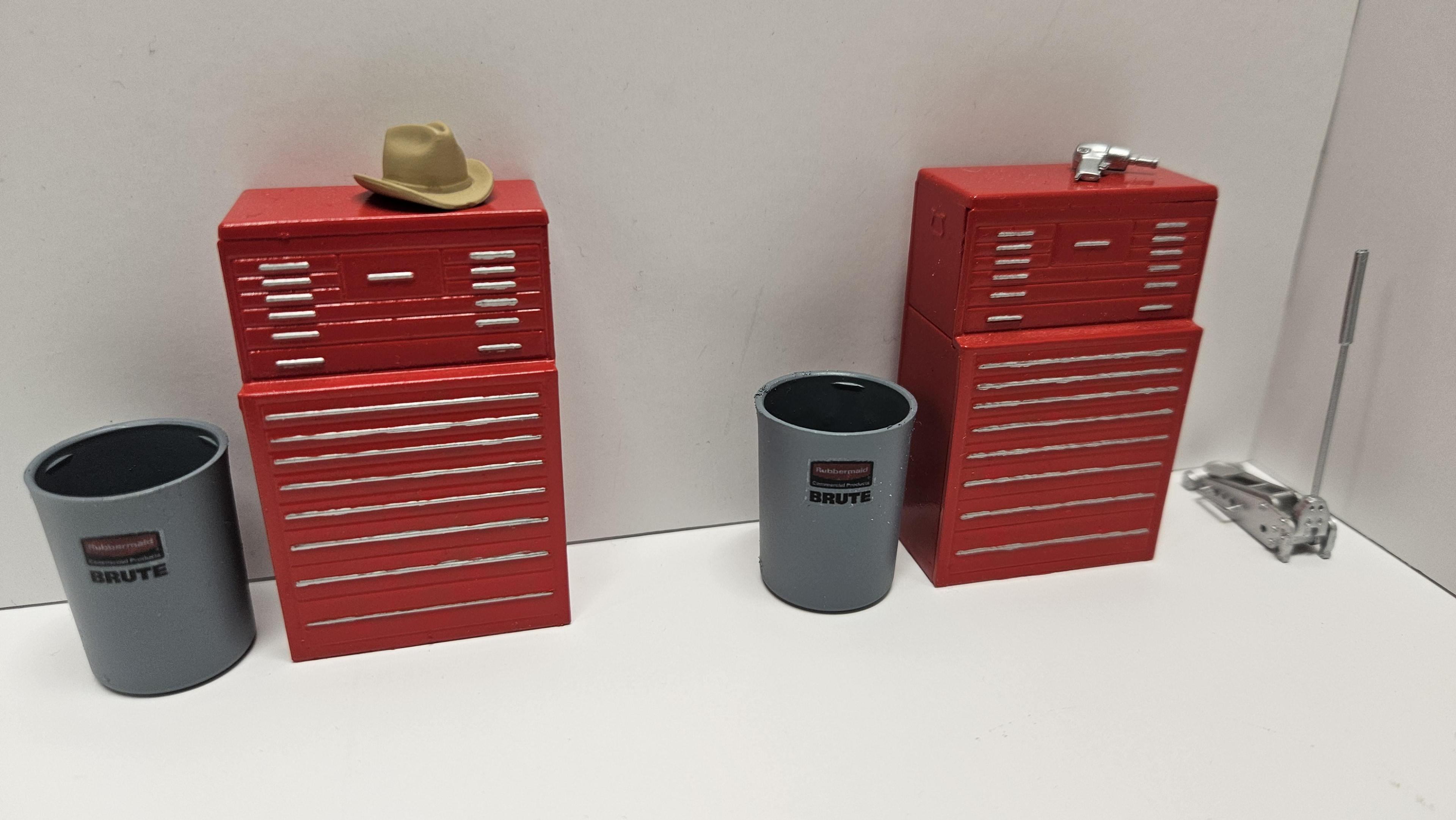

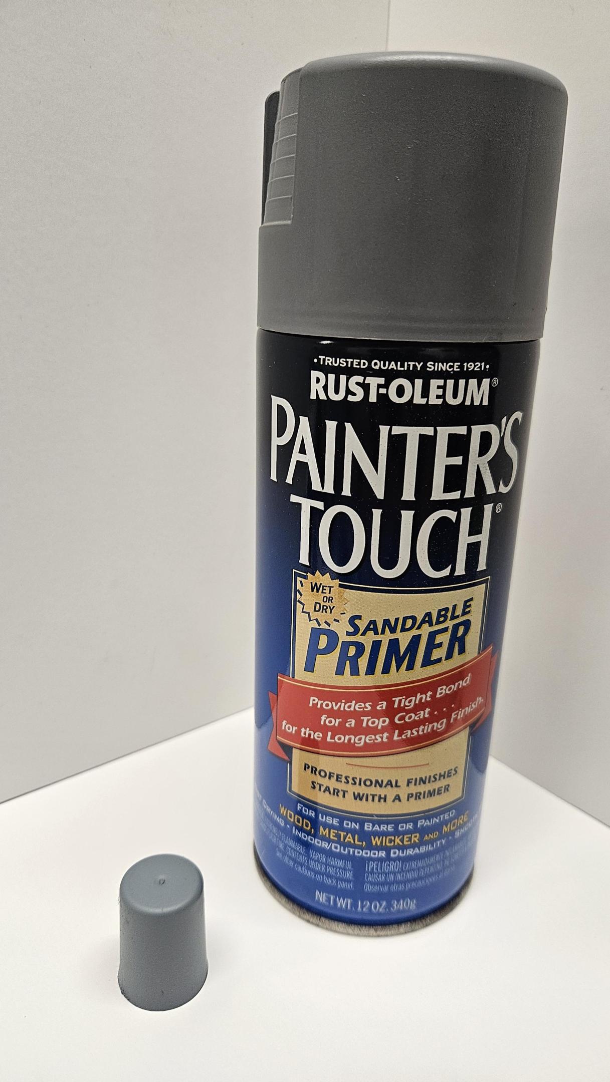

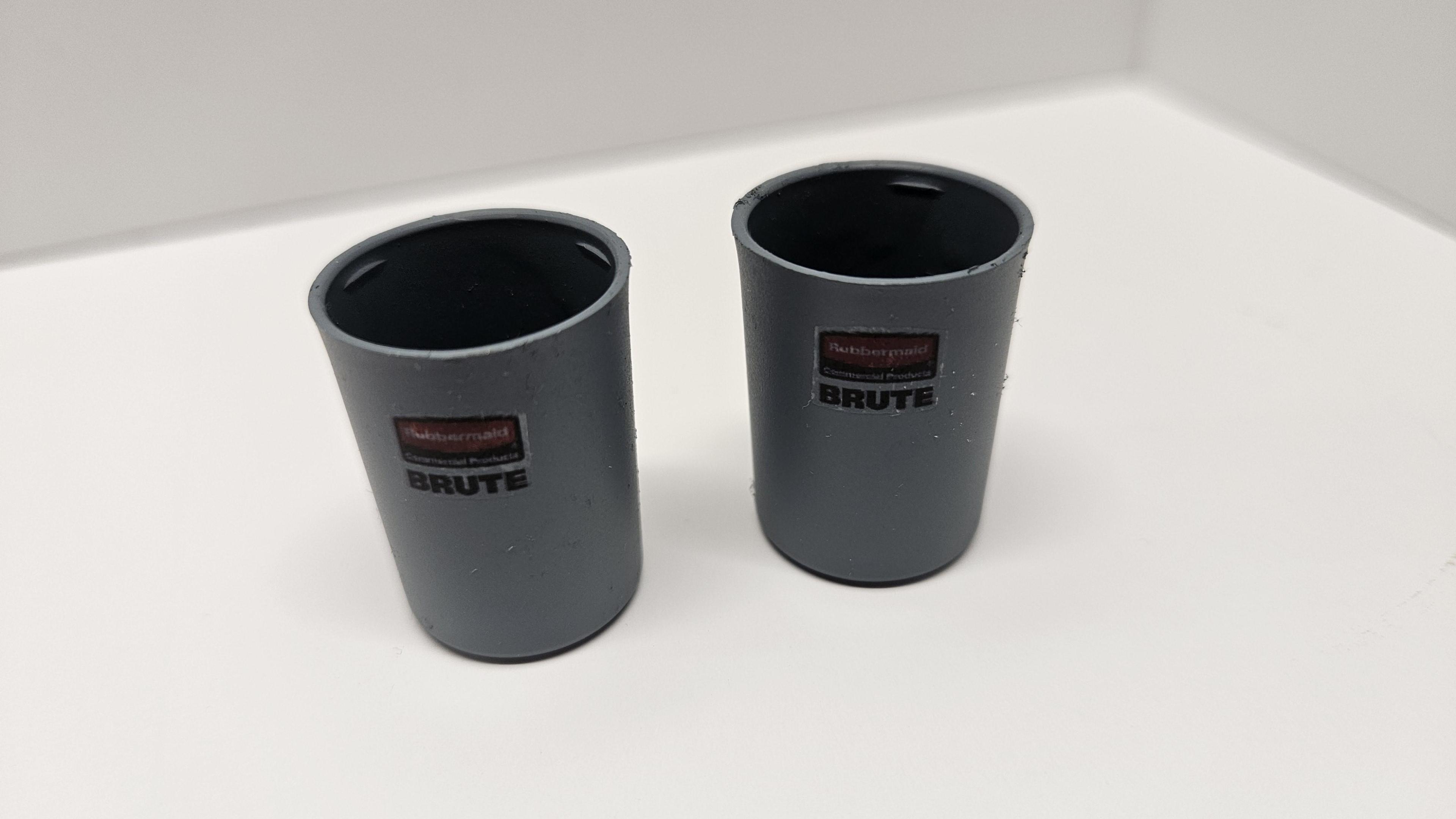

Need some strong Rubbermaid trash cans for the shop.
Scounged some beauty product caps...Trash1.thumb.jpg.0a341f12ce4172a7c15d9ab7a85ed6cd.jpg
A coat of gray primer...Trash2.thumb.jpg.5ac202a19358e45883073e014c4b1ce7.jpg
Used the inkjet to print on clear decal paper and voila...
Trash cans for each work cell.
Steve
  • Like 10

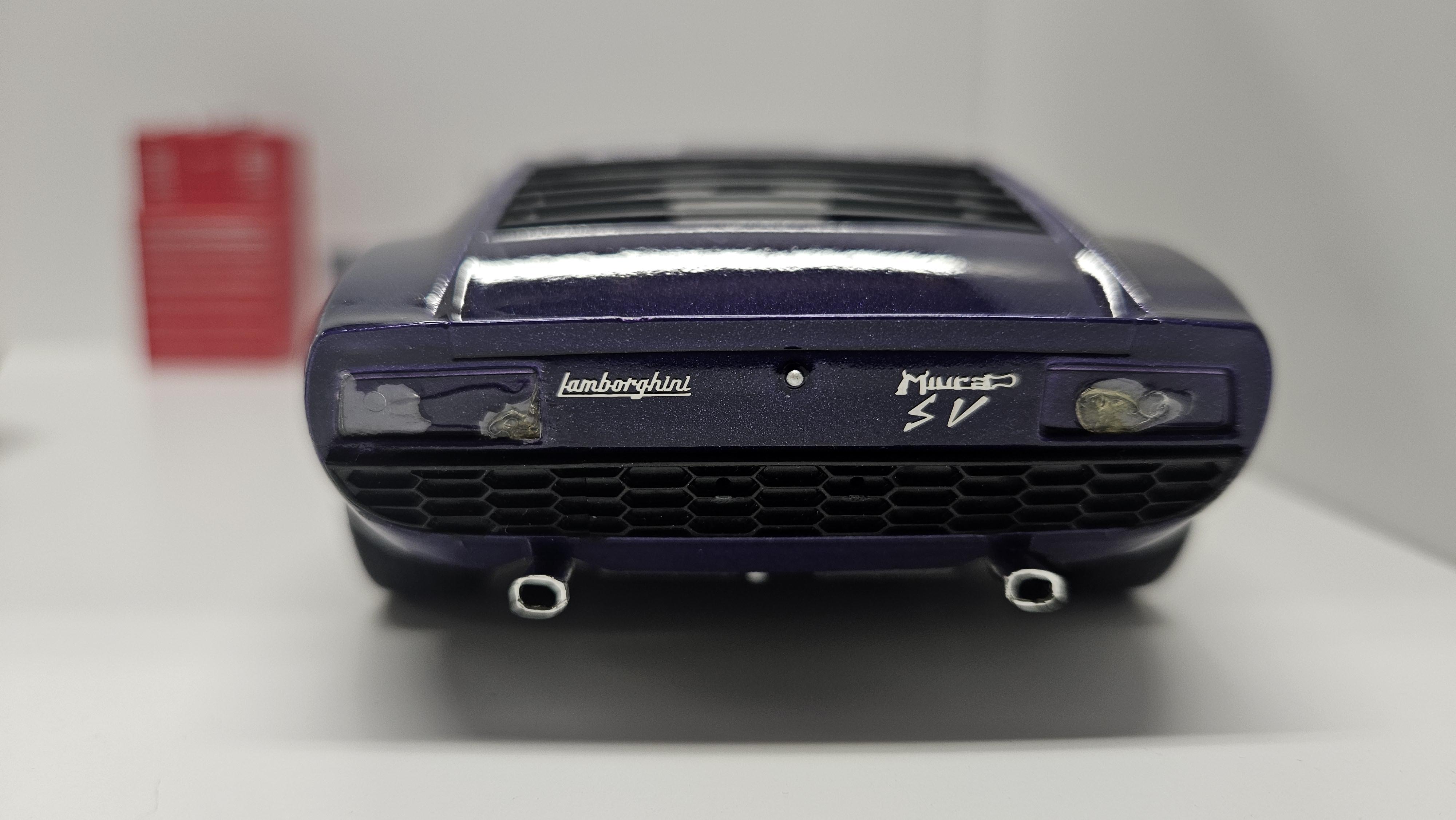

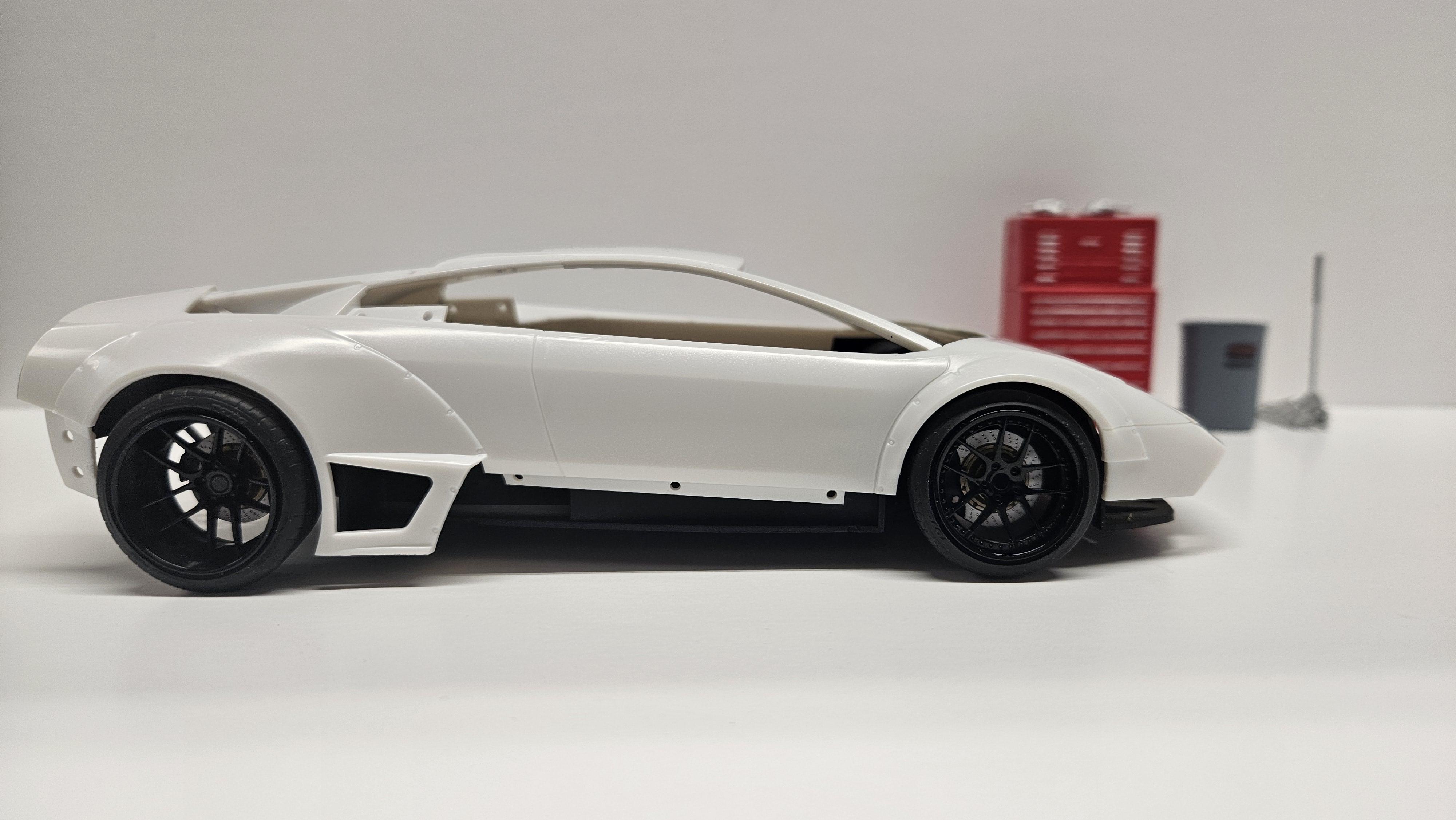

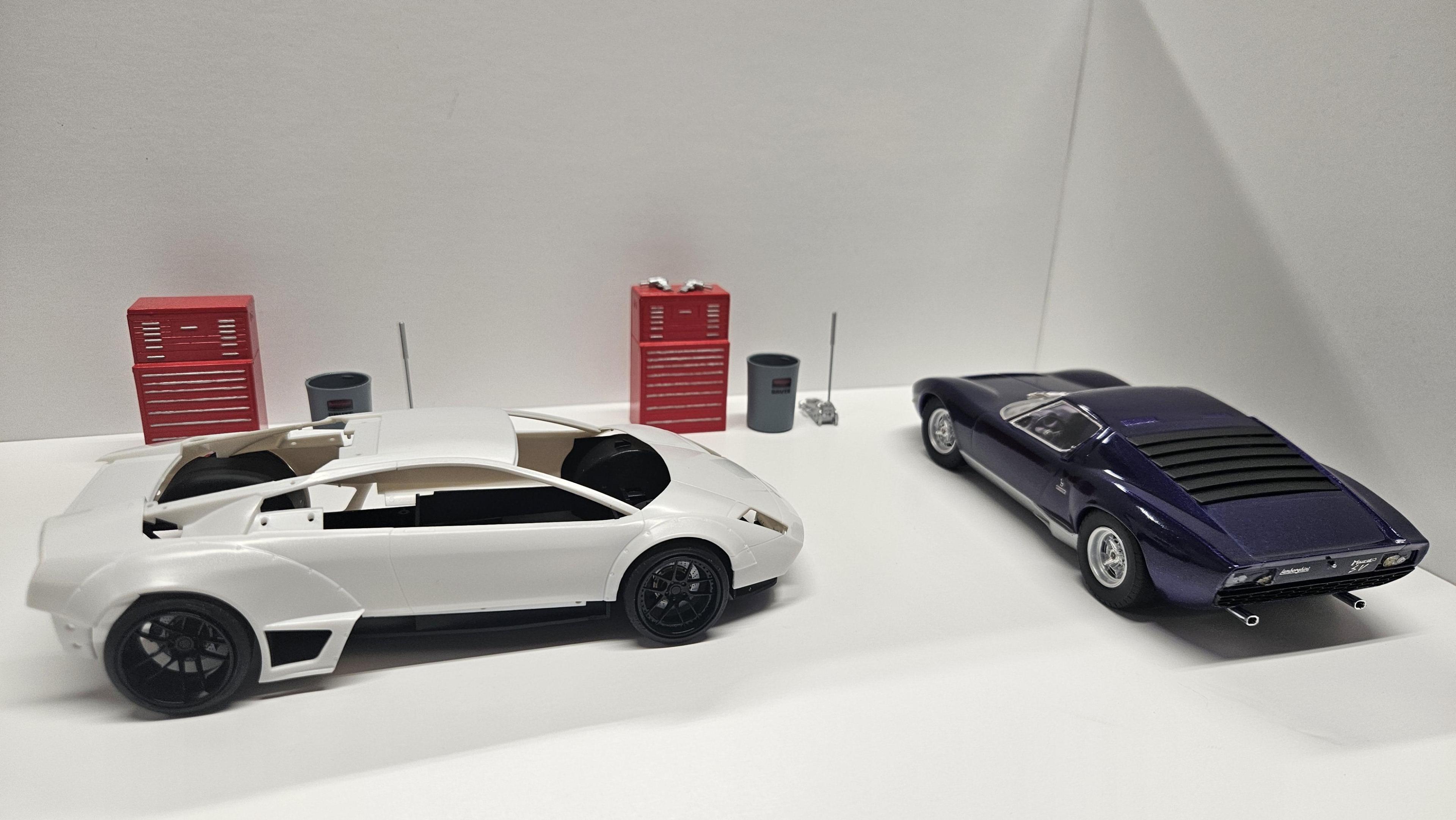

The shop is unchanged to date but it is Lamborghini Day in the shop.  Some old work and some new.
Muira is in to have its tailights refreshed and North American (California) personalized plates put on.
a Liberty Walk Murcielago is being prepped for paint.
Edited by Coyote_6

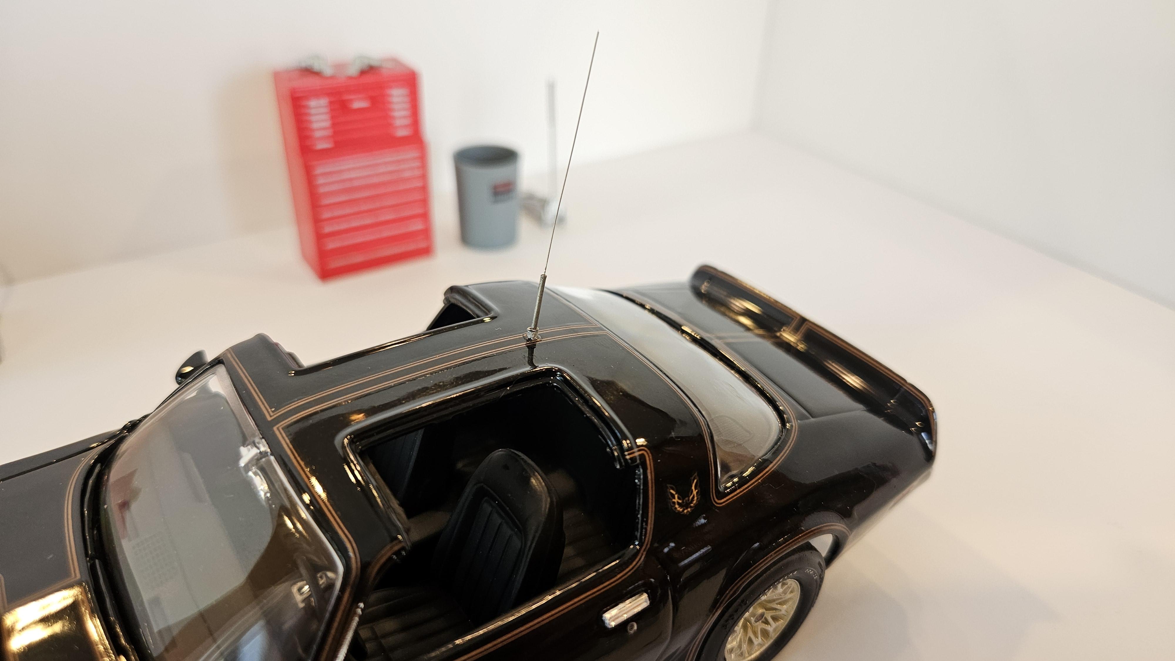

And while we're at it, The Old Shop is a full service shop - paint, fabrication, mechanical, overhaul - and today, auto electronics!
A couple of customers who wish to remain anonymous called ahead for some CB antennas - in 1/24 scale??  Yikes!
The Trans Am currently sports a scale 0.380 inch diameter antenna - Firestick perhaps?   He wants to go with something a little thinner for less wind resistance.
The two boys with the orange car said their antenna got tore off when someone chased them through the old barn by the Boars Nest.
We'll see what we can do.
Edited by Coyote_6
  • Like 2
  • Haha 2

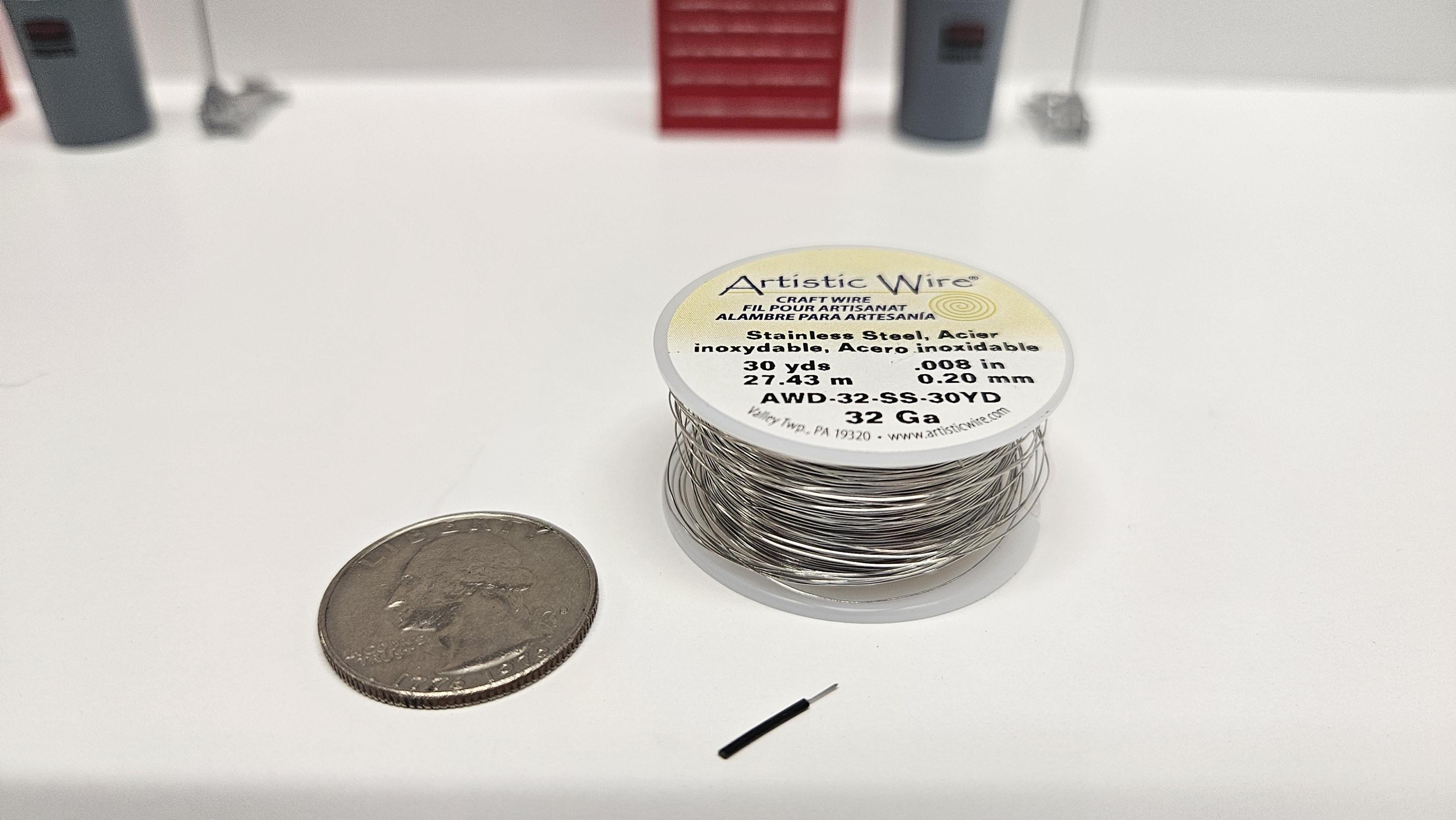

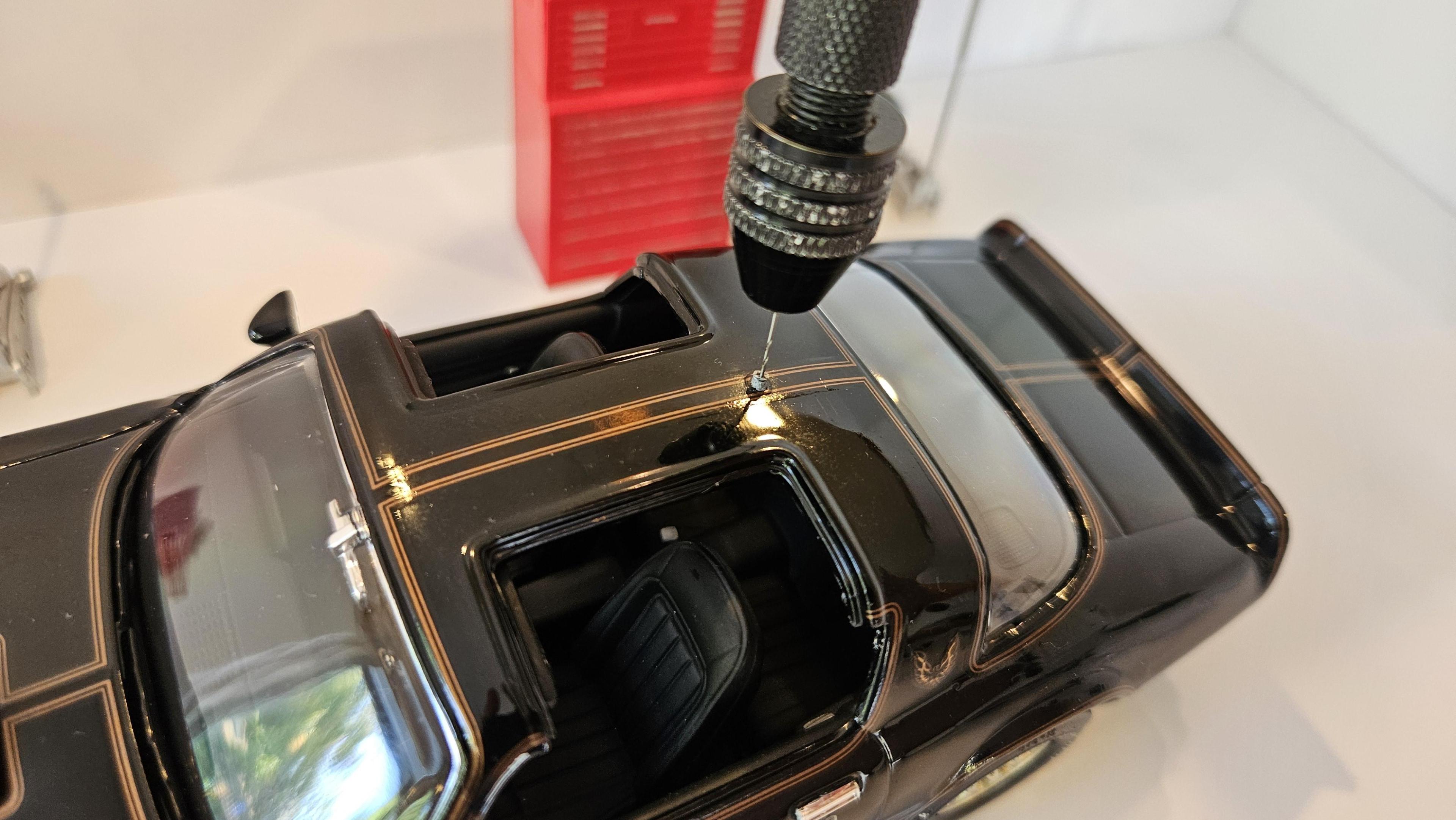

For today, the black Trans Am.

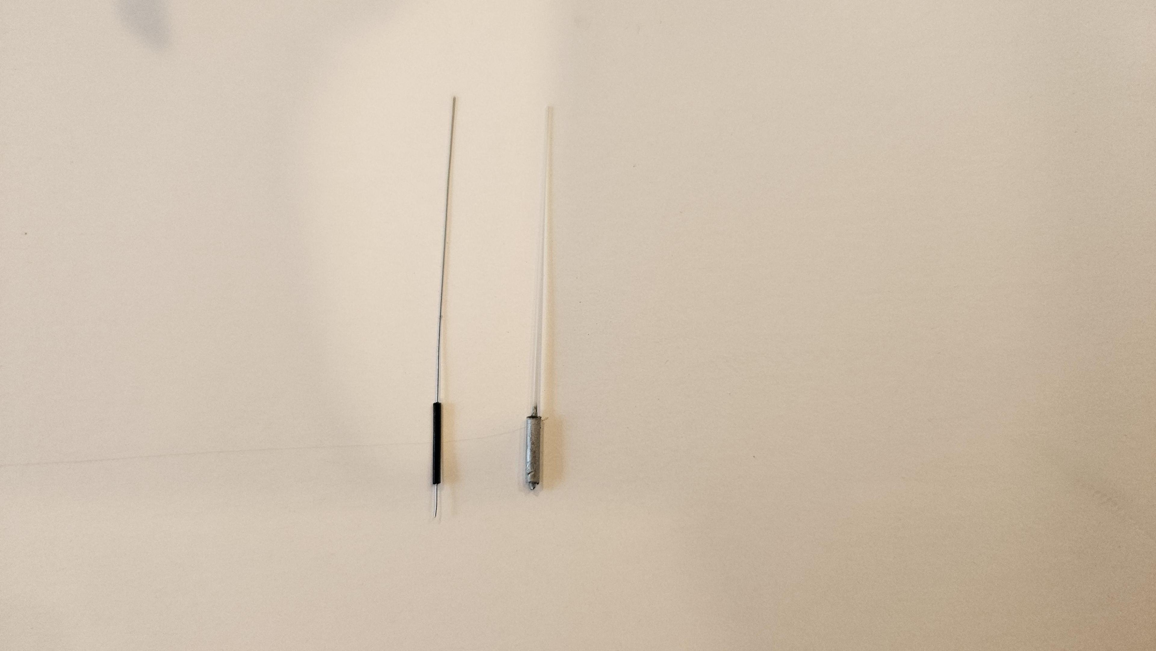

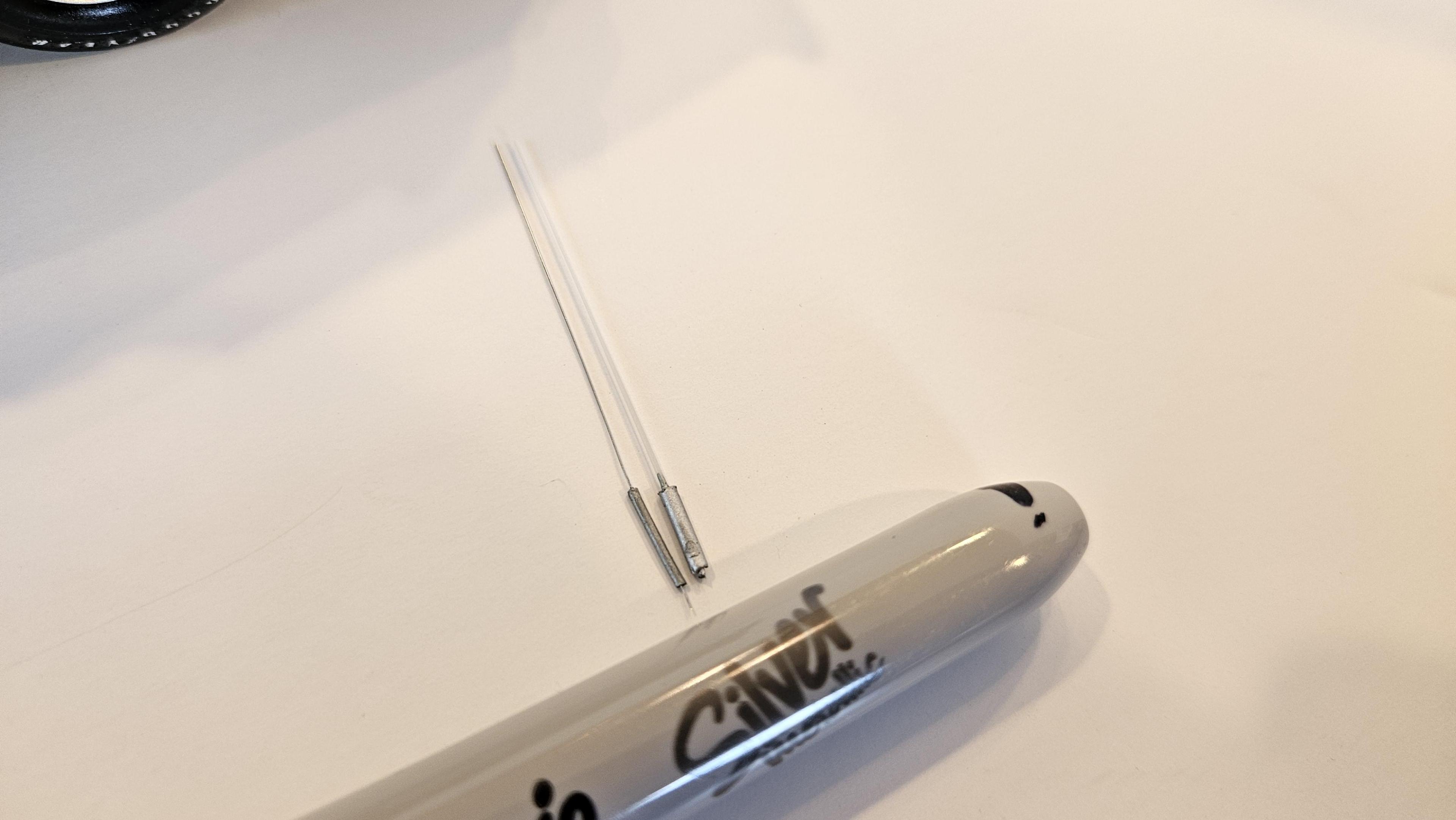

Our supplies include 32 gauge stainless wire (dead soft unfortunately - easily bendable but easily bent), some 0.030 OD wire (about 1/2 inch), silver sharpie and super glue.

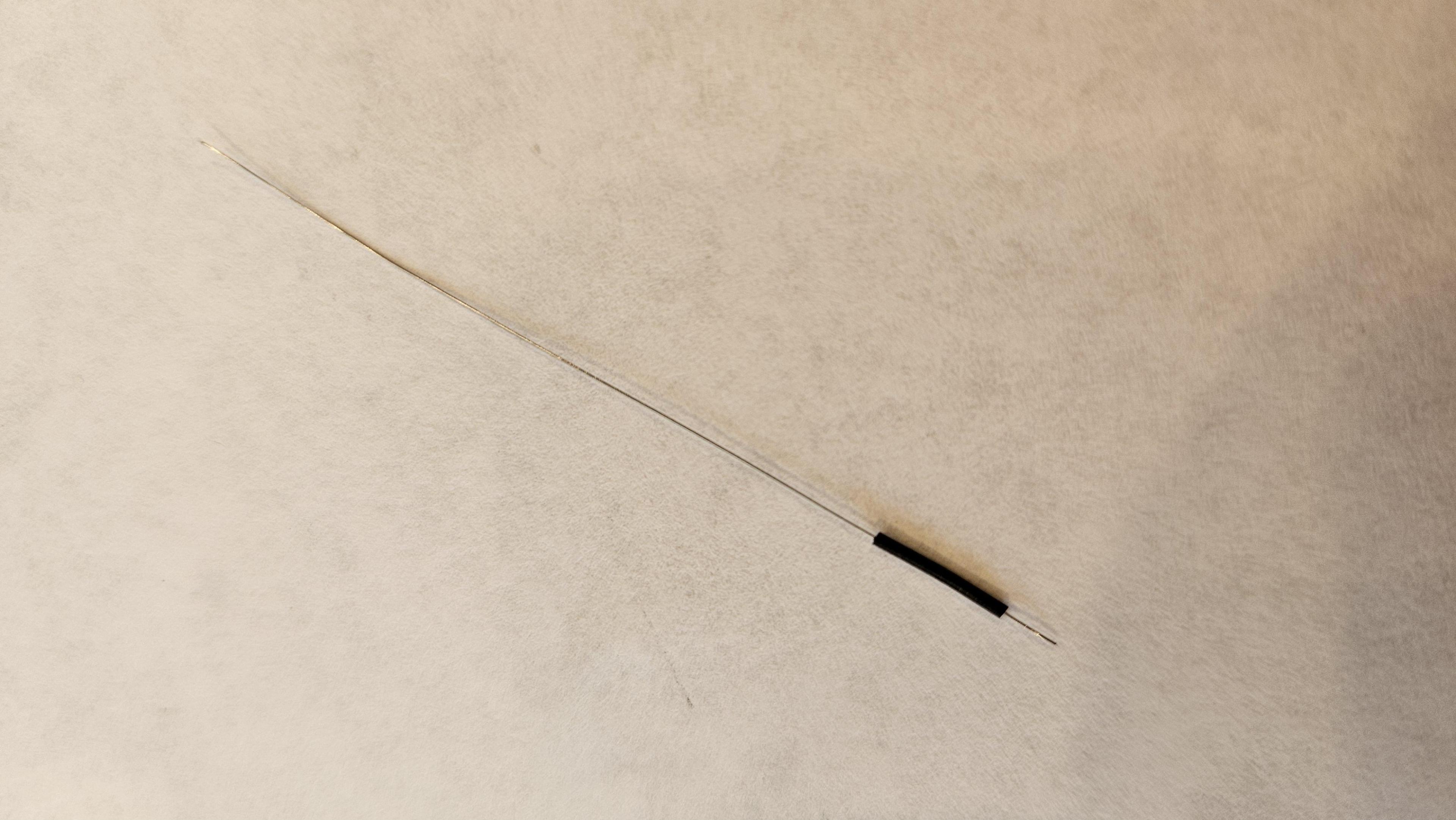

Pull the wire core out of the black insulation and feed our stainless wire through in its place.
Straighten as best we can, lop off the old antenna (leaving a bit to use as the new antenna base) and drill a 0.5mm hole into the remaining base...
New on the left (.007" stainless) vs old on the right (.015" stretched sprue).
  • Like 2

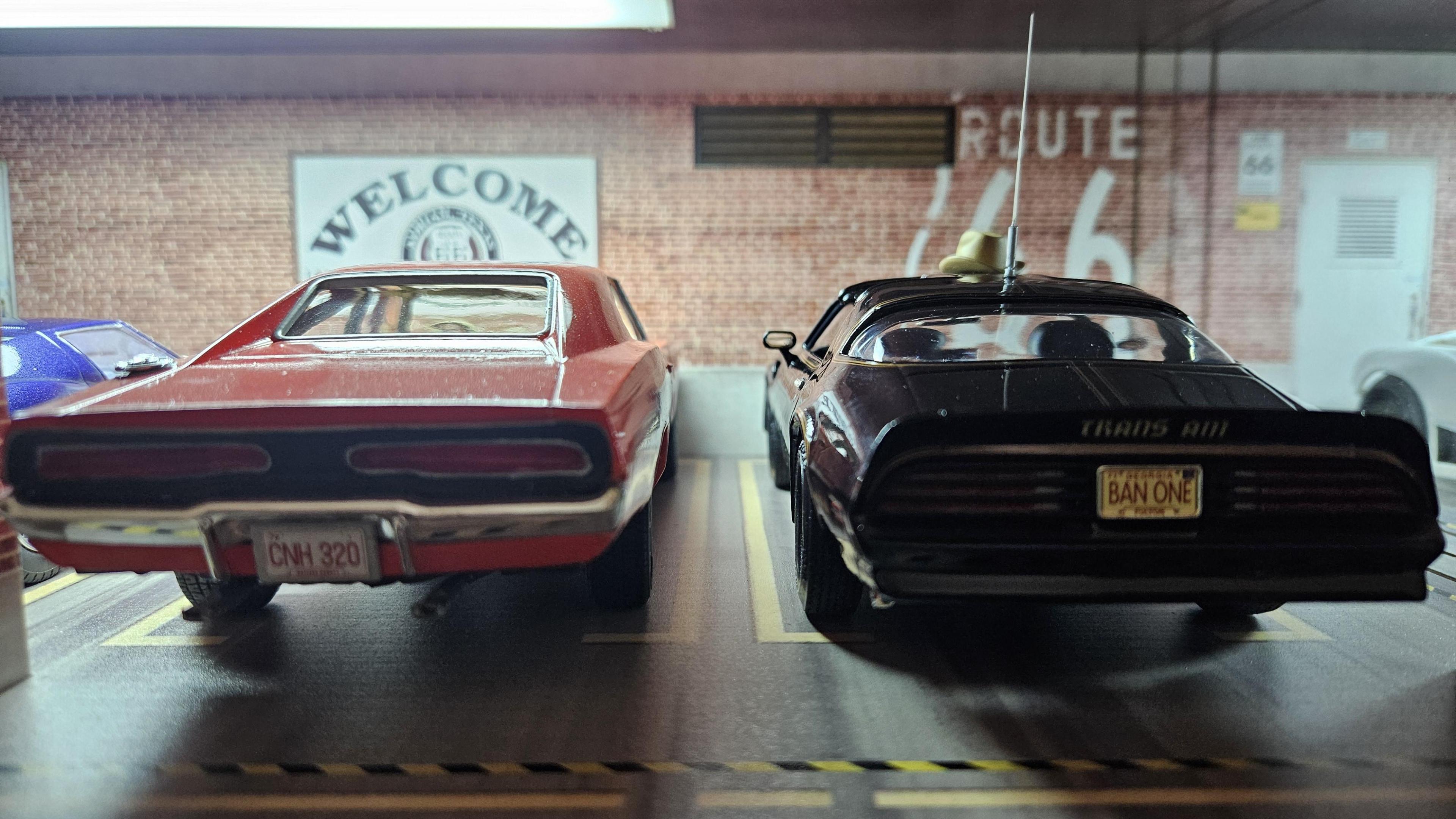

Some silver sharpie and a dab of superglue...
And our customer is back on the road east bound and down.  It looks like an improvement.
  • Like 1

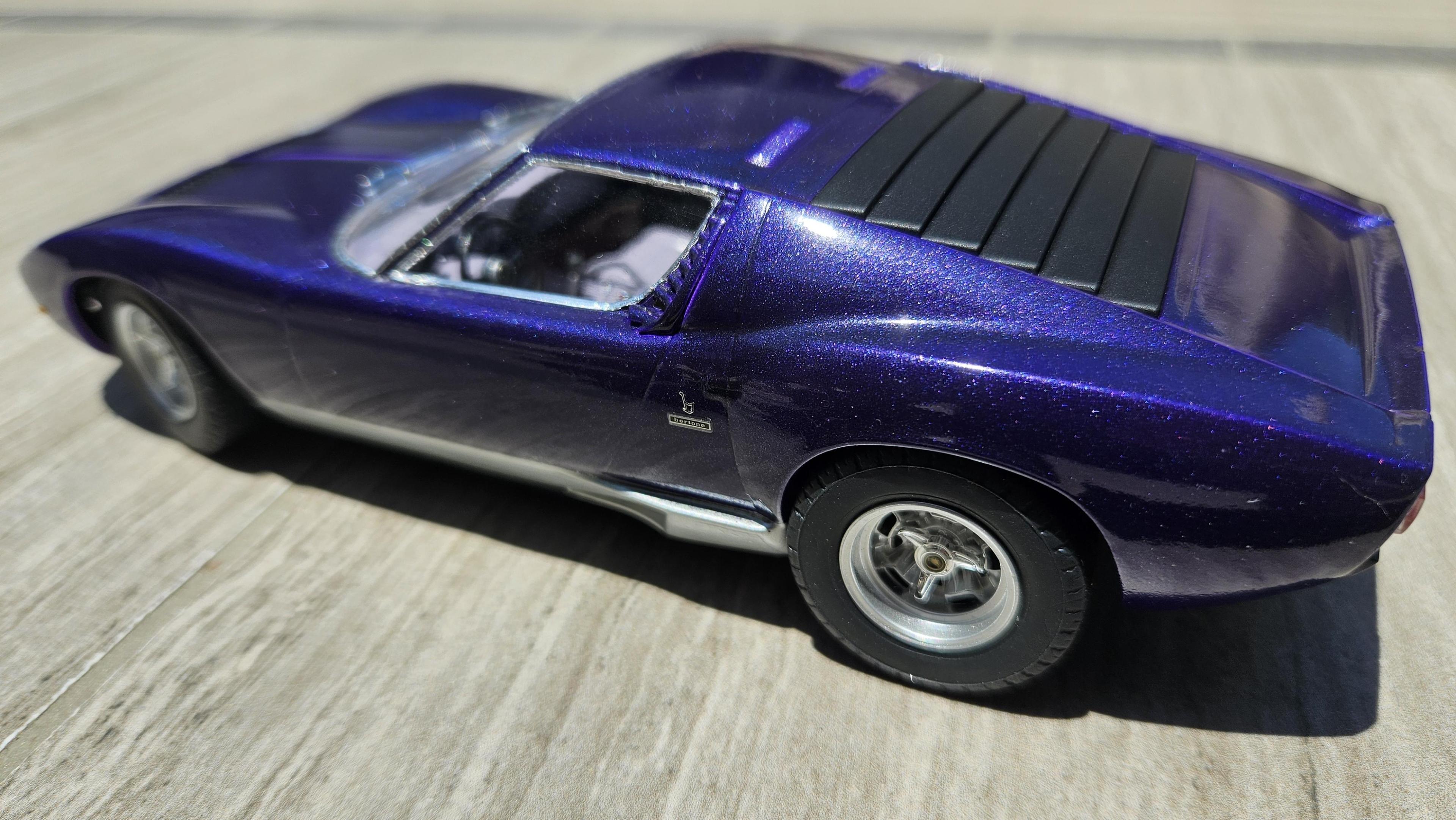

@Dann Tier Thanks!  Fixed up the tail lights so she's out of the shop now.  Waiting on printing a 70's style California personalized plate.  Had a European plate on there before.
Nice!  what color is this? looks identical to the one i built.
56 minutes ago, Coyote_6 said:
@Dann Tier Testors Model Master Plum Crazy metallic flake from a rattle can.
Nice!  I prefer cans. Mine was done in Duplicolor Electric Blue i believe...i built it at least 15 years ago.
