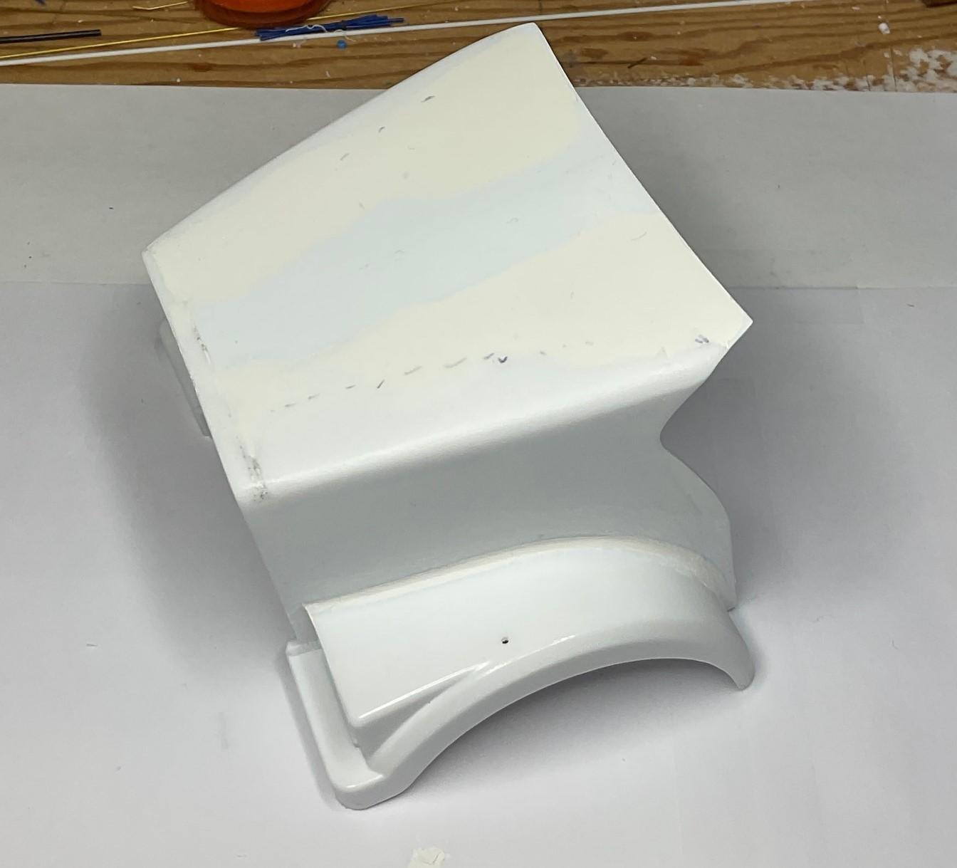

Some progress on the hood has been happening;  have done an initial sanding on first go round of putty (needs a bit more).  Been doing some test fittings of cab/hood together to see about any height adjustments that may be needed - back on page 1, I made a rear cab air bag/shock suspension and I can still set the cab forward or backward as needed to make the front of the hood locate properly.  I will need to make a slight height adjustment to the cab suspension as I finalize where I need to attach front hood hinges.   The front cab support will need work as well.   Lots of going back and forth from the model, to pictures I took today, to get it straight in my head about what's needed next!
Hood sanded after first bit of puttying
When I test fit the hood to cab again, thought I better check some alignment, front of hood to door line on cab.  Cab positioned so door line vertically correct, but..
front of hood needs to drop down slightly - will have to do that by shaving a wedge off of the back edge of hood.

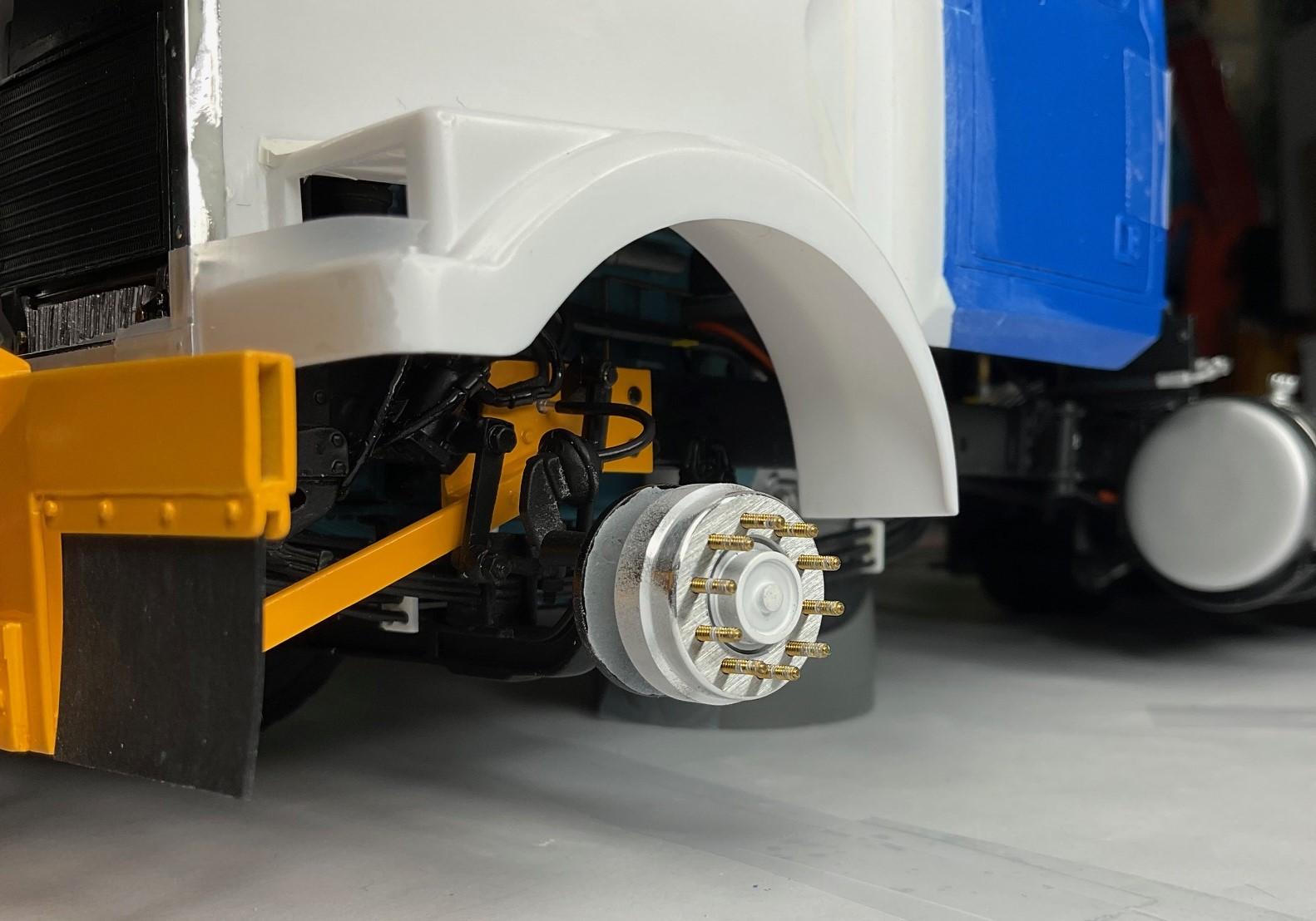

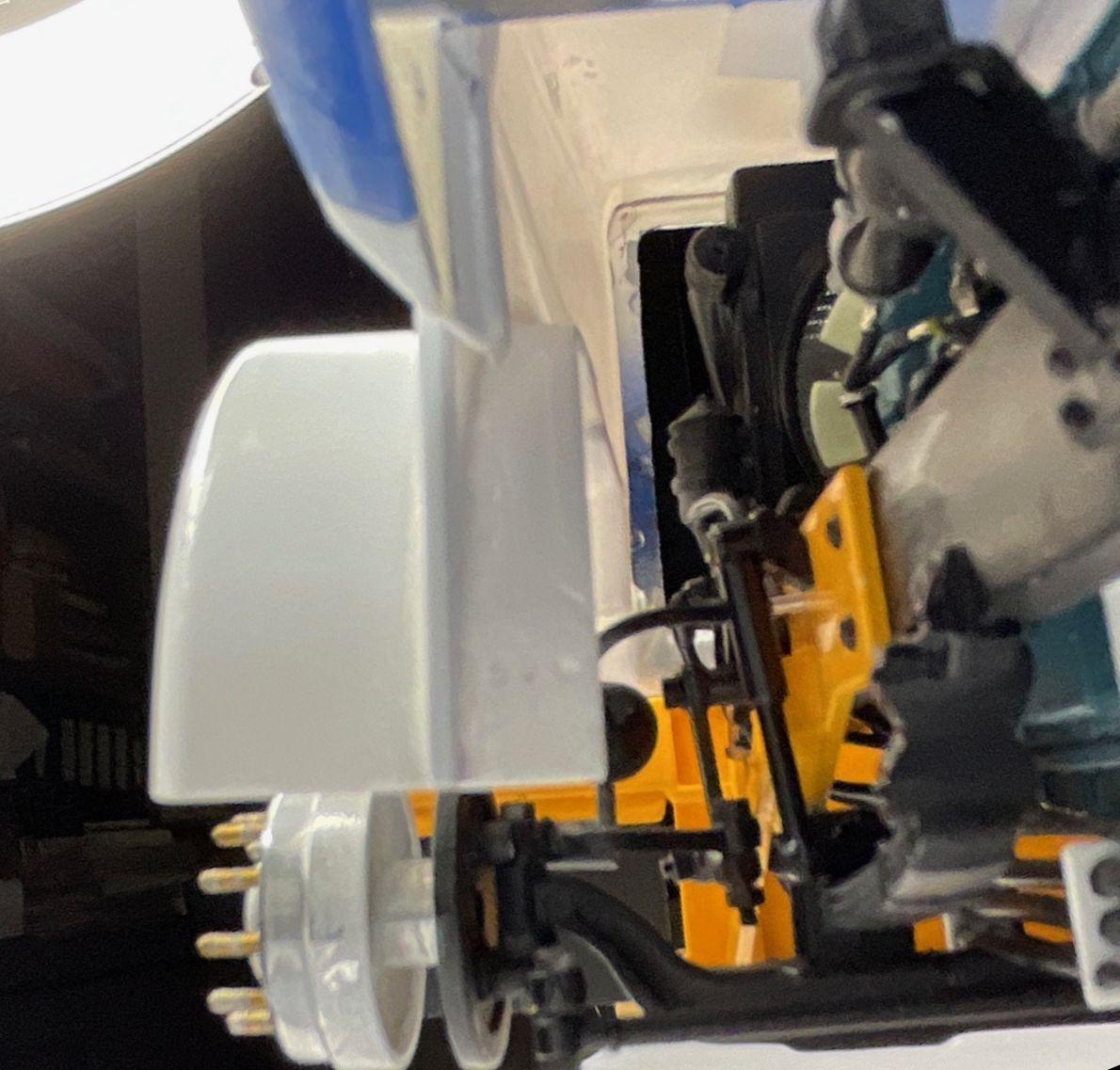

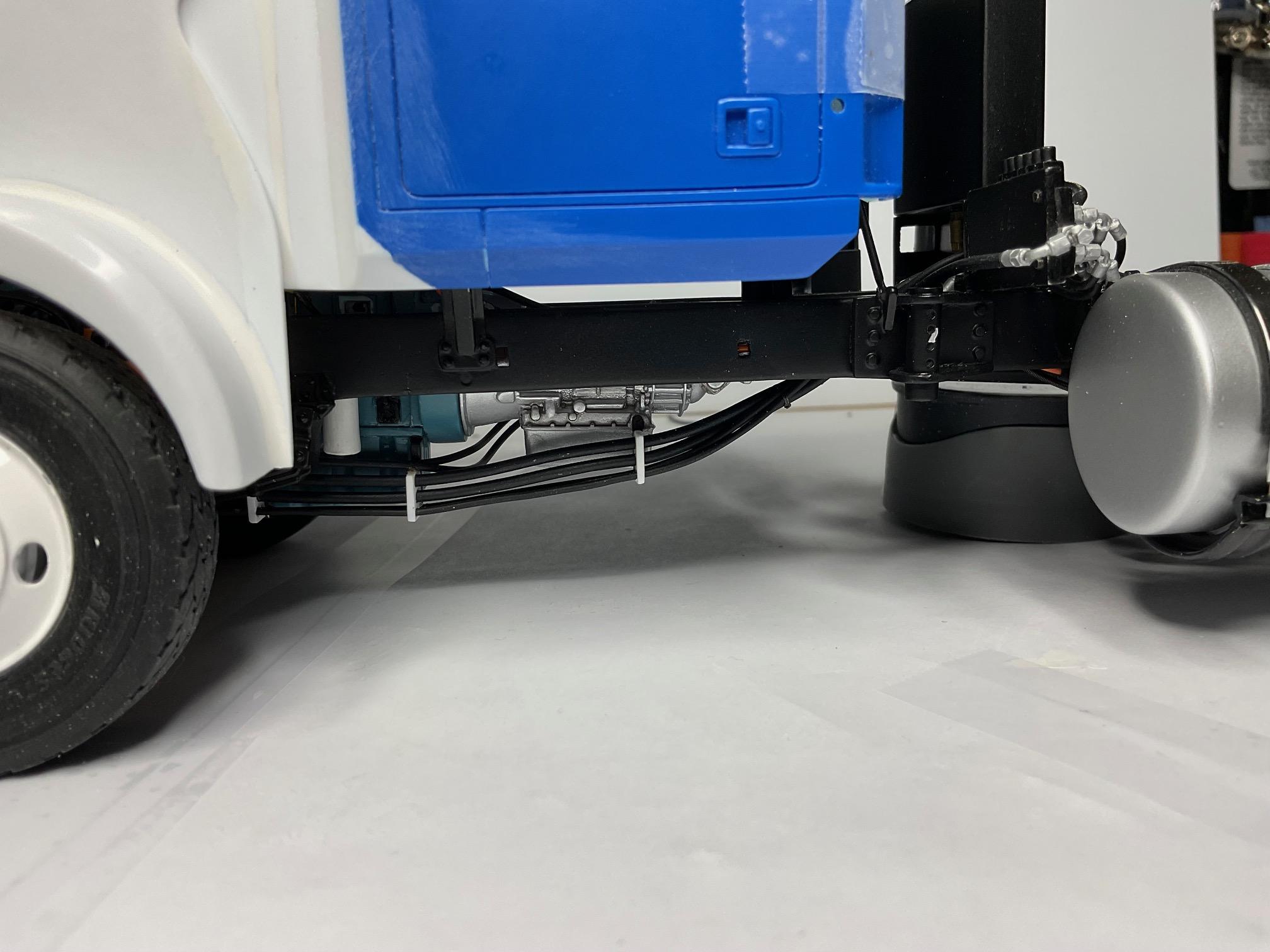

While cab/hood were roughly in place, I needed to check out the clearance for the inner fender and rubber flap that are on real truck - that flap was riveted to the inner fender molding, and extended just slightly below the top of the frame rail

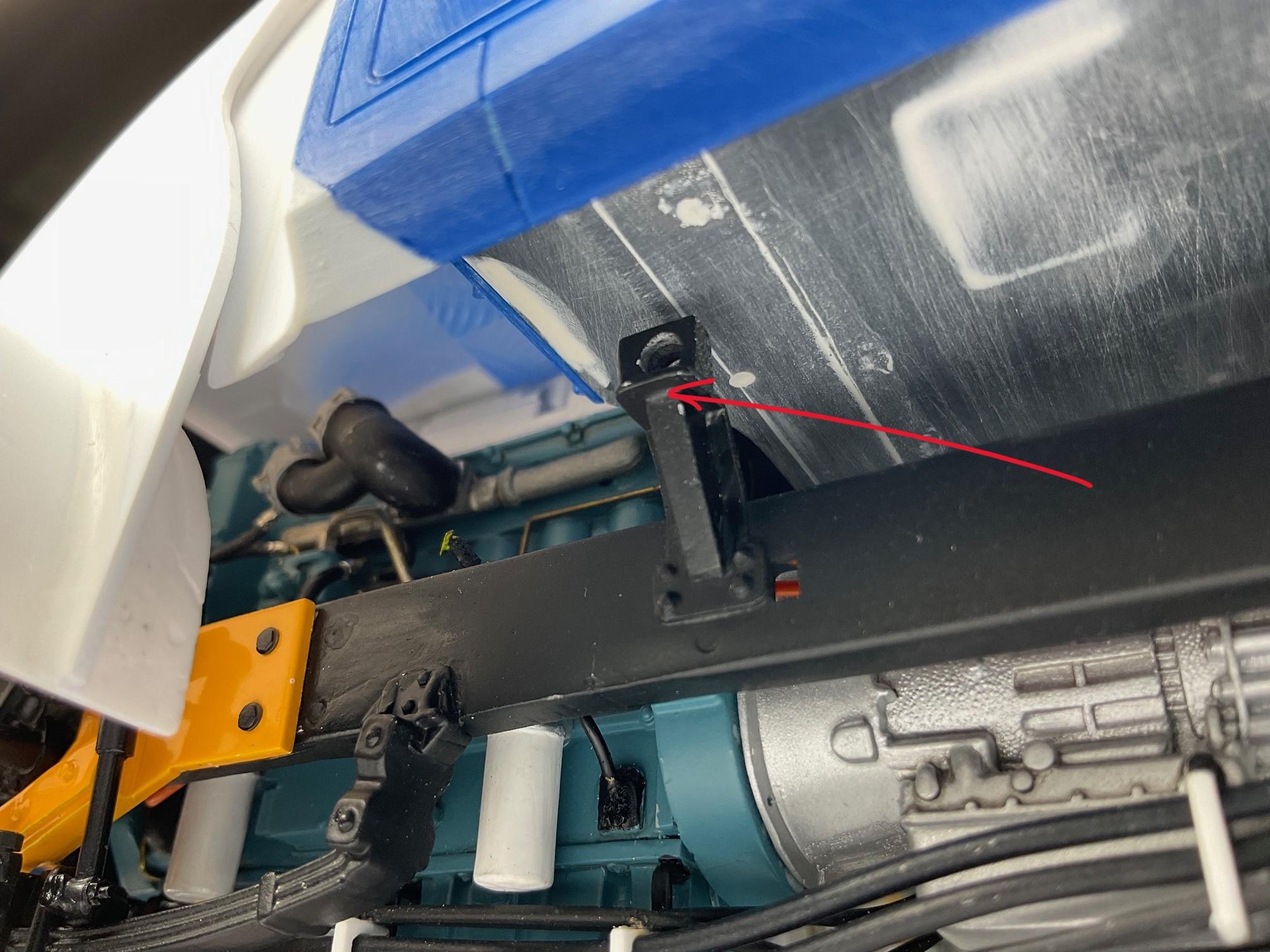

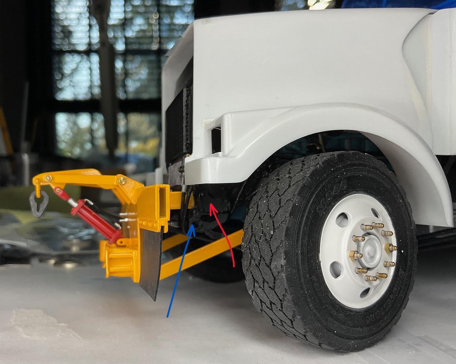

I was worried about interference with the flap, by power steering hoses and brake pot air line - the photo is kind of grainy, but, given that the flap only extends downwards to just below top of frame rail, it shouldn't interfere with any hoses.
While taking the fender clearance photos, it became clear that the modifications to move the firewall back made problems for me with the front cab mount.  This mount was made a long time ago, not knowing about any future work to cab/hood I might do.  So, now I need to shim the support piece because it sits right at the junction where the footwell starts to slope up.
Seems like I keep creating more work for myself!  But, I really think that, once the hinge problem is solved, the rest of this is going to go reasonably quickly.  Going out to the shed to apply a bit more putty to hood.  In a few days, after the inner fenders are shaped and in place, and the hood re-sanded, should be able to give it a shot of primer and see what that reveals for any more work!   As always, take care, and I welcome your questions and comments!

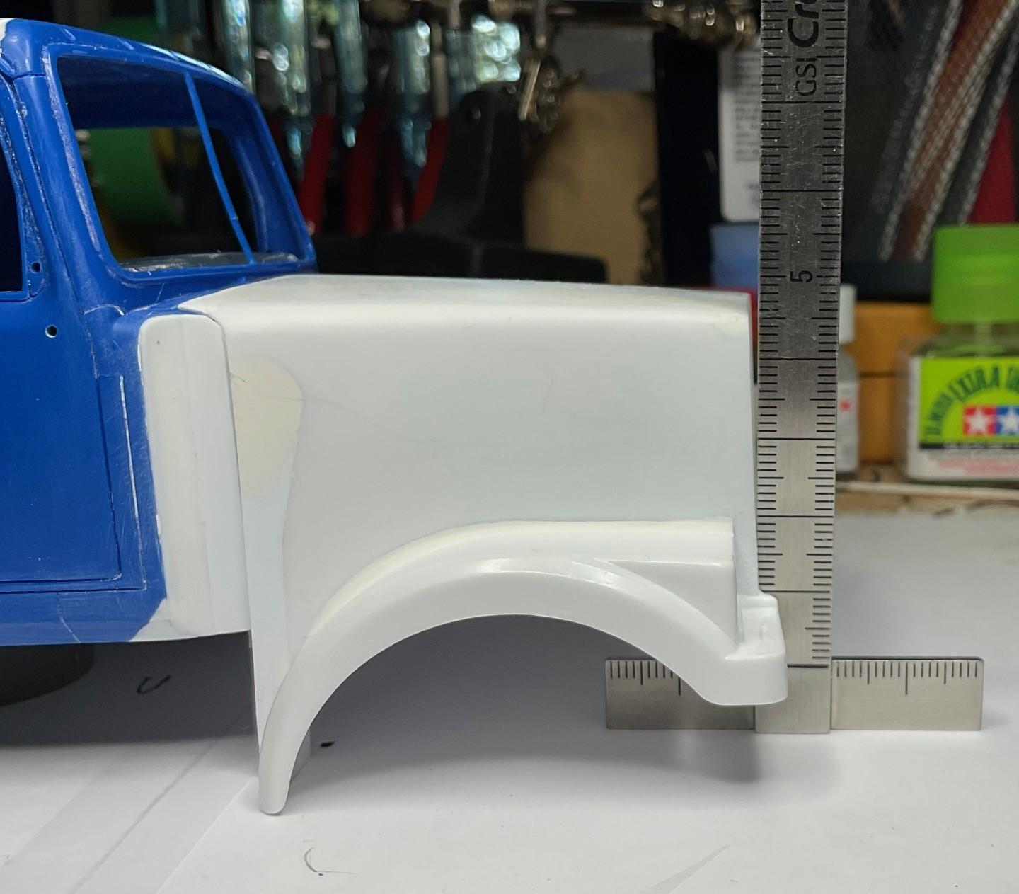

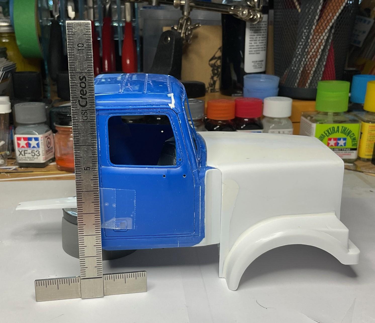

Had to retest the fit of the cab/hood with them both being raised by 2mm.  Measurements from the desk top to the top of the hood, show I should be able to do the inner hood brace and not have a conflict with the air intake plenum.  It was also gratifying to see the driver side row of bolt holes (for the inner fender rubber flap) are close to parallel with the frame rail

I took a measurement from desk top to bottom, rear edge of fenders with the cab/hood in place, then mocked up hood without cab - should be plenty of room to get air intake from air filter over to turbo
