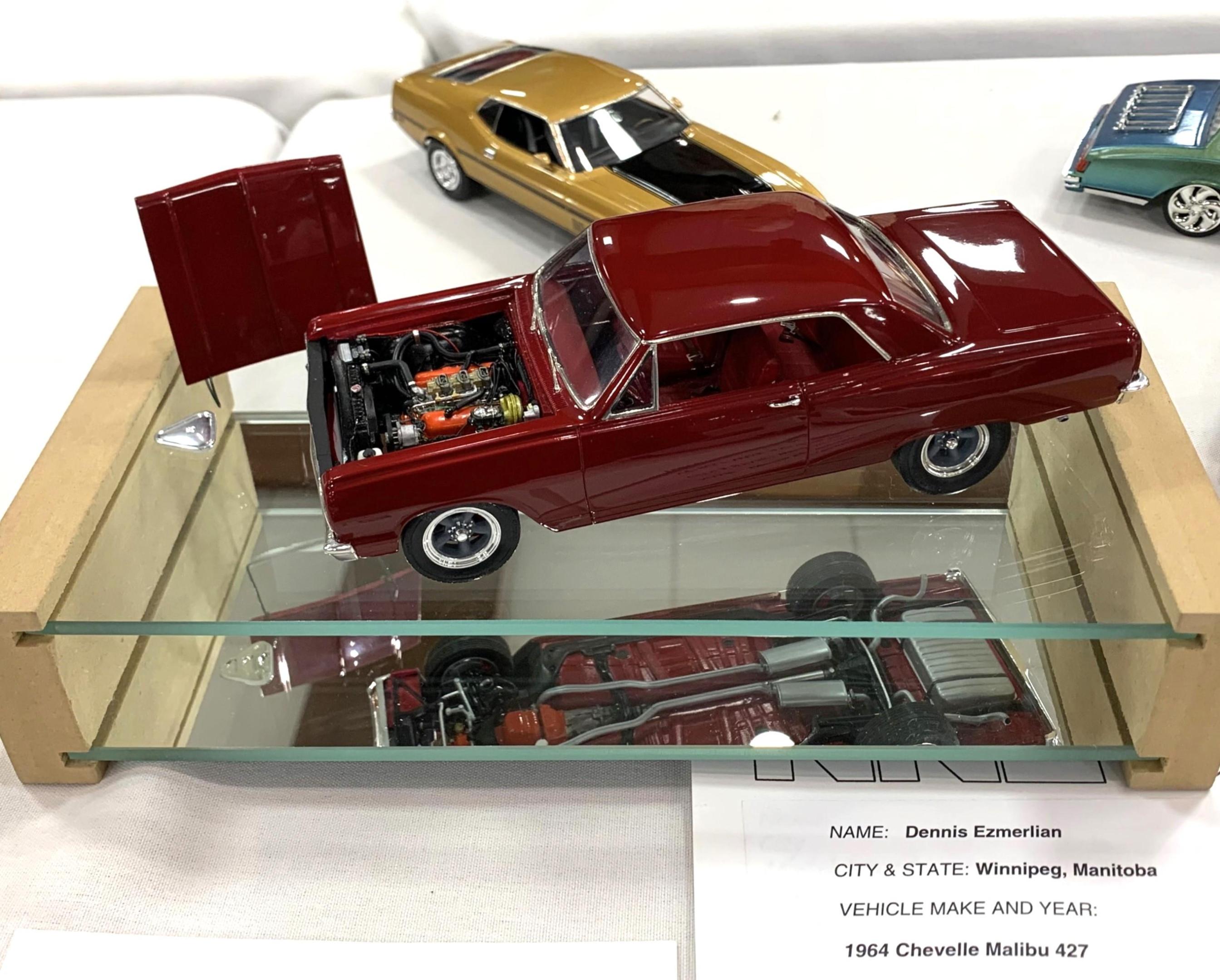

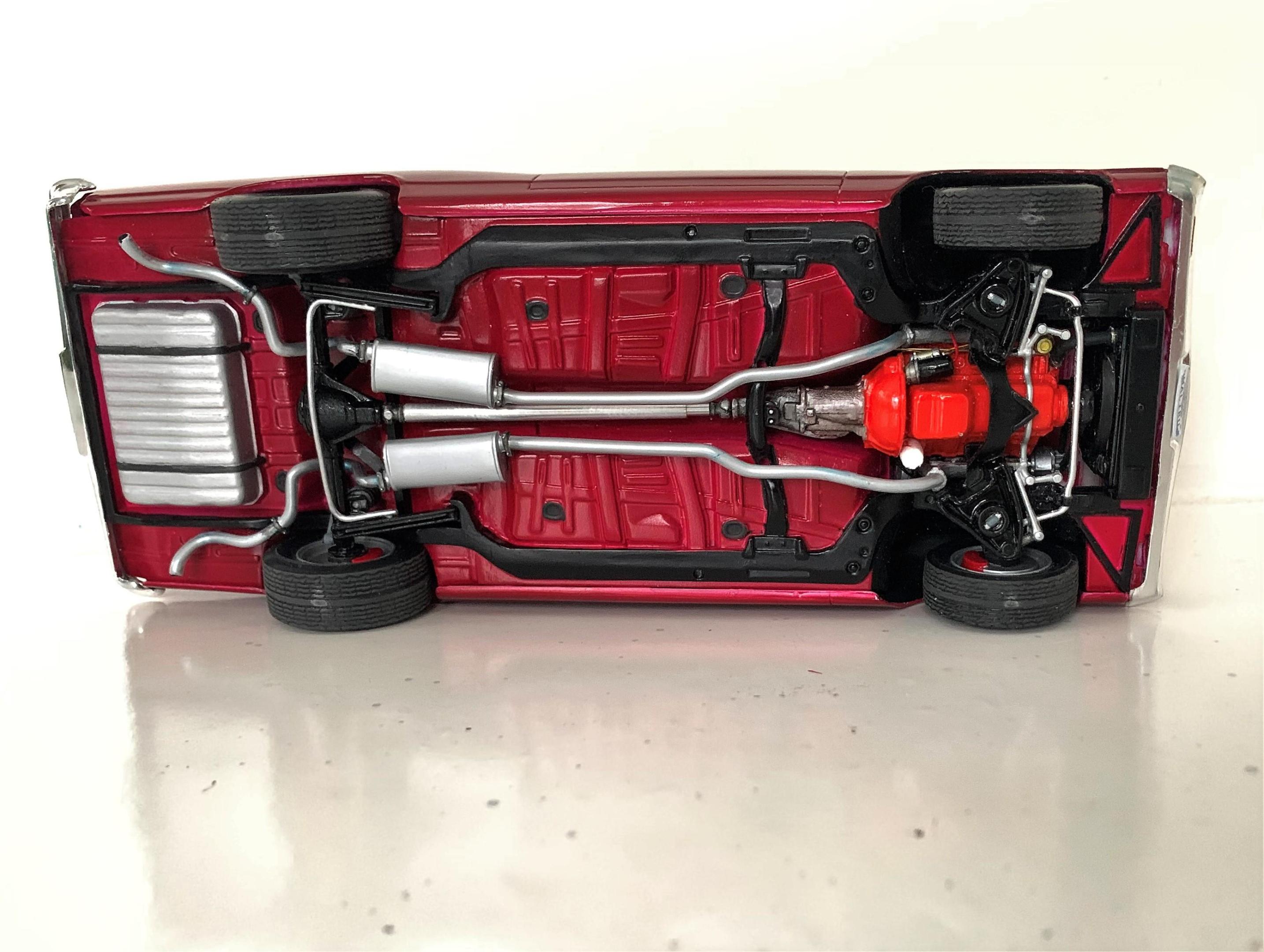

For the excellent Revell '65 chassis to fit, first remove the upper front wheel well tops, then make a cut to shorten the pan, only by a fraction of an inch, the cut is almost enough itself, just some light sanding before the parts are re-joined.
Mine is not a drag car, but here's how it turned out.
  • Like 5
THAT is absolutely GORGEOUS!!!
  • Thanks 1
