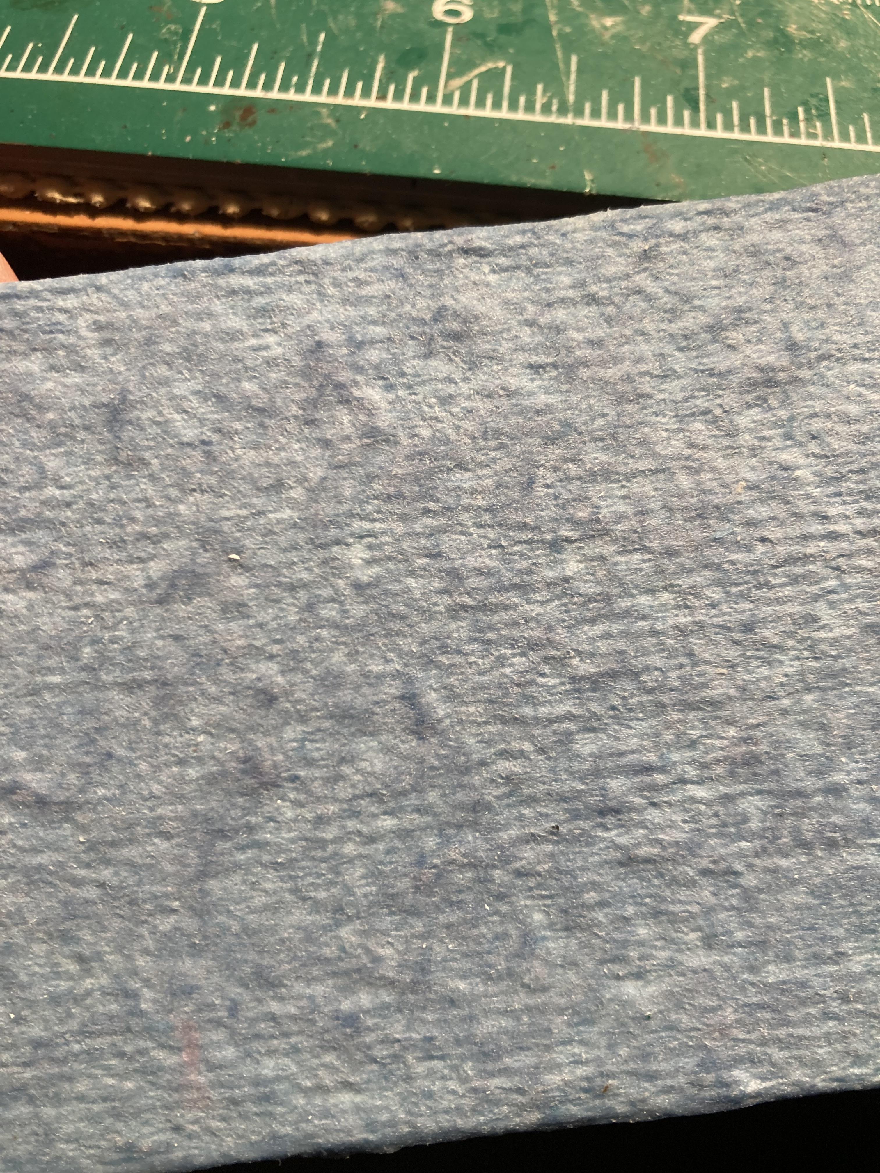

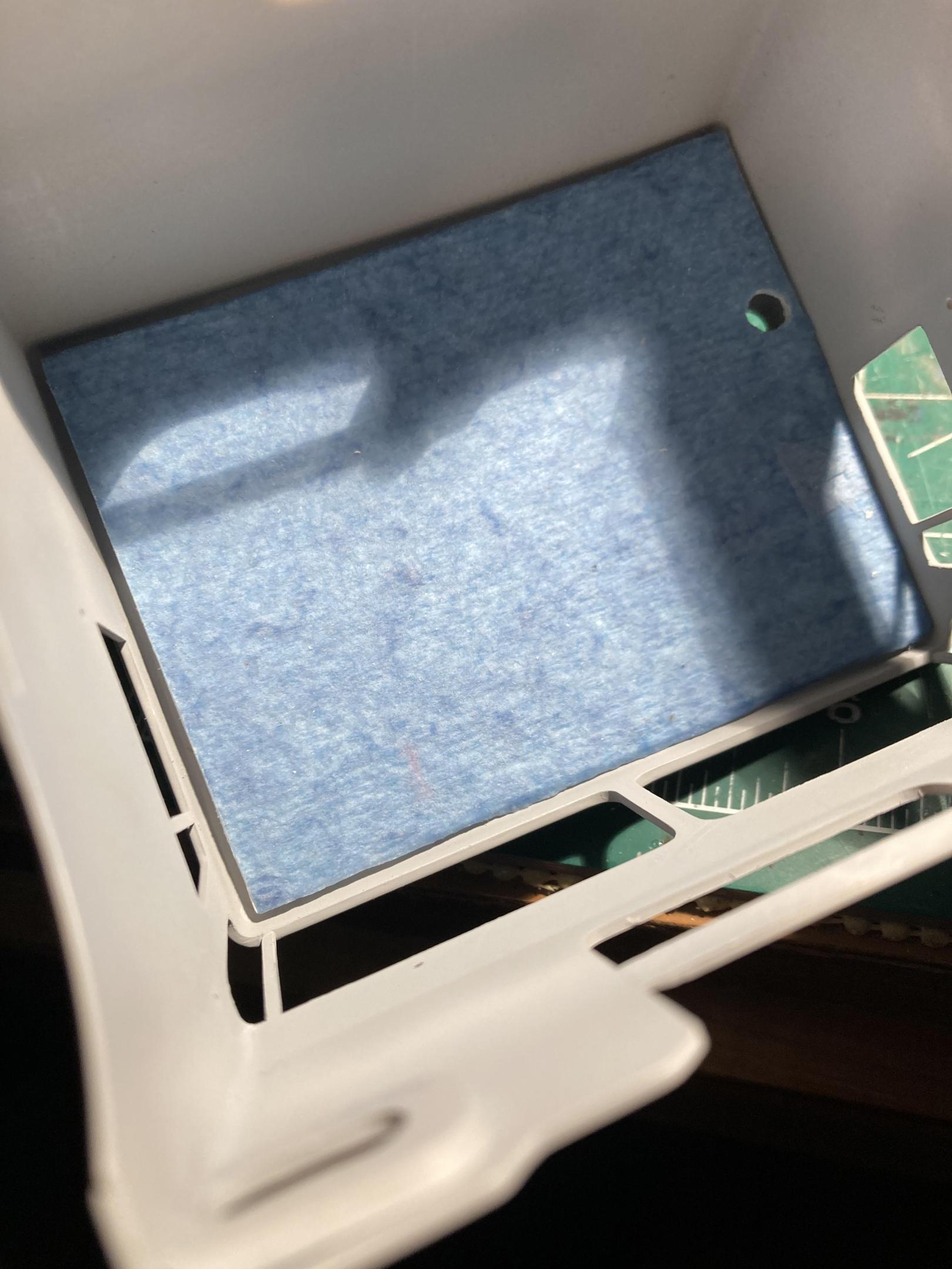

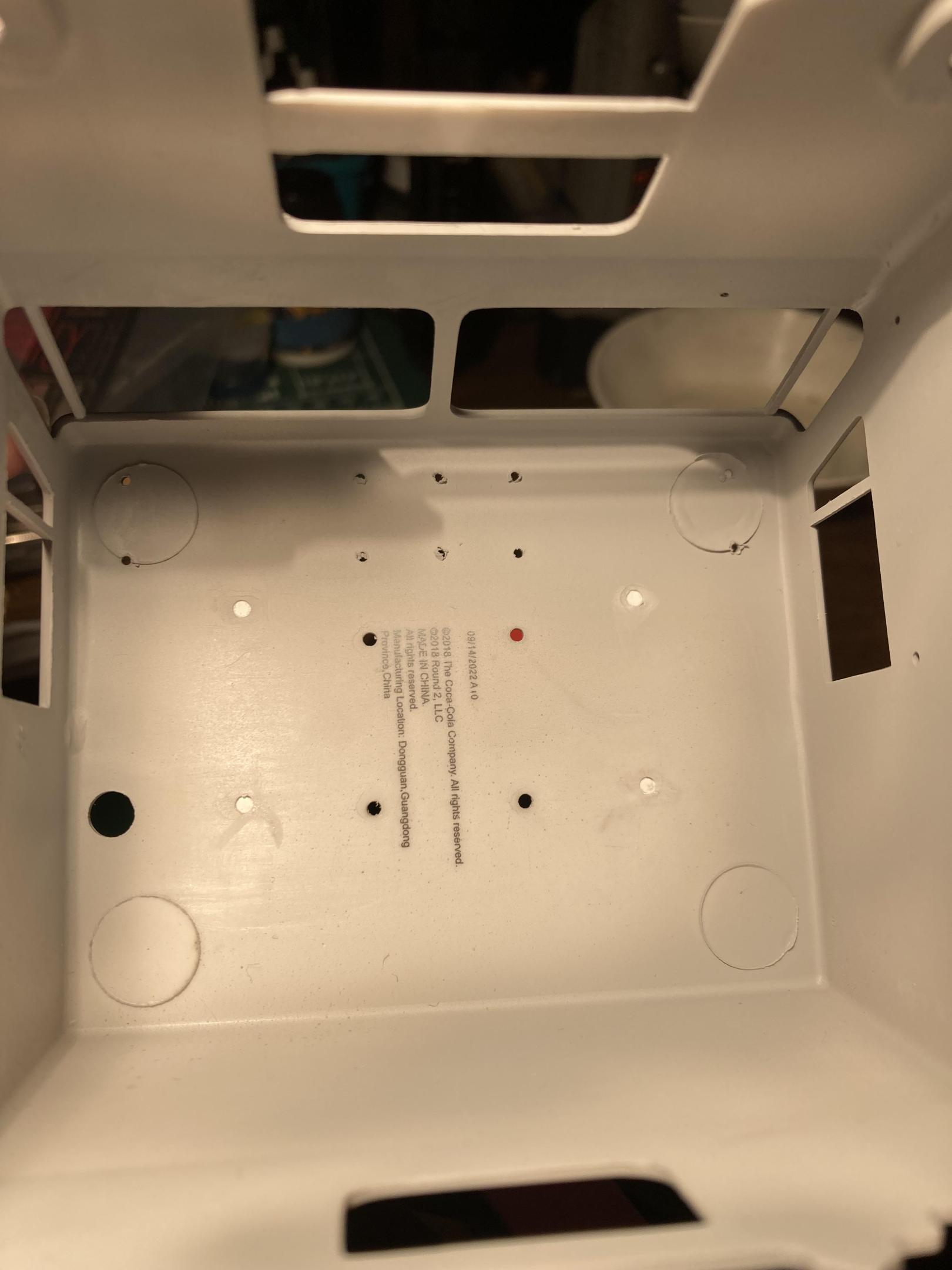

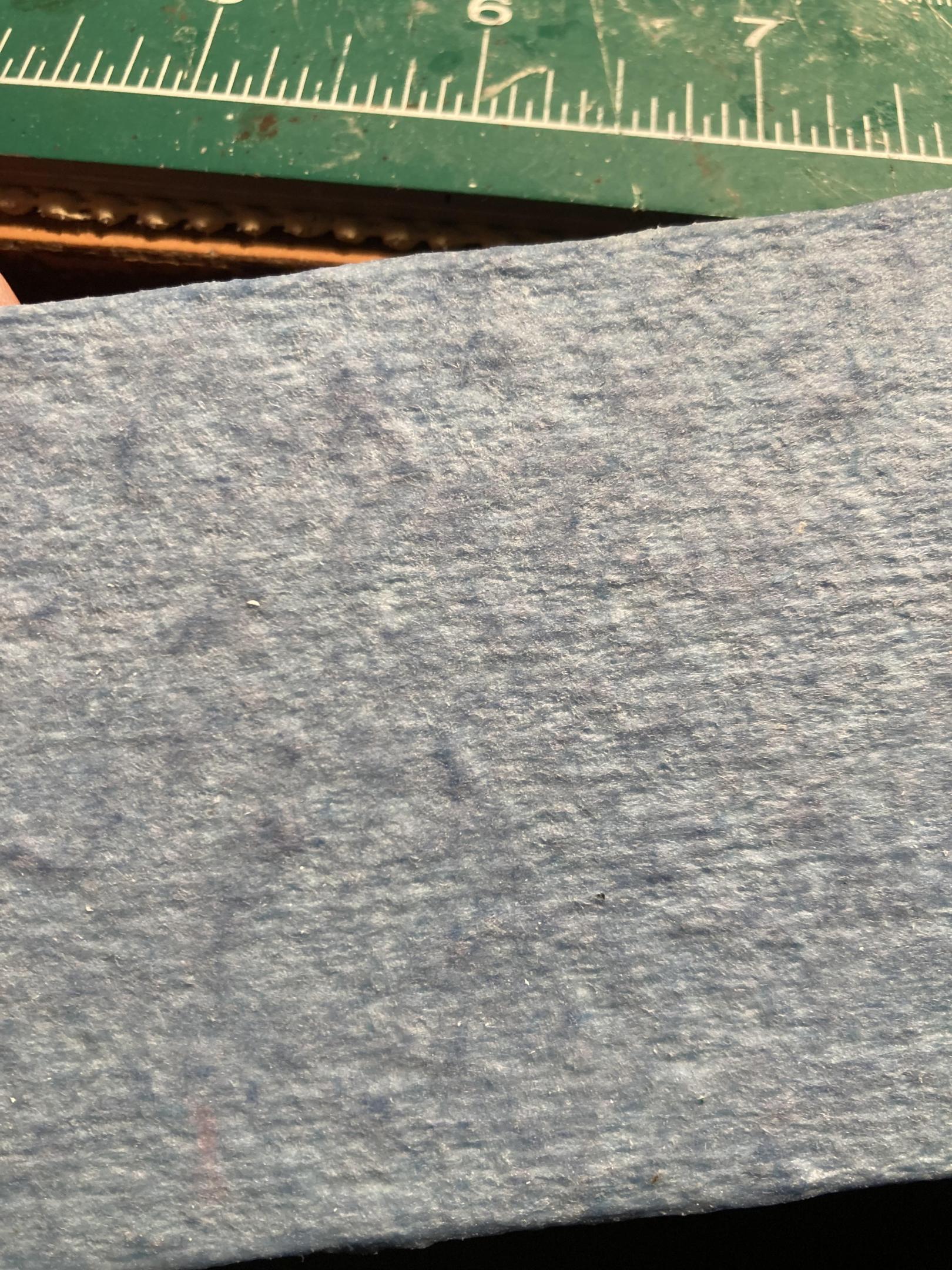

Biggu Posted October 18, 2024 Author Posted October 18, 2024 Not a huge update but enough to keep the thread alive. So, because the inside of the cab looks somewhat unsightly and sometimes just paint doesn’t really do a decent job, I made a ‘head liner’ , although not perfect but good enough to pass when installed and under a splash of paint. It will suffice as it is not a real glaring piece but will be visible if looking into the cab .

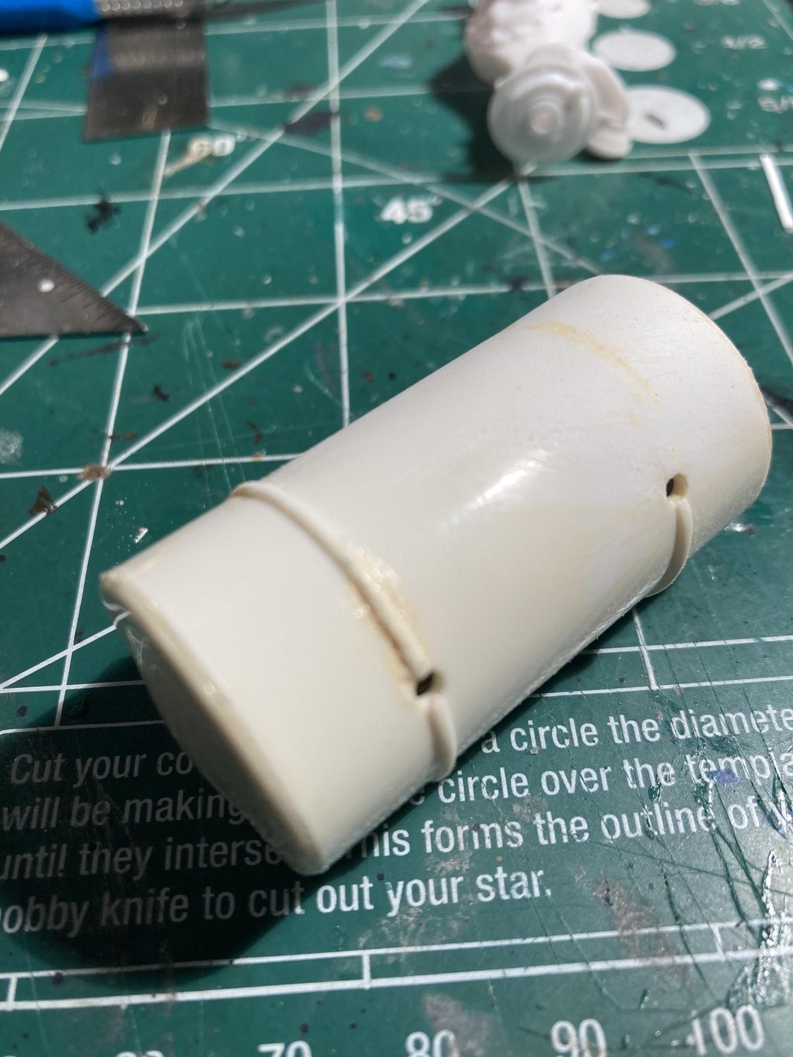

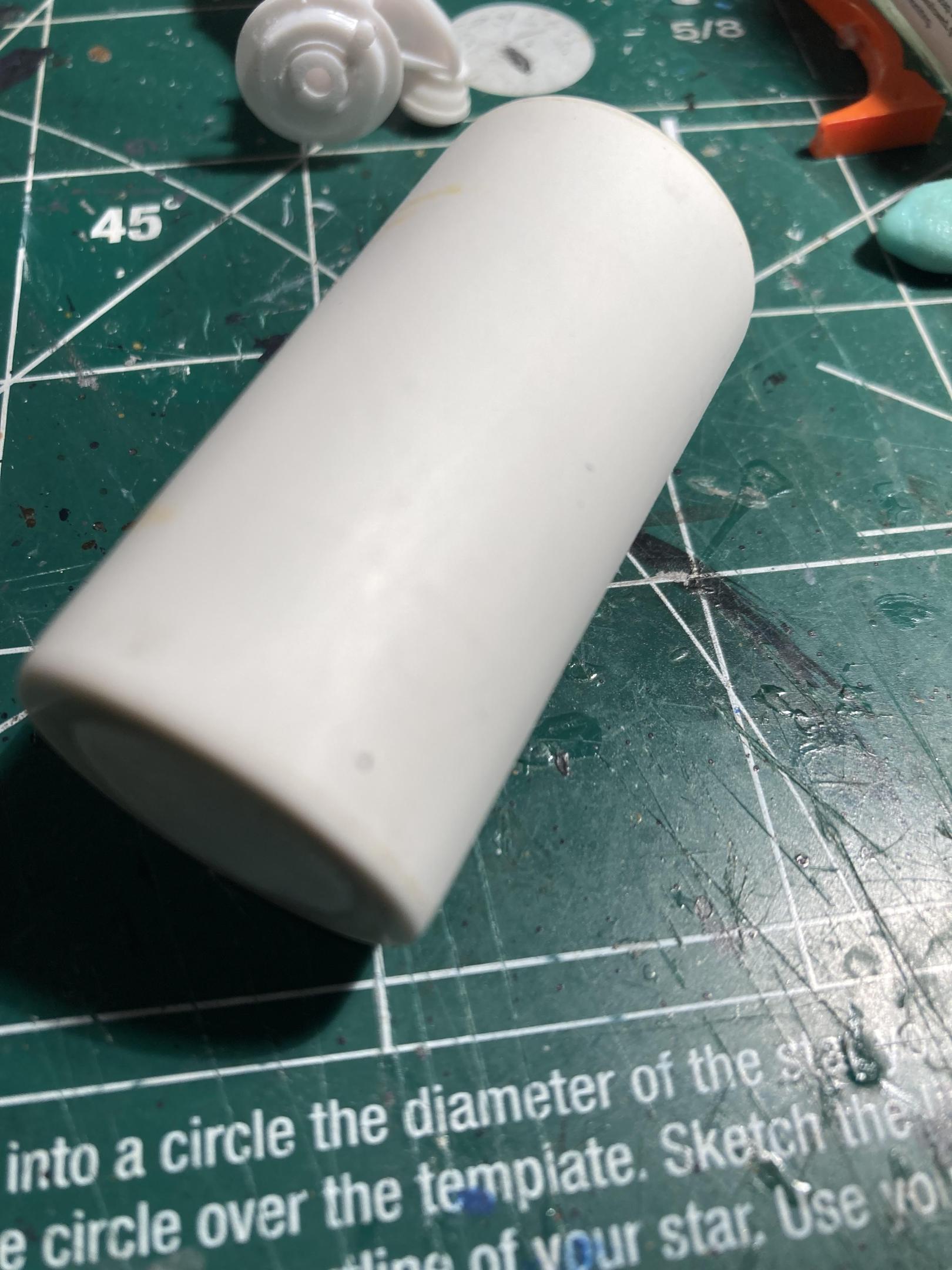

Biggu Posted October 18, 2024 Author Posted October 18, 2024 Another small thing is that I have noticed that some of the Hayes Clipper 100’s seem to have the 100 gallon fuel tank and it seems most just have a single large instead of the 2 smaller 50 gallon tanks as the Pete 352 shows. It is a bit difficult to be sure that there was only one 100 gallon fuel tank and not two as detailed information on these trucks is somewhat elusive. So I found, in my parts box a 45 year old Kenworth fuel tank . It needed to be disassembled, de-chromed, re-assembled ( sounds like a bug job, eh? LOL but only four easy pieces ) and then the molded in straps needed to be sanded off. I have some nice p/e straps I want to try and hopefully not making a hash out of. We will see…., next conundrum is….. re-chrome ( not really sure I want to do that), paint frame color, or paint silver like they did back in the day. This being a work truck, I’m leaning towards the paint is silver……any thoughts from you guys would be welcome food for thought. … 1

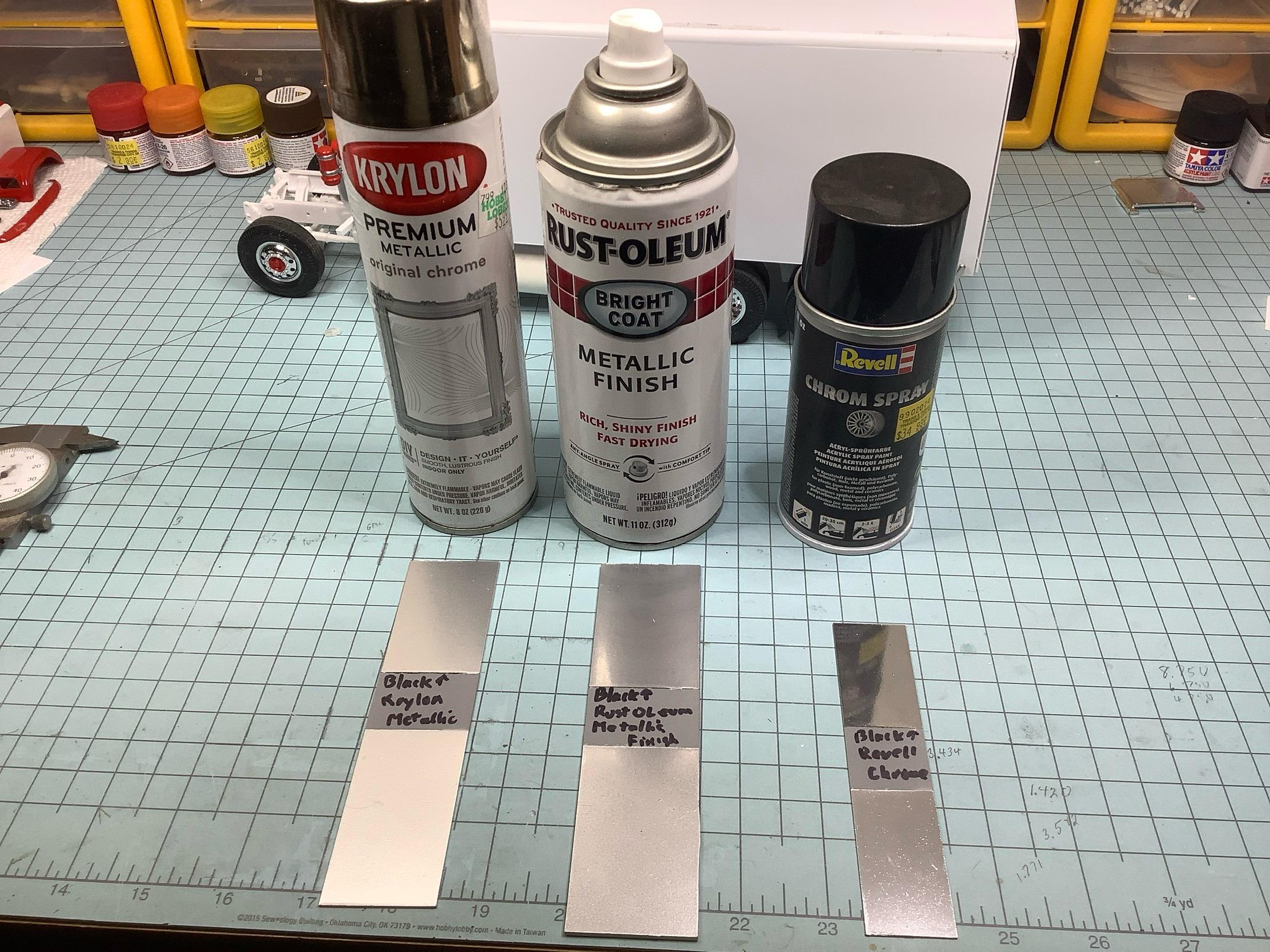

Gary Chastain Posted October 18, 2024 Posted October 18, 2024 Not sure if this helps, some garage experiments with these paints. I have used all three for different look for my builds. Oh, and these will not finger print when dry, so you can work with them. the Krylon is a flatter finish ( looks like dull aluminum), the Rustoleum is a similar color but a bit more gloss ( works good for an aluminum wheel or detail). Then the Revell chrome. 1
BK9300 Posted October 18, 2024 Posted October 18, 2024 Nice refurbishing of the old tank - sure looks better than the way we used to put them together 30 years ago! 1
Jürgen M. Posted October 18, 2024 Posted October 18, 2024 On 10/18/2024 at 6:58 PM, Gary Chastain said: Not sure if this helps, some garage experiments with these paints. I have used all three for different look for my builds. Oh, and these will not finger print when dry, so you can work with them. the Krylon is a flatter finish ( looks like dull aluminum), the Rustoleum is a similar color but a bit more gloss ( works good for an aluminum wheel or detail). Then the Revell chrome. Expand I think Revell chrome is pretty good! After I have it a second chance (or rather myself in handling it) I'm pretty Fond of it! This is coated with Revell chrome: 1
Biggu Posted October 18, 2024 Author Posted October 18, 2024 On 10/18/2024 at 7:16 PM, Jürgen M. said: I think Revell chrome is pretty good! After I have it a second chance (or rather myself in handling it) I'm pretty Fond of it! This is coated with Revell chrome: Expand That's good to know, however it is frightfully expensive.... it does have nice results..... by looking at Gary's garage experiments, looks to me as black is the base for the good finishes, I bought some 'chrome' paint from Canadian tire and it is garbage, came out of the can like Spackle.... I was less than impressed, and it came out like opening a hose tap ! Although I see Gary got good results, maybe it was the operator? ( me ) ....
Biggu Posted October 18, 2024 Author Posted October 18, 2024 On 10/18/2024 at 6:58 PM, Gary Chastain said: Not sure if this helps, some garage experiments with these paints. I have used all three for different look for my builds. Oh, and these will not finger print when dry, so you can work with them. the Krylon is a flatter finish ( looks like dull aluminum), the Rustoleum is a similar color but a bit more gloss ( works good for an aluminum wheel or detail). Then the Revell chrome. Expand Thanks Gary, that's really great info.... I haven't had great luck with cans, and like I mentioned to Jurgen, maybe it was my operating skills or lack there of....
Biggu Posted October 18, 2024 Author Posted October 18, 2024 On 10/18/2024 at 7:07 PM, BK9300 said: Nice refurbishing of the old tank - sure looks better than the way we used to put them together 30 years ago! Expand Thanks, Brian... still a ways to go though, but you are absolutely correct, amazing what a little patience and accuracy can produce ! LOL Sorry for the crummy pics, its my phone....

RoninUtah Posted October 18, 2024 Posted October 18, 2024 On 10/18/2024 at 5:49 PM, Biggu said: So, because the inside of the cab looks somewhat unsightly and sometimes just paint doesn’t really do a decent job, I made a ‘head liner’... Expand Great idea! What material did you use? On 10/18/2024 at 6:58 PM, Gary Chastain said: Not sure if this helps, some garage experiments with these paints. I have used all three for different look for my builds. Oh, and these will not finger print when dry, so you can work with them. the Krylon is a flatter finish ( looks like dull aluminum), the Rustoleum is a similar color but a bit more gloss ( works good for an aluminum wheel or detail). Then the Revell chrome. Expand On my W990 build, I used Motlow Liquid Chrome, out of the "refill" bottle. I airbrushed it (easy cleanup with rubbing alcohol), and it turned out great. 1

Biggu Posted October 18, 2024 Author Posted October 18, 2024 On 10/18/2024 at 7:57 PM, RoninUtah said: Great idea! What material did you use? On my W990 build, I used Motlow Liquid Chrome, out of the "refill" bottle. I airbrushed it (easy cleanup with rubbing alcohol), and it turned out great. Expand I used a square of . 020 sheet styrene and took one of those cheap shop cloths, and watered down white glue, and soaked the paper towel, and layed it on the sheet to really dry, did a light trim and Bazinga ! I think a shot of paint that will be the interior color will give the illusion of a headliner, not hugely visible, but when I look inside it may appear a little more finished..... I used the Molitow pen on some builds, but the refill bottle sounds possible too.... when you air brushed it... thinned or straight out of the bottle....?

RoninUtah Posted October 18, 2024 Posted October 18, 2024 On 10/18/2024 at 9:07 PM, Biggu said: I used a square of . 020 sheet styrene and took one of those cheap shop cloths, and watered down white glue, and soaked the paper towel, and layed it on the sheet to really dry, did a light trim and Bazinga ! I think a shot of paint that will be the interior color will give the illusion of a headliner, not hugely visible, but when I look inside it may appear a little more finished..... I used the Molitow pen on some builds, but the refill bottle sounds possible too.... when you air brushed it... thinned or straight out of the bottle....? Expand Great idea for the headliner, I'll think about using that on the build I'm planning now! I got frustrated with the Motlow pens- they only seem to work only half the time, and you never know if you're going to get a nice thick line that looks like real chrome, or something less. I buy the refill bottles, and I use a brush for small detail painting- I have a lot more control that way. When I airbrushed it, I used it straight out of the bottle, with no thinning. It cleans up super-easy with alcohol. One bottle lasts a surprisingly long time. 1
