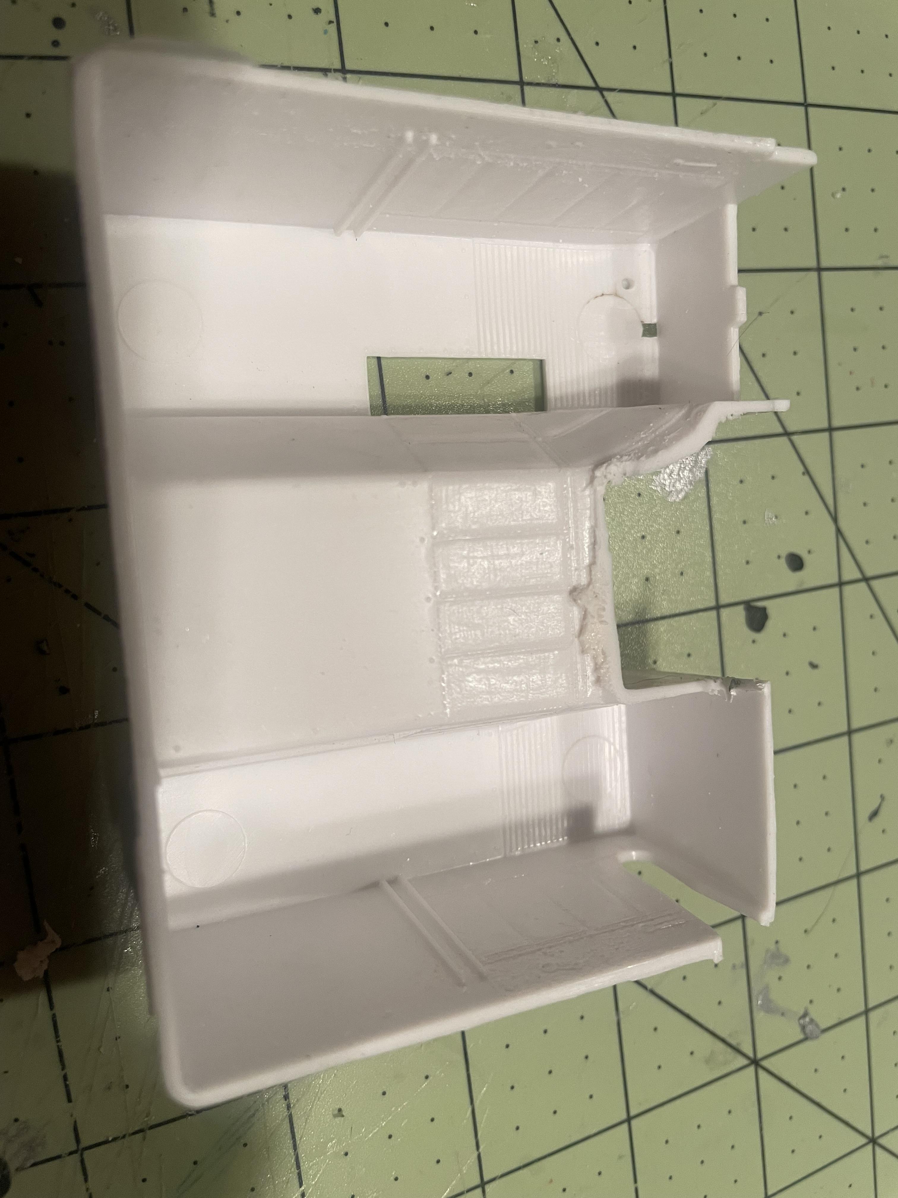

RoninUtah Posted November 1, 2024 Author Posted November 1, 2024 More work on the cab... first, the exhaust stack cutout. I cemented the corner of the cab that I had cut off earlier to where the new corner will be: And then attached a piece of cut and sliced plastic soda straw to form the curve to close it: Plastic soda straws can be very useful. I've made many an exhaust pipe with them, using the bendy part to line it up where I want it! Anyway, now for the headlight bezels. They should be slightly inboard and slightly lower than stock, so I cut out openings in about the right places. I then flipped the stock headlight surrounds backward and cemented them in, using small round and strip styrene to fill the gaps. These also have tabs on the back to make sure they're rigid when I apply the putty. They'll take a little grinding and smoothing to make them flush before I apply the putty. Hopefully, tomorrow! 3
RoninUtah Posted November 2, 2024 Author Posted November 2, 2024 Putty #1- I put it on a little thick for the first layer: Sanded this morning. I need to add reinforcement to the lower front corners. It looks like at least two more rounds of putty and sanding before I can test the surface smoothness with primer. 2

RoninUtah Posted November 3, 2024 Author Posted November 3, 2024 Continuing on... the cab is pretty close. I decided to add styrene strips below the headllights for some extra room for when I install the headlight surrounds. Maybe one more round of putty and sanding before the first coat of primer. I have a bit of a dilemma with the engine, though. I built the Cummins 250; it does't fit quite as nicely as the Detroit. I can make it fit, of course, but then I'd be faced with having to improvise the air and exhaust plumbing, when I can probably just use the kit plumbing with the Detroit. And the Cummins engine is much longer, so the transmission will stick out behind the cab, although that will be hidden beneath a step plate. I'd have to do some major surgery on the driveshaft, too. Either engine would be period appropriate. What do you guys think? I'm almost embarrassed to show the chassis after seeing Jeff's work! Now I'm thinking about the interior. I discovered, to my surprise, that my kit (the newer CocaCola version) came with a California Hauler 359 dashboard instead of the 352 dashboard! Did that happen to you, Jeff, or anyone else who has done this kit recently? It's probably okay, though, since I'm making a flat dash; I can graft the part with the dials and such onto the styrene strip I'll be using. AMT always makes it interesting! 1
